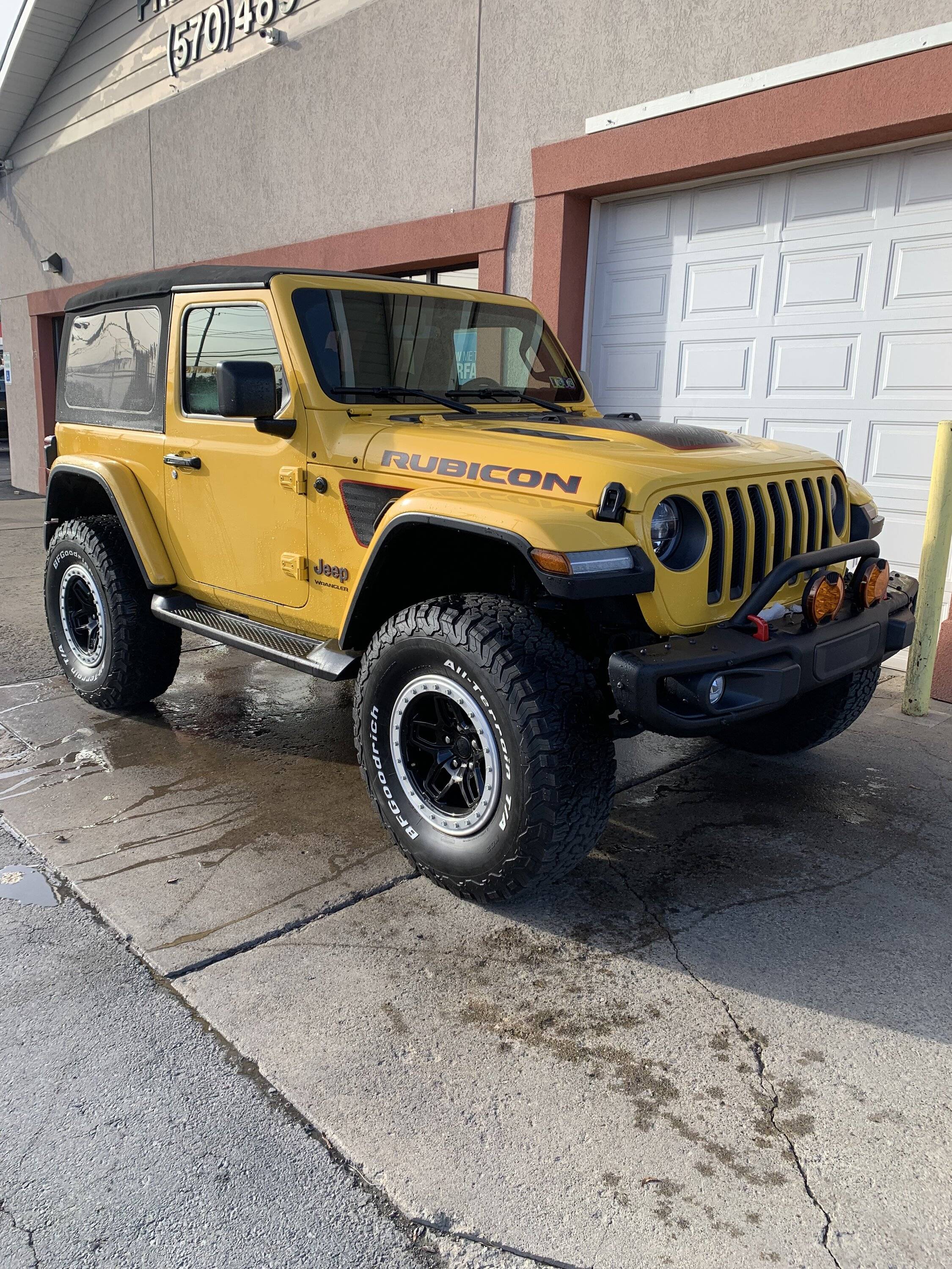

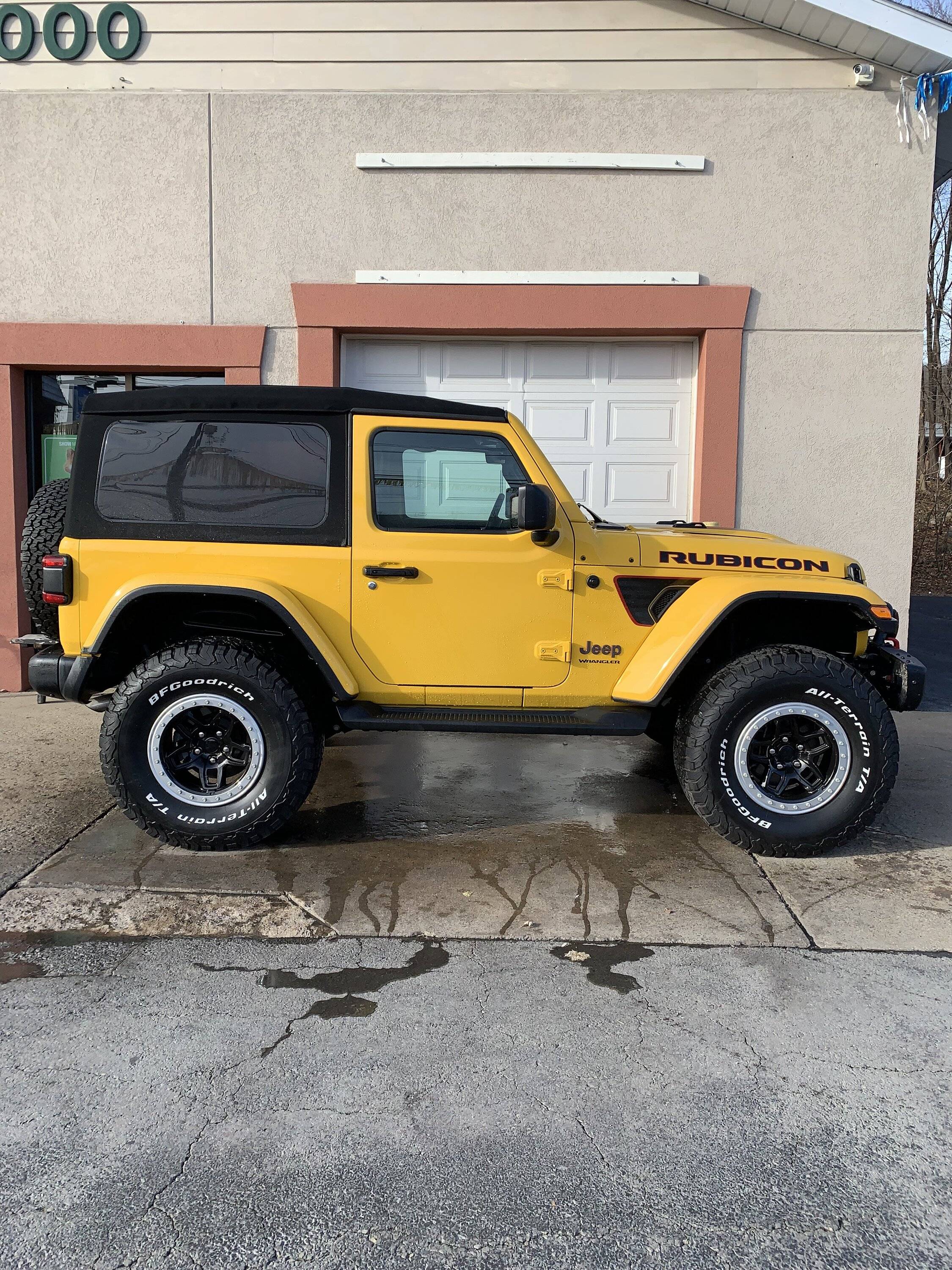

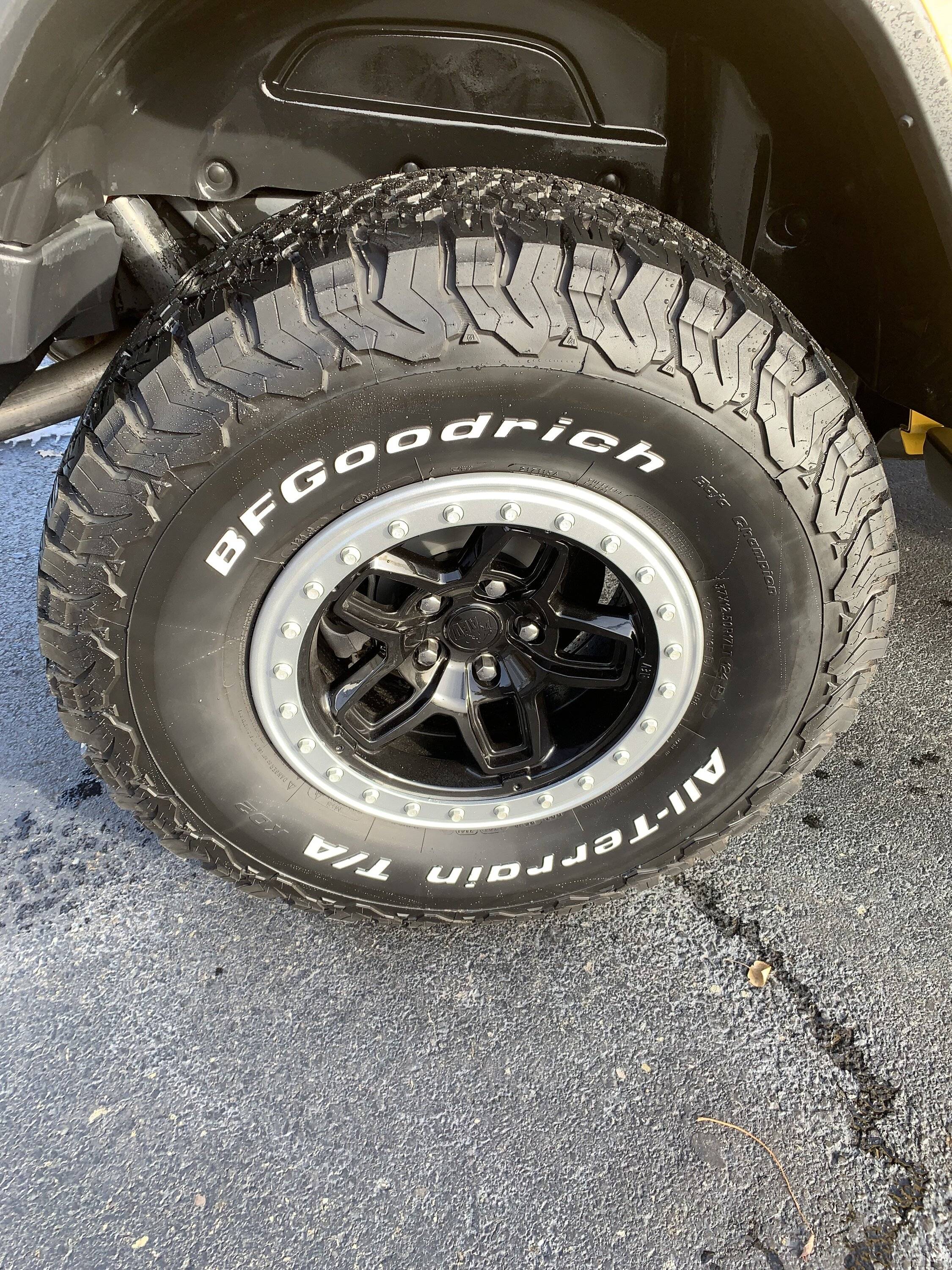

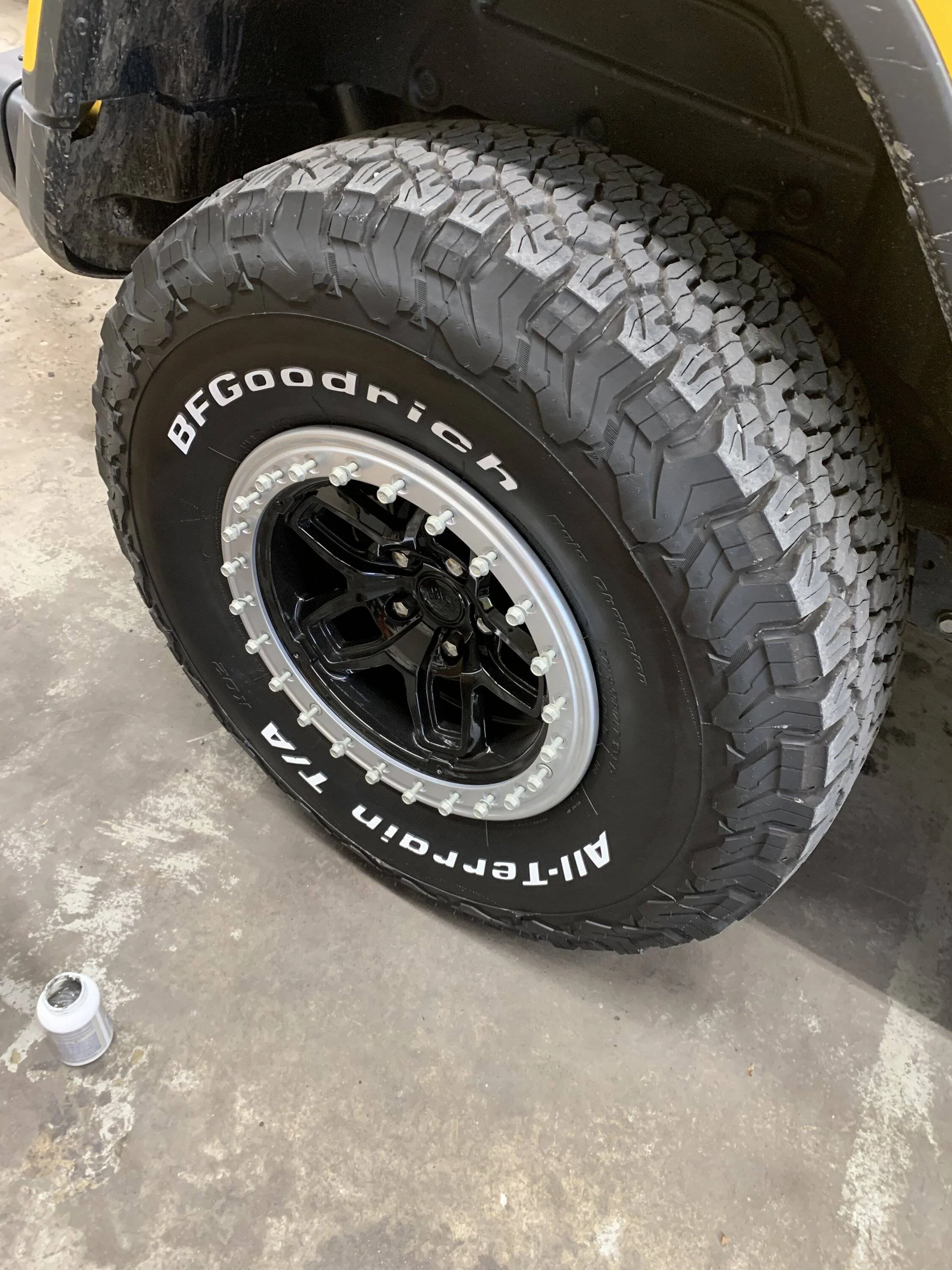

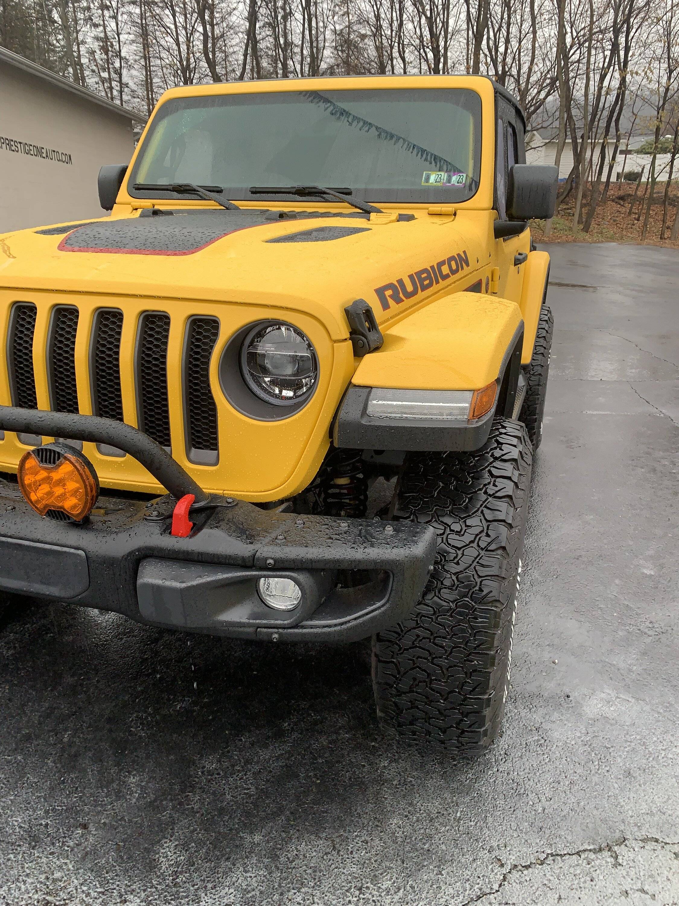

Anyone running the current AEV Borah wheels on a JL? I’ve been told they stick out a little. I don’t hate that but wondering if the version designed for JKs (and its offset) causes any other issues on JLs?
Also, the back up camera does not quite fit through the center of the wheel. Anyone solved for this?
I have a JL with Feb delivery date and wondering if I should wait for the JL version Borahs that are coming out in a couple months.
Any advice is appreciated.

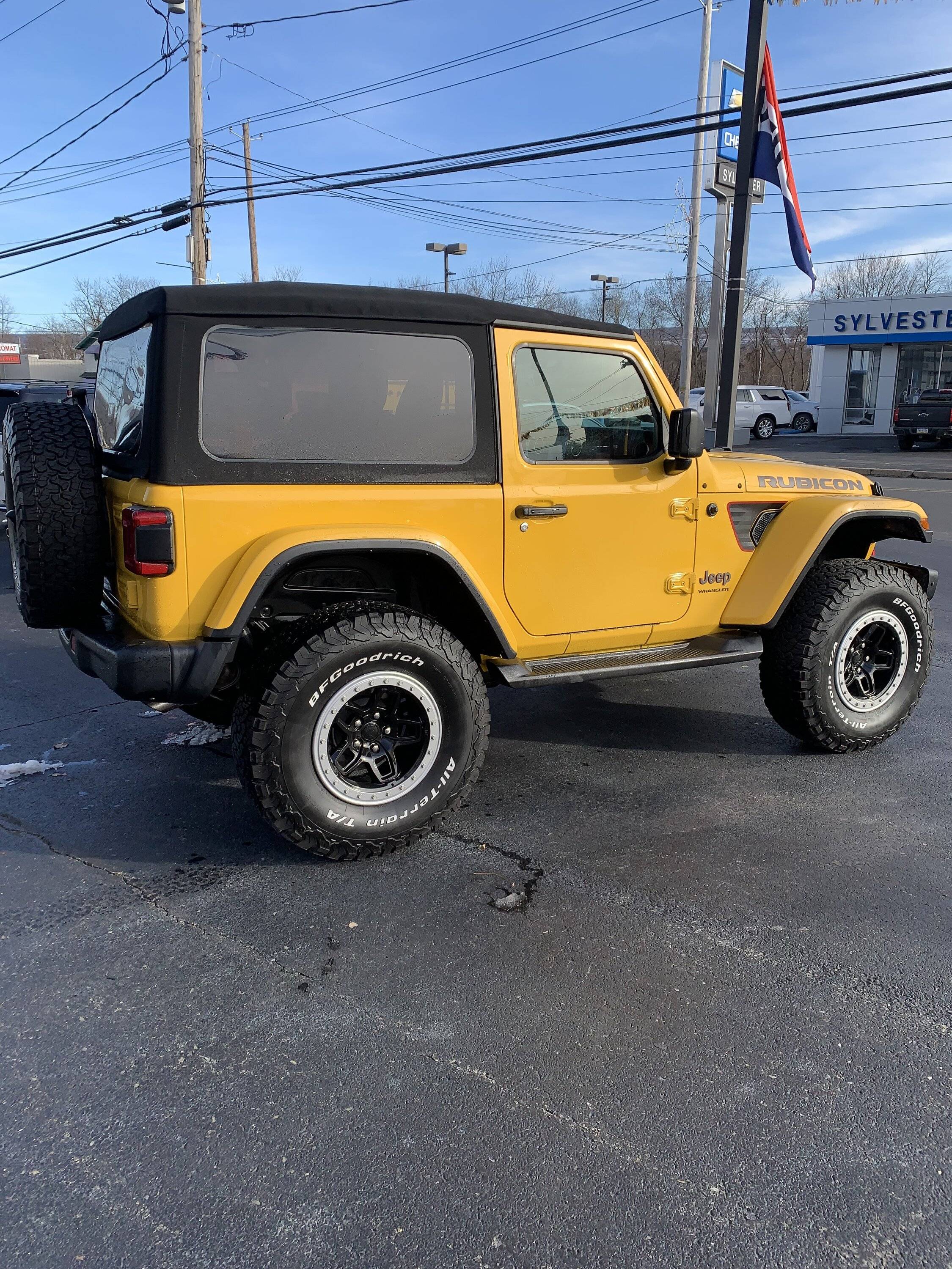

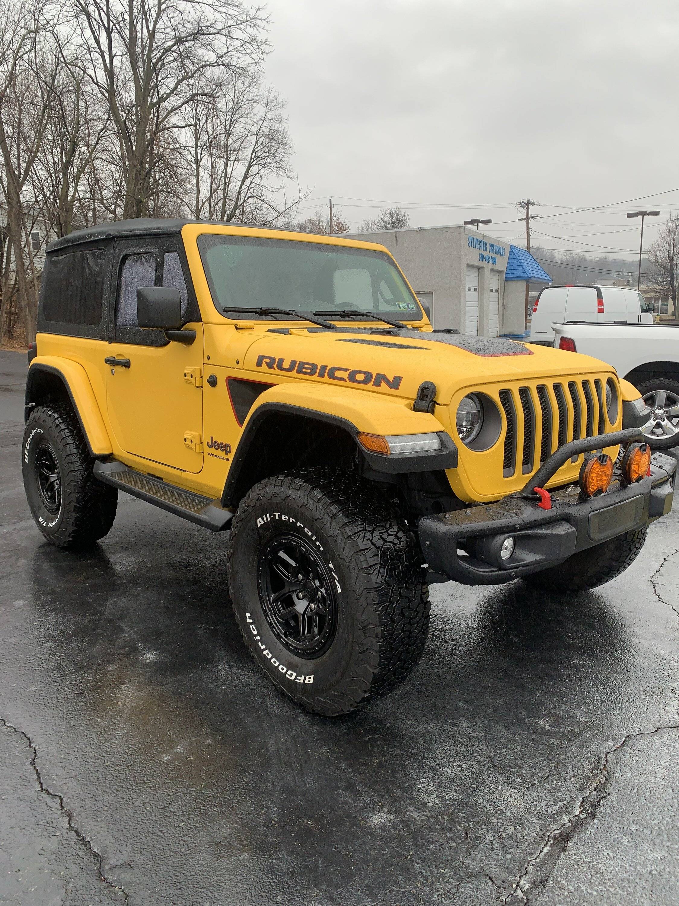

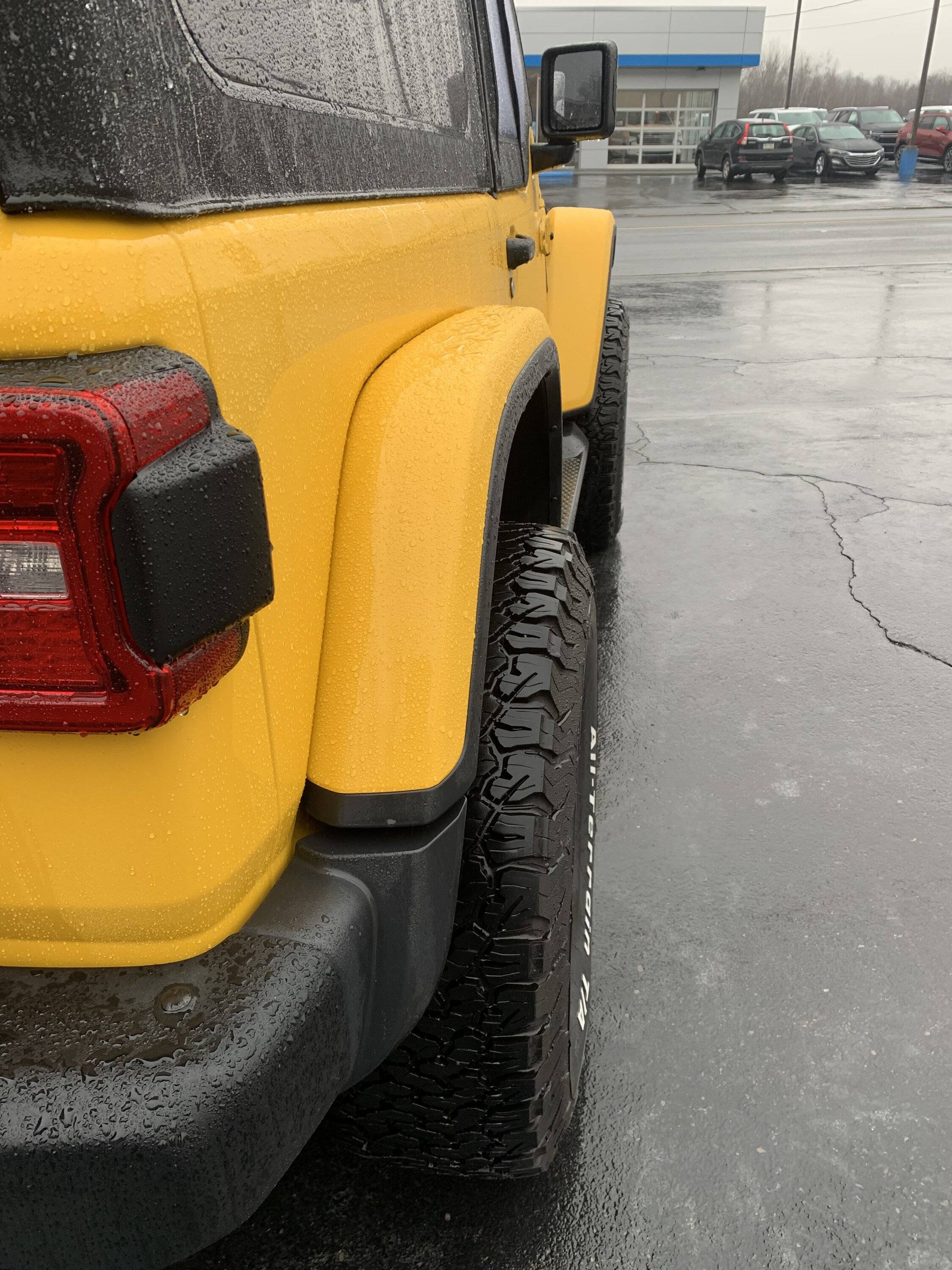

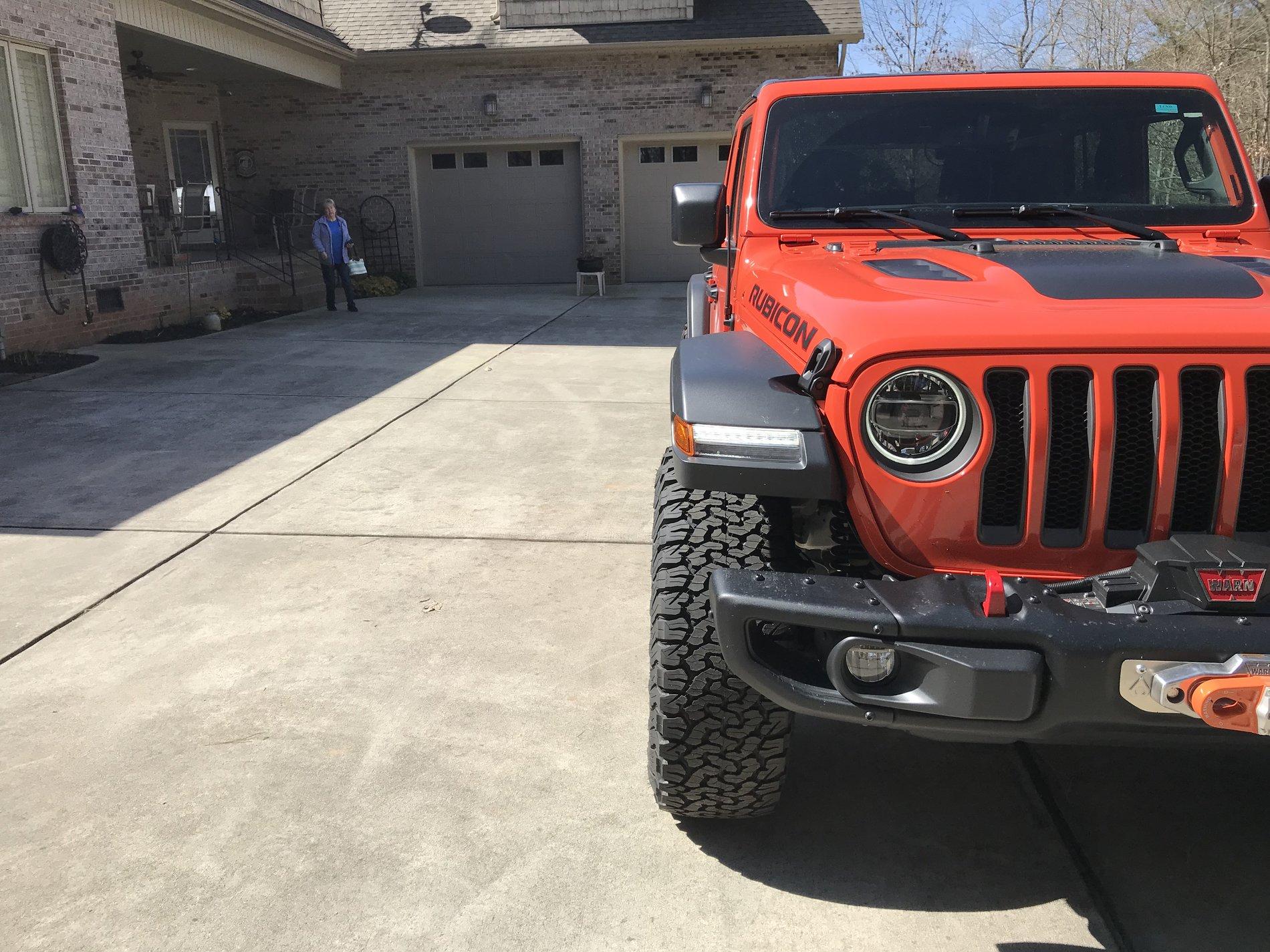

JK BORAHS ON JL 37” ko2 no spacers.With and without protection rings

The Xtreme Recon flares would be ideal.
cool rig, half doors are sweet!! Thanks for the pics.
Thought about those but I’ve seen others that cover from the front to bottom. It’s a mall crawler obviously ? so I actually use it more for the cool convertible than what it should be used for. ??‍♂

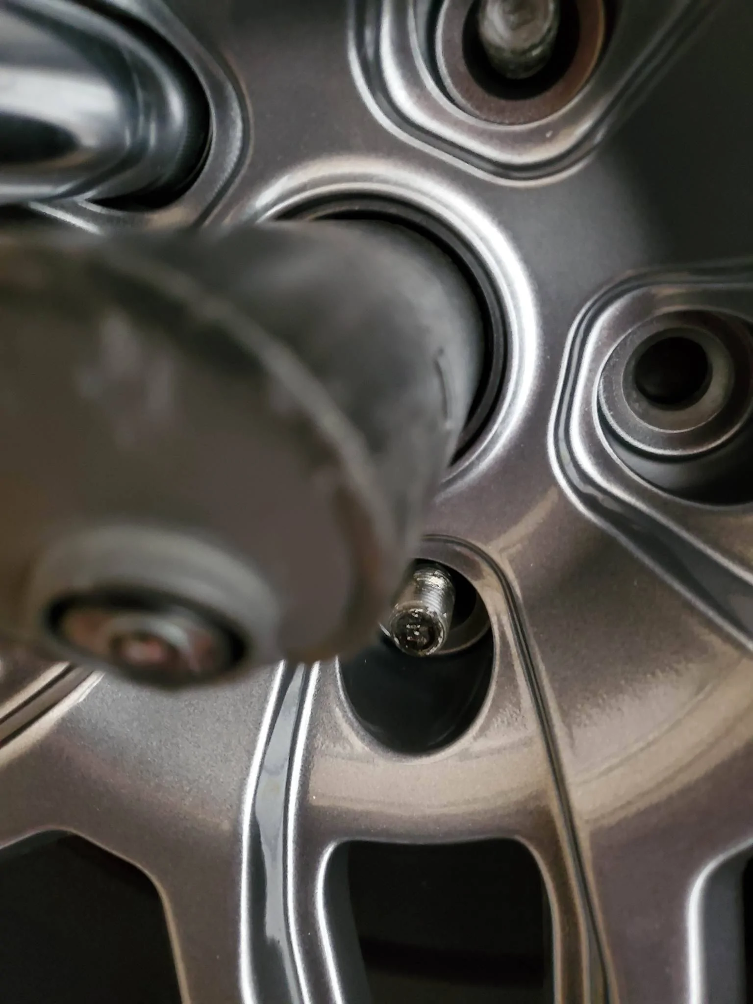

I can officially confirm since my JK AEV Borah wheels arrived today that the center caps are in fact smaller than the JL ones, contradicting what the AEV rep told me over the phone. I have reached out to the rep to get some clarification. I also test fit one of the JK wheels and it clears on the AEV JL tire carrier without issue, but its certainly close. The JL lugnuts also fit in the wheels just fine but you do need a thin wall socket. Again, contradicting what I was told by the AEV rep. I should also note that all five JK Borah wheels were manufactured October 25th, 2022 so they are the 'updated' design as far as I can tell. I will update this once I hear back from the AEV rep.

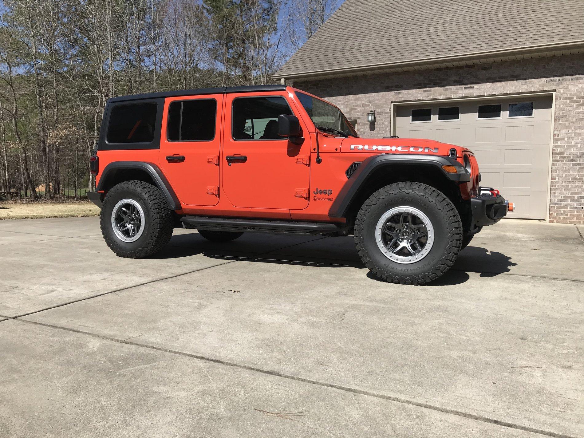

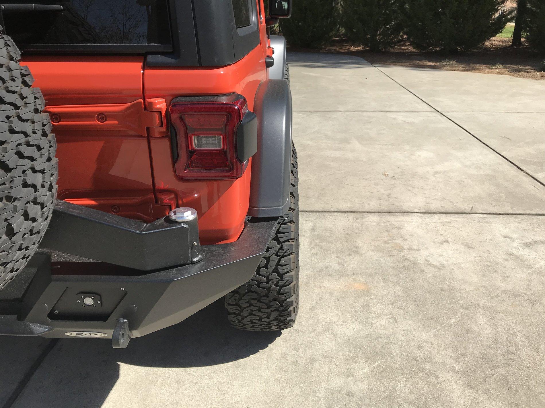

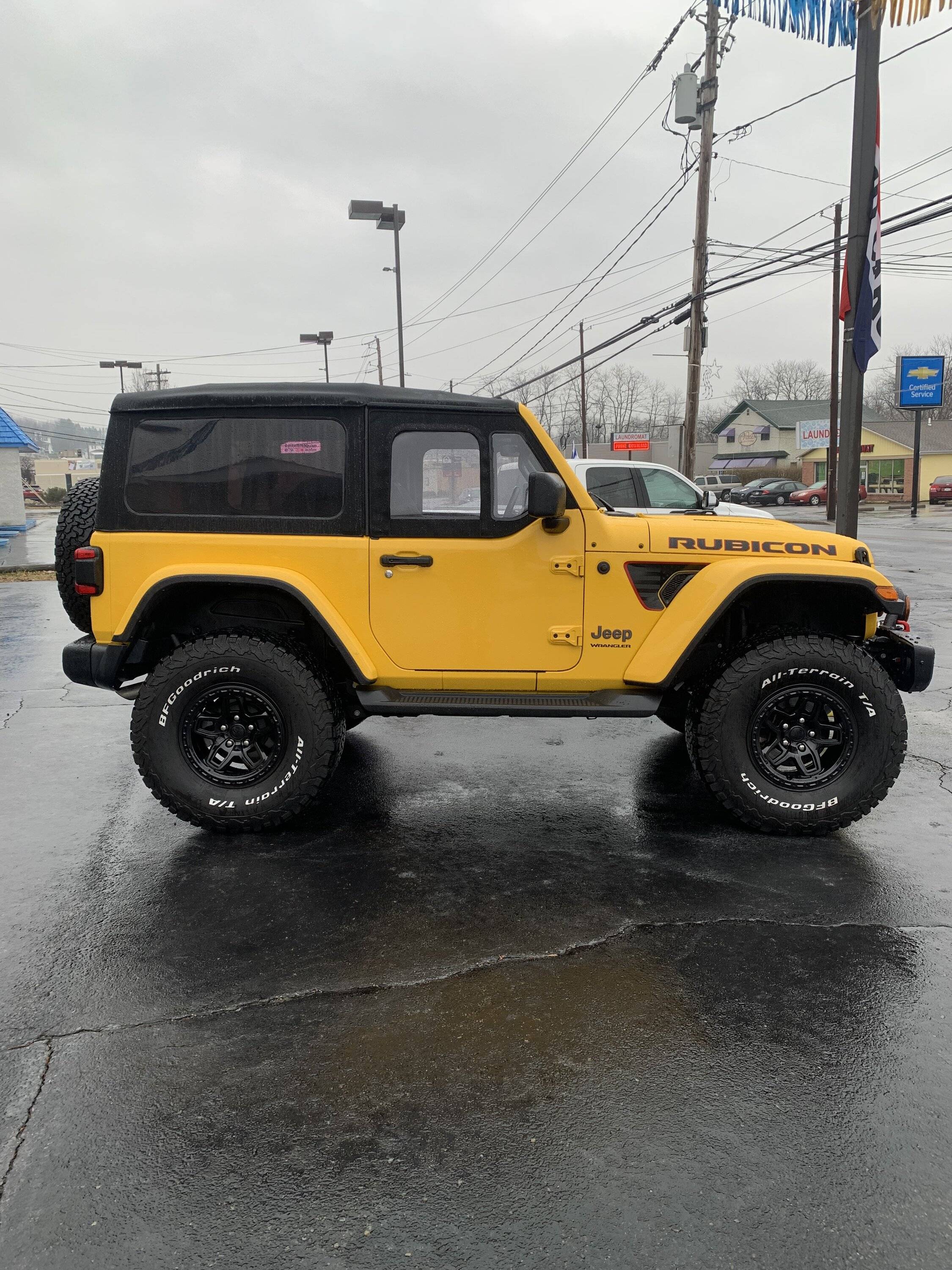

Installed today. 35x12.50 tires
Awesome pics. In the sunlight so you can actually see. Taken at correct angle to see the poke of the wheel. I can appreciate anyone taking the time to post pics (good and bad) but you take excellent pics!

Planning on using the OE JL ones since they work with the thin wall socket I have. Once I get them mounted ill post up comparison pictures.
