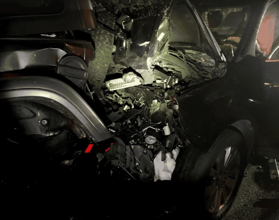

At least think about the implications of disabling a safety feature. It could be really bad if someone has an accident that could have been prevented. Yeah, I had a JLUR totaled by a girl driving a car that lacked that safety feature.
