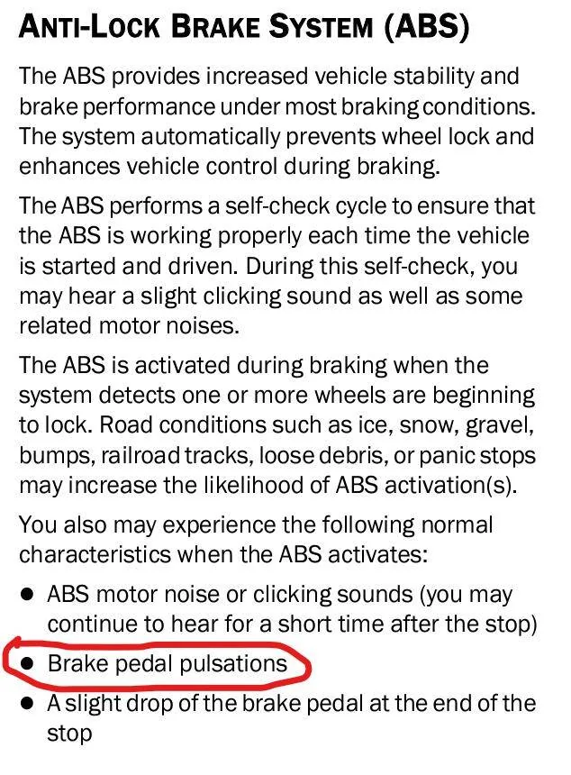

Like I said before, I jammed the pedal hard. The Jeep was beginning to slide sideways.
Yes, because you never engaged ABS. Jamming the pedal hard and staying on the pedal hard until you feel the pedal pulsating means ABS kicked in. Anything else means no ABS. There’s no other explanation.

It's a common misconception that ABS stops skidding. A properly functioning ABS will not prevent sliding sideways, and you will still skid. You'll hear the tires screech, they just won't "lock-up" and stop rotating. If the wheels lock up you can't steer. As long as they are rotating a little you can still control the vehicle. They may only be rotating at 5mph while the vehicle is doing 60mph. As long as the wheels were still rotating ABS didn't need to do anything. With 37s they probably weren't locked so ABS had nothing to do. Stability control systems try to prevent the vehicle from spinning around. Not sure how effective stability control is on our big wallowing jeeps though. lol
