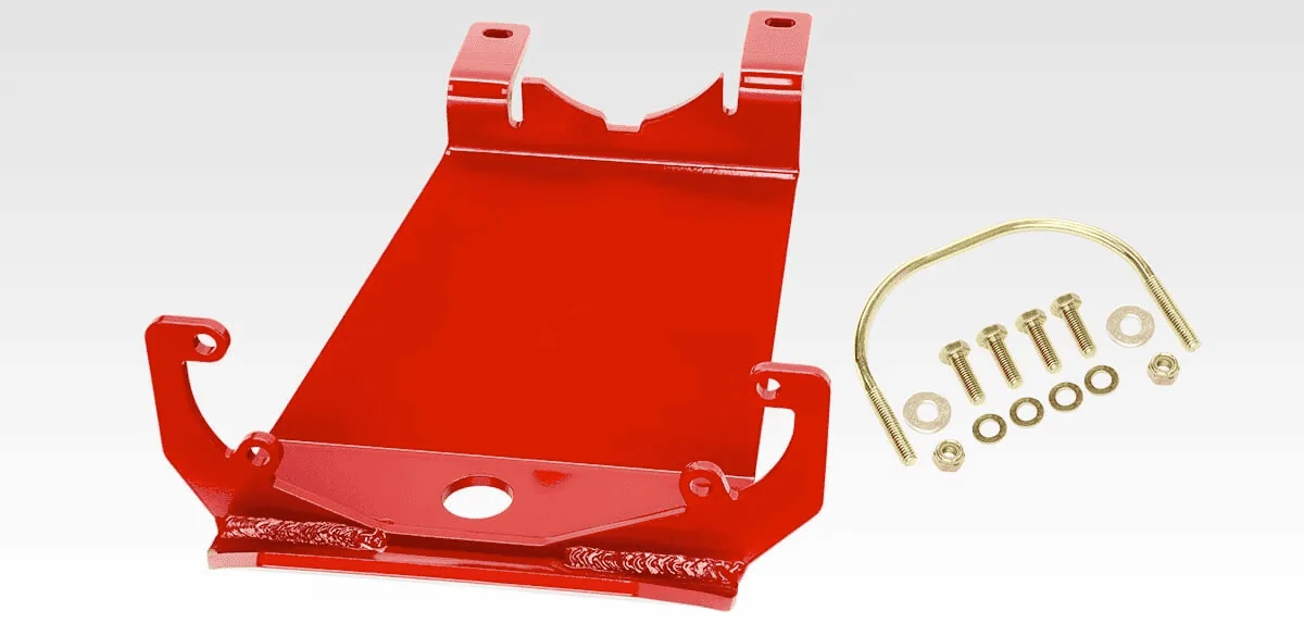

Using this on both our Jeeps with no problems. On my Jeep I have aftermarket Dana heavy duty covers so I needed to go to the hardware store and buy a long piece of threaded steel, sort of like a 2' long screw and I used it to shape a new, longer U bolt like the one they supply.
The Rancho appears to be one of few, if not the only one, that does not require you to also replace the front diff cover. That's the main thing I like about it.
https://www.northridge4x4.com/part/...ho-performance-front-diff-glide-plate-dana-44

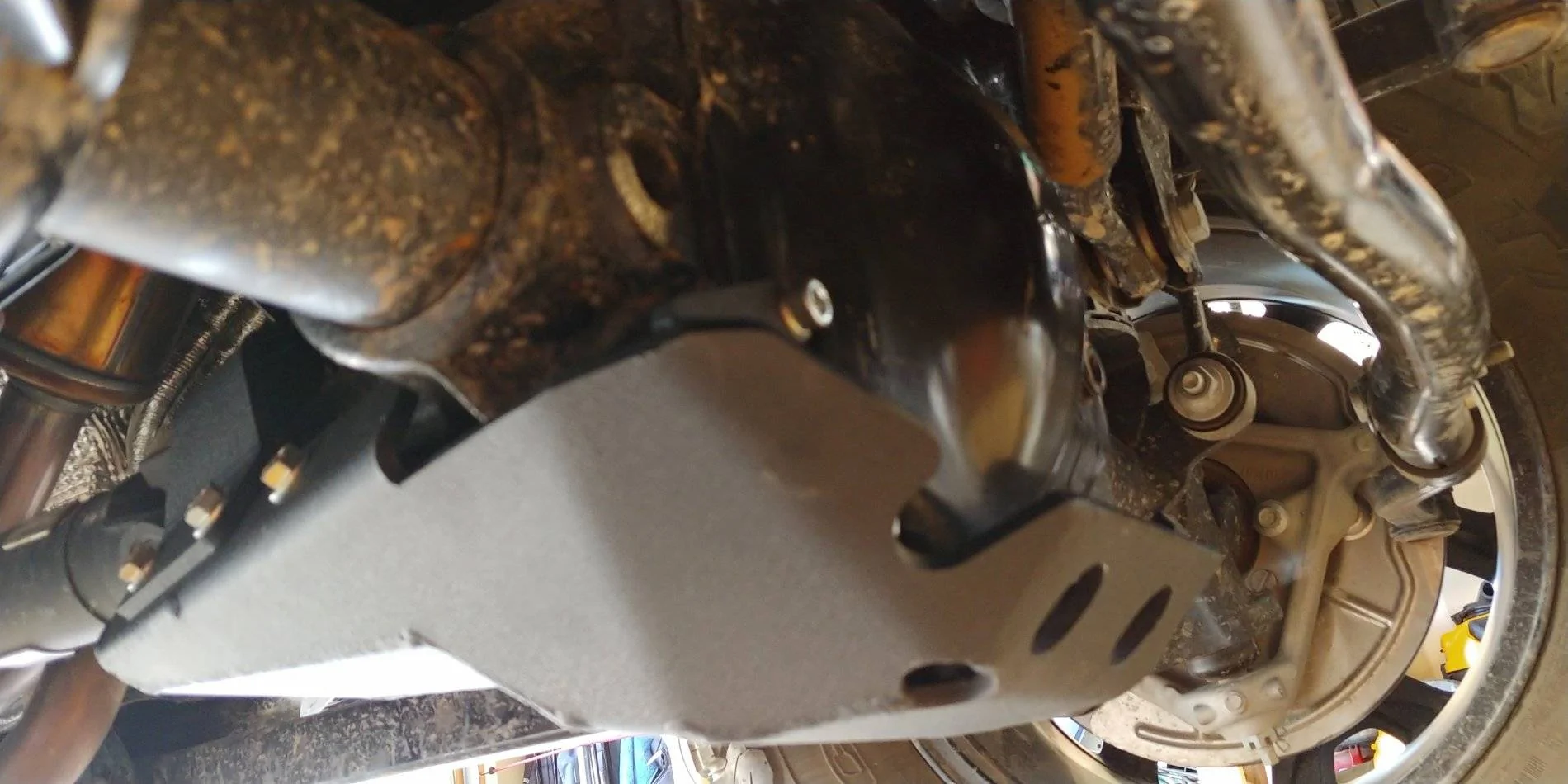

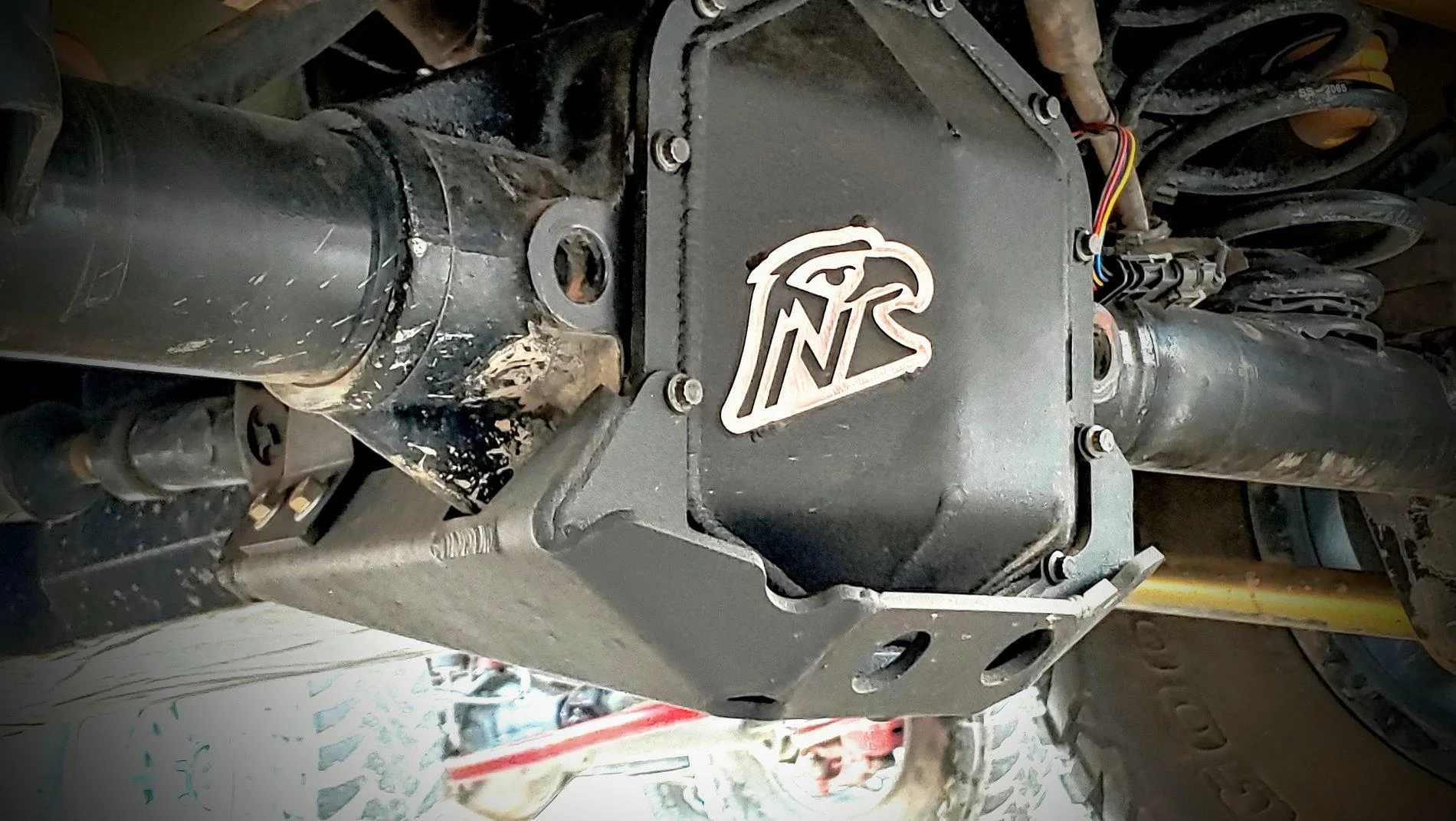

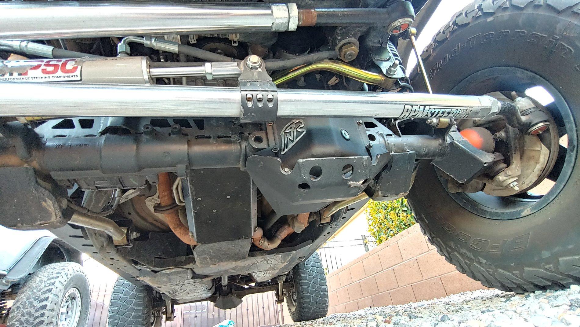

I'm using both front and rear diff skids from Next Venture Motorsports.

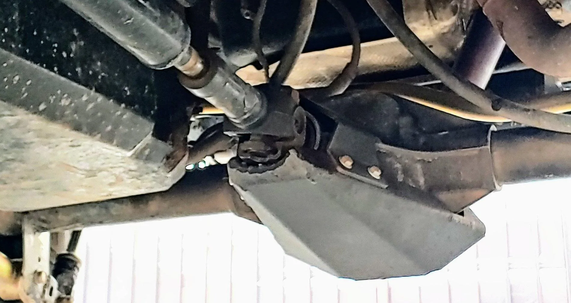

Another Next Venture Motorsports skid here with stock cover. Waiting for rear shim and I'll have there rear skid installed also.
