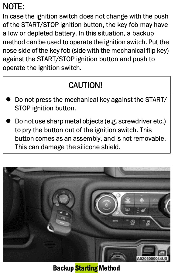

When my FOB battery died I got a FOB not detected when I tried to start the Jeep. Using the RFID end of the FOB against the start button the Jeep started. As a precaution against a dead FOB battery I carry a spare battery in each JL.

Should work. ?‍♂ Did you use the wrong side of the key?
I'm aware of this procedure. I assure you if you are setting on the side of the trail on a cold Utah morning this procedure will not work. I tried multiple times. It may have something to do with not being able to disengage the alarm system.
Maybe there is a related issue- you lock the vehicle with a functioning fob, come back and cannot unlock it with a non-functioning fob, cannot disengage the alarm even if you try to unlock the door with the metal key, the vehicle won't start when pushing the button with the fob. Maybe if I was able to unlock and disengage the alarm system it would have started with this procedure. This is kind of a catch-22.

Somehow I stumbled on a circumstance where it doesn't work.
It would be interesting if someone wanted to replicate my situation and duplicate this behavior- get in the vehicle, lock it with the fob, take the battery out of the fob, see if you can start the vehicle.
If you can stand the noise- get in the vehicle, lock the vehicle with the fob, take the battery out of the fob, open the door, get back in, try to start with the fob.
If none of this works you would have to put the battery back in the fob or have someone standing by outside the vehicle, far away from the vehicle, with another fob.
