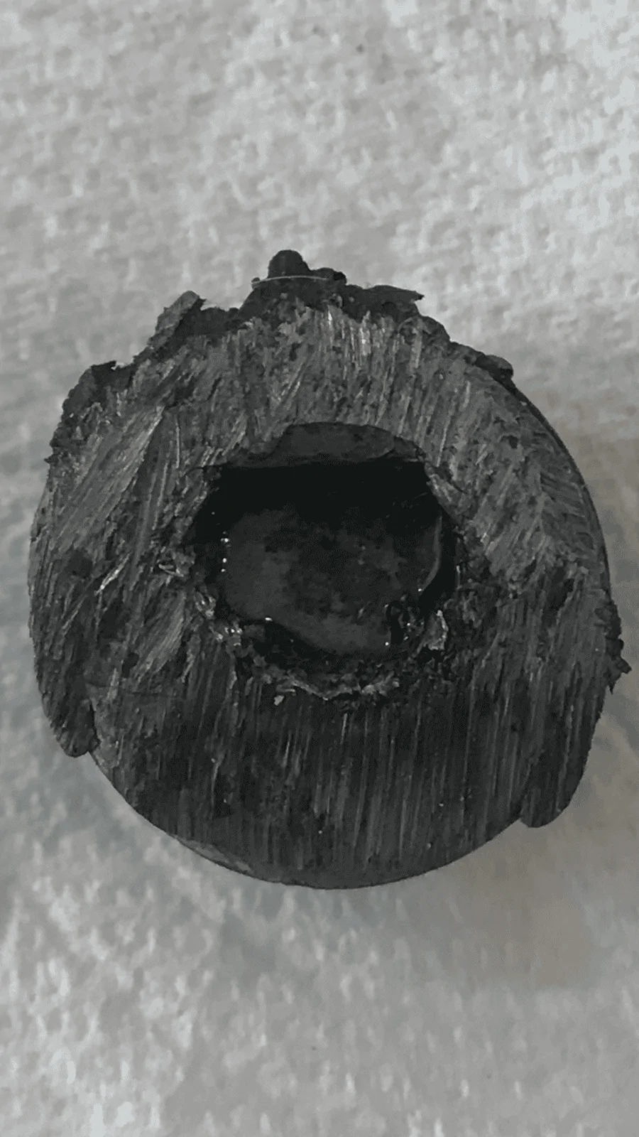

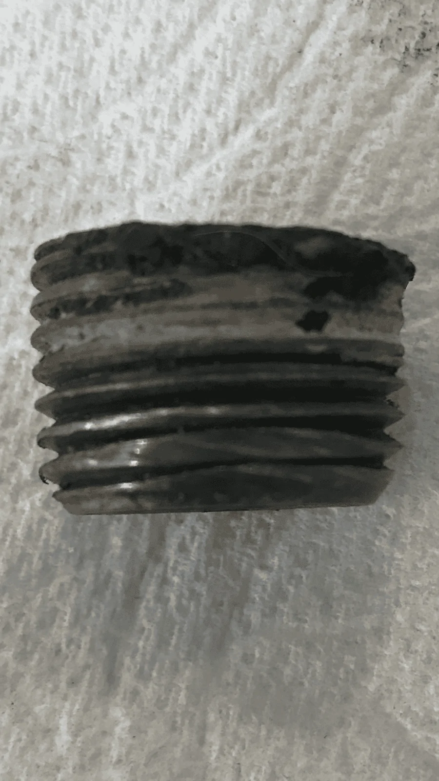

I damaged my drain plug yesterday and found your post through google search, if you don't have a diff skid get one right away! The front diff drain plug on the Rubi axle (I can't speak to non-rubi axles) is definitely a bad design. I got lucky and didn't rip it out all the way, but it did grind the plug down on rocks which damaged the threads on the plug and housing. Like the original poster I had no idea i did it at the time, I noticed a puddle of diff fluid under the Jeep this morning.
Here is a picture of the damaged plug and damaged threads on the plug. The diff housing threads were buggered up too.

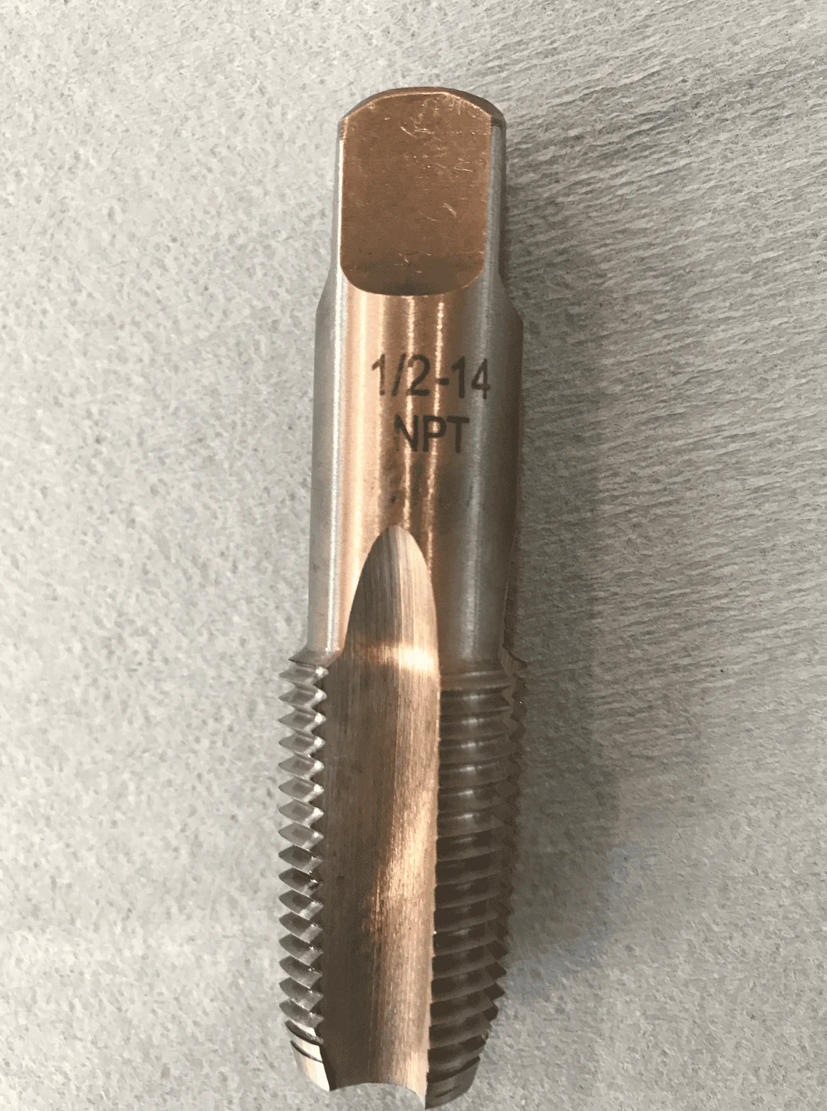

I was able to carefuly re-tap the diff housing and tested the repair with the drain pug out of the rear axle (need to hit the dealership up for a new plug tomorrow. These plugs are tapered, you need to use a NPT 1/2-14 NPT tap, even though the bolt is way bigger than 1/2". NPT taps measure different then standard taps, someone with plumbing experience can probably explain why. I found a tap set at Harbor Freight theat worked and saved my housing. Soooo Happy! If this didn't work I was going to someone TIG weld the hole.
Hopefully this helps someone else, but if you read this first, do yourself a favor and get a skid before hitting the trails.

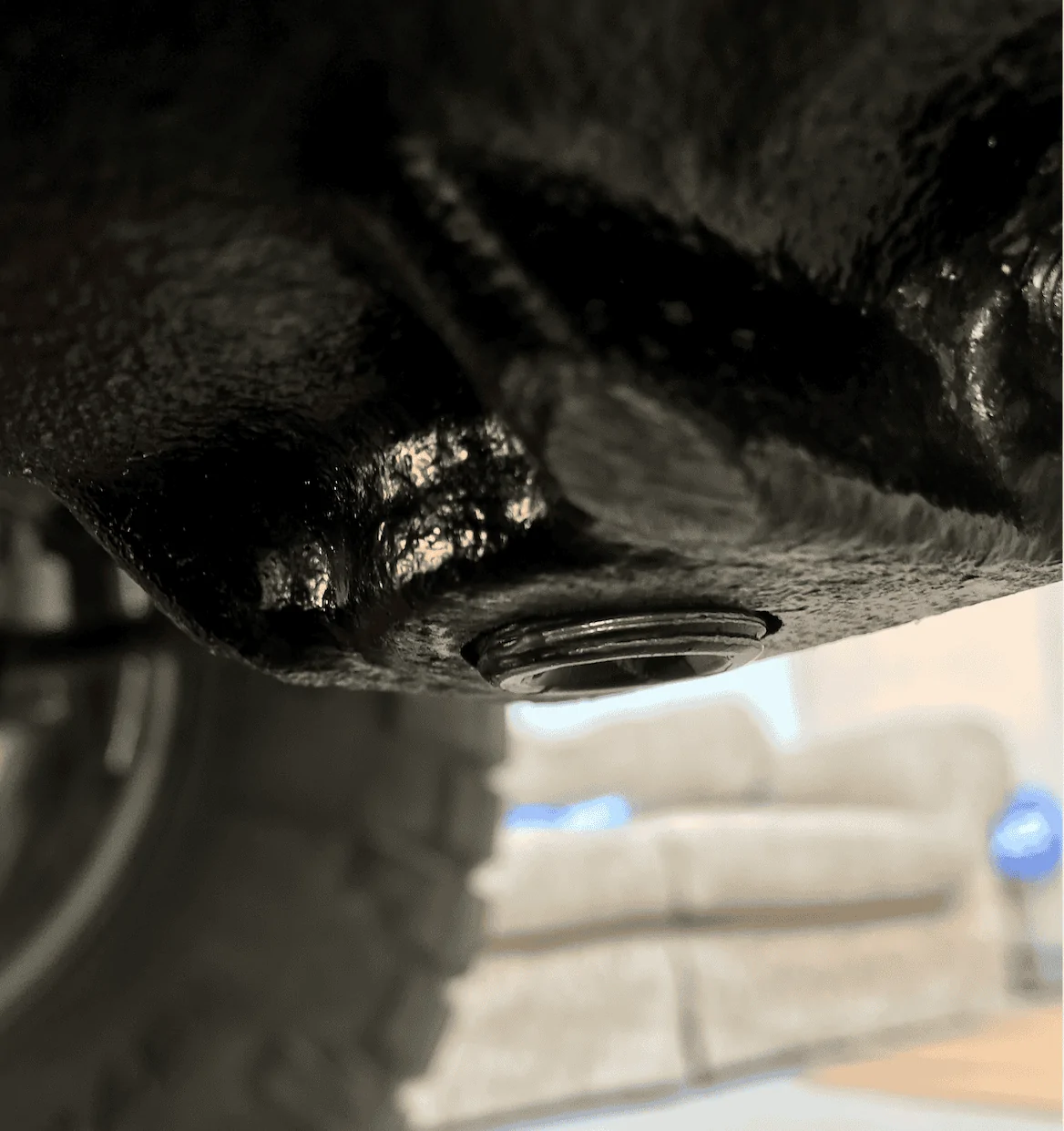

One more picture to show why this is drain plug is so vulnerable, here is a picture of it screwed all the way in. Because it is NPT tapered fitting it stops (at least on my diff) with still about a 1/6" of an inch hanging down, if it was flush you might be okay, but I still wouldn't trust it if you play in the rocks.
