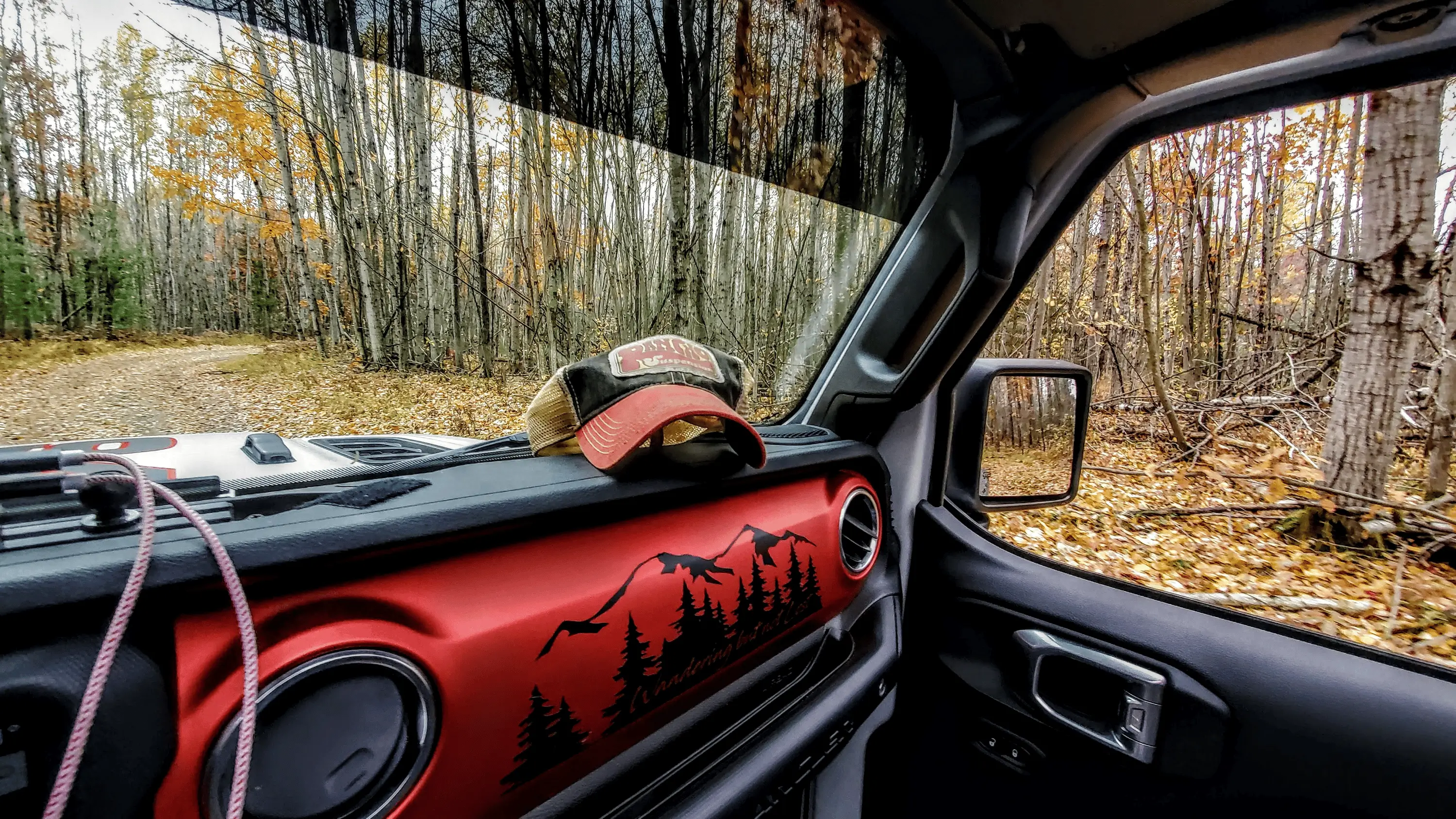

I hardly ever use the sun visor. One of the best mods I did was have the top 5 inches of the windshield tinted. It is great, harsh sun tilt my head up a little, bright lights on from other drivers, no problem tilt my head up a little. It was like $40 to get it done at a local shop. Normal driving, I look under the tint and a slight tilt of the head put me looking through the tint. At first when I drove out of the shop I was not crazy about it. In a day or so, I started to love it. Now there is no way that I would not have my Jeep windshield with out it. Truly a game changer cheap mod.
That is an interesting idea, Wibornz! I've seen those kind of top-of-the-windshield tintings before, but never one quite as wide (tall?) as yours there. I like the idea, though!
I do have to wonder if having that wide a tint strip on the windshield might goad some cop or state trooper into giving a ticket for it, though, as windshields are never supposed to have aftermarket tinting on them (which didn't stop me from already having mine tinted to 70% transmittance, LOL).
