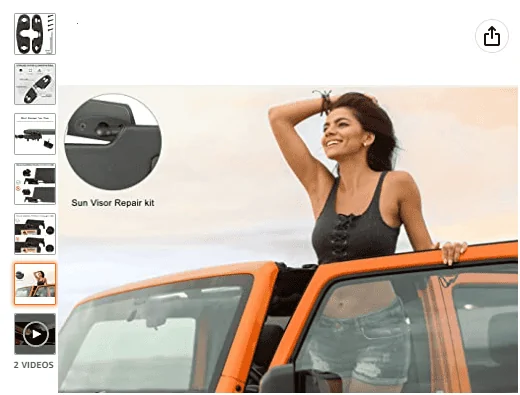

I guess they're right.... sex sells. How does this lady have anything to do with the visor??
Jeep Wrangler JL Sun Visor Issues? 1677701900843
I mean, if she comes WITH the product, I'd buy it for sure!
