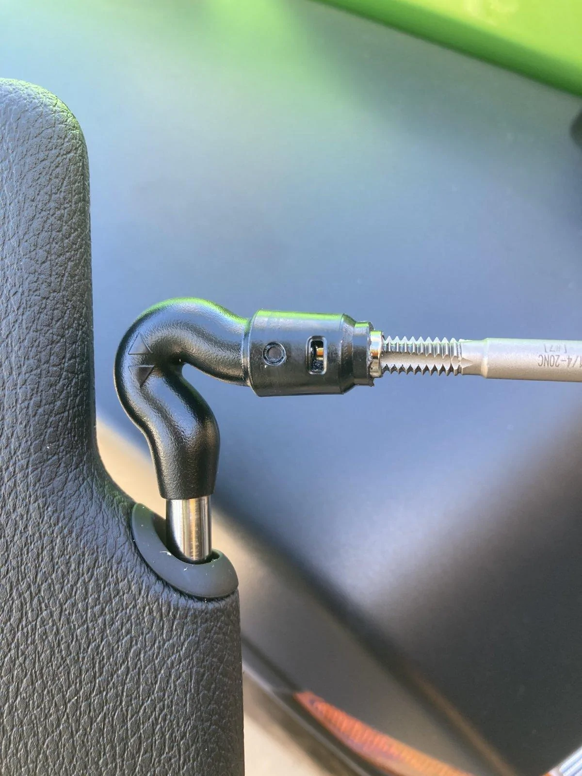

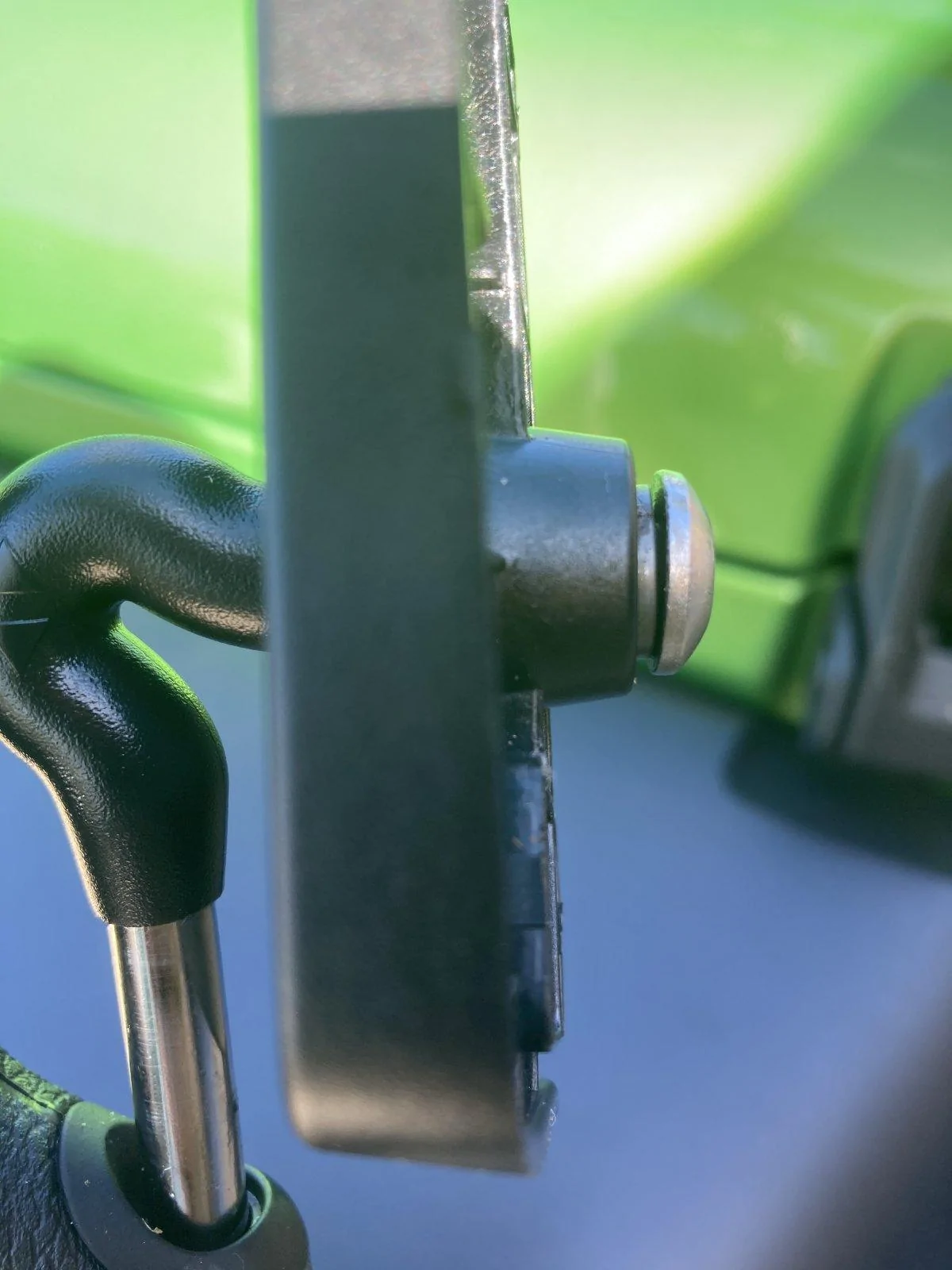

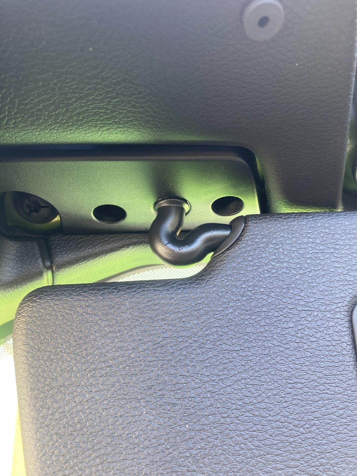

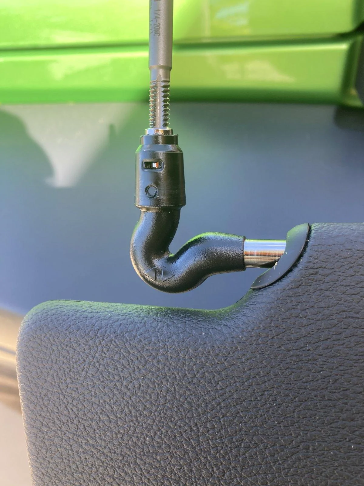

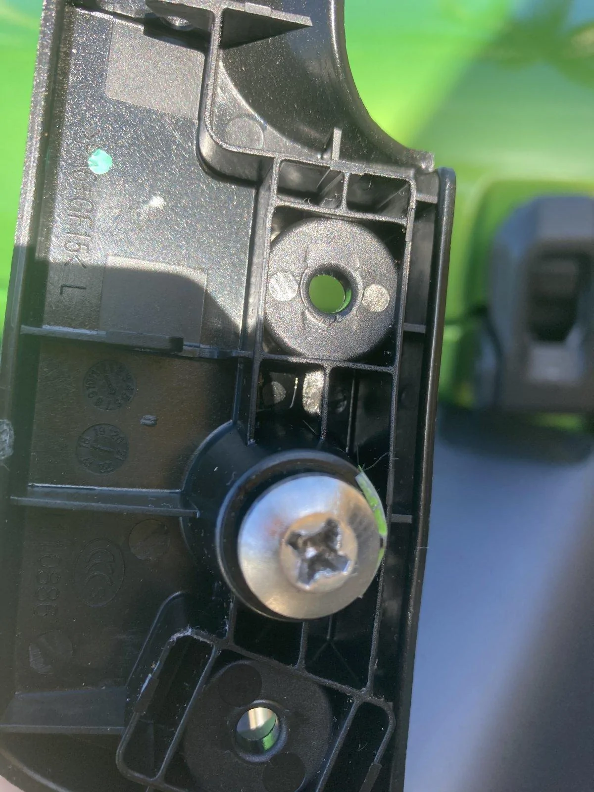

I’m sure I’m not the only person who fixed there sun visor. Probably still under warranty but fixed myself it’s EZ all you need is a 1/4-20 tap , remove the two torx screws that hold up the visor, after tapping the visor use a low profile button head bolt/screw. Better than new...! My wife can’t break it off now when she gets out gym...! I posted some pictures.This is base model fix. If you have wires going through it probably won’t work. Good luck 🍀

Thank you so much for the post, this is so far the best solution!!! For other folks who might want to try this method, the size of the bolt is 1/4-20 x 3/4'', I also added a washer to make it more secure.

THANKS SO MUCH!!! This was easy to do and beats the endless wait for backordered replacement visors from the dealership even if they are free under warranty.

Great. This looks much simpler than some of the other self-fixes I've seen. Nicely done.
