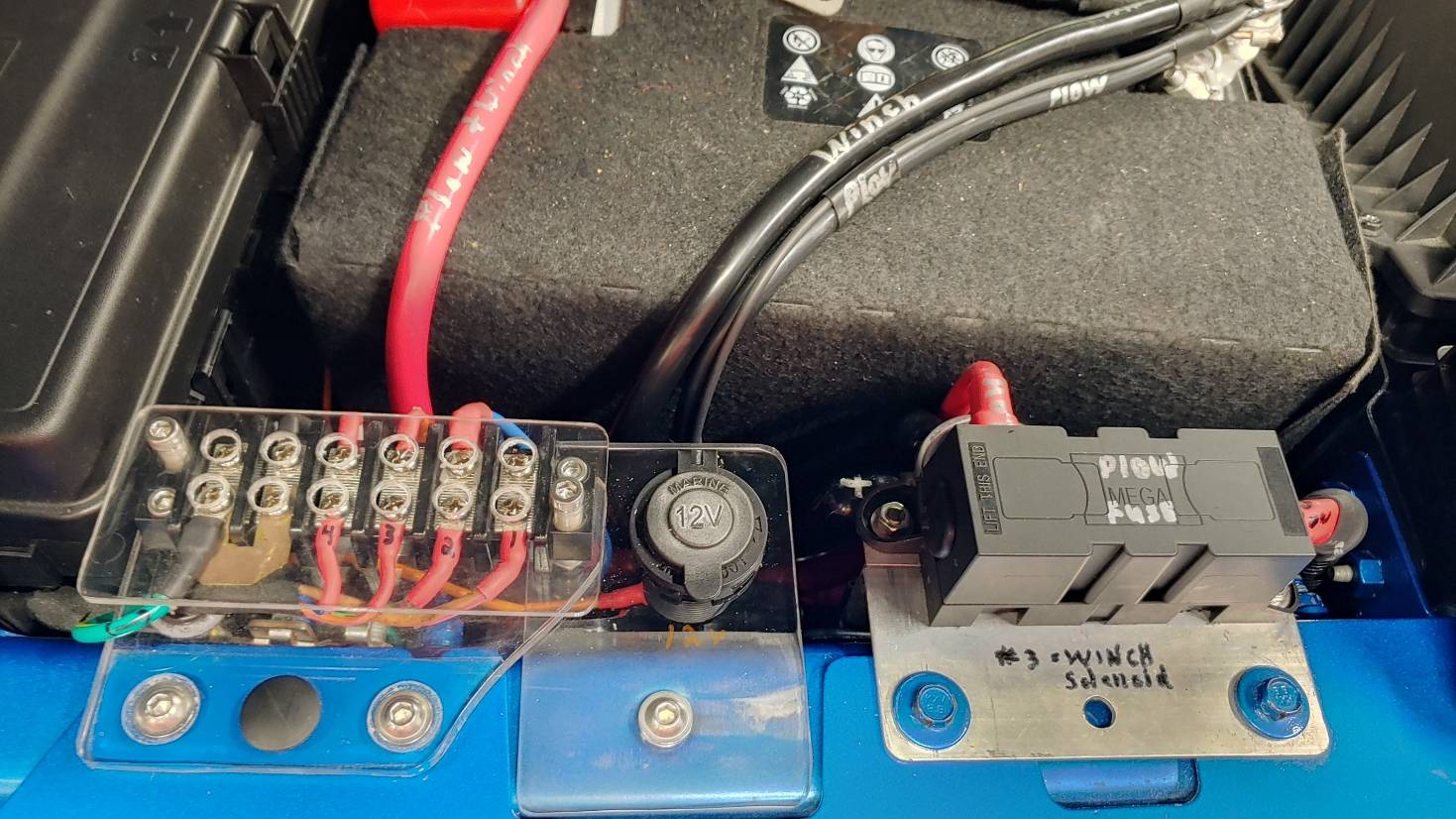

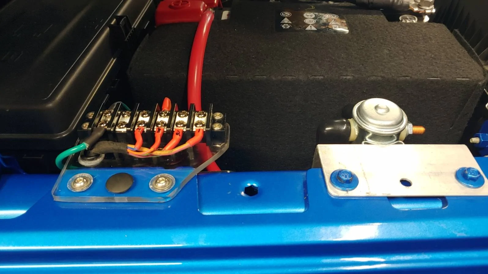

Make your own terminal block for $10-$15. Get the terminal strip at Menards for about 7 bucks then make a mount for it.
Jeep Wrangler JL A basic wiring question... 20220720_145333
Jeep Wrangler JL A basic wiring question... 20220730_140937_HDR
I added a 12v outlet under the hood for a convenient place to plug in a Christmas wreath.
Jeep Wrangler JL A basic wiring question... 20221121_140955_HDR
Jeep Wrangler JL A basic wiring question... 20221109_160600_HDR
I always use marine type heat shrink. It has a glue in it that melts and seals the wires. Hey, Jeeps are for bad places and bad weather........
I use open barrel crimp connectors and the proper crimping tools for each.
When I join wires, I strip the ends, slide the heat shrink on, then joint the bare ends with a Western Union physical connection and then solder the joint, then heat shrink.
I made my terminal strip and bracket so I could very easily move things around, add or subtract things, whatever. I added the acrylic top to prevent anything from touching the terminals or screws. I can use a screwdriver to access the screws without removing the cover. You can lay things on it and nothing can touch the terminal strip or connections. Easy to disconnect something for troubleshooting if necessary. Have a problem? Loosen screw, remove that wire easily for testing. Can use a volt meter probe on the screws in case something isn't working and I want to check that it's got power.

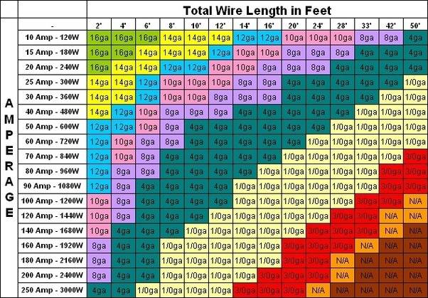

The wire gauge you use for your lights will depend on the amps they will draw. I always use 14 volts as the voltage as when running things are never "just 12 volts".
If you know the wattage of the lights, divide that by 14 and you'll get the amperage. Then look up what gauge wire you need for xx amps.

14AWG is fine for this application. Be careful on long runs with 12v as voltage drop happens quick. Best practice is to check a voltage drop chart for 12v before running a new circuit.

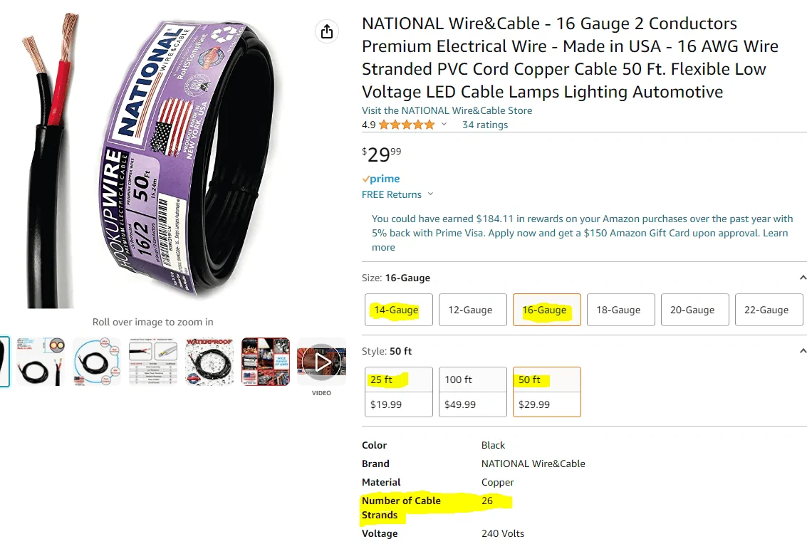

CCA (Copper Clad Aluminum) is also problematic if you want to solder it.... stick to either Pure Copper... or Tinned Copper ....
Also.. the more strands (cores) the wire has.. the more flexible... but it also reduces the current capacity..
Jeep Wrangler JL A basic wiring question... 1684168791651
I also think 14 AWG is a bit overkill for your application.. you should be fine with 16 AWG... like this one
