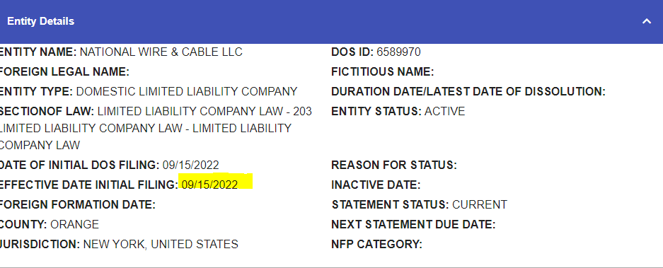

Interestingly there is a National Wire and Cable that produces US made wire, but they're in LA: https://www.nationalwire.com/index.php
Last year, looks like Remee Wire and Cable set up an LLC for National Wire and Cable in NY (same corporate address).
Jeep Wrangler JL A basic wiring question... 1684184477862
Per Remee's site, they've been manufacturing in NY since 1972, which matches the labeling.
https://remee.com/remee-wire-cable-profile/
They are in a city called "Florida, NY" which is why I assume they leave the city off.

I saw the LA location online as well, but I didn't dig any further. Looks like it might be legit... which creates a whole other conundrum.
