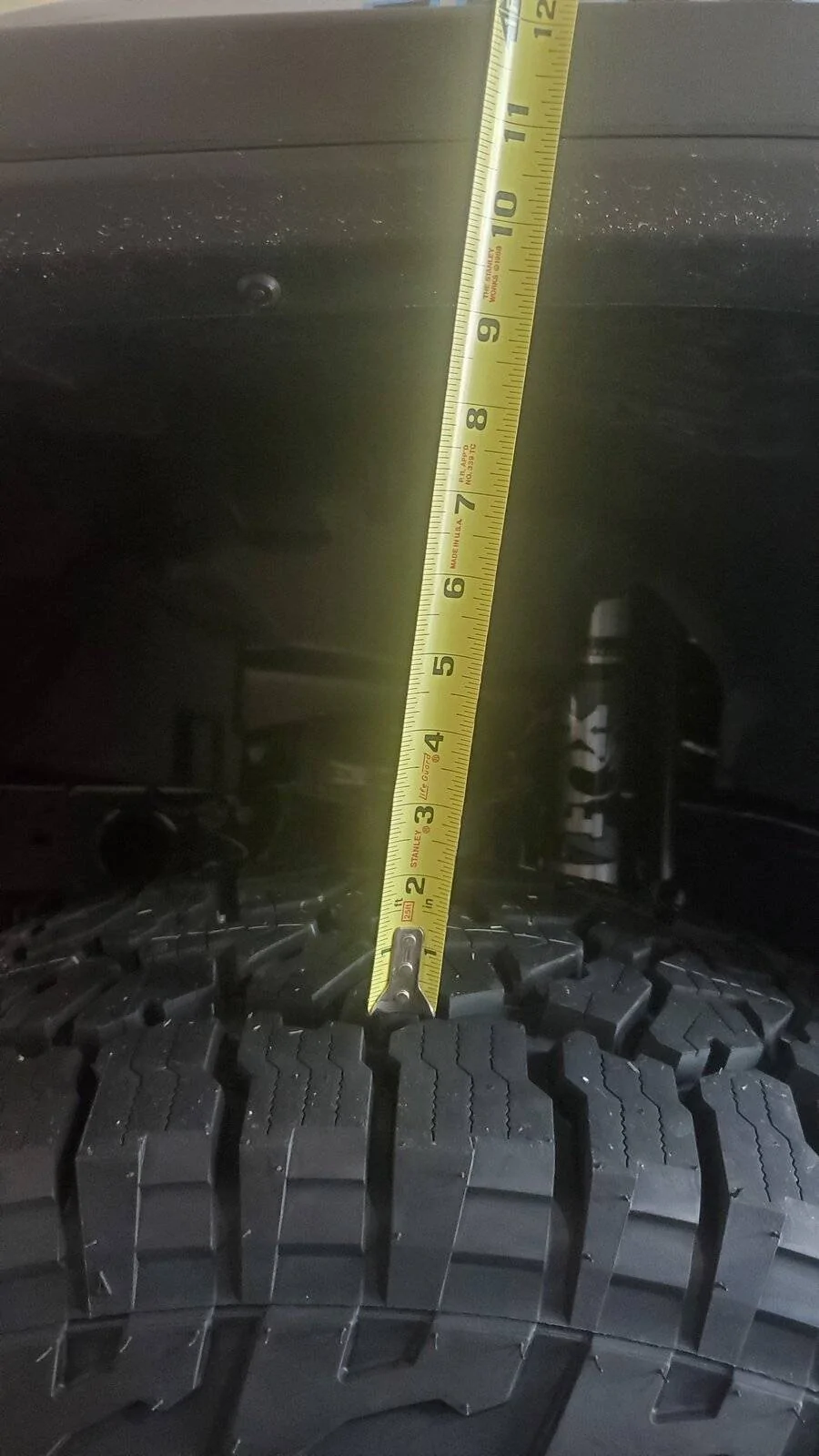

I confirmed today that the 4xe (confirmed at least for Rubicon) does indeed sit approx 1" higher from the factory. I went to my local dealer (not where I got my 4xe from) who has numerous (and most of them green, lol) JLURs on their lot. They all measure ~23" at the lower part, and ~23.5" at the arrow in my previous pic. There were two 4xe Rubicons on their lot both customer orders, and one was in the service bay getting prep'd for delivery. They measured ~24" / ~24.5" respectively at those two points above, just like yours above. The wandering salesman who was interested in why I had a tape measure in my hand said that they had already determined that the 4xe sits higher the first time they parked a customer's 4xe delivery next to another customer's regular JLUR delivery, and since that it's become "common knowledge".
Went to my dealership today and while I was there, measured at least 4 JLUR 4xe w/ stock bumpers and tires (ko2). Noticed an interesting trend; all the fronts measured 1/2 inch taller than the rears. They were consistently 24.5" (front) and 24" (rear) - measured to the same spot on the fender. This makes sense due to the placement of the battery on the 4xe. So this begs the question of whether it makes sense to swap the spacers of the spacer lift kits and put the taller spacer in the rear....especially for overlanders and car campers who will mostly be adding weight to the rear of the Jeep. Where might I be going wrong with this line of thought?
