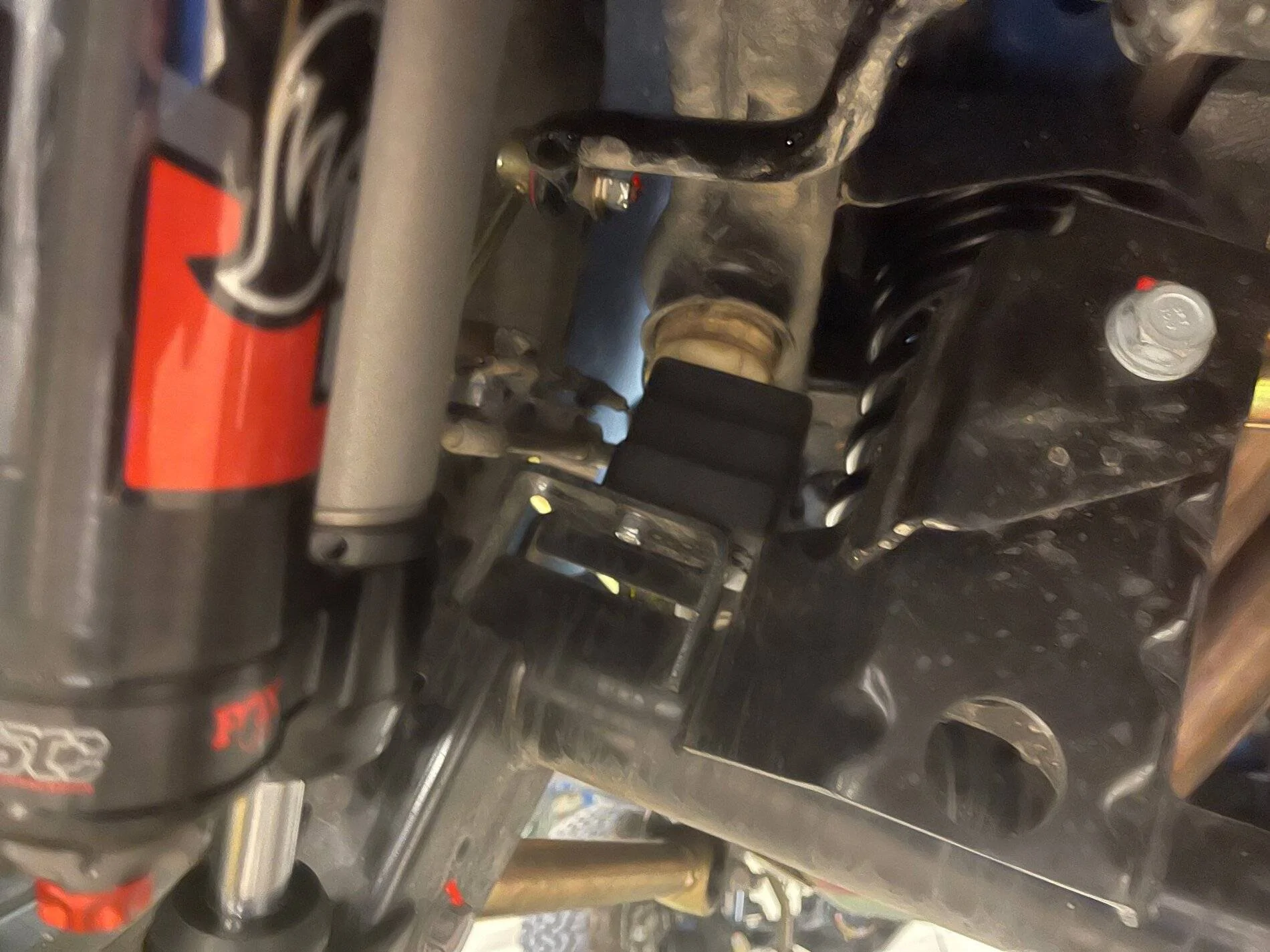

Weird. My installer said the bump stop pucks weren't needed, front or rear.
What shocks, wheels and tires are you running? All variables that could influence the number of stops installed. Also, any mods to your fender well or any wheel spacers? What Back Spacing do you have on your wheels?

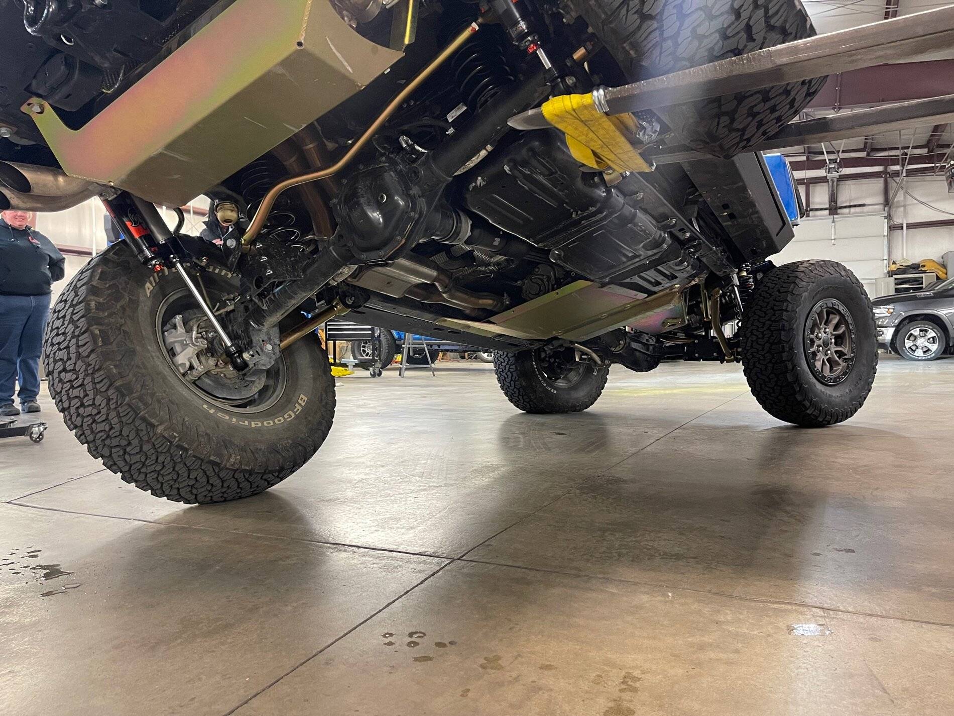

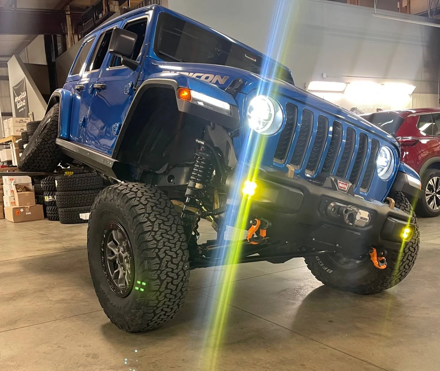

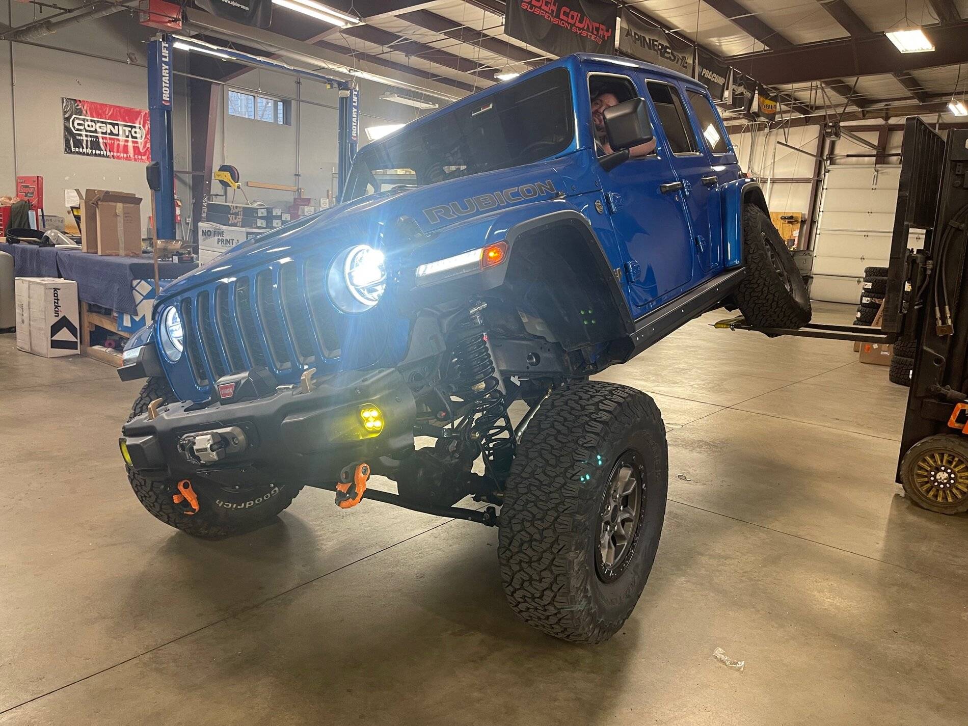

More pictures from the shop showing the lift flexing with a few close ups of the springs and shocks.
John, that has to be the most thorough description of parts, specs, results (with pics and vids included no less) of any lift install I've ever seen! Wow, thanks for all of this!
