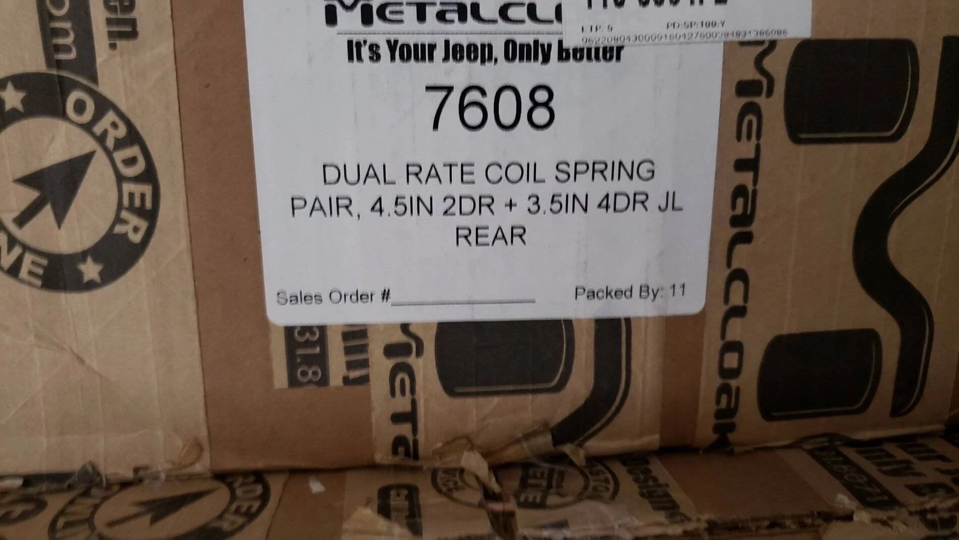

Talked to the guys at MC....for the 392 game changer 3.5" lift, they found out that the front dual rate springs for a 3.5" 4 door JK lift works. For the rear, they use a dual rate 3.5" lift spring for a JL. I went with Fox 2.5 DSC shocks for a 4.5-6" lift (per MC) and had them tuned by Accutune. Metal Cloak says that their 3.5" lift will add about 2.5" more than the OEM lift, so at least 3.5" total lift....

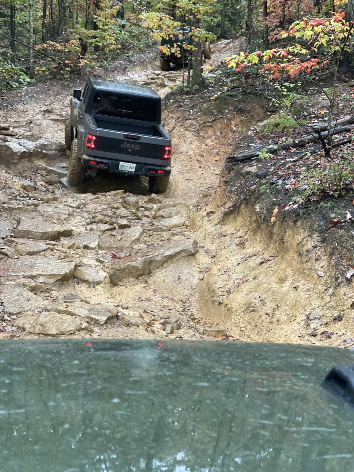

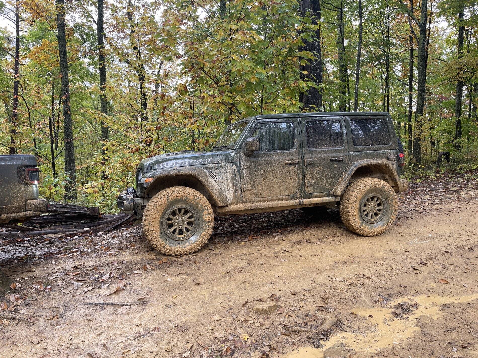

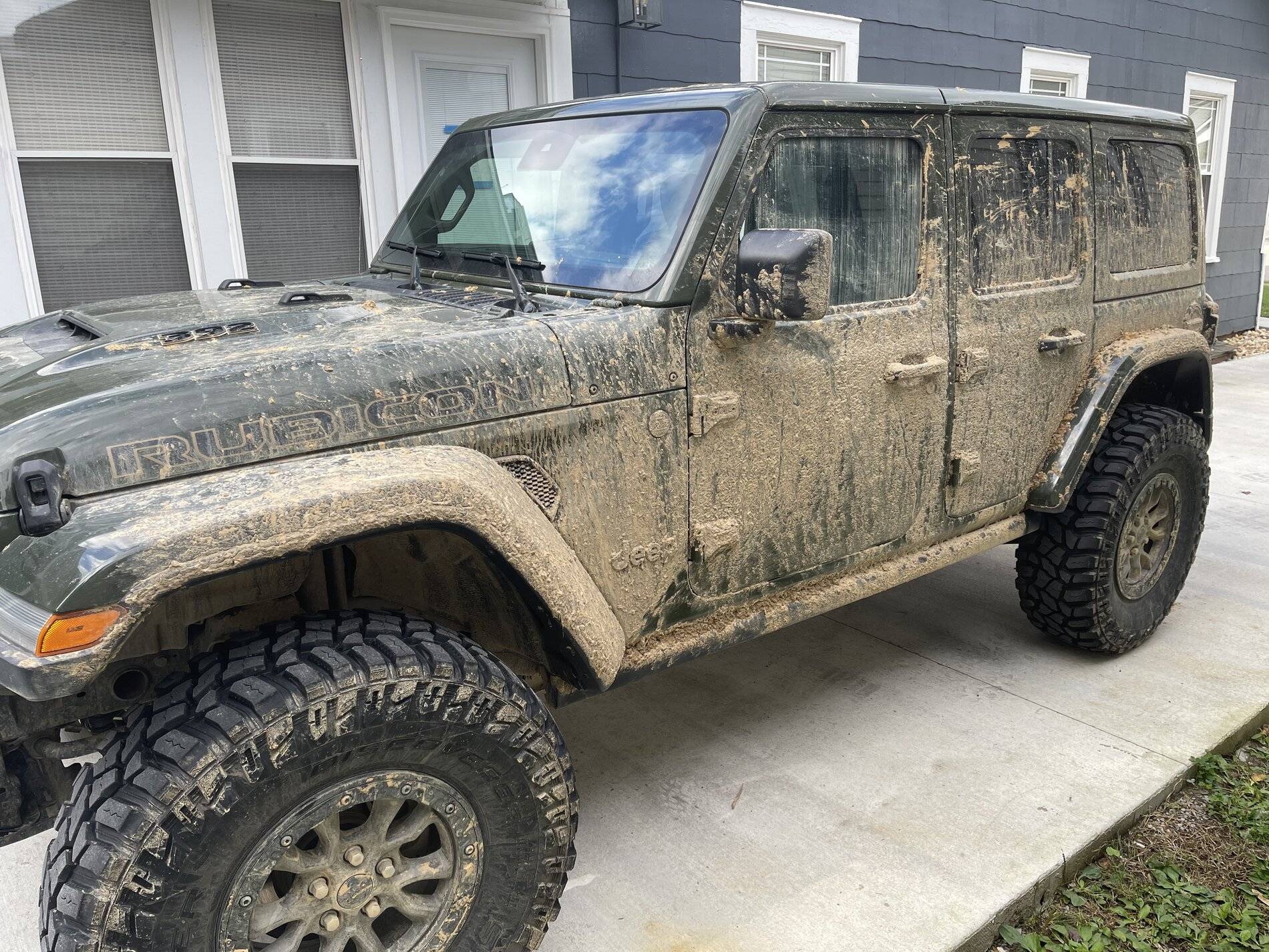

I’m running the 3/4 inch spacers from Fishbone Offroad along with 2 inches of rear bump stump extensions and Teraflex Falcon Performance bump stops.
This is enough to not rub with 37s Offroad. I just tested this set up at Windrock last weekend and finished trails 26 and 16 with no major problems!
I have no need to go bigger until I go to 40s so I’m saving my piggies for a good long arm kit and 1 ton axles.

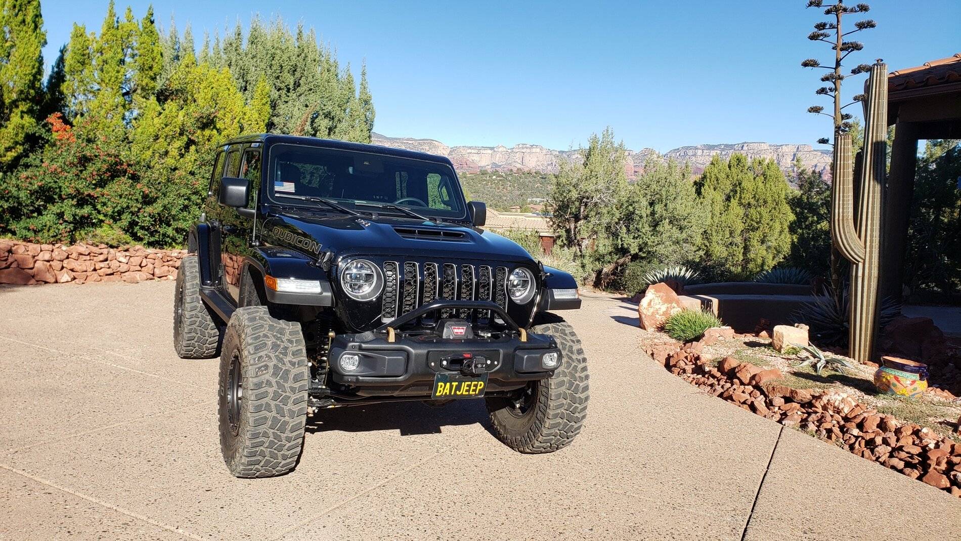

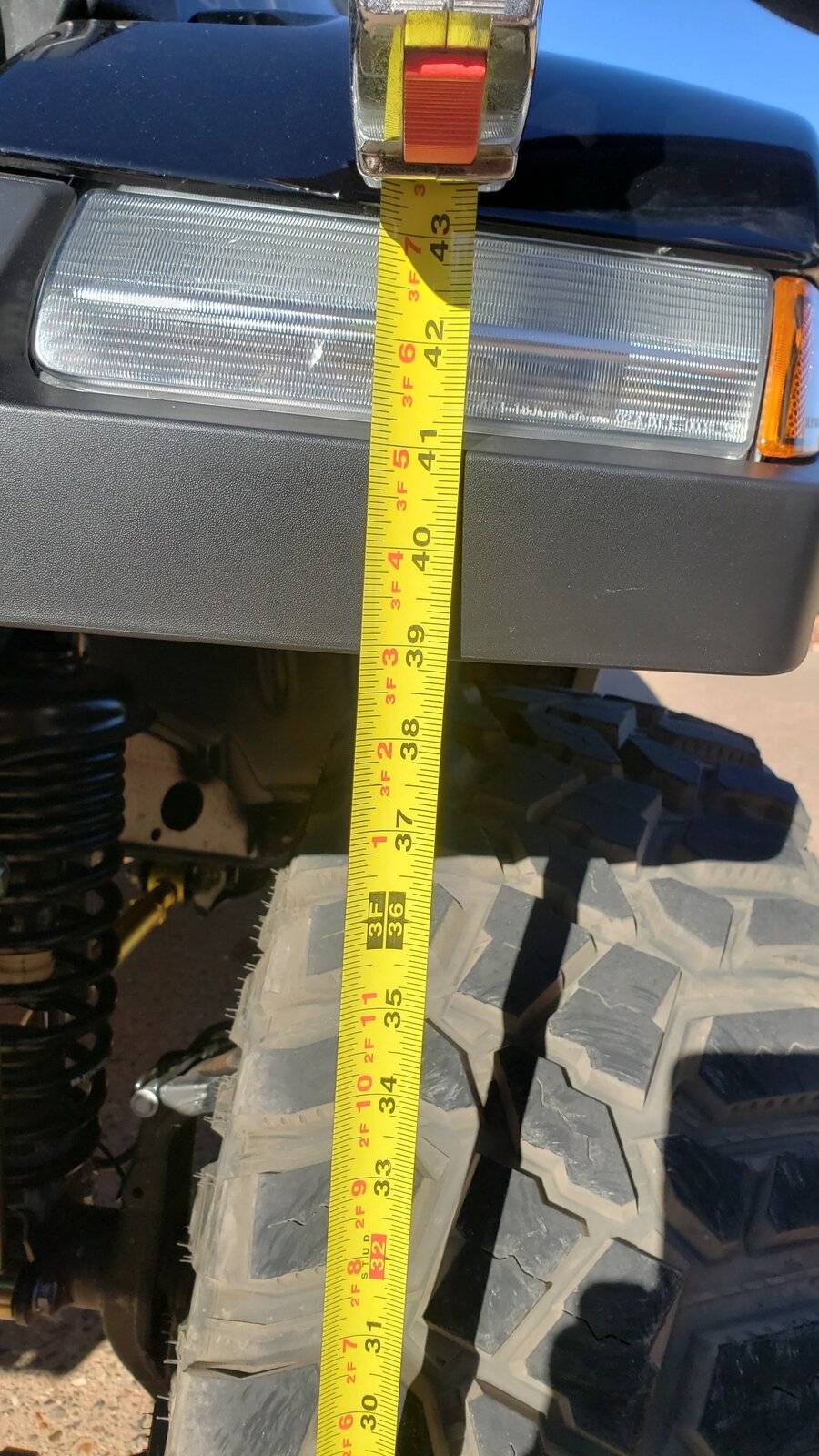

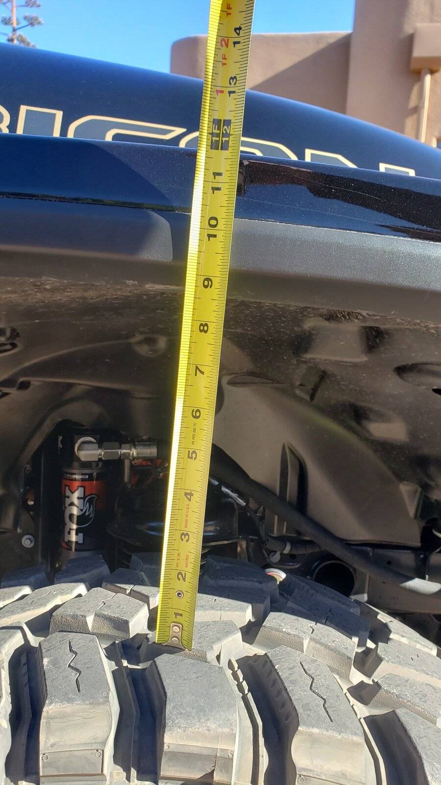

Here are some measurements pre and post install of a MC 392 game changer dual rate lift. The shocks are Fox 2.5 DSC (052/056), further tuned by Accutune. With the shocks dialed all the way CC (both high and low speed), IMO, it rides just like stock. From there, you can dial them for any on or off-road conditions....fantastic. Some measurements: pre: bottom of rear receiver 20.5", post 24". Gained about 3 1/2" overall.
