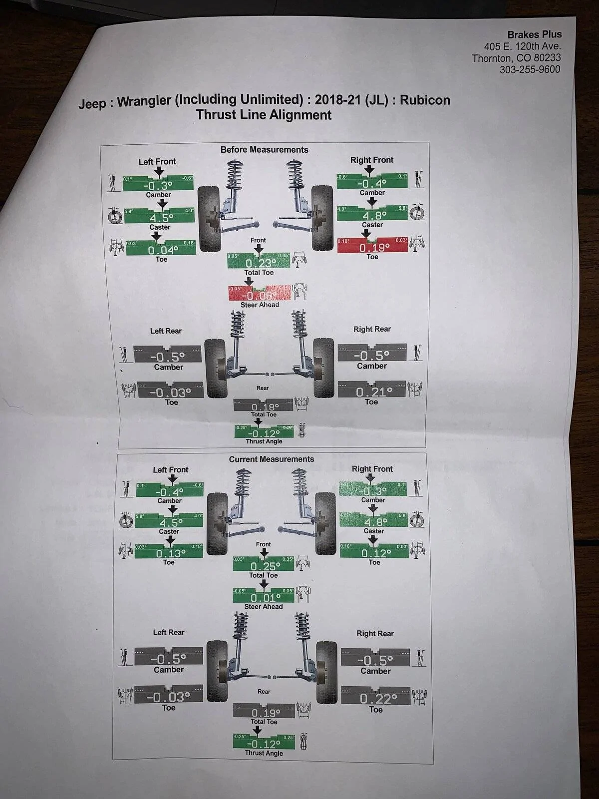

Here is the pre-lift OEM suspension alignment report:

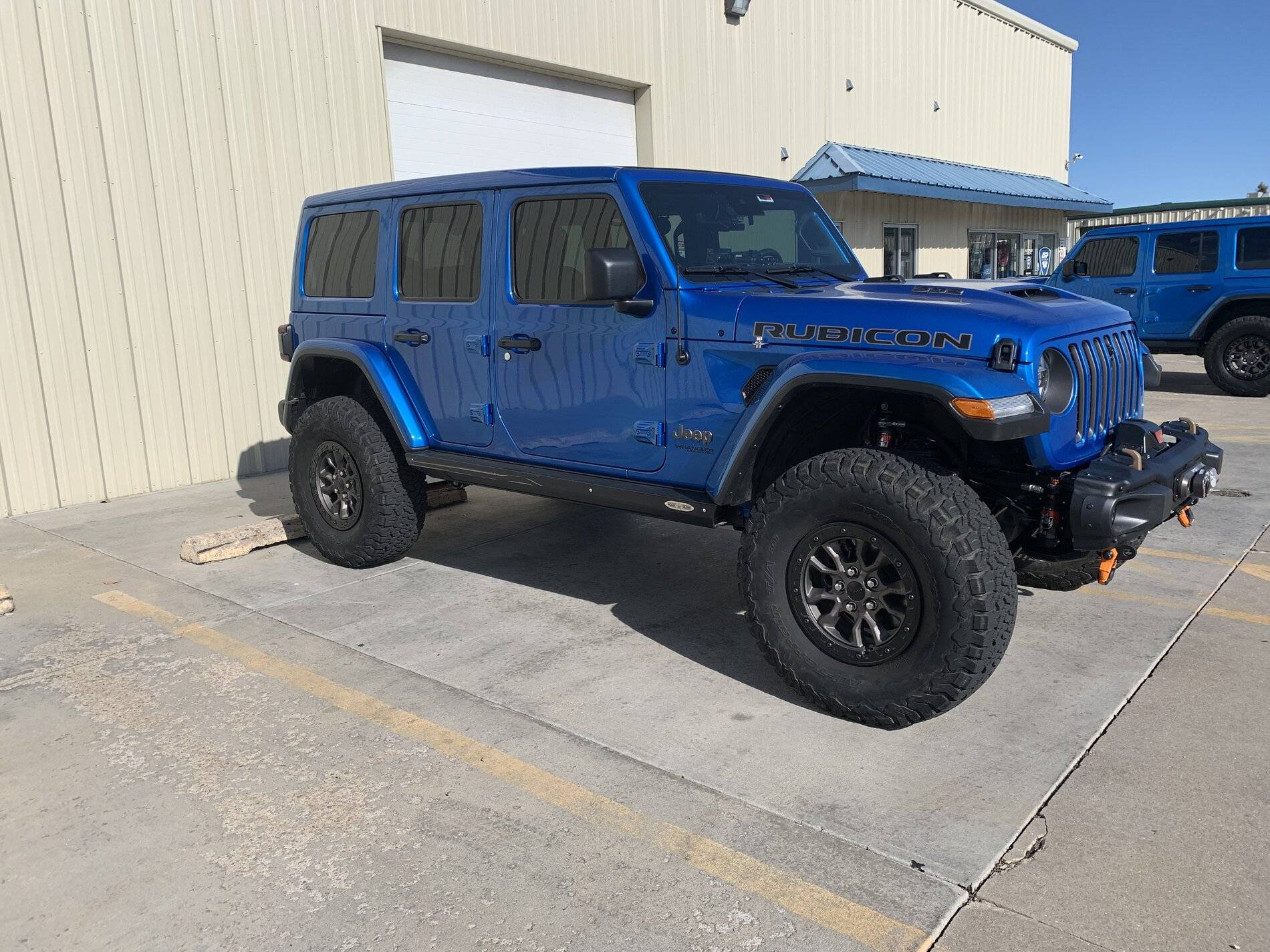

Here are some pics of the stance and components added.

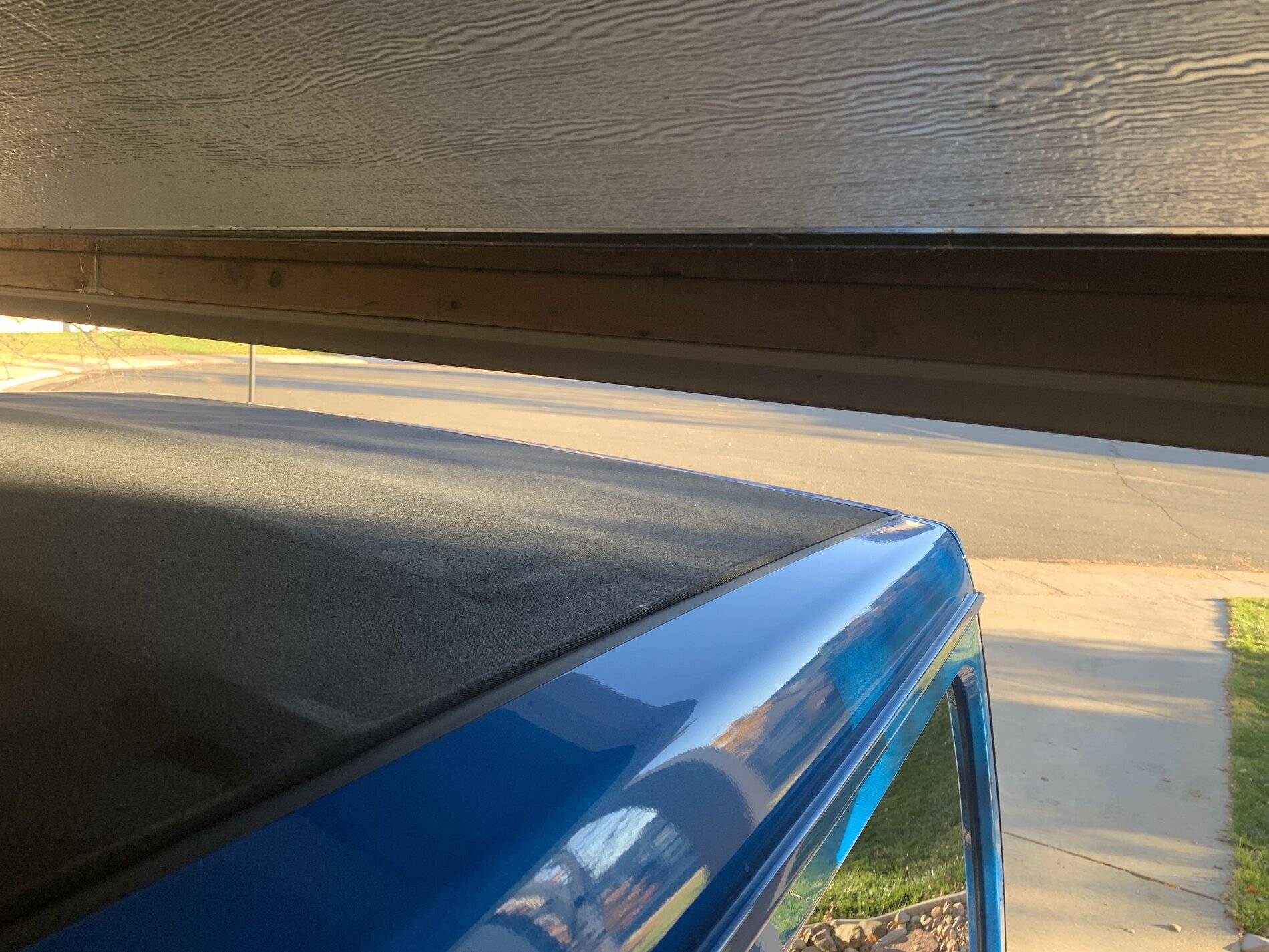

I still have plenty of head room between the top of the Jeep and the standard height garage in case anybody is wondering, maybe 4" or so

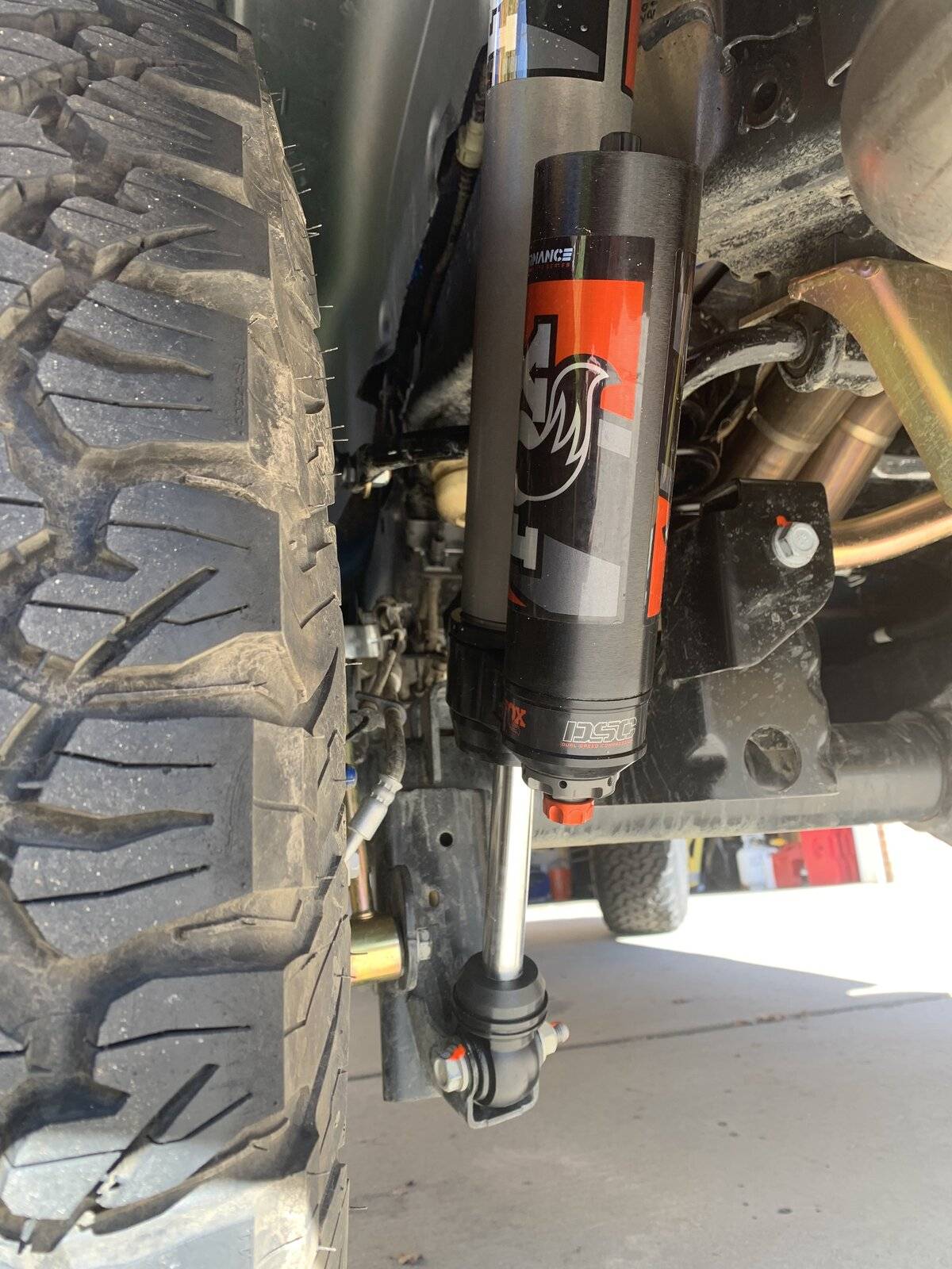

More pictures from the shop showing the lift flexing with a few close ups of the springs and shocks.
