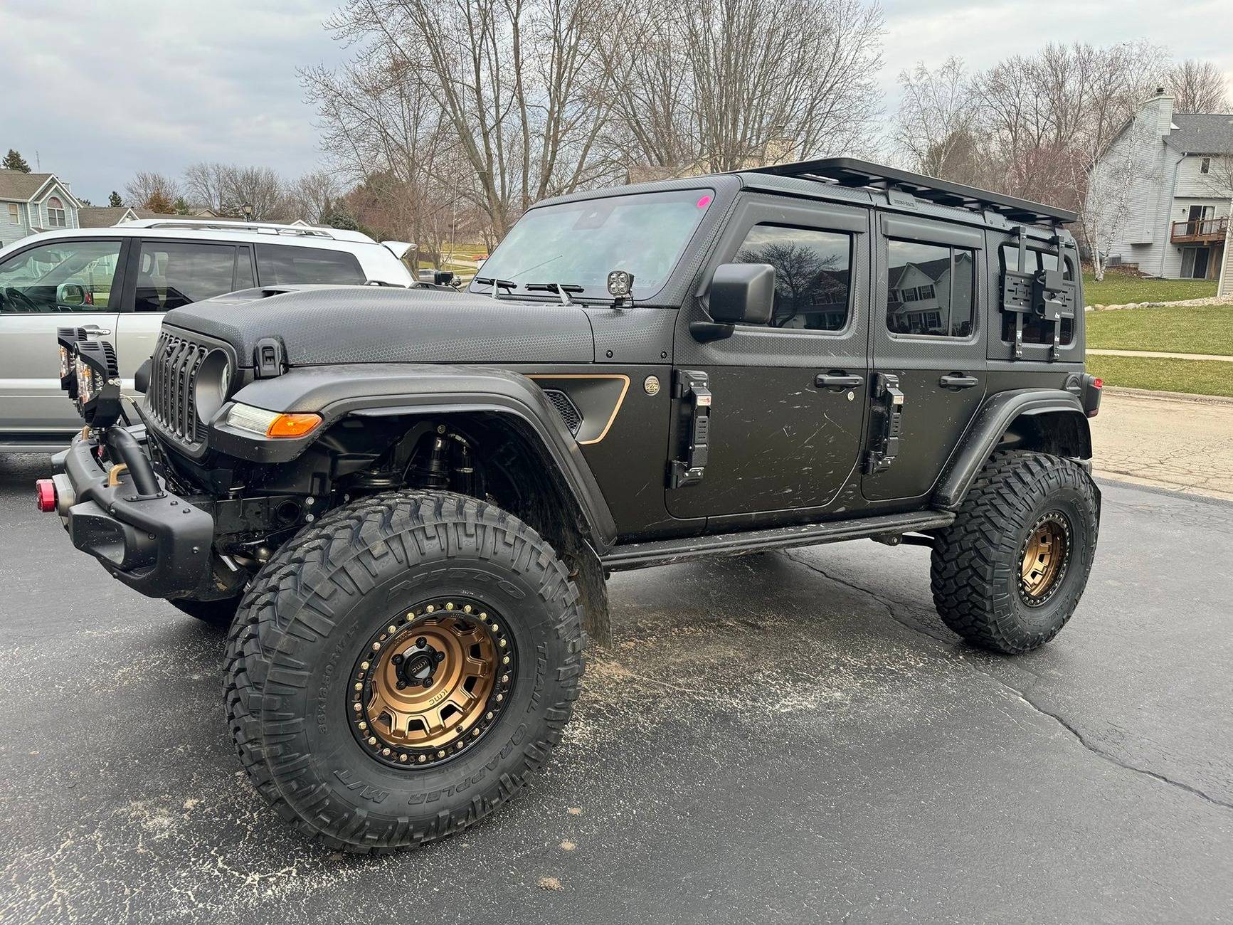

Nice!
I have had very very good experience with Avery wraps. not these though.
Had my Ford wrapped 3 different times with em. lol

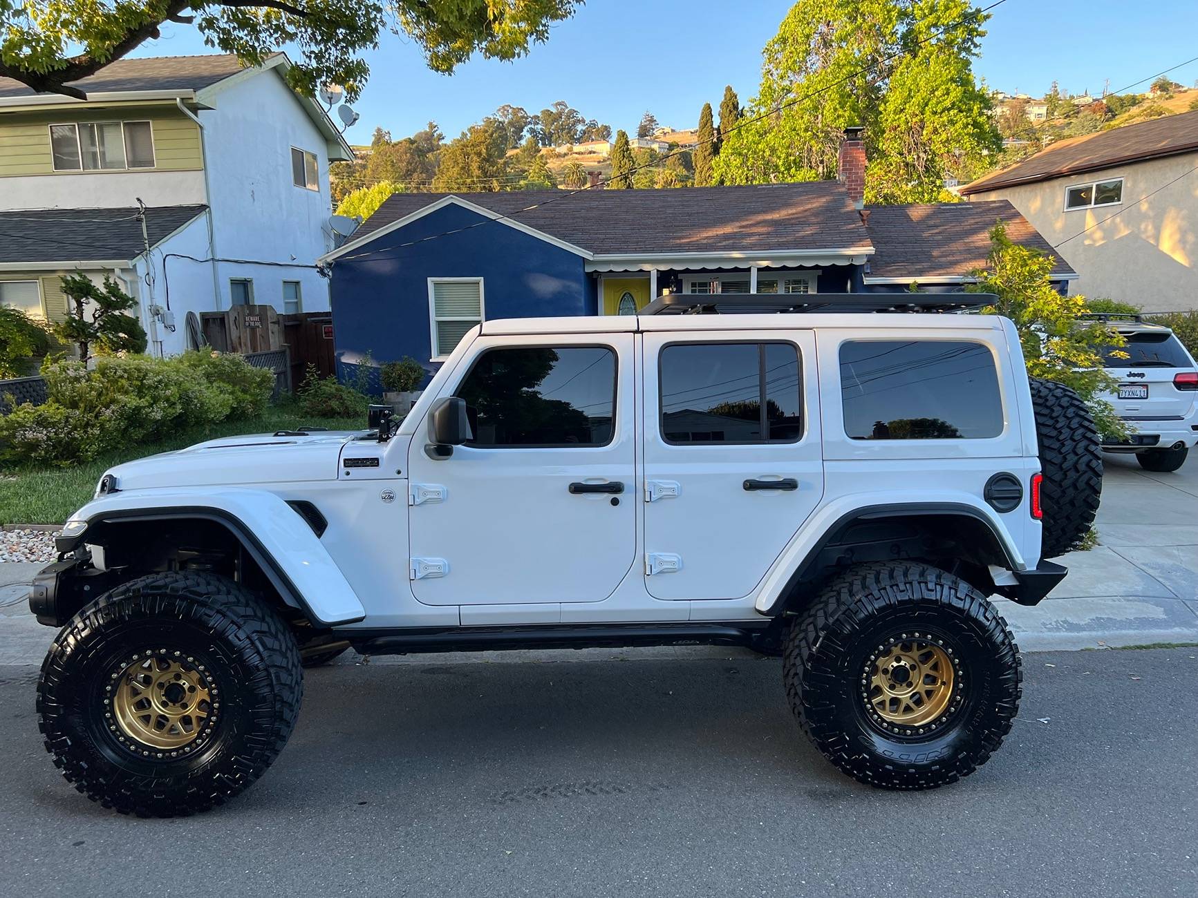

I have a 23 XR that is currently on 37's. I would like to go to 38's. Wheels are Kmc tank, -38 offset.
What lift without going insane with cost should I look into? Jeep is not my primary and only sees some off road as I have a can am to beat on..
Thnx
I daily drive, rock crawl and rip sand on 38" Falken RTs with a 3.5" lift with no problems. I 'm running Dirty Life beadlocks with a -38 as well. However I also completely removed the fenders and liners and replaced them with KBD fenders and Motobilt liners. I am also running 2.5 ton RPM Steering tierod, draglink and trackbars. We also pulled the steering box and ported it and added a PSC ram so I have have hydro assist.
Ditch your spare because that will be a lot of weight dangling from the rear. I'm running fully adjustable MC arms and Teraflex dual rate springs. Also still running 4.10 gears which I know is frowned upon but I don't have 2k laying around to re-gear yet.

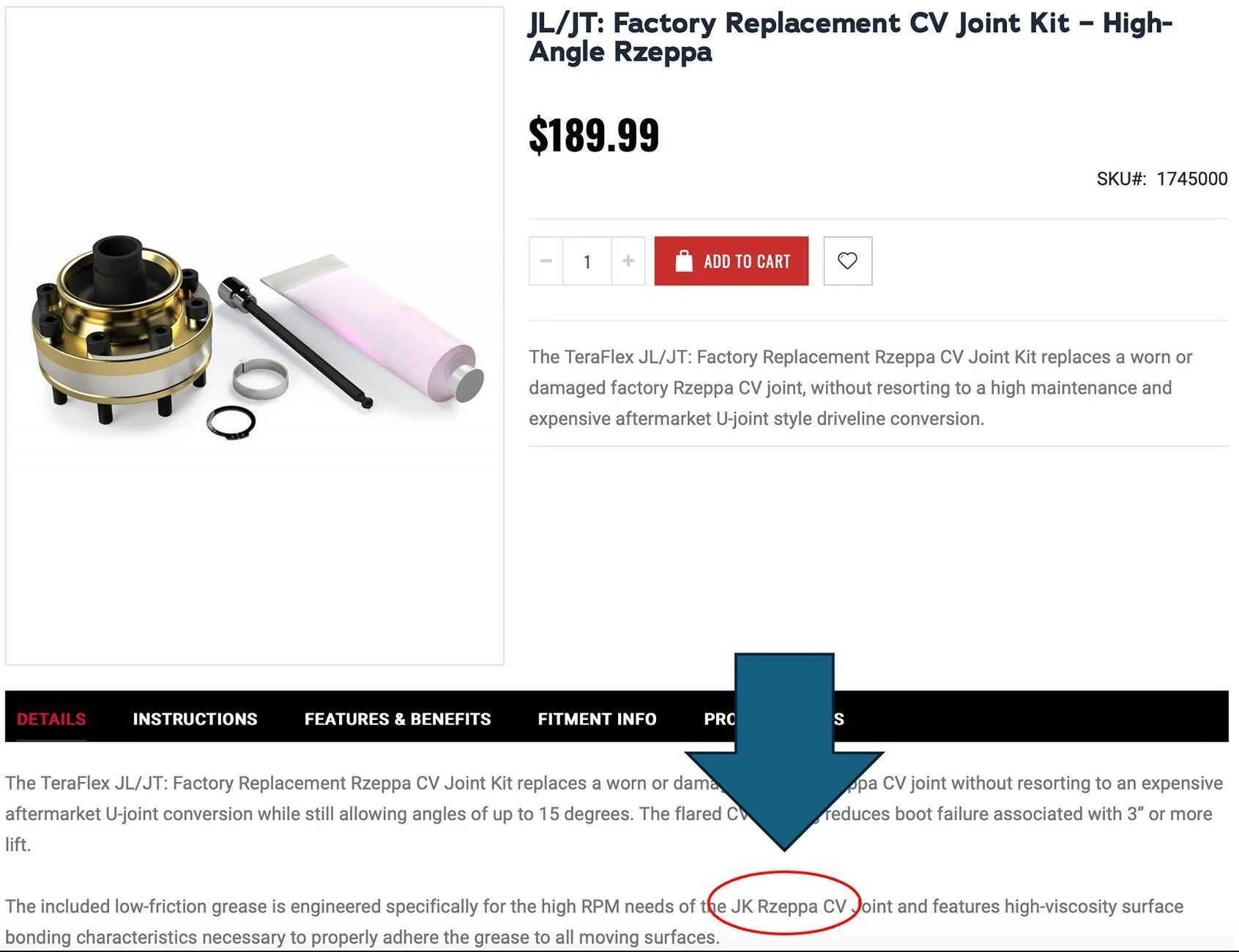

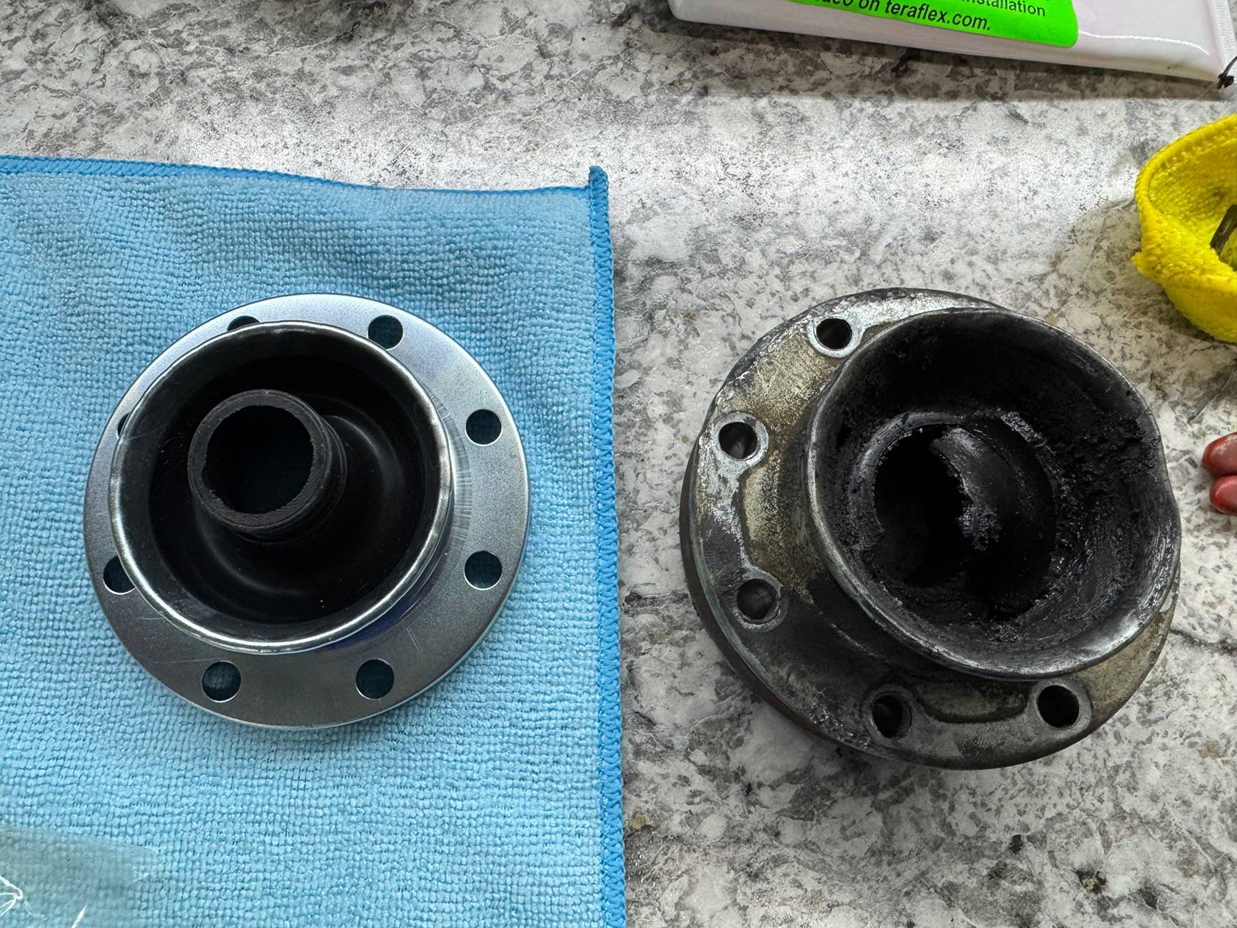

Replaced our factory Rzeppa with the Teraflex kit today. It definitely does NOT look like the item they list on the website. It is identical to the factory assembly I swapped with a few very small exceptions I noticed.
What their website shows

Here's a picture of the boot side that was in the kit.
Jeep Wrangler JL 38's IMG_7682
Exact same dimensions for both old and new. Color/Coating of the boot-side and cap is different.

If you look closely at Teraflex's website, it looks to me that they just copied and pasted the JK Rzeppa content over to the JL/JT variant. I am not convinced this will give any advantage over factory - but it was very straight forward to swap out. I'll be optimistic that this one will last longer, but nice to have it as an option to swap if/when we blow up another. :)
Would love if there's a Teraflex rep on the site that could weigh in....
Others experience may differ - posting my experience for reference.

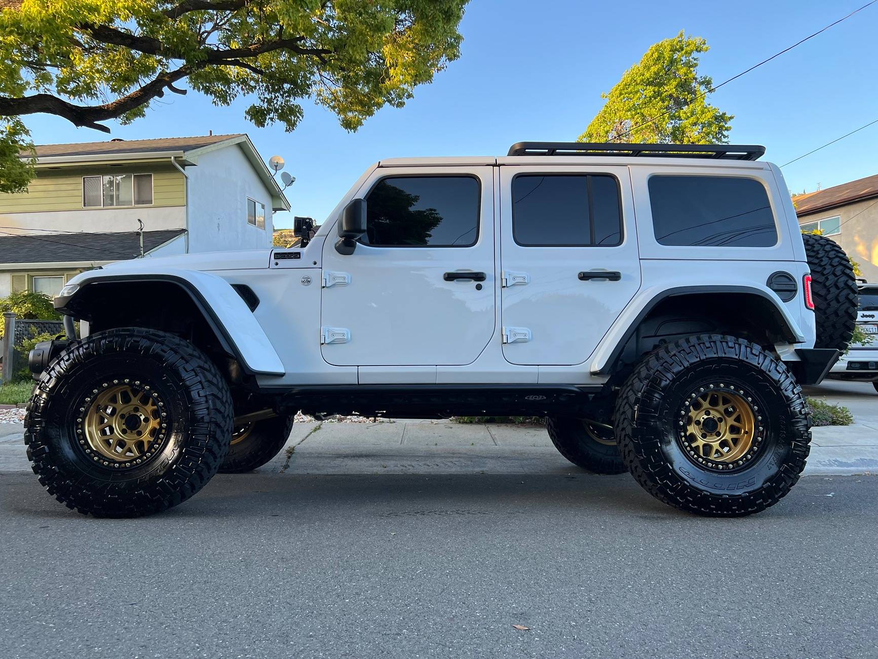

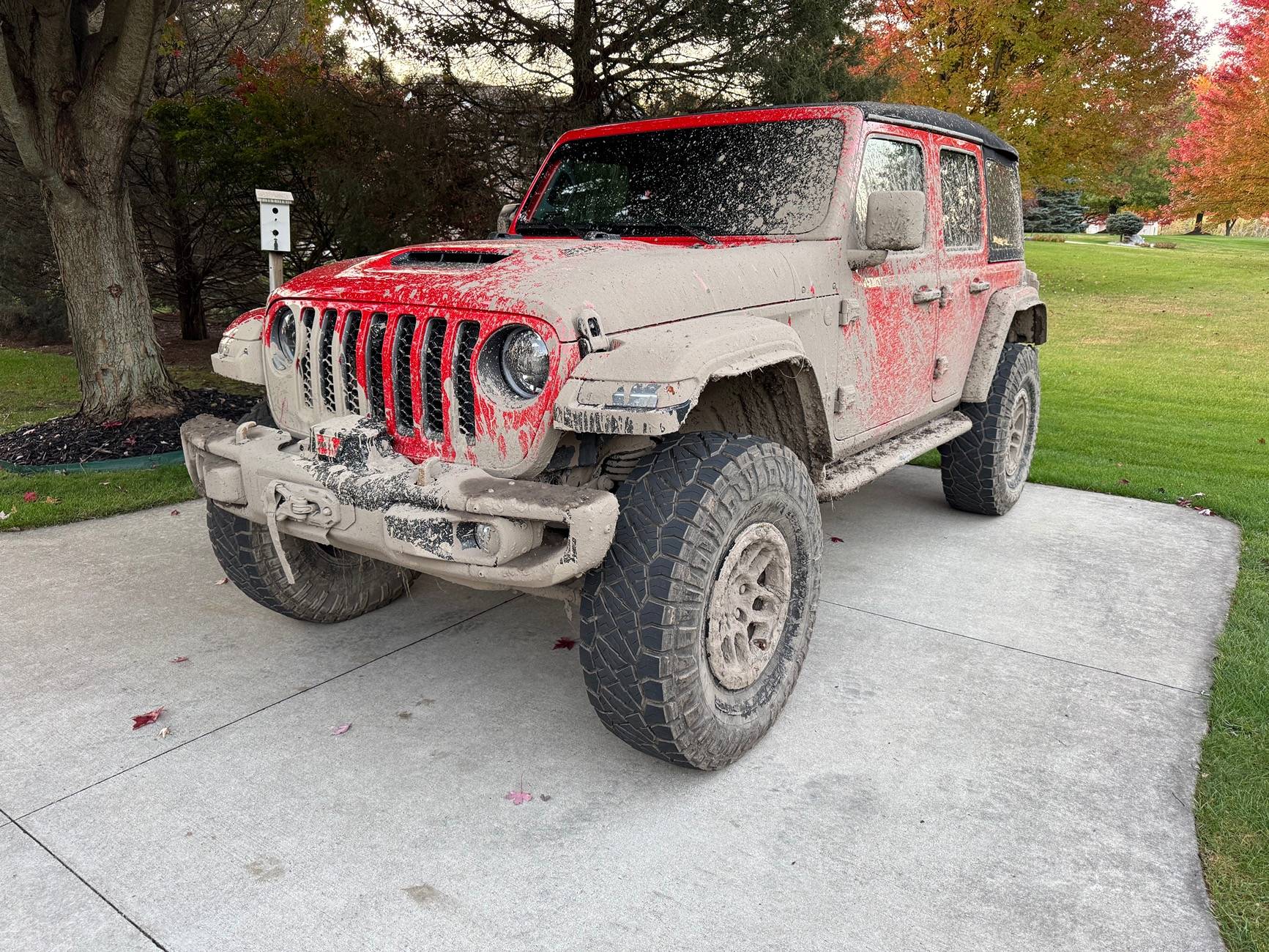

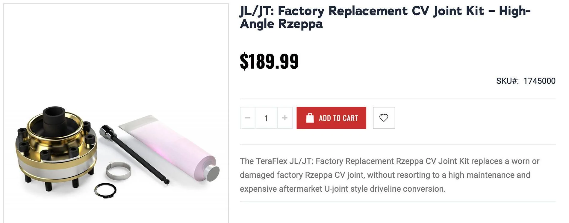

it’s hard to tell much difference, but since first picture I added full drawers, fridge, belly skids, etc and decide to go upgrade to MC 4.5” in front and 5.5” in the rear for added weight and soon to be 40’s.
Jeep Wrangler JL 38's IMG_5467
