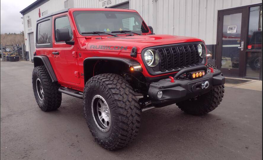

We used the Mopar lift kit for Nitto trail grappler 38x13.5x17's.

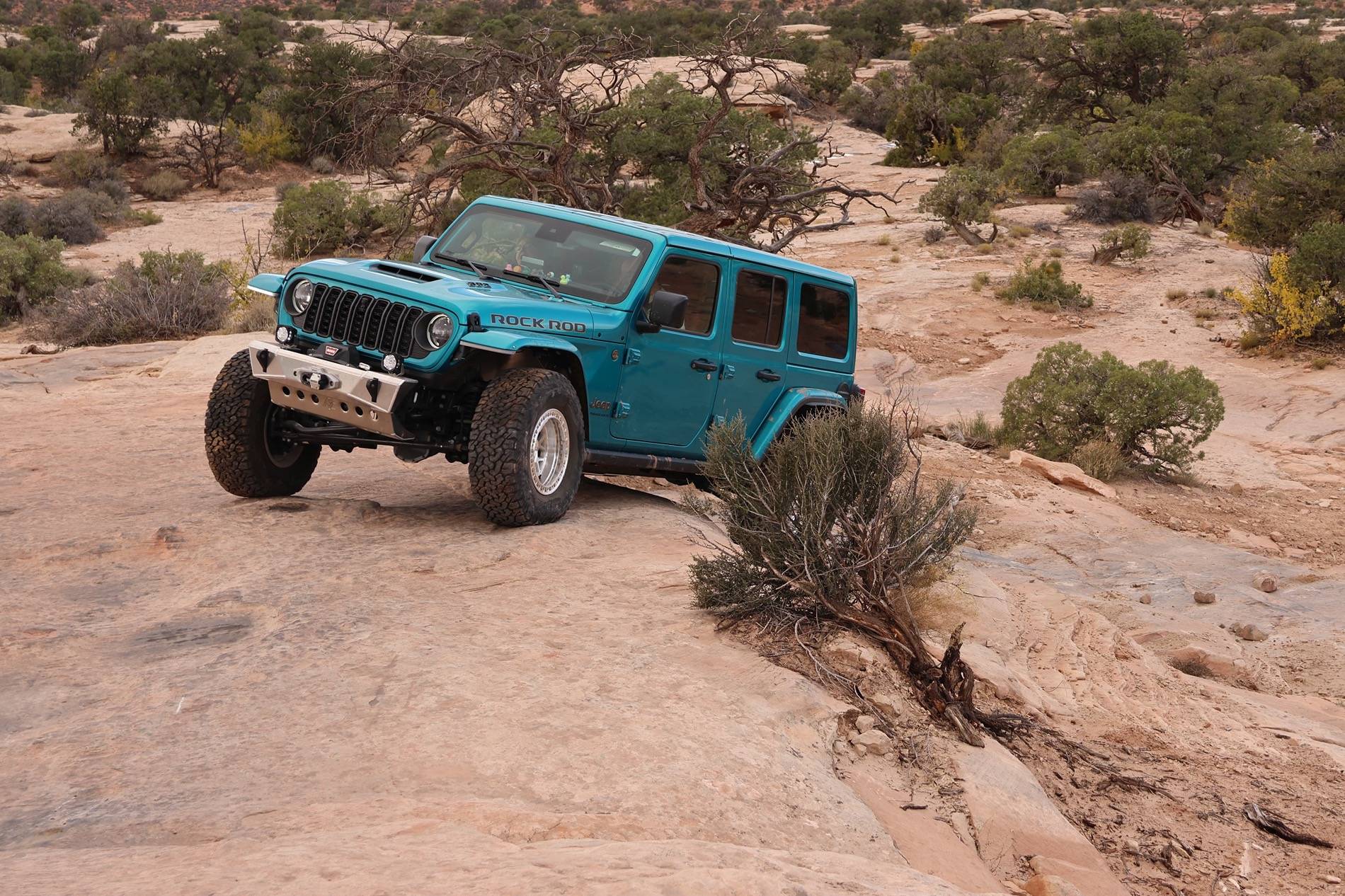

Like others have said, fender chop and you can fit 38s without suspension mods. That was my plan, until last week when I was in Moab and realized there isn't enough up travel with the XR and I was bumping the stops too hard. Plan B is figuring out what lift I'm getting. Here is a picture of my Jeep with the left front stuffed. There is plenty of room for a 38" tire there.
