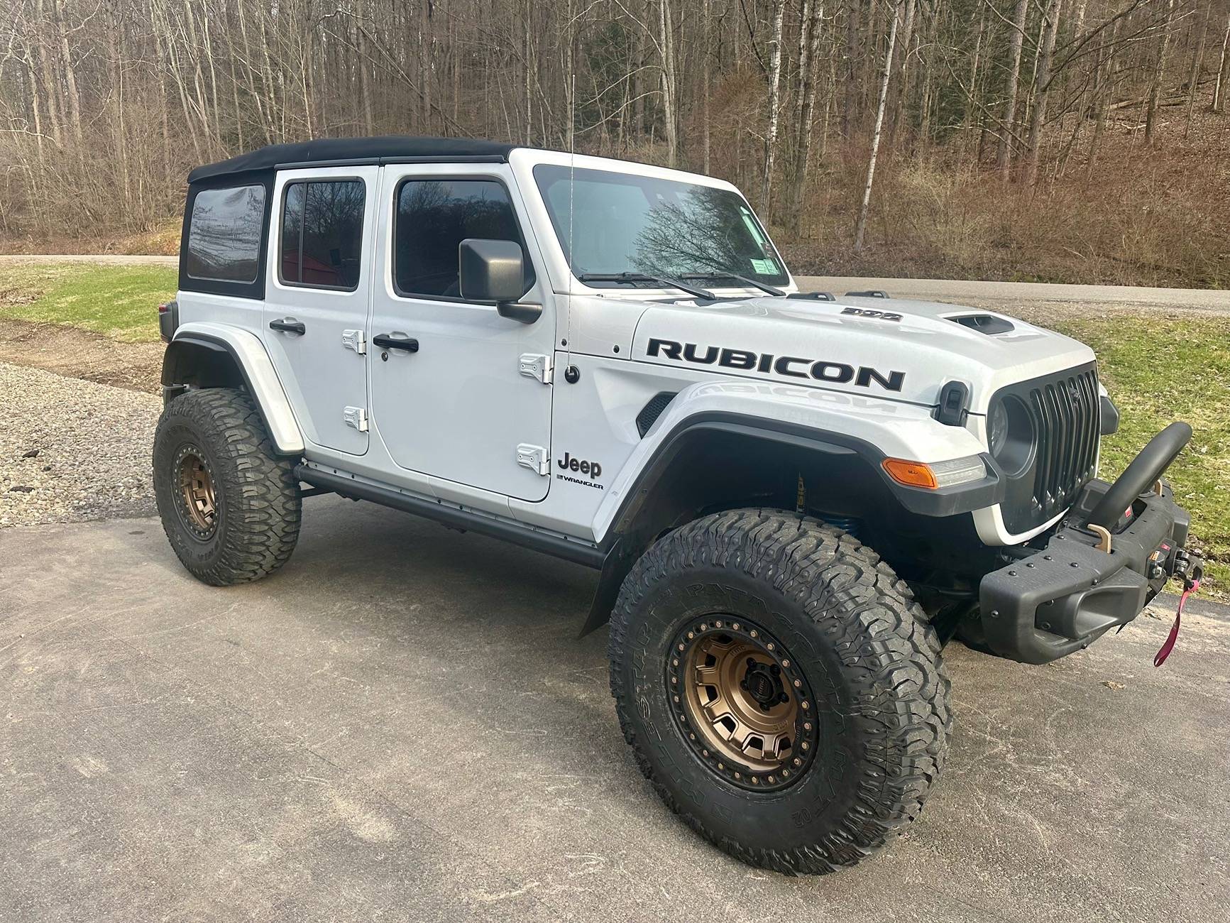

What is your backspacing on those wheels? I have a Rockkrawler 3.5 inch lift, same tires, -10 mm offset, 4.36” backspace, and I’m rubbing my front lower control arms at full turn.
-38 backspacing. I needed it aggressive to allow full lock on coilover suspension from RK, to clear reservoir speciifcally...

Sorry if I missed the post...so what was the end result set-up to go 38s & what tires did you go with?
AEV 3" w/ patagonia 38/13.5's
The wheels are -38 offset.
