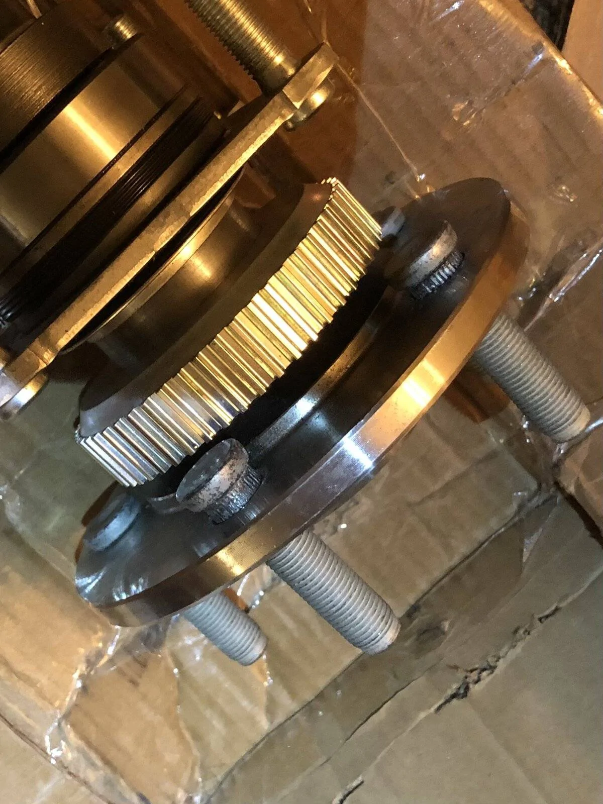

Sorry to see this happen, keep us posted on what you figure out....personally I haven’t been impressed with anything Dana Spicer has sent me. From ring&pinion sets, master install kits, and of course chromoly shafts like yours there’s been a nice surprise when I open a package from them. This pic is just one example of how poor their quality control is, can’t even press the studs in all the way. Of the 2 shafts that showed up I had 3 studs not pressed, 2 nicked tone rings, and smashed splines.
I’ve had no issues with Yukon brand and will be sticking with them once these parts fail and leave me high and dry just like you :)

Very interesting.... I could see improperly seated studs causing torque issues and perhaps a thread stripping problem and potential breakage when driving when driving from the loose studs but it would not cause cross threading. Breakage can happen from over torque but also from tire forces from a stud loosening while driving forces are in effect.
Looks like wheel stud forensics are in order here!
It could be a factory warranty defect that would potentially be denied due to tire modification which would suck when the true cause was poor Dana build/production quality should it be determined as the cause of failure...

Yup. This right here explains it all. Studs weren’t properly pressed in. I’m never put this trash in my rig again. I wheel
This thing can’t be risking a stud failure lol

Considering this is an aftermarket assembly made specifically for off-road use it’s a pretty clear defect. Just look at the previous post where it shows the studs not even pressed in properly. Mine looked like they were but clearly weren’t

That Dana photo is a factory supplier..
