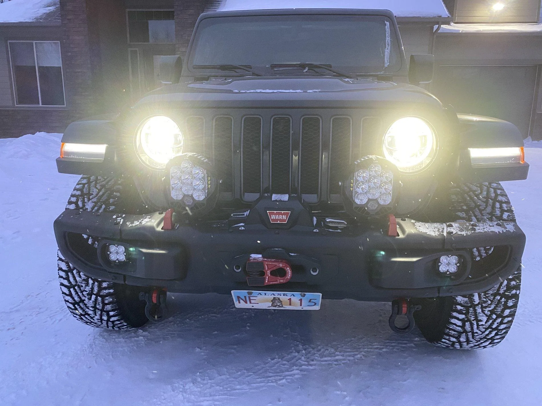

Finished installing the mopar steel bumper with Maximus 3 tow loop mods to the bumper and skid plate (deeply satisfying hour with an angle grinder). BD squadron pro fogs are relatively easy once the brackets are aligned, but the LP9 wiring is going to be another project. Zeon 10s was a royal pain in the ass as usual. A word to the wise about the factor 55 flatlink e...when you take out the c-clip to get it on your rope, cover that thing up or it may just pop off your tool and wind up 30’ away.

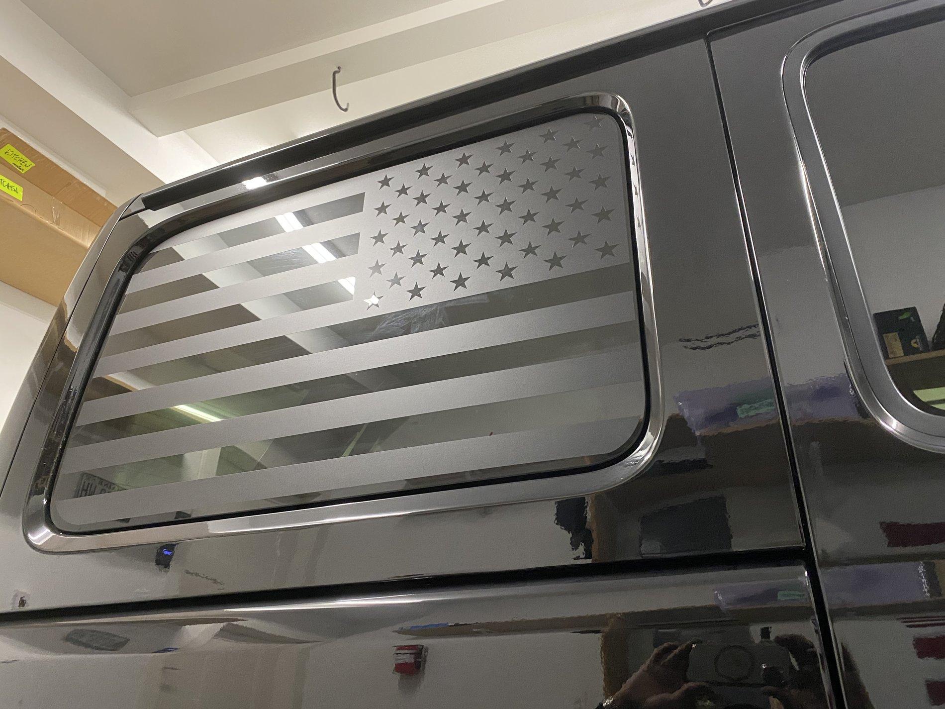

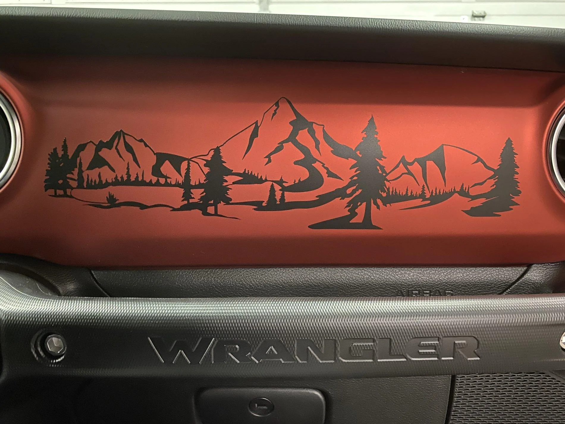

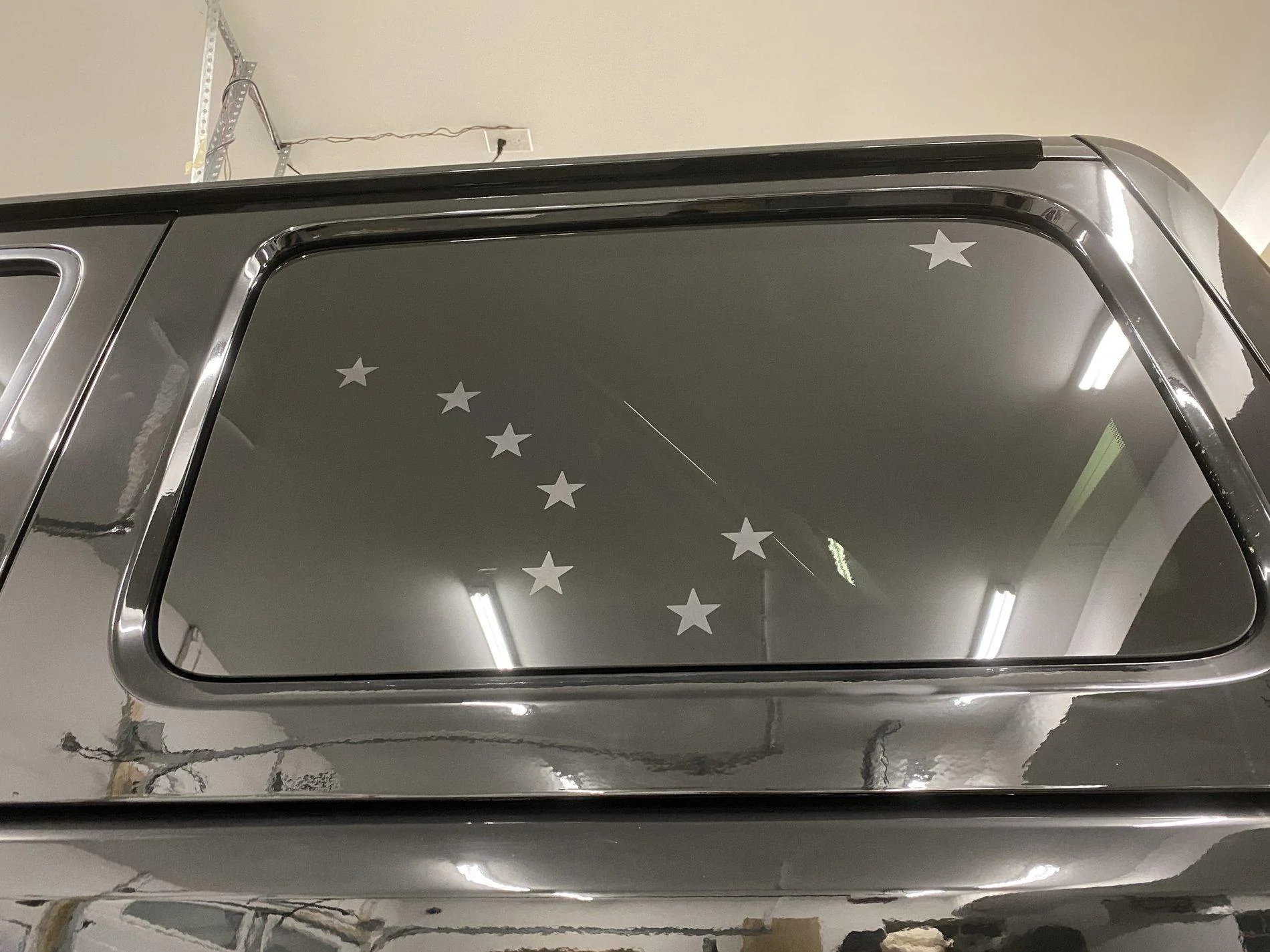

ETA: Some shots of the vinyls I’ve added.
