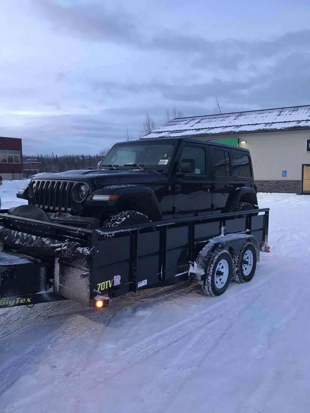

Alright folks...the first trailer ride is done and the 3.0 is tucked away in the shop for wash, clay and ppf. Ecodiesel sticker is gone and I learned the hard way that this type of trailer requires you to exit via the window or the rear swing gate :CWL:...I tried both.

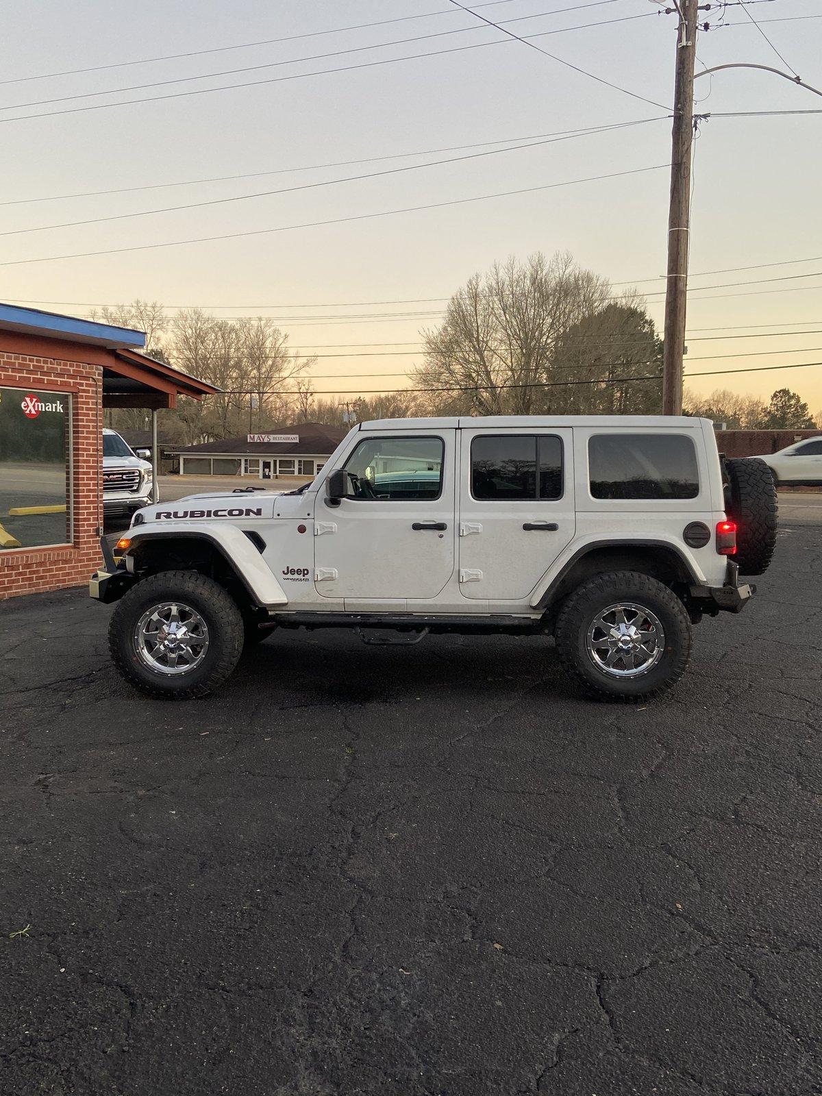

I put a Terra Flex 2.5 inch lift kit with Falcon 3.3 shocks but the the right front shock would not fit. The piggyback hit the battery box. I’m going to put the 2.1 mono shocks. I’ll post picks when shocks are installed.

Finished up with the 2.5 Terra Flex lift. Well almost. Originally I ordered it with 3.3 Falcon SP shocks and the right front shock piggyback hit the battery box so I have the 2.1 coming. Everything went well but because the diesel is heavier I had to add an inch spacer to the front. The back was spot on. The front only raised it an 1 1/2 with spacer it a tad over 2/12. Also had to use the stock bump stop on front on bottom.
