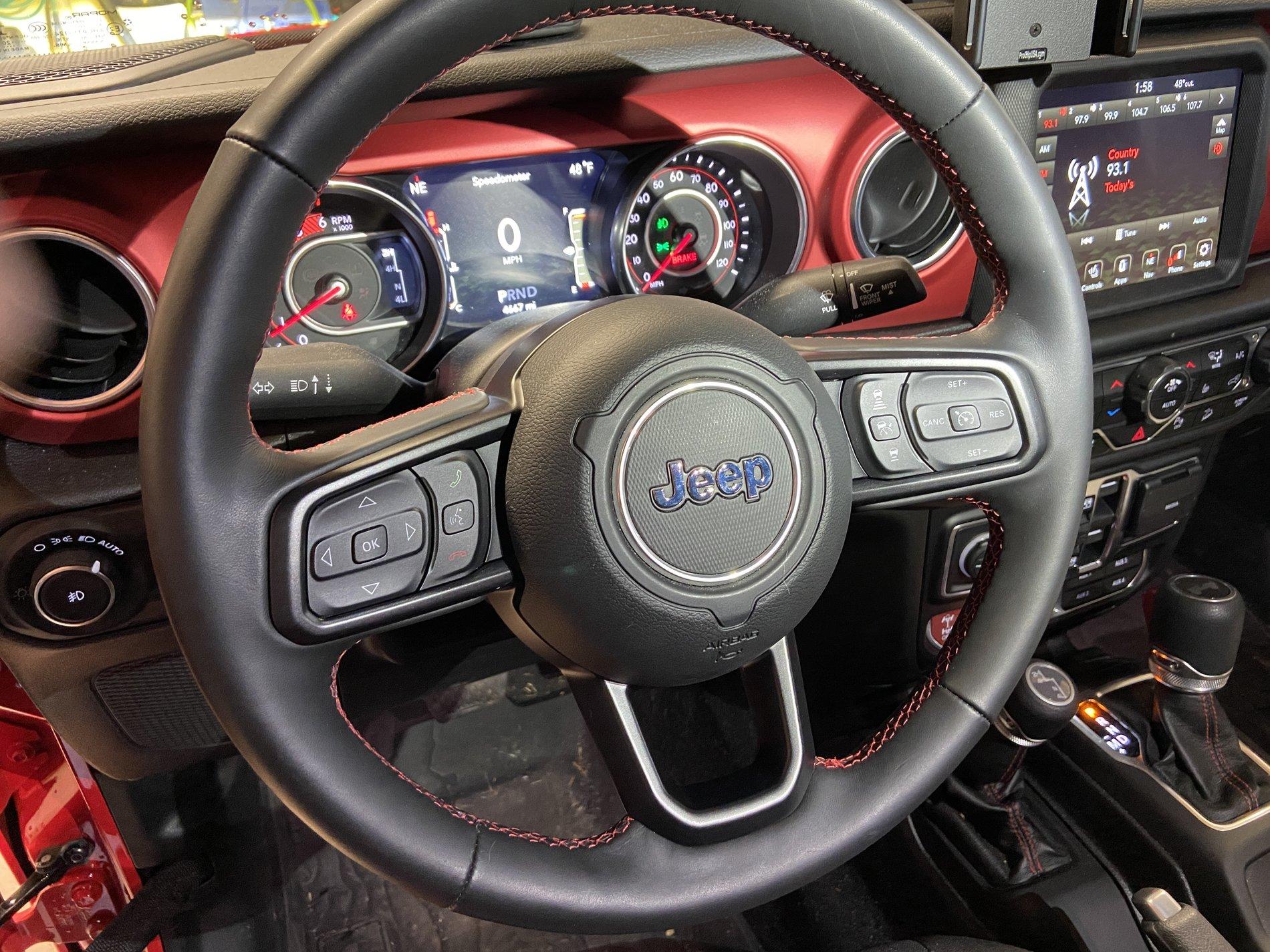

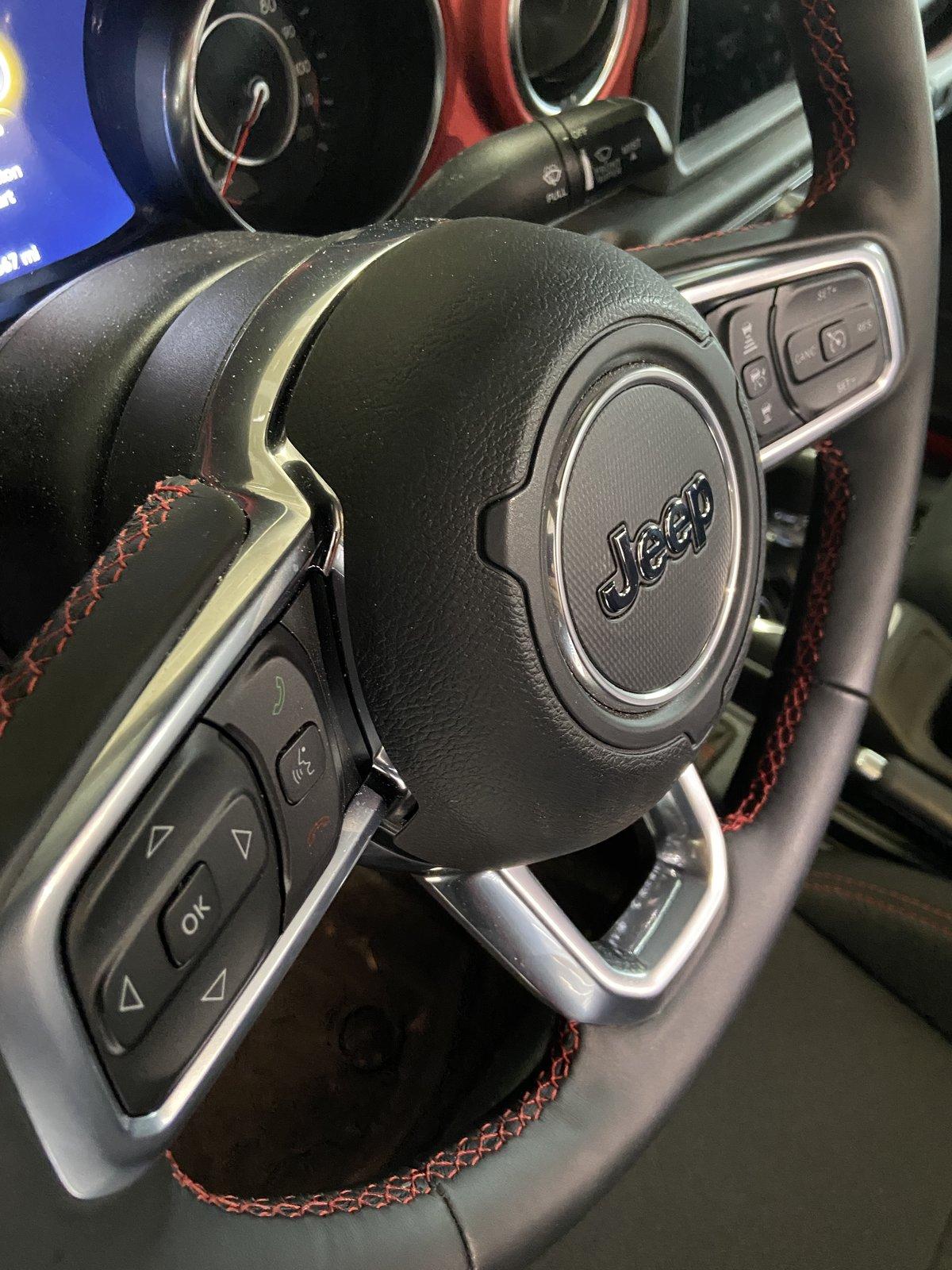

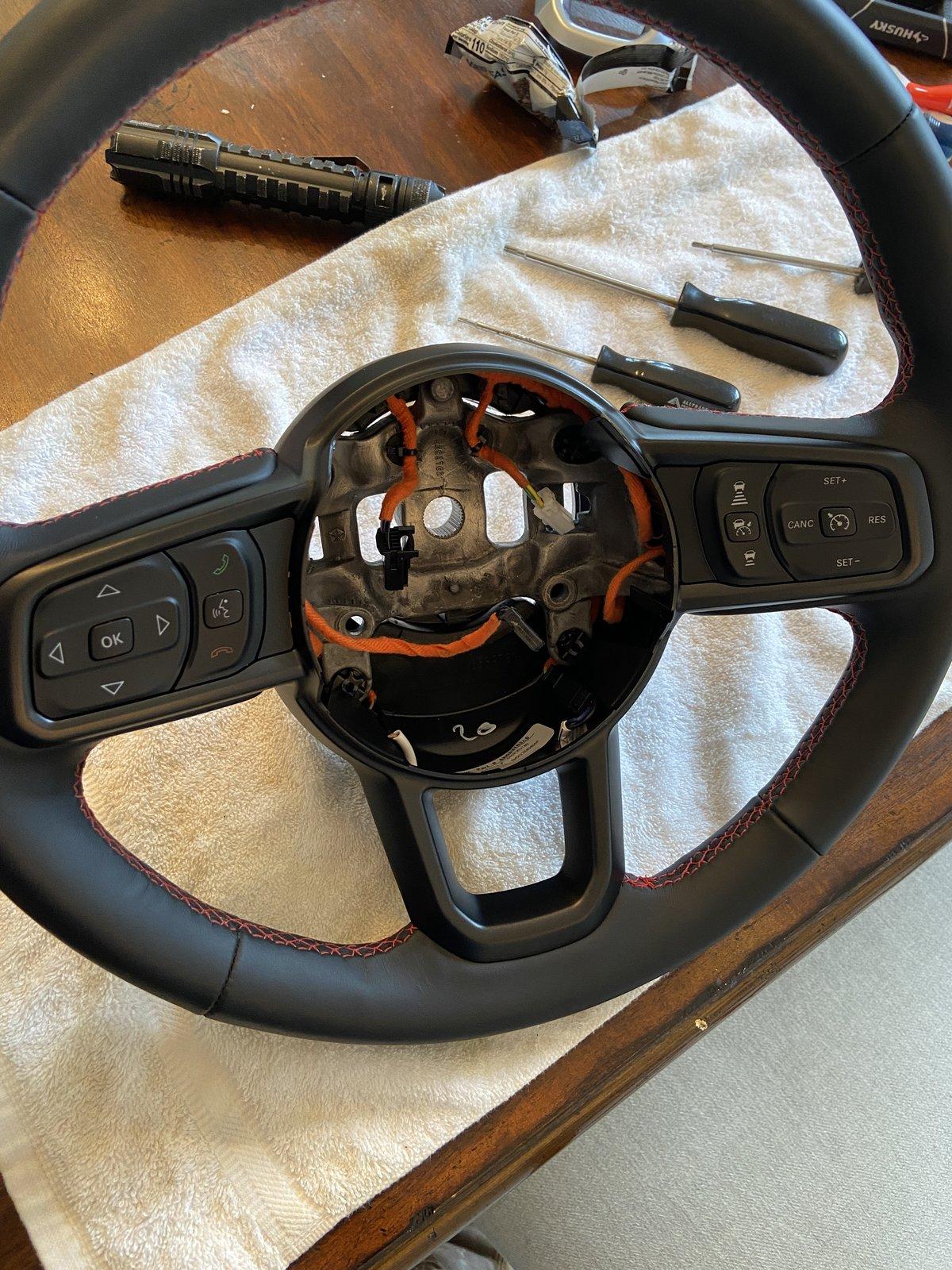

I got tired of seeing the reflection from the steering wheel trim on the windshield. I removed the chrome trim ring and installed a black trim ring. I like the new look and there is no more reflection from the sun.

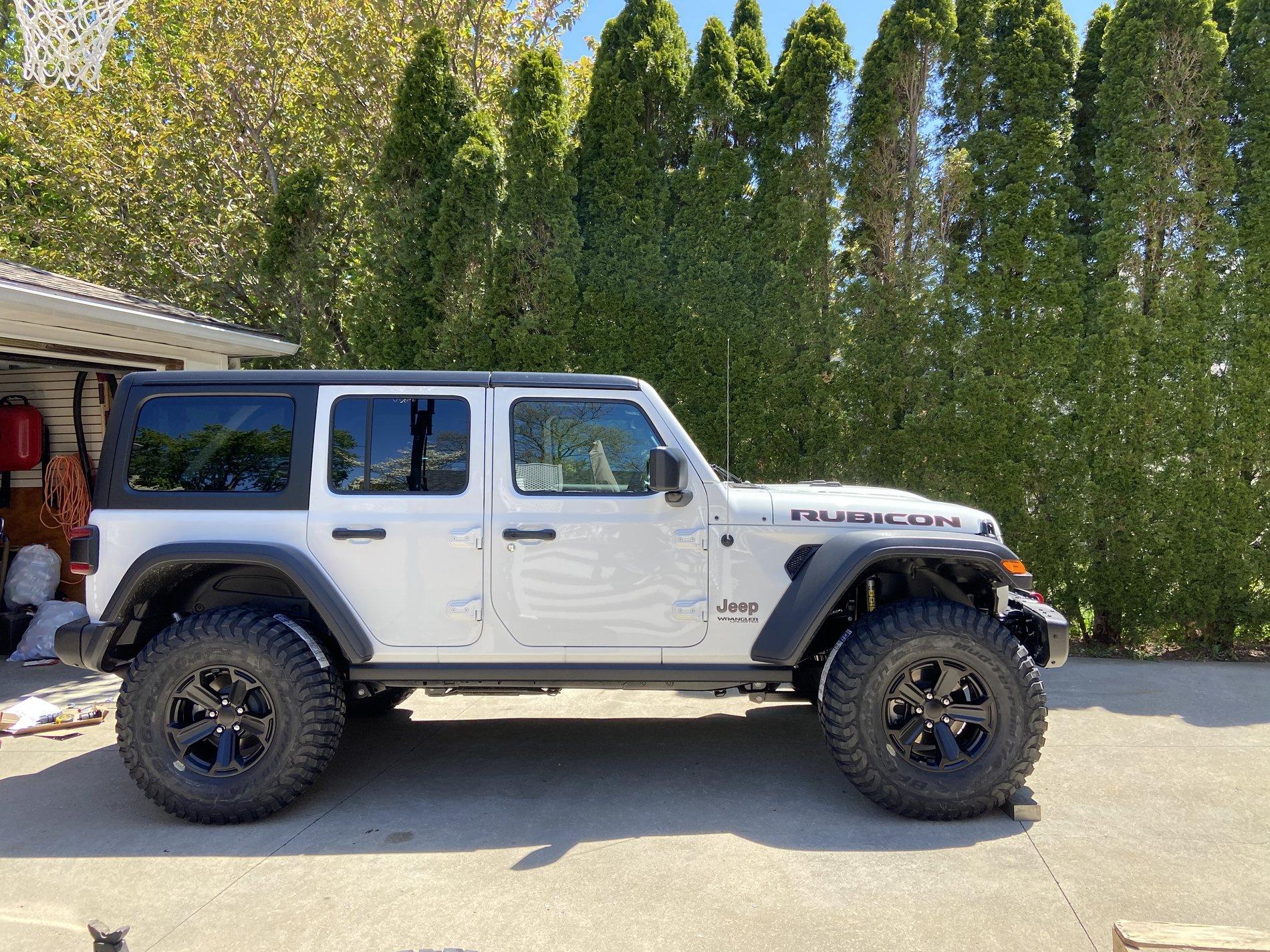

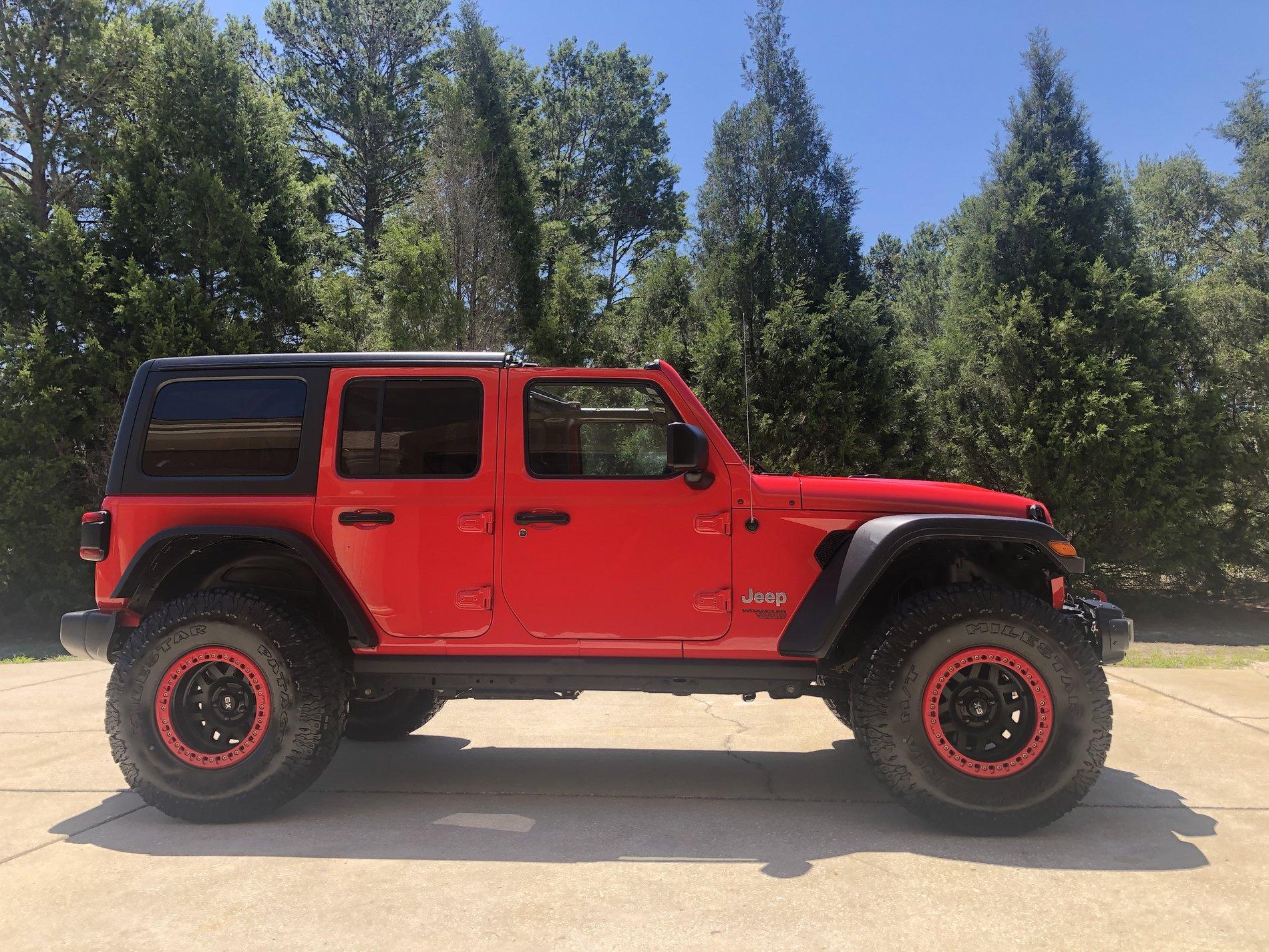

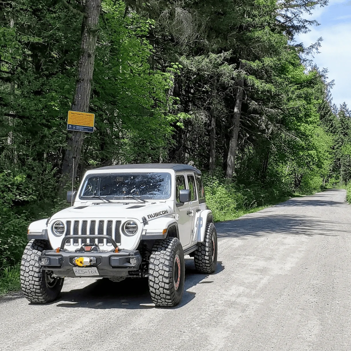

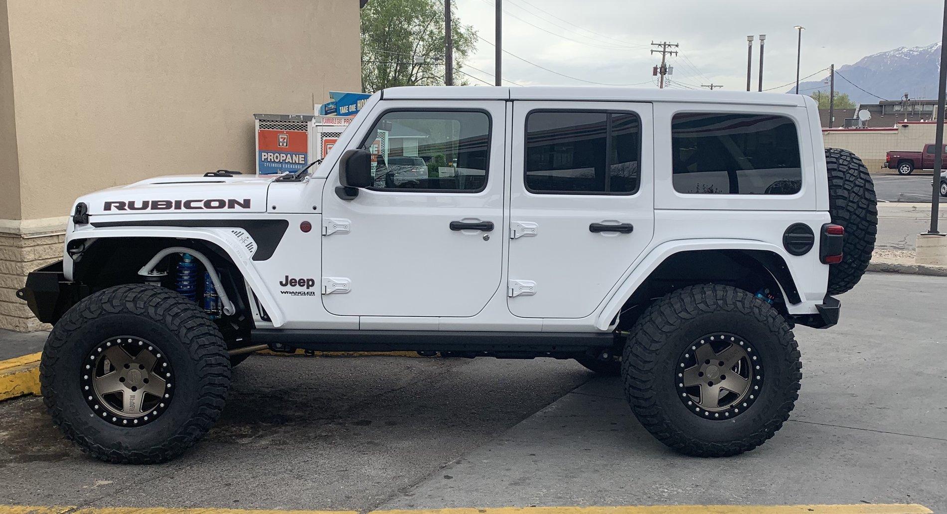

5 months of waiting and a week of driving before tearing it apart for this:
Still needs the RSE step sliders, winch and a pair of 0.5” rear coil spacers to level out the back. Pretty stoked with how it turned out. Can’t wait to run it...just hope this diesel will hold up.
which front bumper is that? Jeep looks good..

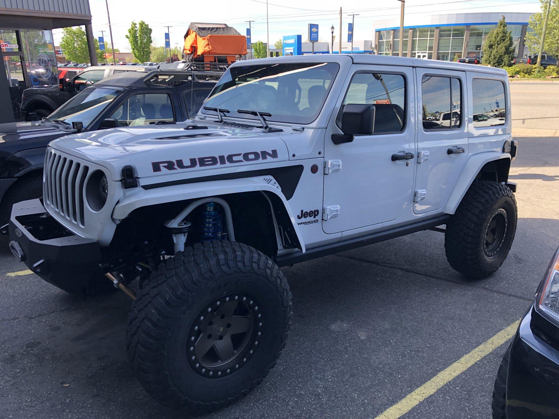

3 weeks in and 1k miles, on a Sport S EcoDiesel... Done so far; Rubicon Steel bumper, Rubicon fenders( rears chopped), Smittybilt 12k H2O, Rubicon rock sliders, 2 1/2" spacer lift, KMC Beadlock wheels, 38" Patagonia's, JKS disconnects, Factory55 ultra hook, Proclip phone mount.
3.5" Metalcloak game-changer on order, American Adventure Lab front fender chop on order. Motbilt inner fender liners on order.
You have been busy, Good Looking Rig :like:

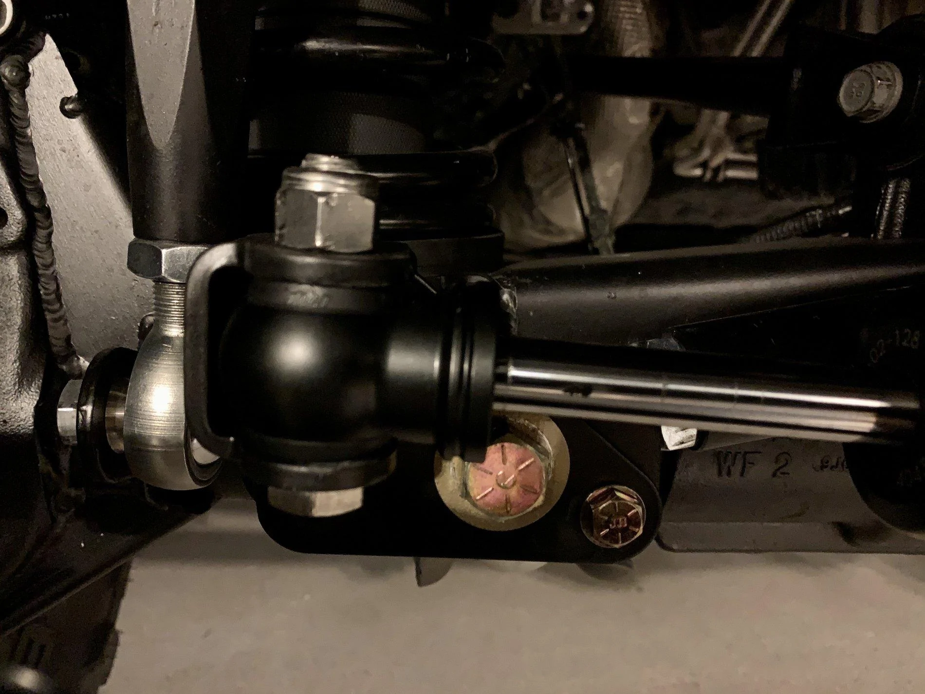

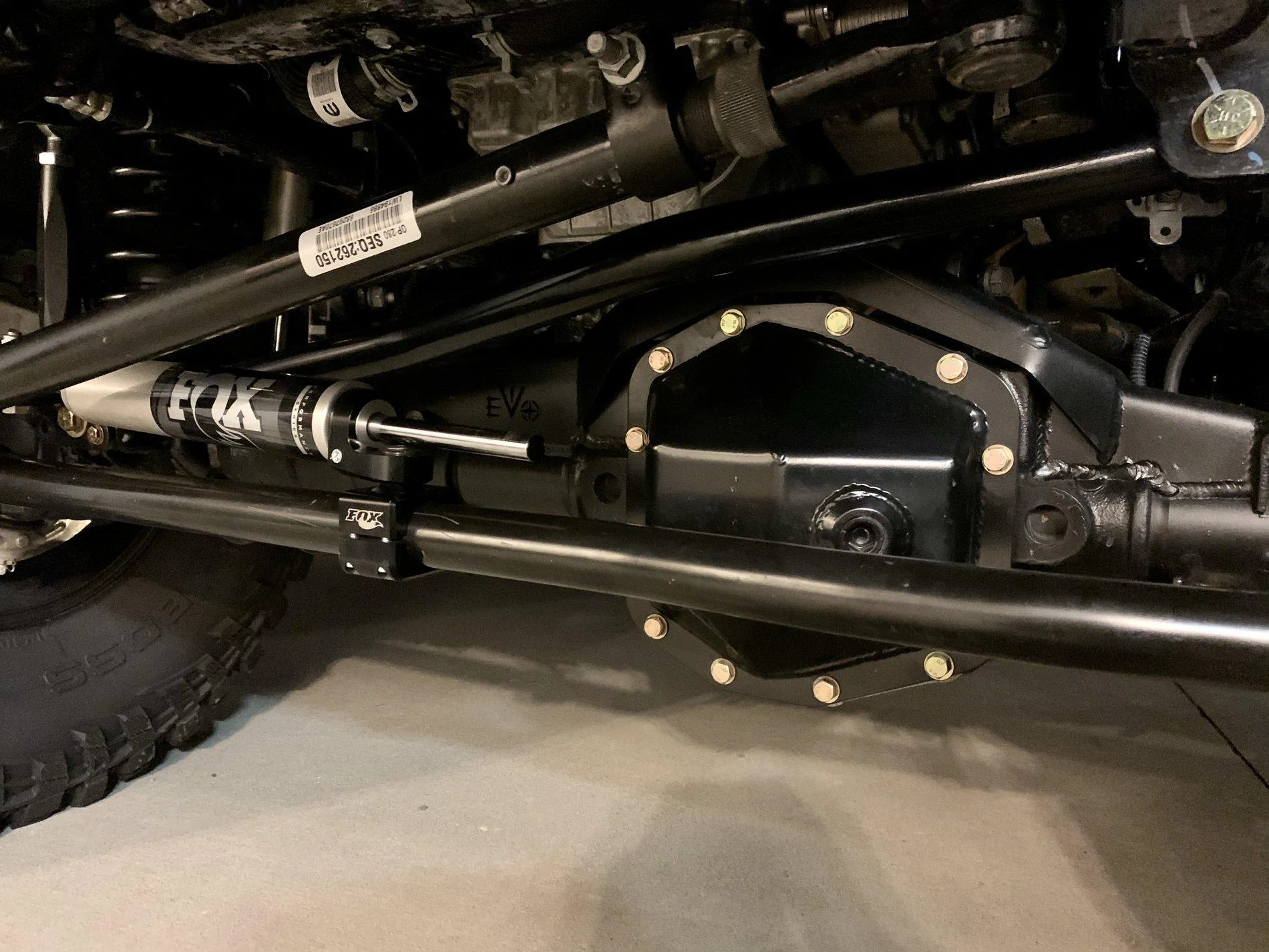

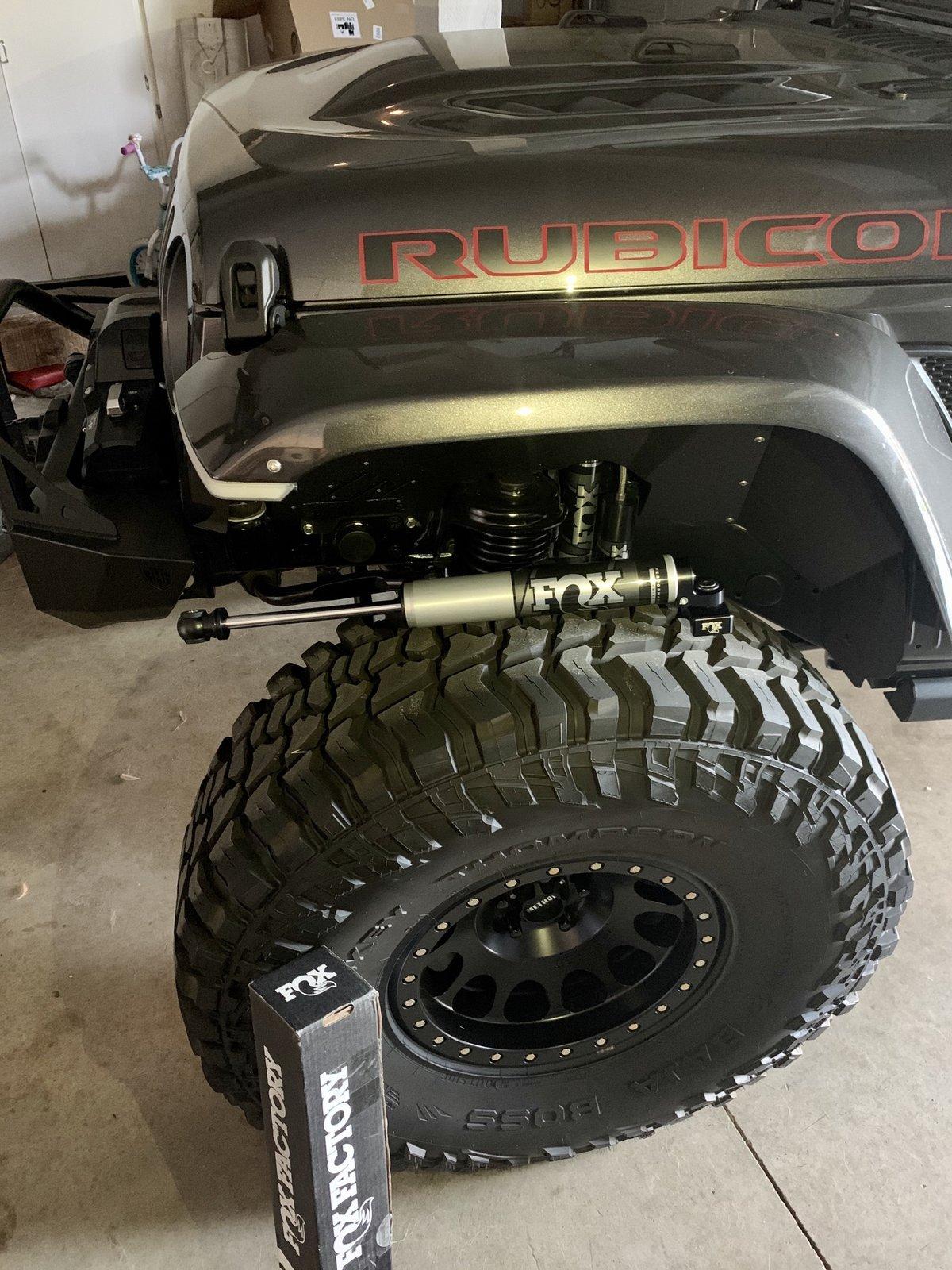

Got the fox SS on. Had to use a JK synergy mount for the axle side mount to raise it high enough so the stabilizer body wouldn’t hit the tie rod.
Thanks, it’s my first Wrangler and I’ve had fun building it. Sorry for the delay in getting back to you...haven’t been on the forum for a few days. It’s Rock Slide Engineerings stubby.

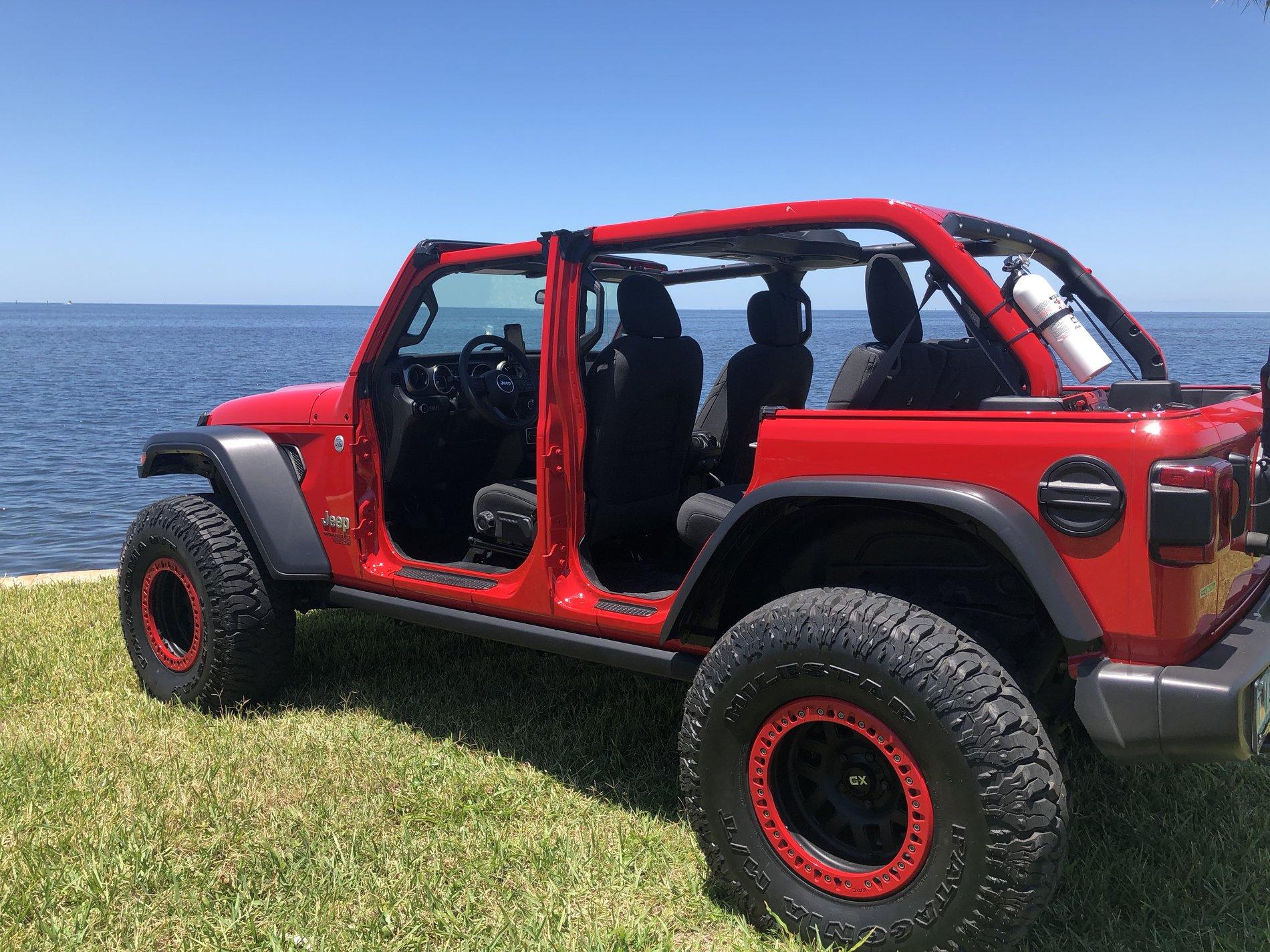

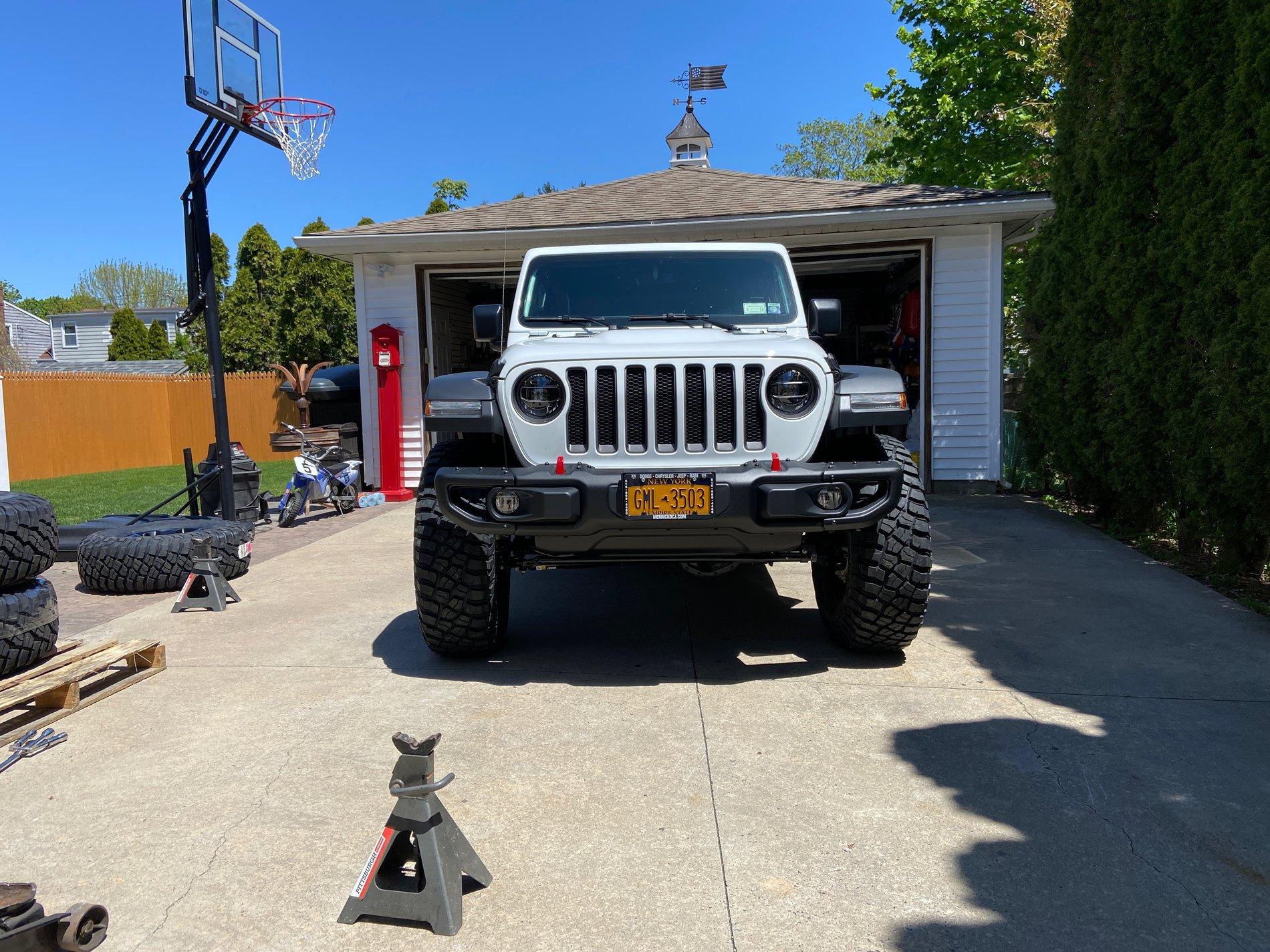

3 weeks in and 1k miles, on a Sport S EcoDiesel... Done so far; Rubicon Steel bumper, Rubicon fenders( rears chopped), Smittybilt 12k H2O, Rubicon rock sliders, 2 1/2" spacer lift, KMC Beadlock wheels, 38" Patagonia's, JKS disconnects, Factory55 ultra hook, Proclip phone mount, Taser JL, Mopar door sills, Mopar trail hitch, and trailer tow wiring(mine did not come with tow package)
3.5" Metalcloak game-changer on order, American Adventure Lab front fender chop on order. Motobilt inner fender liners on order.

very nice.

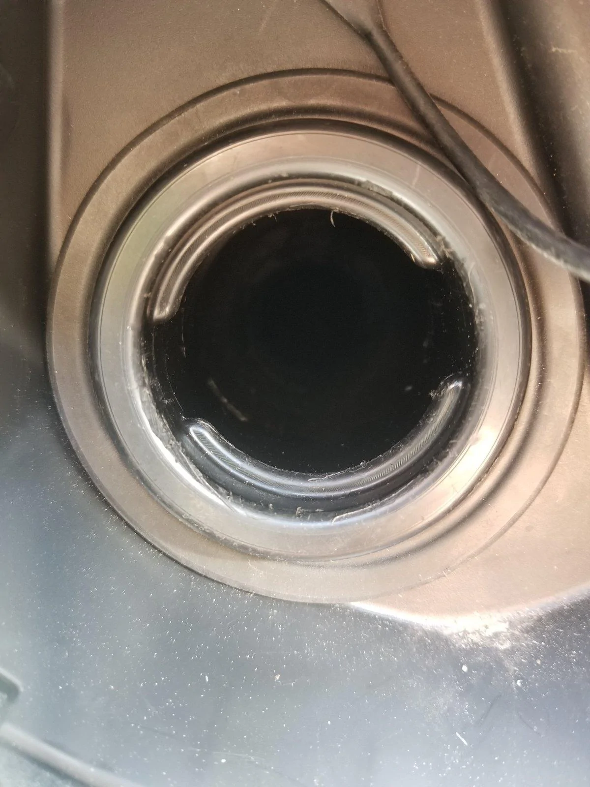

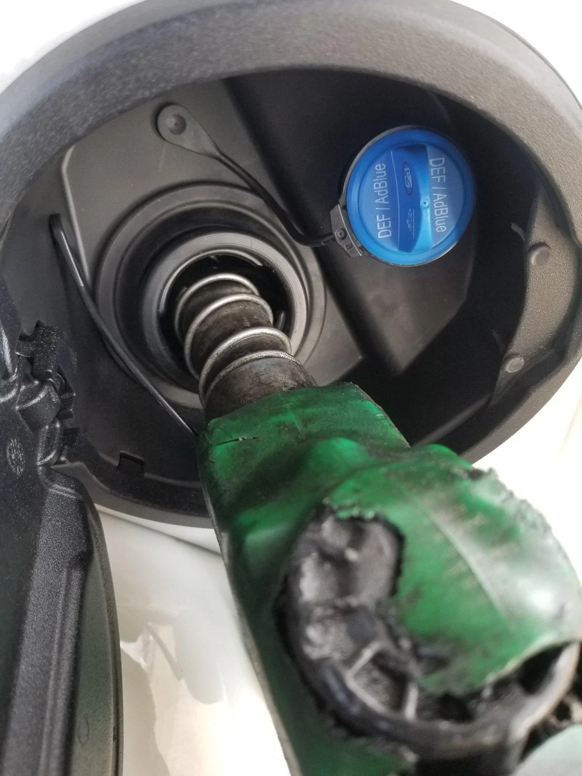

Modified filler neck for truck diesel nozzle use. May not be helpful to some, but beats using the misfueling adapter every time.

How much $ and time to do it?

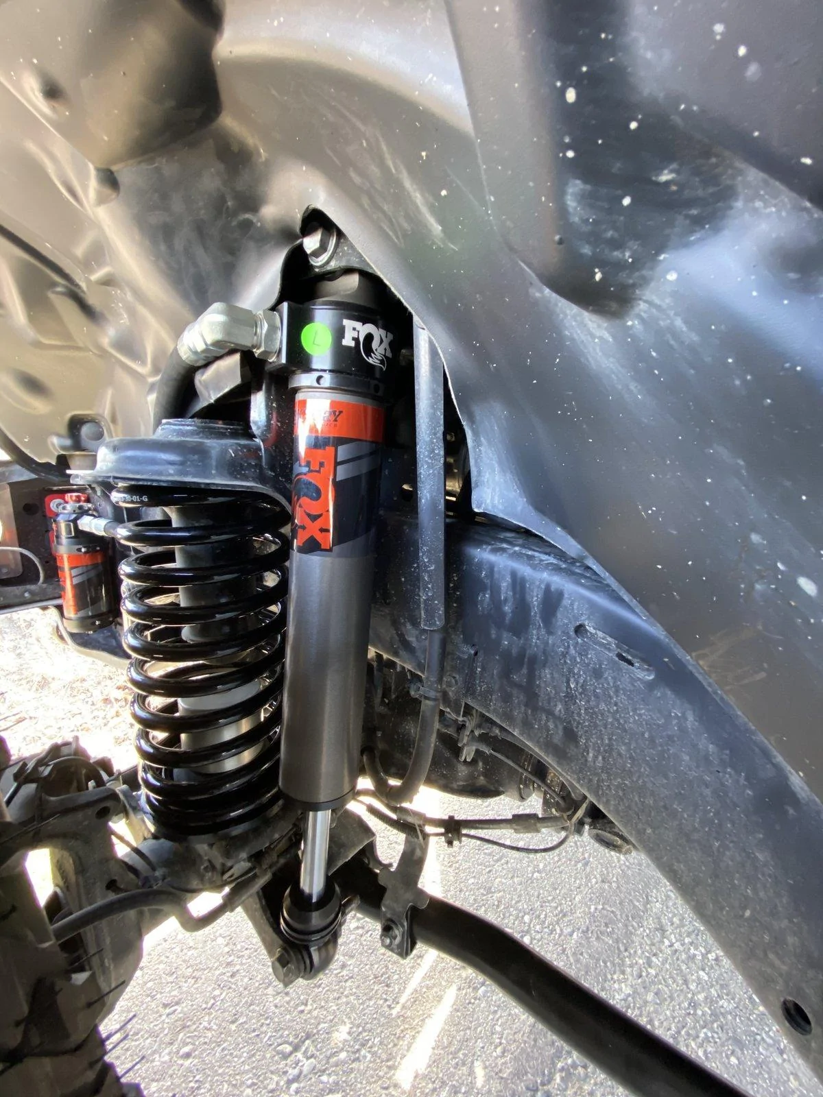

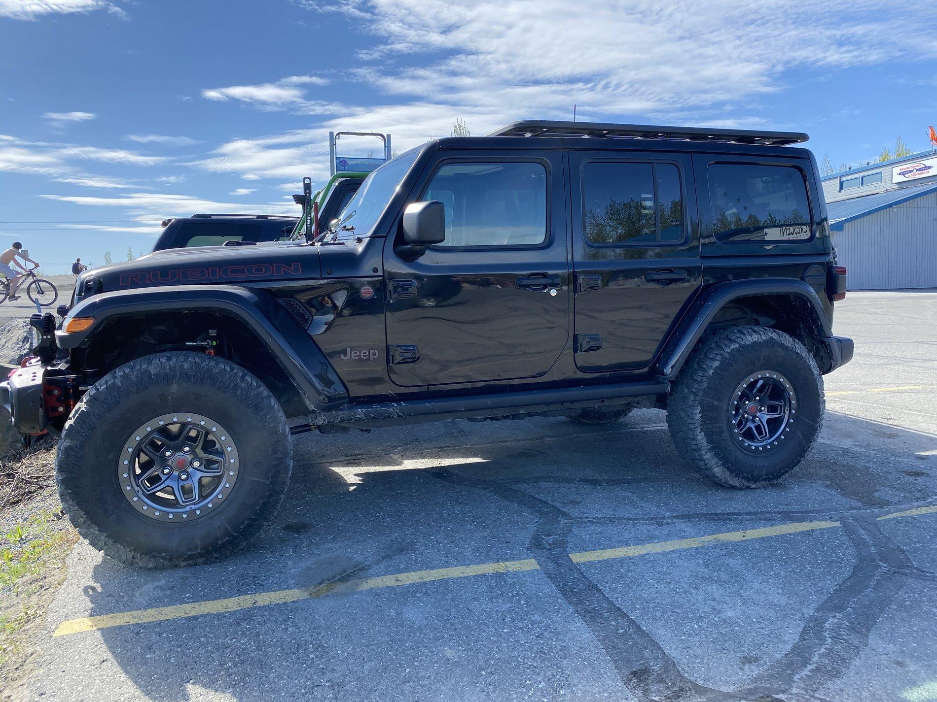

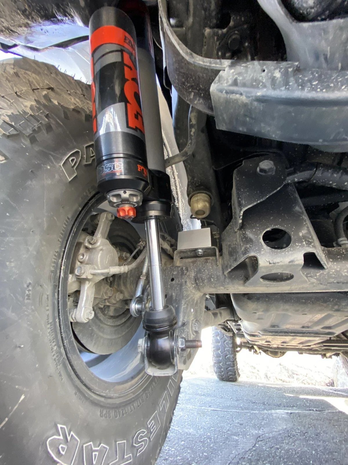

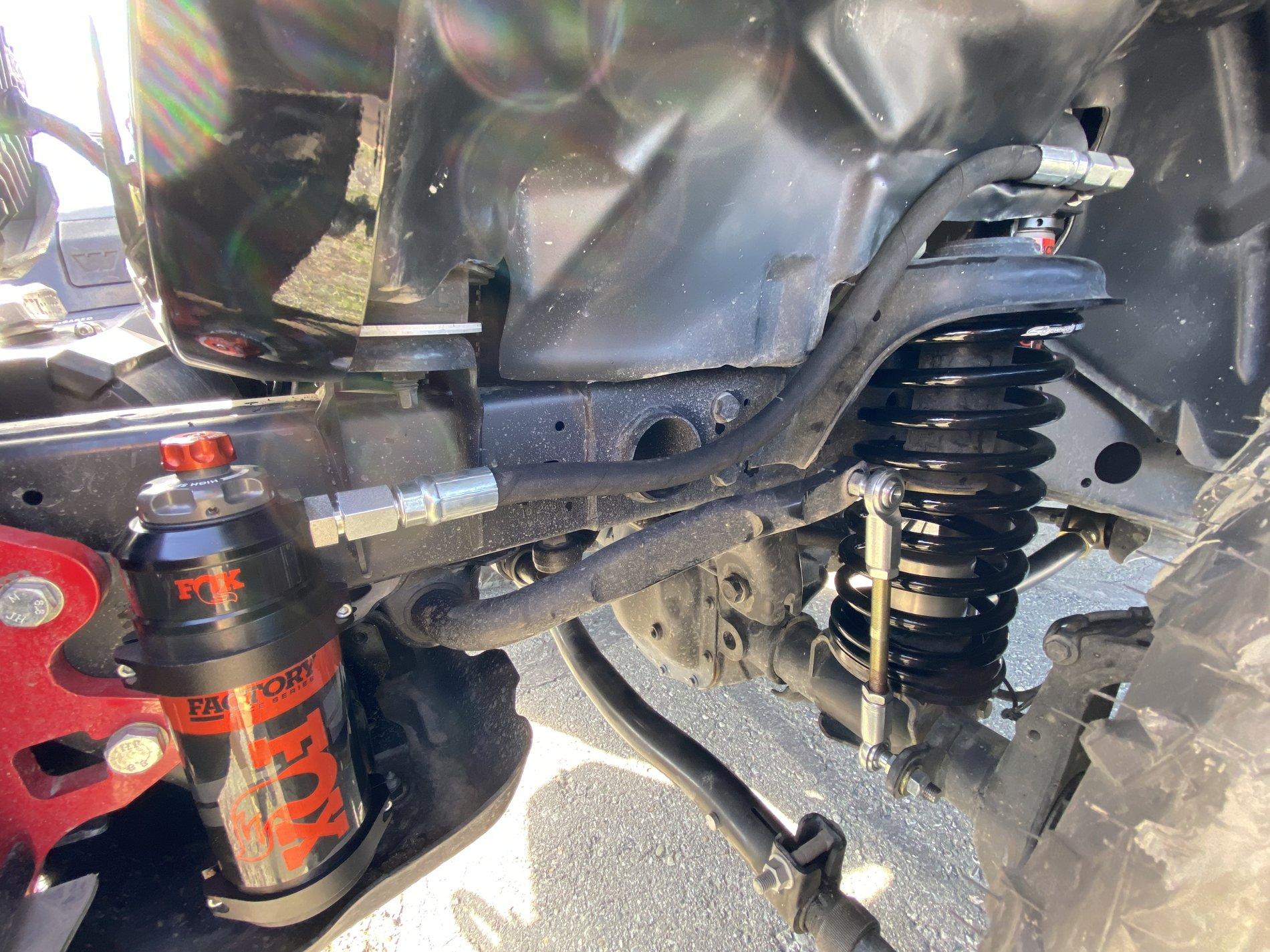

Accutune LCAs, stops, and swaybar links, synergy 3” springs, Fox 2.5 DSC shocks all on today. Looks like only a shade over 2” of lift with all the extra diesel and mod weight. Might have to go higher but we’ll see how it runs off road.
