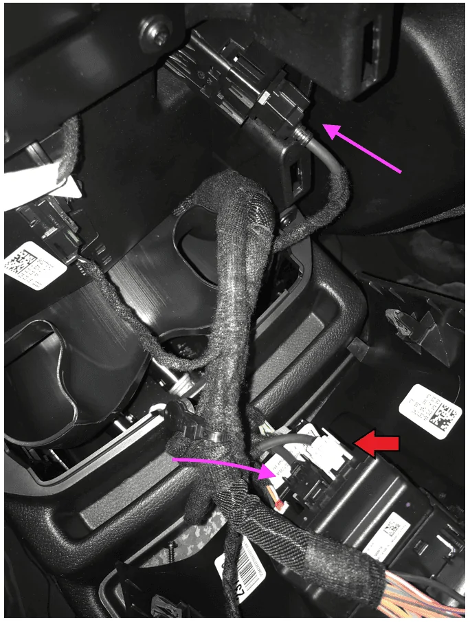

That is pretty much what I did "take it all apart and check every connection.", albeit in my driveway rather than taking it to the dealer.
Taking the HVAC controls out was the scariest part, the center console was easy :)
Keeping my fingers crossed that it's fixed :fingerscrossed:, to date the results have been good.
Center Console removal: Steps here: https://www.jlwranglerforums.com/forum/threads/jl-non-rubicon-cupholder.9882/page-2
Pulling Dash apart/AC controls:
I didn't take any pics of it all part, I should have done :( I simply unplugged anything that looked USB , I marked up some the image from post #27 in this thread, and there are also white and black plugs on the back of the USB media port in the dash that I unplugged/reseated.
