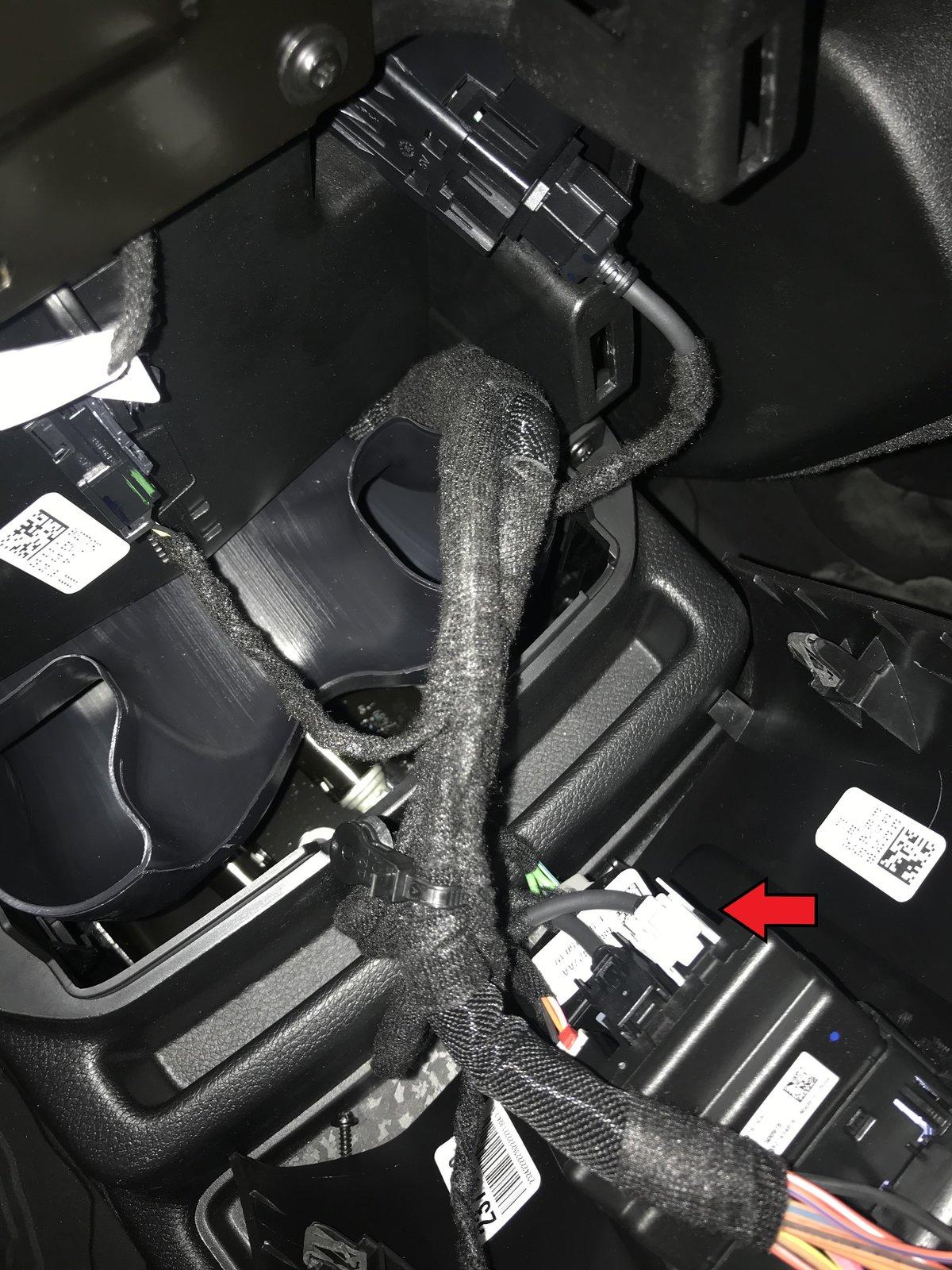

Sorry if this thread is a little old, but it seemed like the most appropriate place to post - I had this exact problem from the very first evening. At first the center console USB was intermittent, then after a couple days it stopped working completely.
After dismantling the dash to check the head unit connections, and lifting the console to check for pinched wires, I found the culprit after removing the rear console cover since I couldn't access the interior USB connector from underneath. Turns out the connector (which piggybacks off the rear USB assembly) wasn't snapped in all the way.
Thanks for this post, I stumbled across it recently and it inspired me to take a look around. Since day 1, the USB in my center console hasn’t worked consistently, always worked fine at the dealership. In the past, I have take. The center console apart, and it worked for a day or two, and then started acting up again.
This time I went extreme, I pulled apart both the center console and the dash, and unplugged and reseated all of the usb connections several times. Then I put everything together again.
I have been using CArPlay exclusively since doing this, about two weeks, and I have had no issues :rock: .
