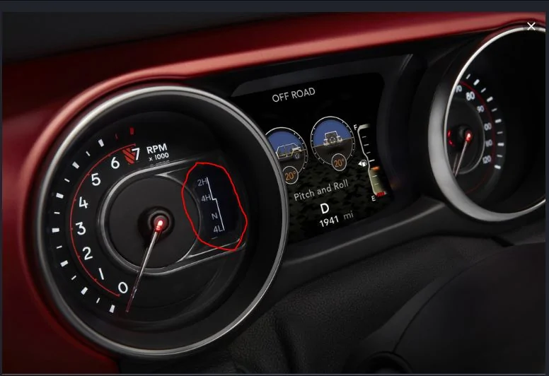

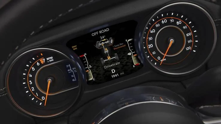

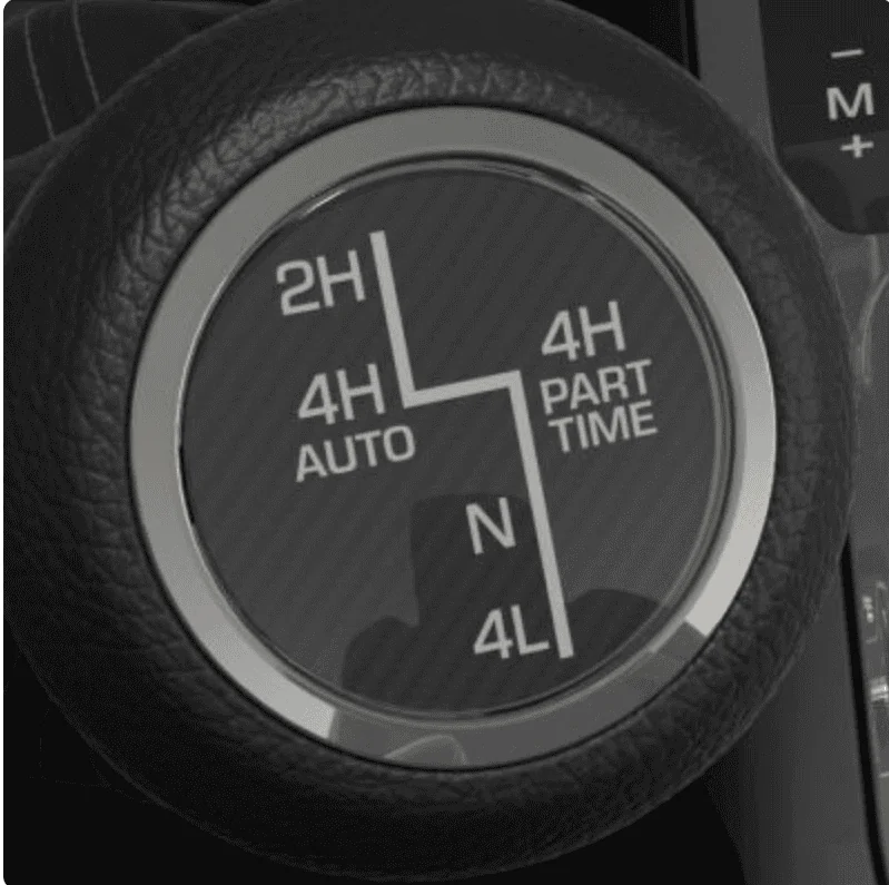

I’m not sure I’ll have to look it up. The guy at the dealership didn’t show anythung about 4w auto
Look on the 4WD indicator on your instrument cluster (next to the tachometer) and/or your 4WD shifter. If there is a 4H Auto next to 4H Part-Time, that means you have Selec-Trac, which comes with a 4WD mode that can be used all the time —well, excluding the trail.
Jeep Wrangler JL 2H vs 4H 1603114937116
Jeep Wrangler JL 2H vs 4H 1603114974409
If they look like this, then your Sahara has Command-Trac, in which case you need to observe the recommendations listed by others above.
Jeep Wrangler JL 2H vs 4H 1603115528765
Jeep Wrangler JL 2H vs 4H 1603115182723
Good luck!
