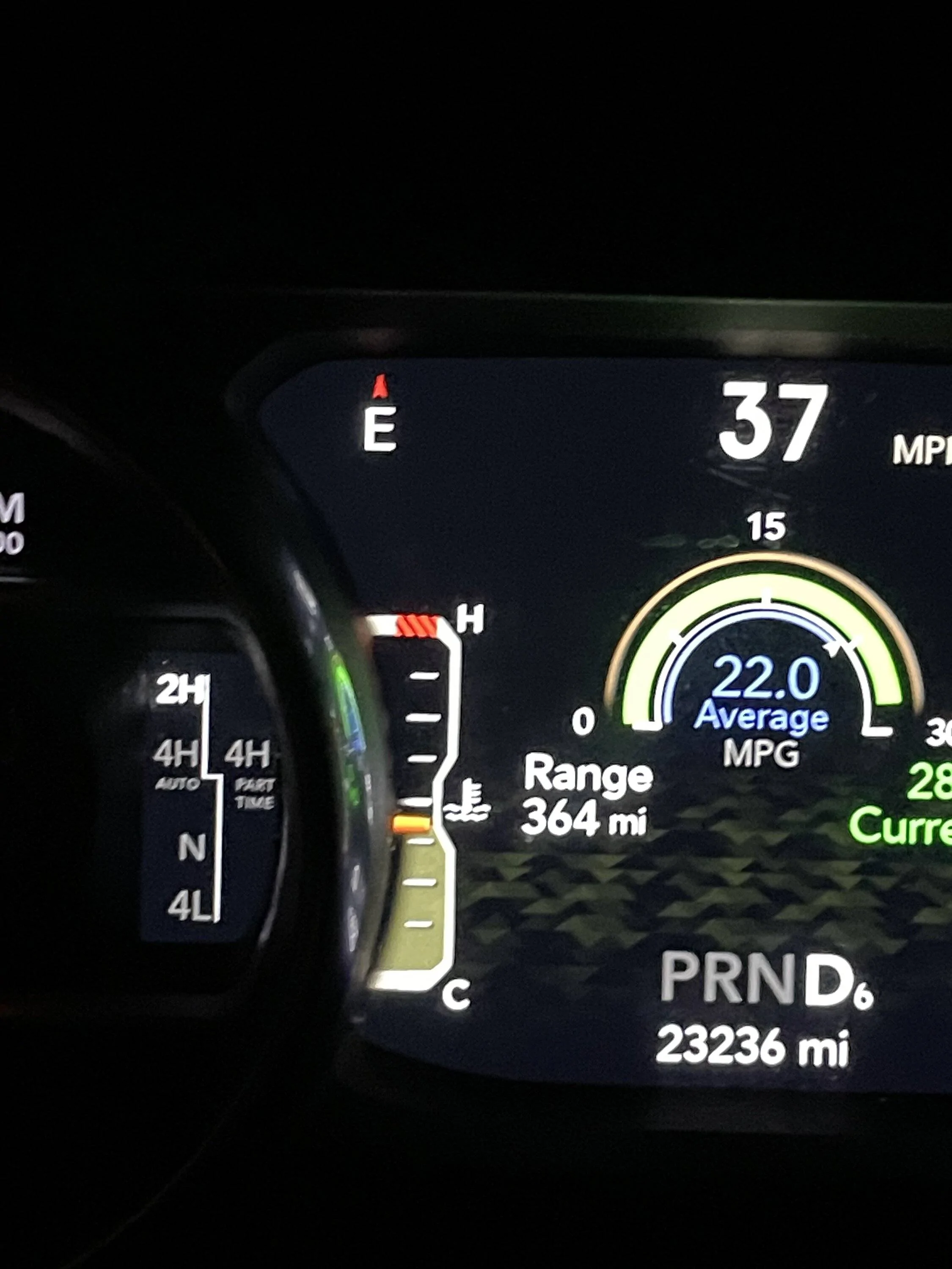

Indeed, Jeep "hid" the 2hi function in the transfer case on the 392's, I believe their reasoning was probably something along the lines of "this engine has too damn much horsepower to be safe to drive in 2wd". The Tazer allows you to access the hidden 2Hi mode.
Also a 4xe owner here, and I agree with you that I also just leave mine in 2hi 95% of the time. No reason to waste gas spinning the front driveshaft for no reason when I'm just commuting on the highway to work. The torque/hp is the same as 4hi when you're at highway speeds, it only gets throttled in 2hi at lower speeds, say < 30mph or so.
I still miss locking hubs!

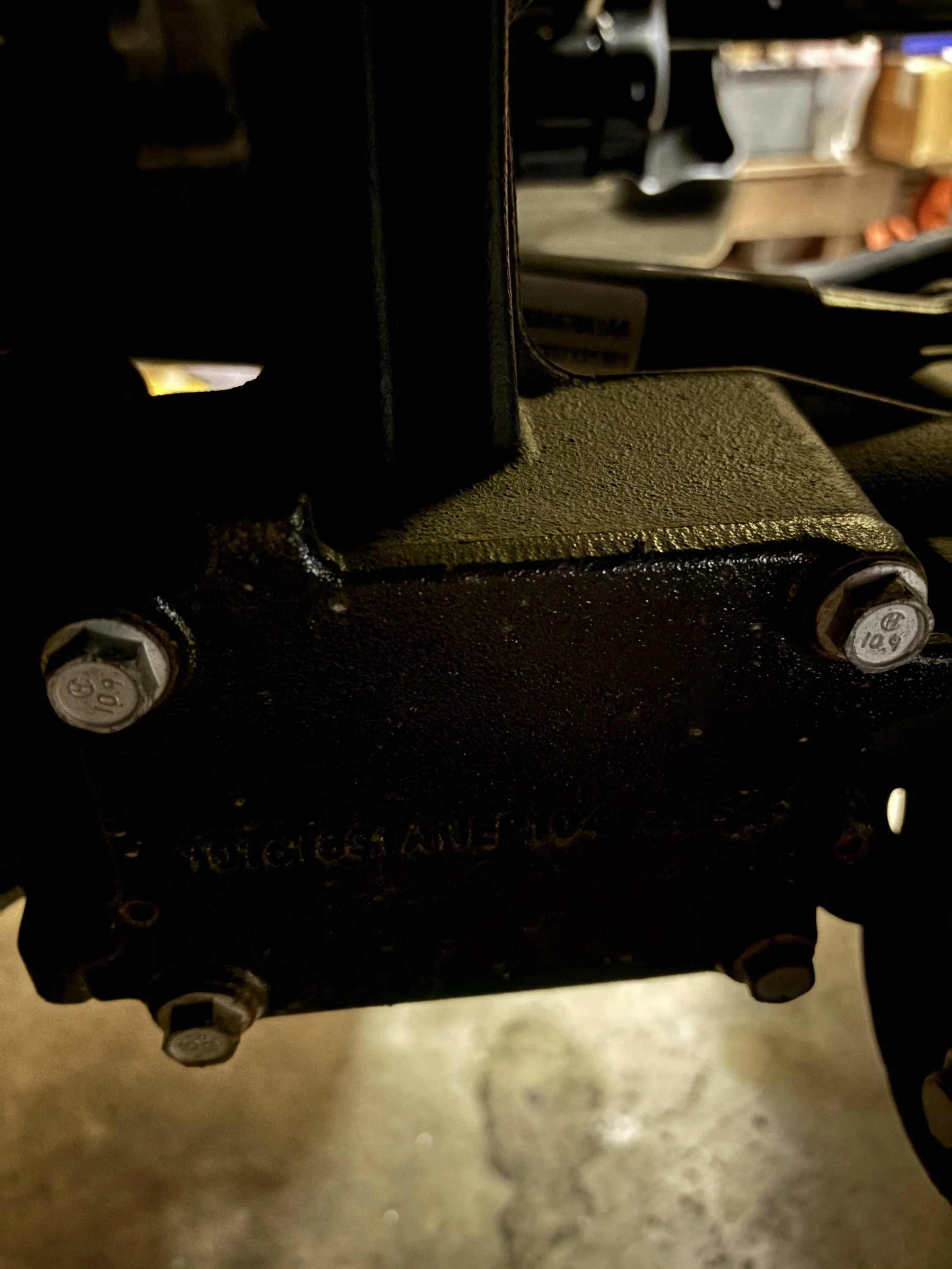

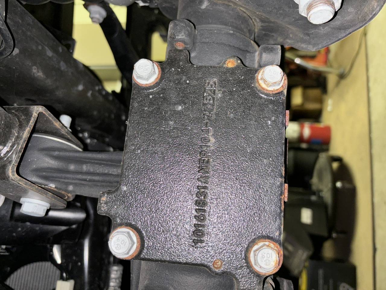

FAD nowhere to be found on a 392
Jeep Wrangler JL 2H drive 86FB65D7-11BD-44D7-A3CE-8DA39938E217
Jeep Wrangler JL 2H drive 64F24D67-1EF9-43FA-8FE7-0565D71C26B6

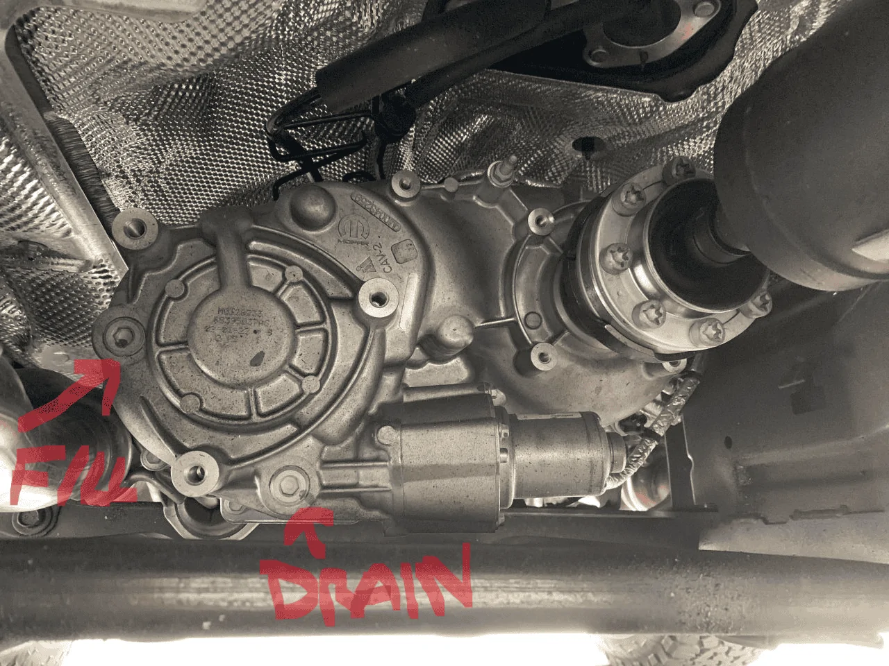

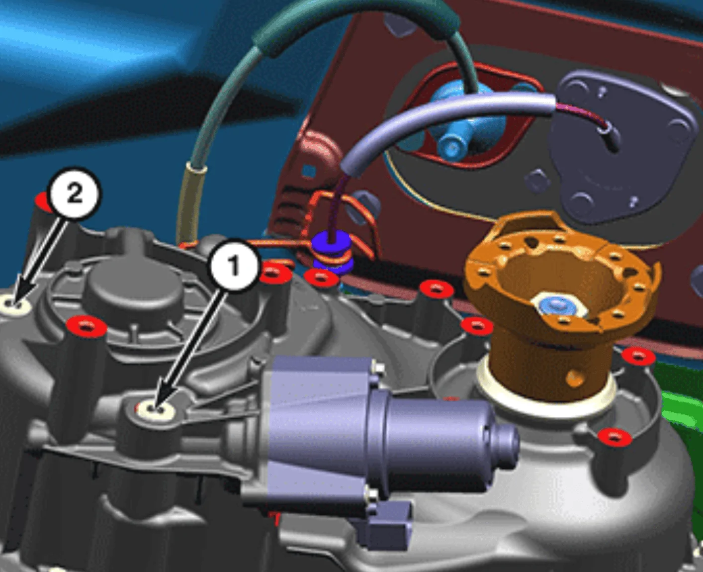

Nope it's definitely still serviceable. Uses standard ATF like regular gas and diesel Jeeps. 21ft lbs torque spec.
Jeep Wrangler JL 2H drive mp3022 transfer case diagram
Jeep Wrangler JL 2H drive mp3022 transfer case photo

Thanks for the heads up, I could swear that it was considered unserviceable, maybe my Raptor was or the wife's Grand Cherokee. Now I`m on a quest to see where I had read that
