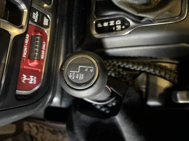

What was weird was after coming out of the woods and I have never had this happen … it’s like it was no in gear. And when I went to accelerate… the engine just rev’d. And I finally got it to go. But I never saw 2H highlighted.
Yesterday I went down the road and it did the same thing and I couldn’t figure it out unless I was in neutral obviously.
I have since this morning gone and put it in 2H. So going forward like I have always done .. put it in neutral, pull down to 4H in the woods and I should be fine. Then when I come out just put it back in 2H.
I’ve done this before for 3 years and it’s never been a problem I’ve just never seen 2H illuminated … or I’m just dense lol
You may want to check the transfer case lever adjustment, on the link I noted above. Perhaps it’s not engaging back into 2H due to the adjustment being out of spec. It’s easy to do.

As others have said - we need a bit more information from you before we can comment.
The owners manual has all this stuff explained BTW.
1. There are two different 4wd transfer case types.
a. one of them has 4wd auto plus 2H, 4Hauto, 4H part time, neutral, and 4Lo. This is the more expensive option.
b. the other one only has 2H, 4H, neutral, and 4Lo - this is the standard old school 4wd
2H should be your normal driving mode for city and highway in good weather. It will give you the best gas mileage. You can drive at any legal speed ;)
4H can also be driven at any safe speed, but ... should only be used in slippery conditions.
Do NOT drive in 4H (4H part time) on dry pavement when you have good traction on all 4 wheels. This mode locks the front and rear axles so they turn at the same speed and is designed for when you have some wheel slippage on dirt roads, snow, etc. On a dry road you will either put stress on the drive shaft or you will chirp the tires as you turn corners and such.
For those who have 4H Auto - it has a clutch system that allows you to leave it on all the time. Set it and forget it ... at a small cost to gas mileage. This is similar to an AWD - all wheel drive system.
N is for flat towing
4L is for when you need high torque and low speed.
Read your owners manual
Yeah I guess I should have pulled out the owners manual lol. I have driven 4WD before and never had a problem. This is just my first Jeep. Back in my day we had to get out and lock the hubs lol.
mine in your pics is option b. I do t have the auto.
