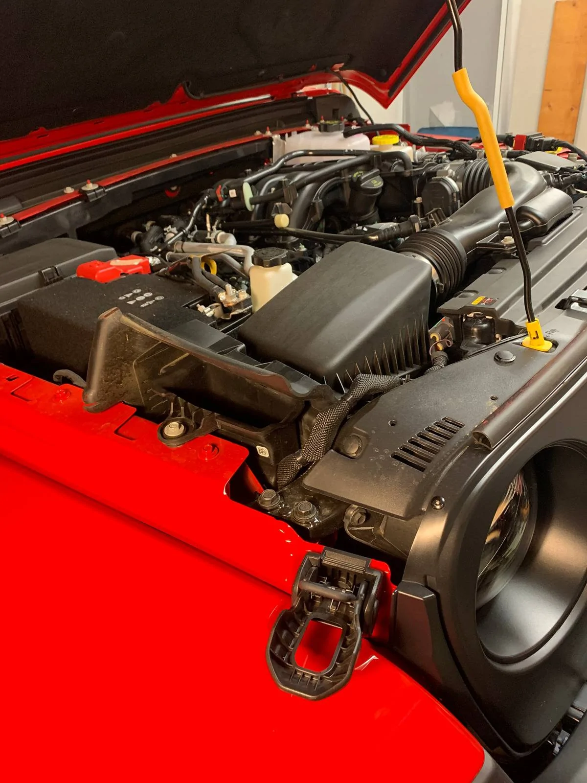

Jeep Wrangler JL 2024 Cold Air Intake IMG_0641
I am preparing my 2024 Rubicon X build and I am looking at the CAI option for $525. I am not planning to add a snorkel, but if I were, how difficult/expensive is it to add the CAI aftermarket? Are there other benefits of the CAI on a Wrangler, and finally for those that have it, would you say it is worth it? Thanks in advance!
In 2022 and 2023 there was no reason to order the CAI. I did not order the CAI with my 2022 Sahara or my 2023 Rubicon. This is the way they both came from the factory. All I would need to do is cut out the hood. That should be a lot cheaper then $525...

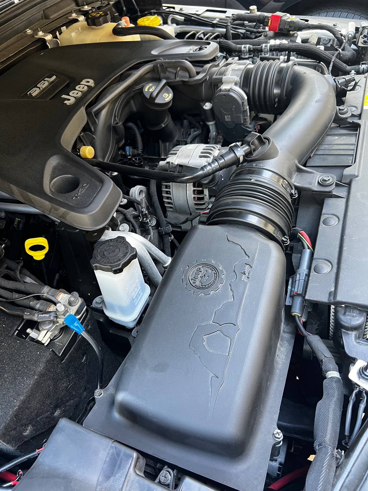

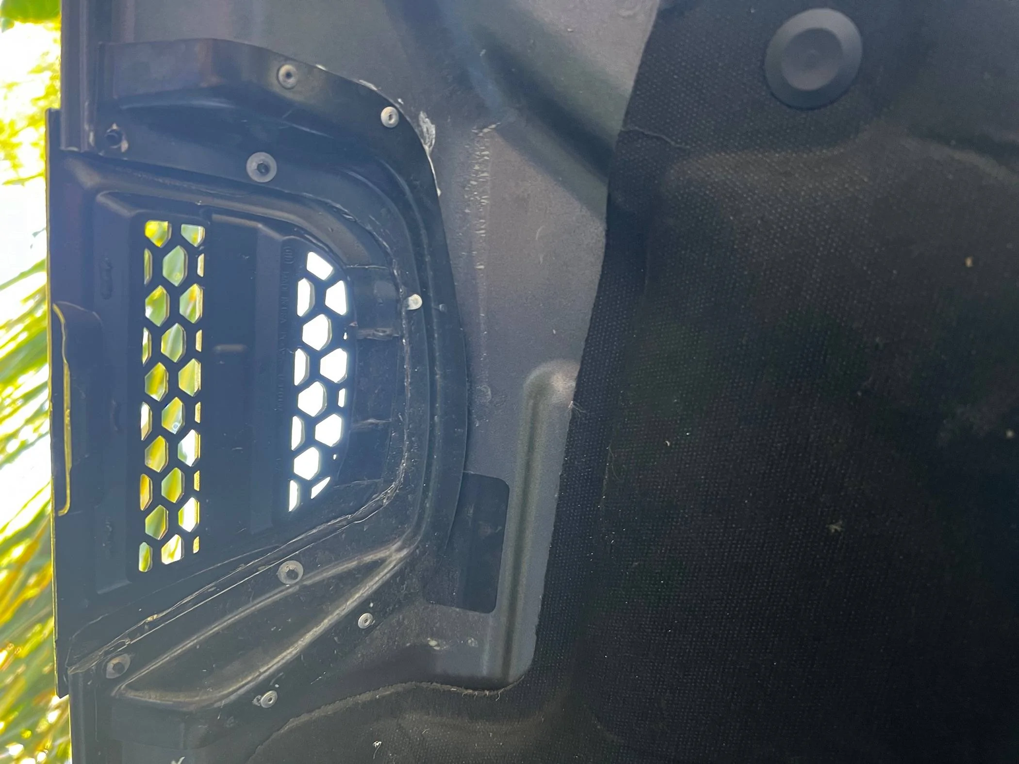

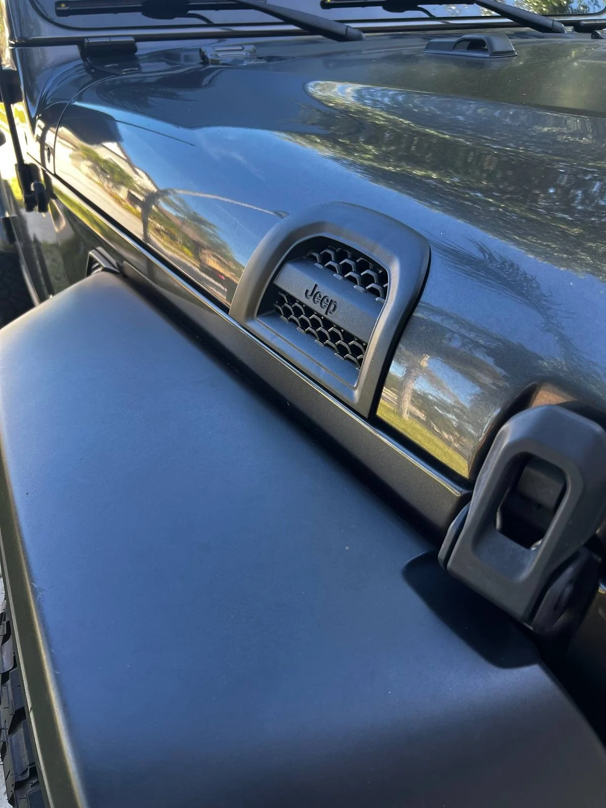

I have the mopar cai, and can attest it hasn’t done much of anything measurable. That’s said, I like idea of it scooping air from outside, particularly here in Florida where under hood temps skyrocket.
I do understand there is a little duct pulling air from the front, that said, sitting in traffic that does nothing. The kit uses the stock lower box and only comes with the upper box and intake hose, pcv connection and new inlet air temp sensor.
It does not have the resonator the stock unit has, probably why it sounds the way it does. Also comes with “cover art?”
Have had it for two years, still like it.

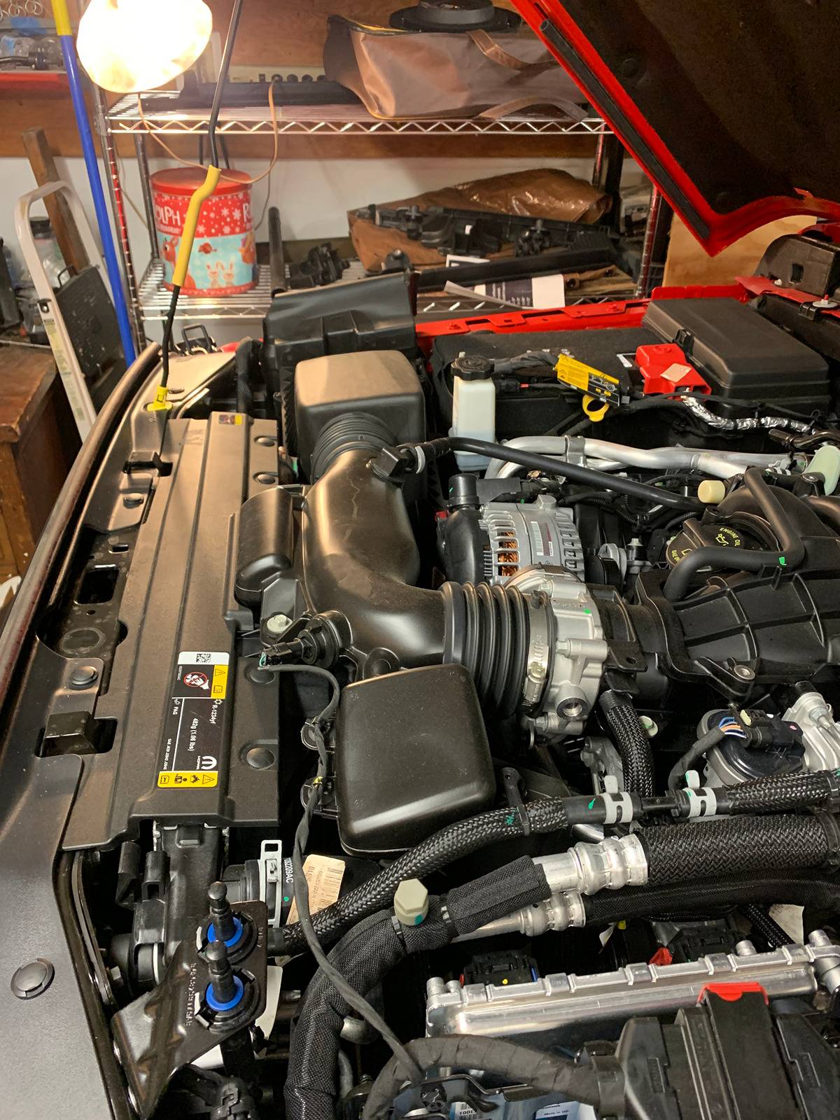

I have this on my 3.6 really happy with it.
Jeep Wrangler JL 2024 Cold Air Intake IMG_1618

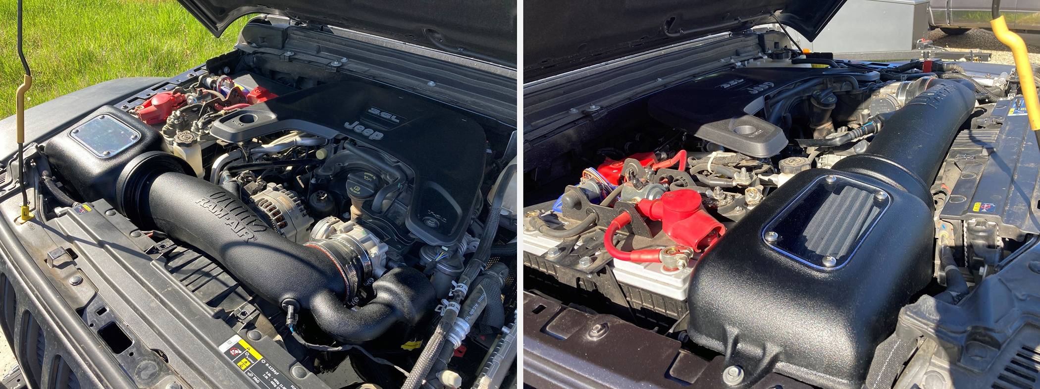

I'm breathing easy with Banks Ram Air and MBRP Flo-Through 2.5" Stainless Cat-Back (Stock Resonator & Muffler delete)
Jeep Wrangler JL 2024 Cold Air Intake BanksRamAir
