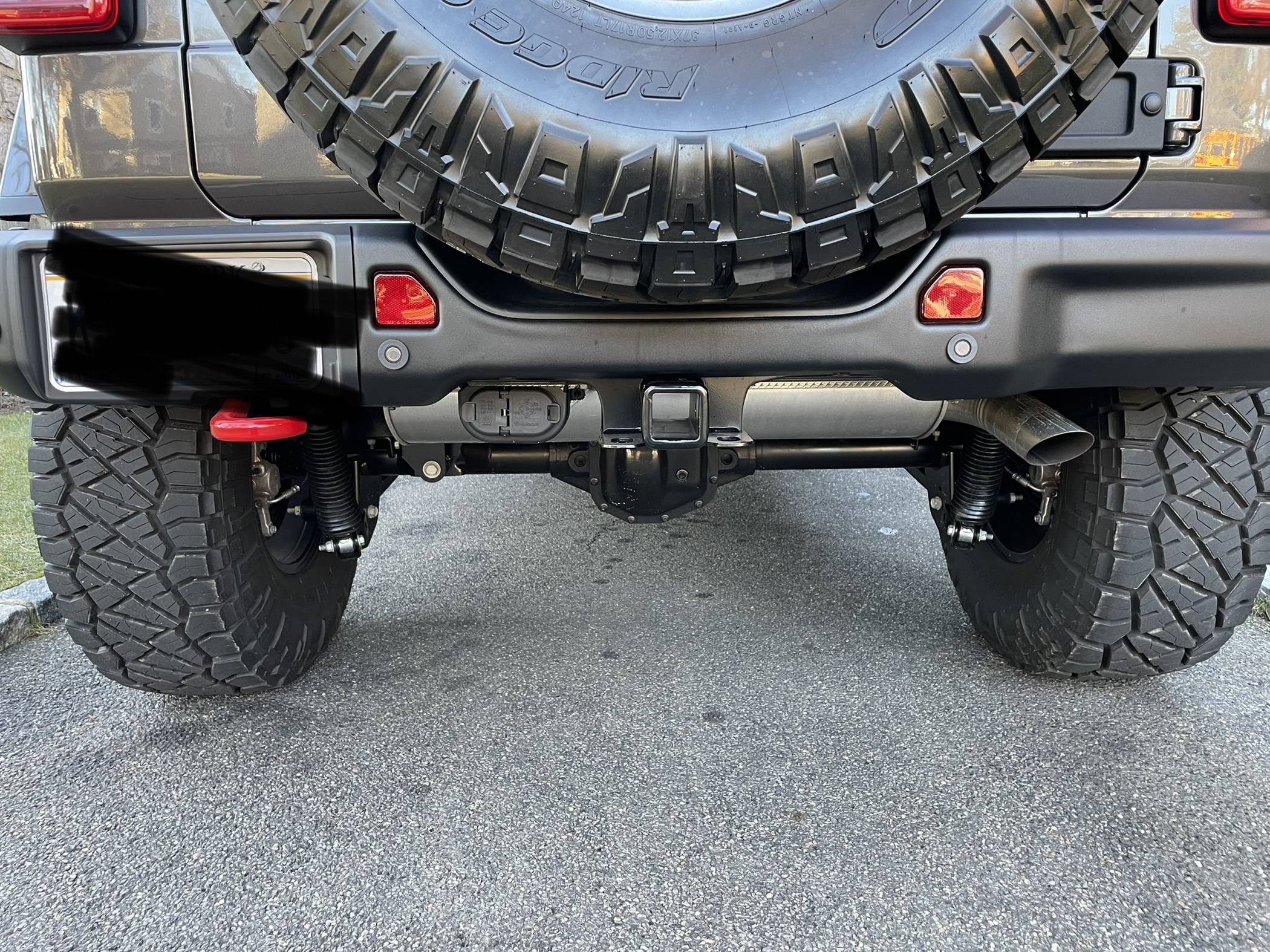

Just in case anyone else cares (and for anyone looking in the future)… They noted TSB-08-110-19 which calls for a reset of “Parktronics module.” They also… rotated the spare tire to 3:00 because the TPMS sensor was interfering with back driver’s side sensor.
I could have done that but I figured it wouldn’t be an issue with a friggin’ factory spare.

So was it a defective spare tire/wheel/TPMS? In other words, if I purchase an identical spare tire/wheel (of the same model), could it resolve the issue? If so, maybe I could come to my dealer and ask them to replace the spare under warranty.
BTW, my spare starts and persists failing (wipe rear sensors issue) at 67 degrees of air temperature and higher when TPMS is at 1 o'clock position. When it is at 6 o'clock position the issues starts and persists at 55 degrees and higher. So, in winter time I don't see this "PARKSENSE UNAVAILABLE WIPE OFF REAR SENSORS" issue. In summertime it's here almost non-stop.
