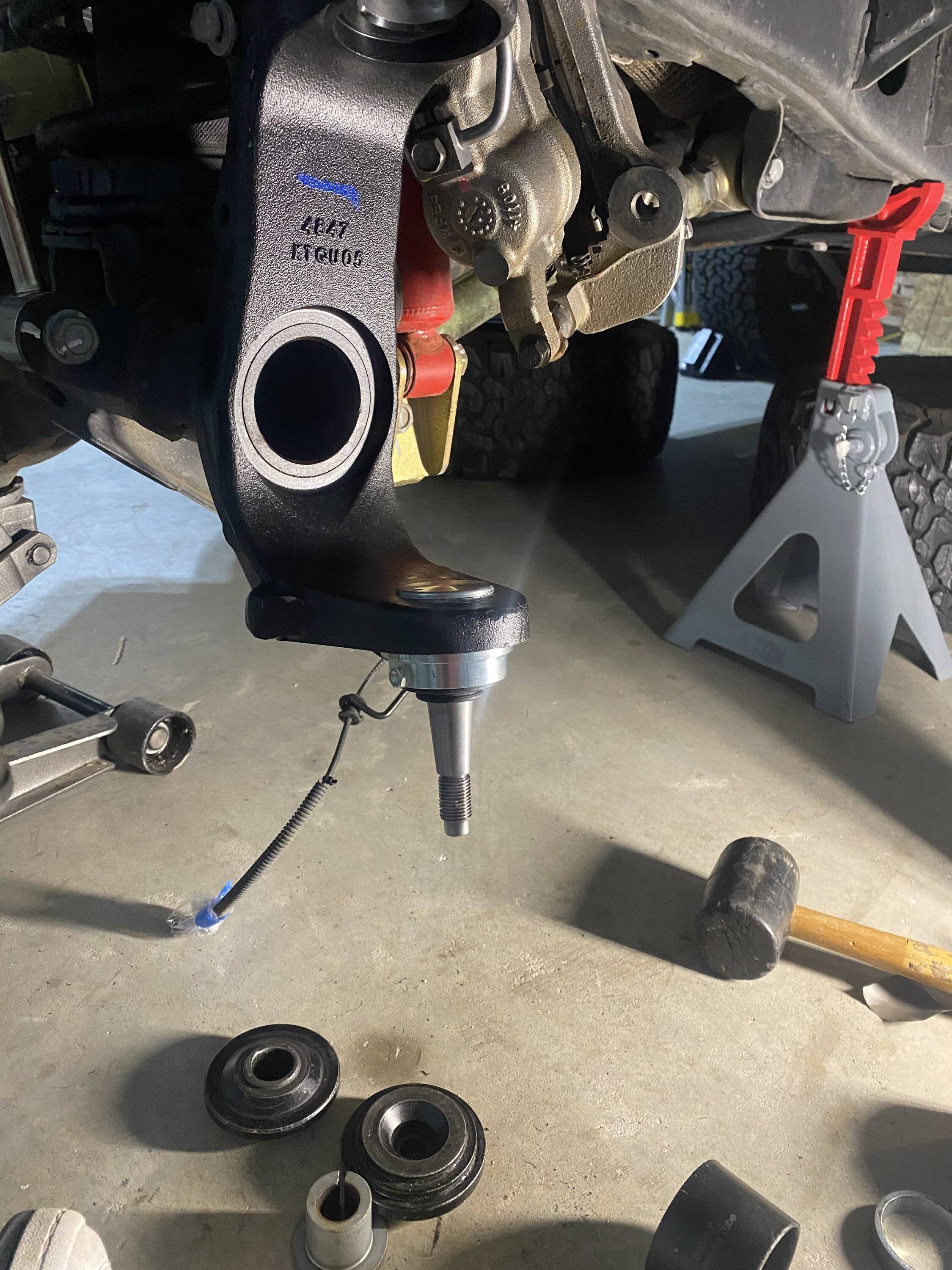

I got the first lower Dynatrac ball joint installed. Look at that shine!

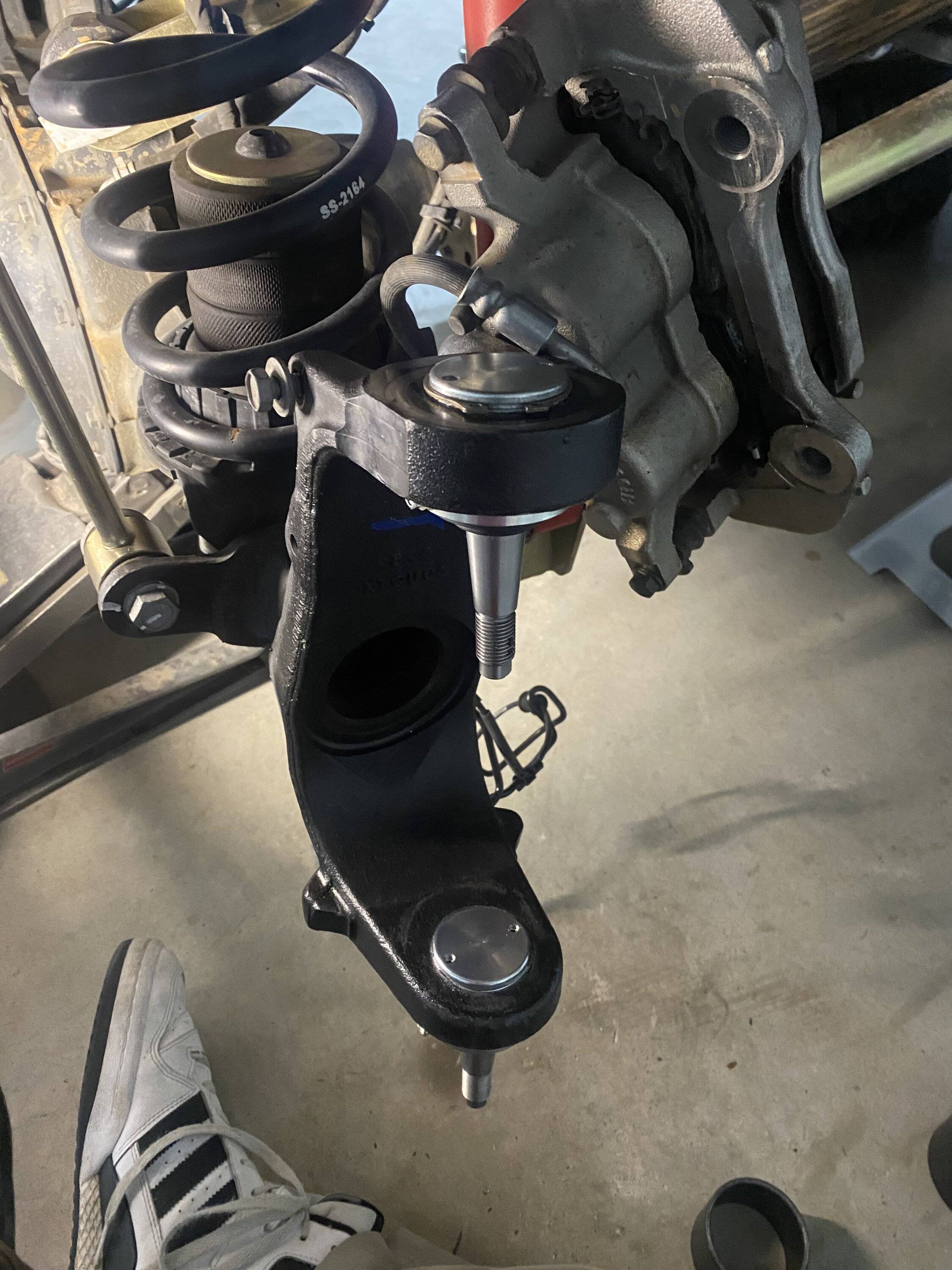

That snap ring for the top ball joints is a pain in the a$$ without a good set of snap ring pliers. I made due with what I had but it took a lot longer and a few cuss words.
