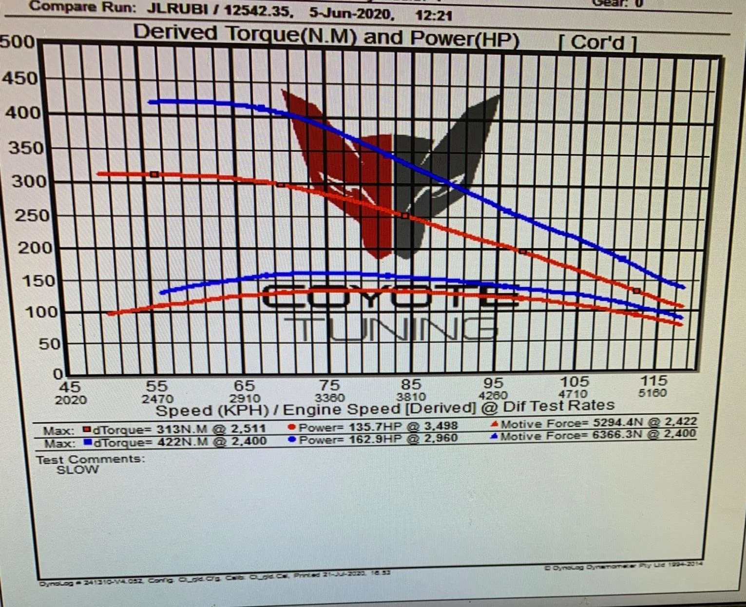

I have just had my JL 2.2 Multijet remapped. There's heaps more torque and Horsepower now with very little lag. I had it done by a local specialist custom tuning company, Coyote Tuning in Brisbane Australia. They do a pre tune dyno run and another after the tune. see attached the results
Jeep Wrangler JL 2.2 diesel tuning JL dyno results

Wow, the torque increase is impressive, but I wonder why pre tune measurement shows only 136 hp and 313 Nm if technical data says 200 hp and 450 Nm ... Or that is what's exactly measured on wheels?...

I have the same question :like:

I would also say that it looks pretty low.
Keeping in mind that the US uses HP and the UK and Australia use BHP, which will be slightly less.
Still, with an automatic transmission, the difference between CHP and HP at the rear wheels will be 18-20% of the PHP value.
So, you should see about 156 HP at the wheels. Since we lose about 2-3% for pumps and what not, that takes us down to perhaps 150-155 HP.
As such, 162 HP would be a slight increase in the expect power to the rear wheels.
A figure of 135 HP would more than 30% below peak Power, which indicates that something was pretty wrong with your engine.

The figures on the chart are based at the rear wheels whereas Jeep quote figures at the flywheel/engine
