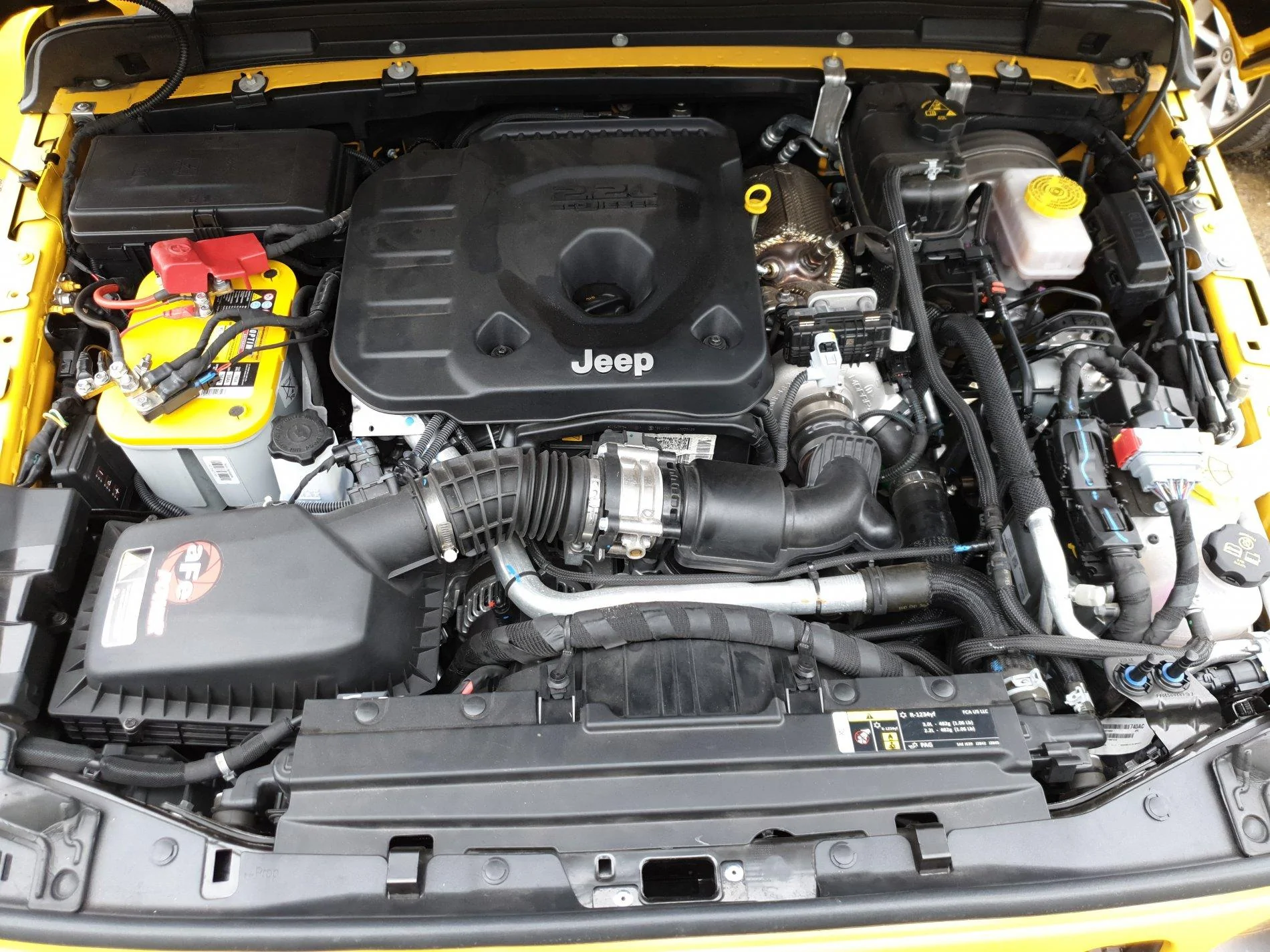

I'm going to see him this Friday to do measurements. Can you post a photo of your engine bay so I can see what differences there are.

OK I'm going to go take some pictures as soon as possible, thanks for your help. :like:

Got some bad news to report. There isn't enough space under the bonnet of the RHD JL to fit a catch can. Tried off the shelf ProVent 150 and 200 as well as a prototype that he's working on that uses the 150 filter in a billet housing (still circular but physically smaller than the 150). There are some spaces lower in the engine bay that it might physically fit but with the over pressure vent on them they have to be mounted high otherwise you risk ingesting water. He has taken photos and will look again but he said at this stage without going to a custom, specifically shaped, housing then it doesn't look like he'll go ahead. Custom housing would likely be $1,000 per kit and that is if he could guarantee 100 kits to justify the set up to make them.

Horsepower factory in Melbourne advised the same no room for a catchcan unless behind the inner guard but would have to take it off first to get a better idea if there is room...

Looking to try something here but I can't see the crankcase breather for the life of me. If you look at SwissSteph's photo above, where would the crankcase breather be. It doesn't appear to have the hose coming back into the top like the photo on page 1 provided.

I did take the cover off but there was not much that I could notice under there. Maybe I am going blind. The photo posted on the previous page does not relate to our engine. That hose is just not there. I am looking at the intake pre turbo and can't see the breather in there.
Any ideas?
