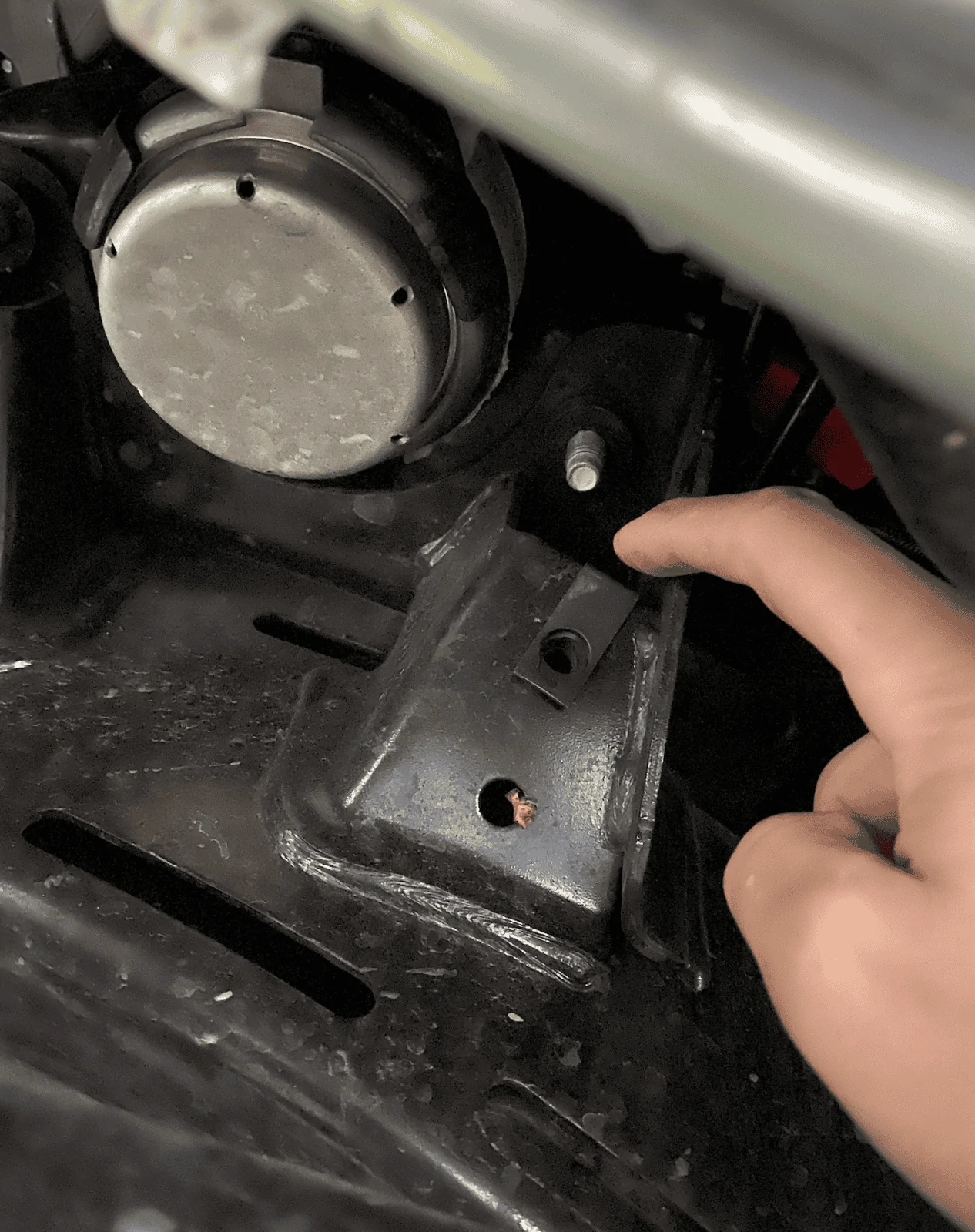

I am guessing the difference is mine is a 2 Door.It just will not fit.There is an extreme gap and the bolts will not reach.Even if they did the Skid would be at an extreme angle.Thanks for all of your assistance we will see what Asfir says.
See here, how the coolant pipe mount is much higher to the body tub?
I really appreciate all of your help they are going to credit for the bracket here is what they have said
Thank you for all the photos and explanations – much appreciated.
This is the first time that we are aware of this bracket on the JL vehicle. This is not assembled on any of the models that were imported to Israel.
We would appreciate it if you could try and check from your side if this is assembled on a specific model of the JL only or any other information that could help us for future reference.
In any case we apologize for any inconvenience caused and will credit your PayPal account for the cost of this item($102) and the proportionate freight charge ($24).Please confirm that this is acceptable.
Regarding the plate itself – we are checking and will advise you what to do with it shortly.

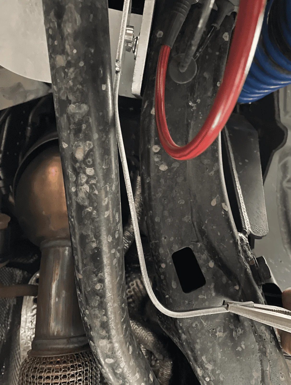

I finally had some time to install the skid. It was a straightforward installation; it was completed in about 30 minutes. My recommendation for any install is to take a moment and get familiar with all of the hardware so you can visualize where it all goes. This kit has very little hardware, so there should be no confusion.
I started with the left side bracket because I figured the capture nut would be the trickiest part of the whole job. I recommend that you lay directly under the frame rail so you can clearly see how you need to bend the rod. I found it was easiest to use some locking pliers to hold and manipulate the capture nut. Insert the nut through the aperture in the frame located in the wheel well. (see the last photo)

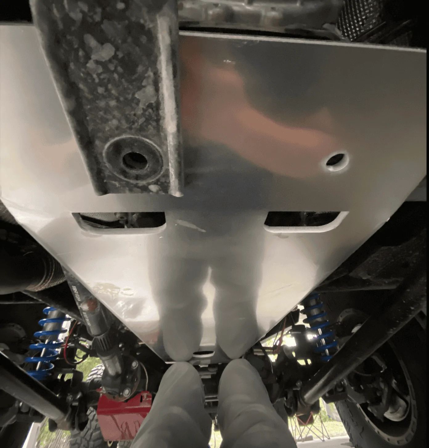

Once you have both brackets loosely installed, you can go ahead and install the skidplate. I found it was easiest to lay with my head to the back of the Jeep and use my knees to hold the skid plate attaching the rear bolts first.
Jeep Wrangler JL 2.0 Engine Skid Plates Screen Shot 2020-06-05 at 7.38.48 PM

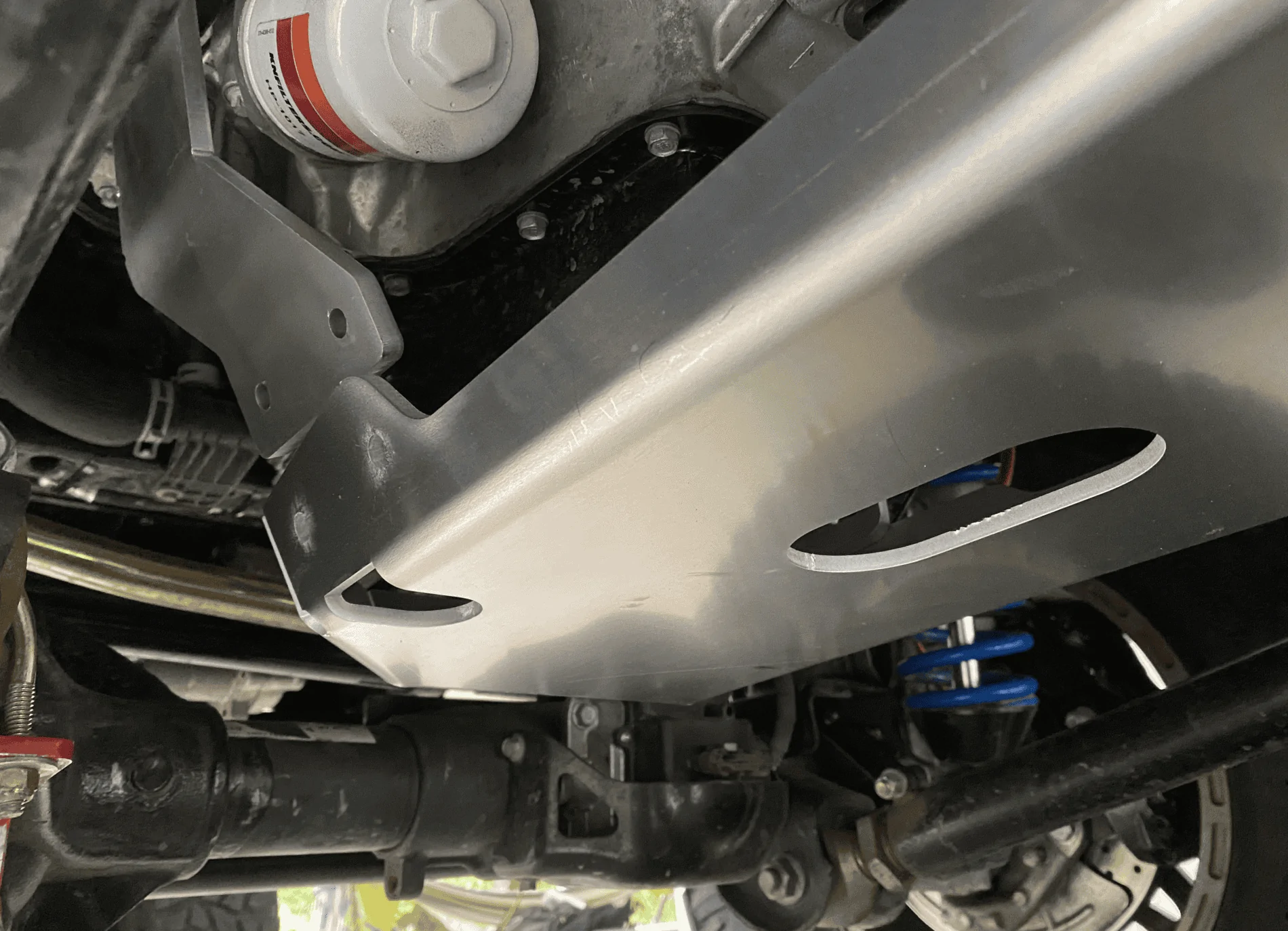

From here it's just a matter of securing in the remaining 13mm bolts with the nylon locknuts.
Jeep Wrangler JL 2.0 Engine Skid Plates Screen Shot 2020-06-05 at 7.42.08 PM
The capture nut was hardly noticeable so I didn't bother trimming it.
Jeep Wrangler JL 2.0 Engine Skid Plates Screen Shot 2020-06-05 at 7.39.53 PM
