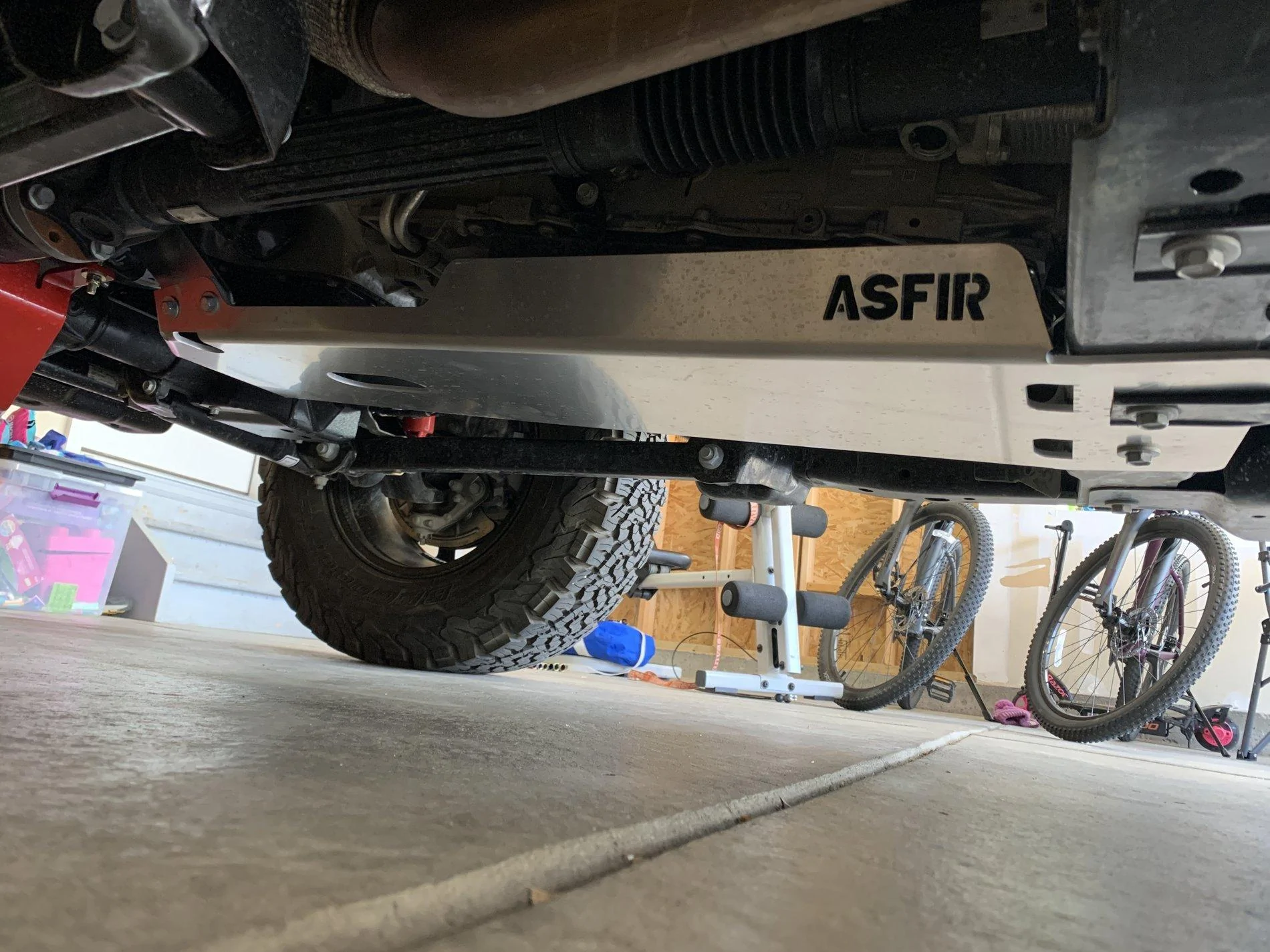

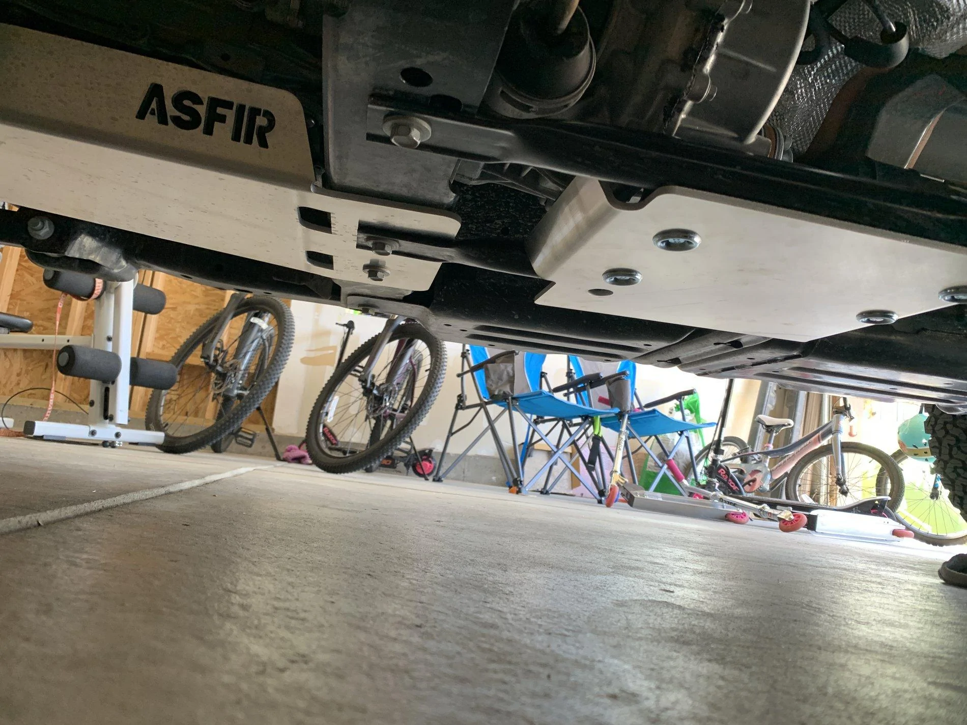

I also have the aluminum asfir setup. I wanted aluminum to save weight and wasn’t ready to shell out $2000 for a full underbody system. I’m happy with it and don’t recall having to pay any special taxes on it. Easy to install.
I haven't installed my ASFIR engine skid yet. The install directions, if you can call them that, say to remove one of the cross members before installation. Is that cross member replaced at some point?
No that cross member is replaced by the skid

Is this on the driver or passenger side? I just installed the ASFIR skids, I’m not lifted yet (soon to be 2wks) I wonder if there is an issue there as well under compression. any way we can see a couple pictures of yours? Thanks
