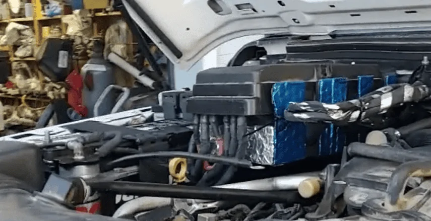

After playing around with the components I realized that the Fuse Box is quite large, basically
the same size and height as a large battery, so, If I could relocate the Fuse Box, then I could
use that freed space to install an additional battery .. :)
After some CAD (Cardboard Aided Design) I decided that I wanted to move the
Fuse Box to be on top of the passenger side of the engine bank (the engine cover /
stupid hood insulation things are gone) .. ... this idea required

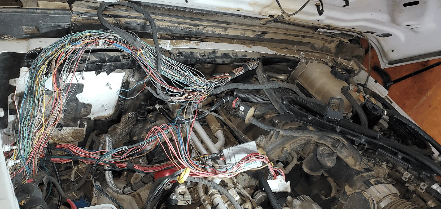

rerouting of the wire harnesses, the fuse box has 4 big connectors.. after unbundling
the harness and rerouting the wires I was able to reroute the wires with a surprising
low amount of wires needing to be cut and extended, a low percentage of the wires
needed to be disconnected from the connectors, unbundled, and then rerouted to
be able to reach the new location of the Fuse Box.. I was rushing to get the project
done so I forgot to take a lot of pictures... here is one from when I was in the middle of
unbunbling and rerouting the wires.. and another with some of the wire harness done..
Jeep Wrangler JL DIY Dual Battery System on 3.6L - The Cheap-O way 1691890902139
Jeep Wrangler JL DIY Dual Battery System on 3.6L - The Cheap-O way 1691894275638

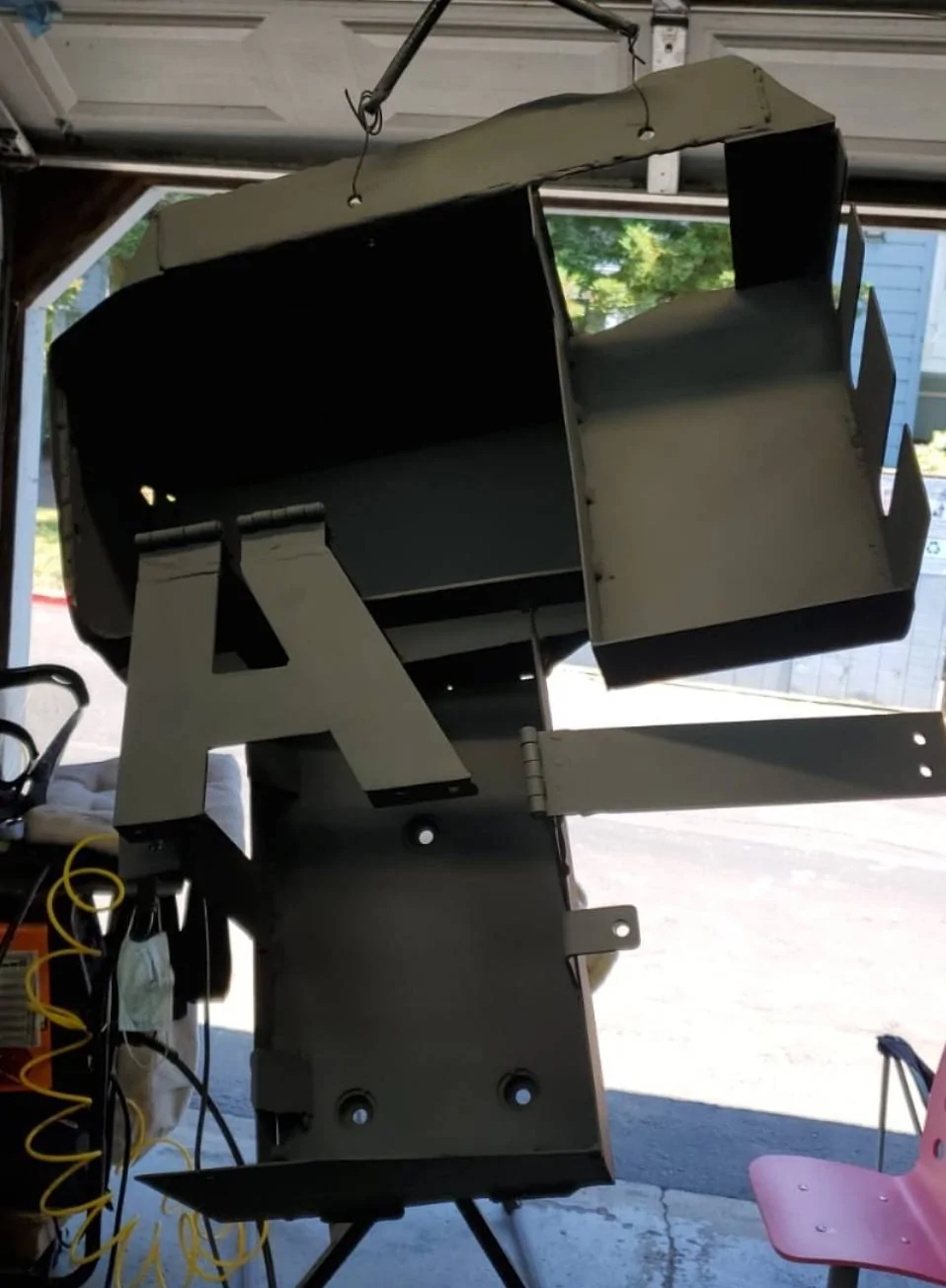

Here is the metal base I fabricated for the two batteries ( both are H7 size !!!! ) and the Fuse Box.. I rattled can it with some Ceramic High Temp coating...

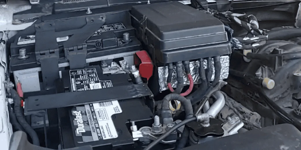

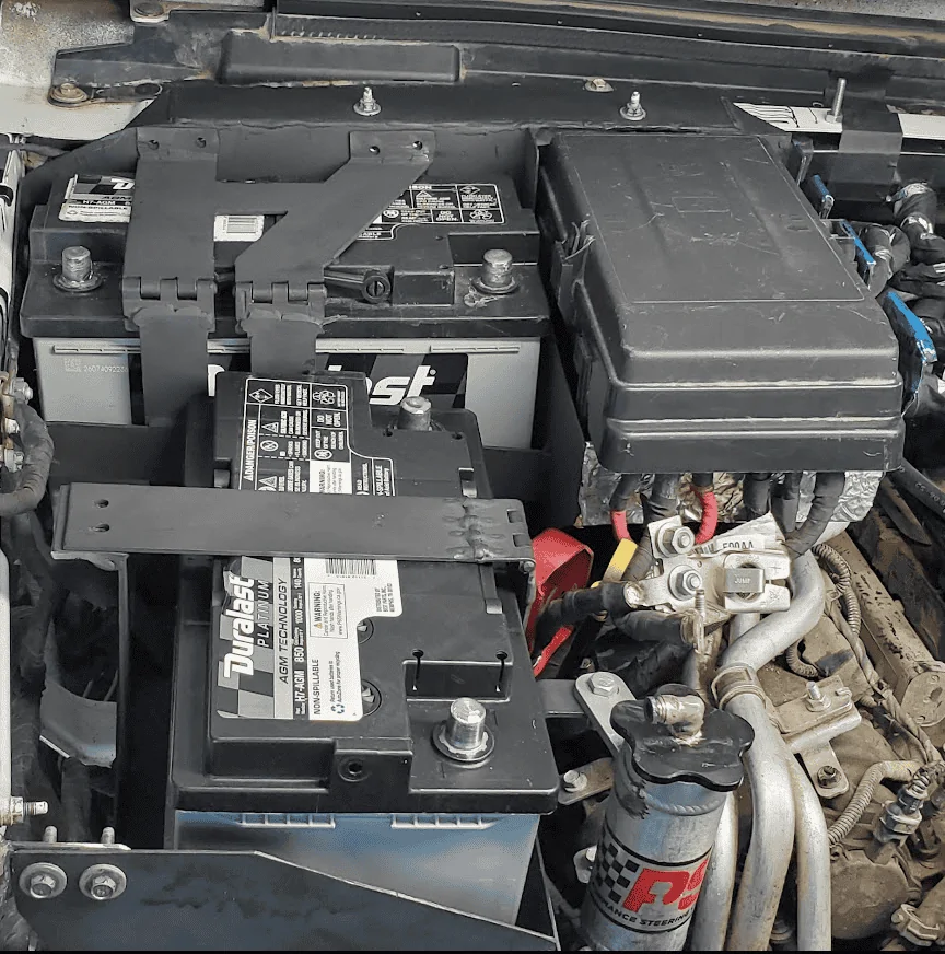

Here is everything assembled and ready to go!!
Jeep Wrangler JL DIY Dual Battery System on 3.6L - The Cheap-O way 1691897467058
Jeep Wrangler JL DIY Dual Battery System on 3.6L - The Cheap-O way 1691895206485
Jeep Wrangler JL DIY Dual Battery System on 3.6L - The Cheap-O way 1691895479644
Before you overdose on Sugar and start frenetically and mindlessly hitting
the keyboard with nonsensical comments about my design ( LMAO ).. keep in mind
that I have been running my JLU in the Summer heat with this new dual-battery
system, AND, I just came back from running the Rubicon Trail back and forth,
it was quite hot during the day... and I ran all the hard trails, including Little, Big, and Old Sluices..
so yeah, the design survived all the banging, drops, rocking sideways, heat, etc..
