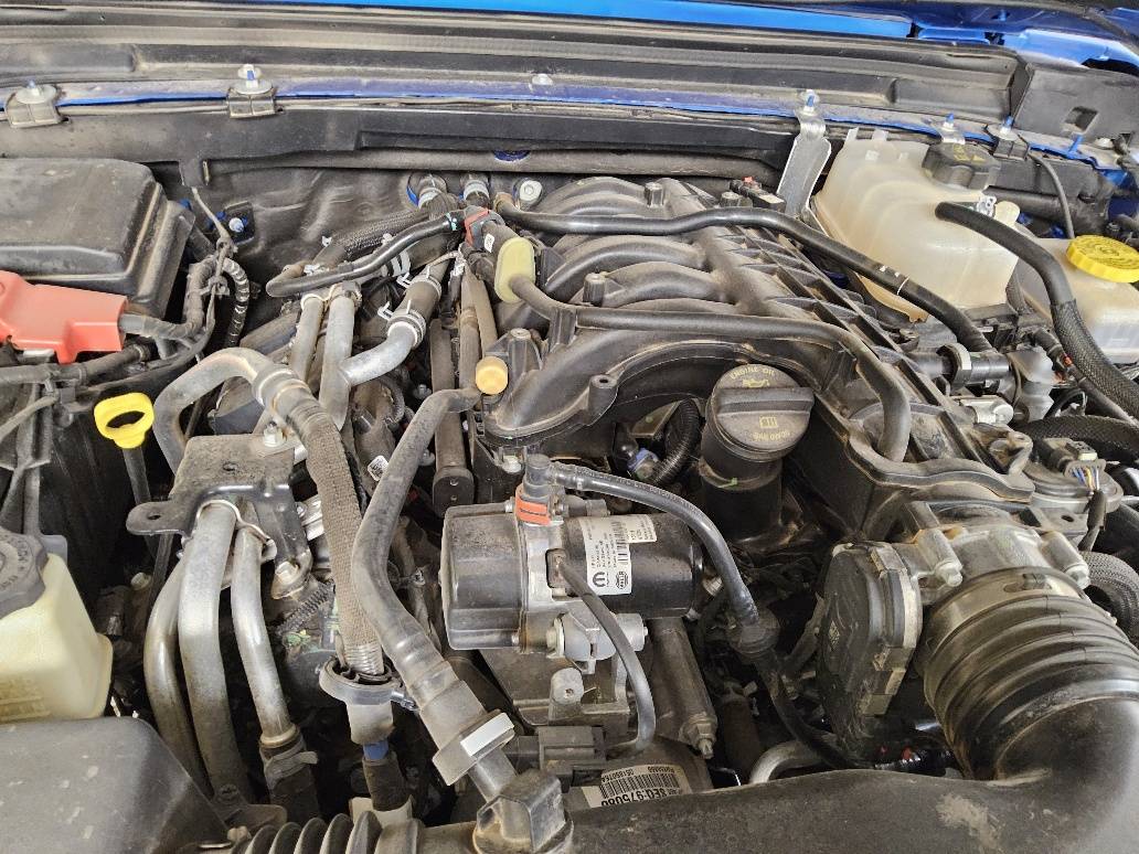

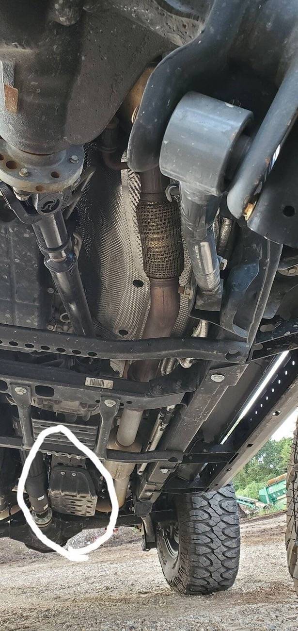

Do you have an etorque? Don’t bother looking at battery wiring, or how many coolant tanks you have or whether you have an alternator or generator. For my simple mind, no need to know anything more than this. Look under the Jeep for this suitcase size 48 volt battery.
Jeep Wrangler JL DUAL BATTERY SYSTEMS? Feedback / Reviews? IMG_2145
Jeep Wrangler JL DUAL BATTERY SYSTEMS? Feedback / Reviews? IMG_2144

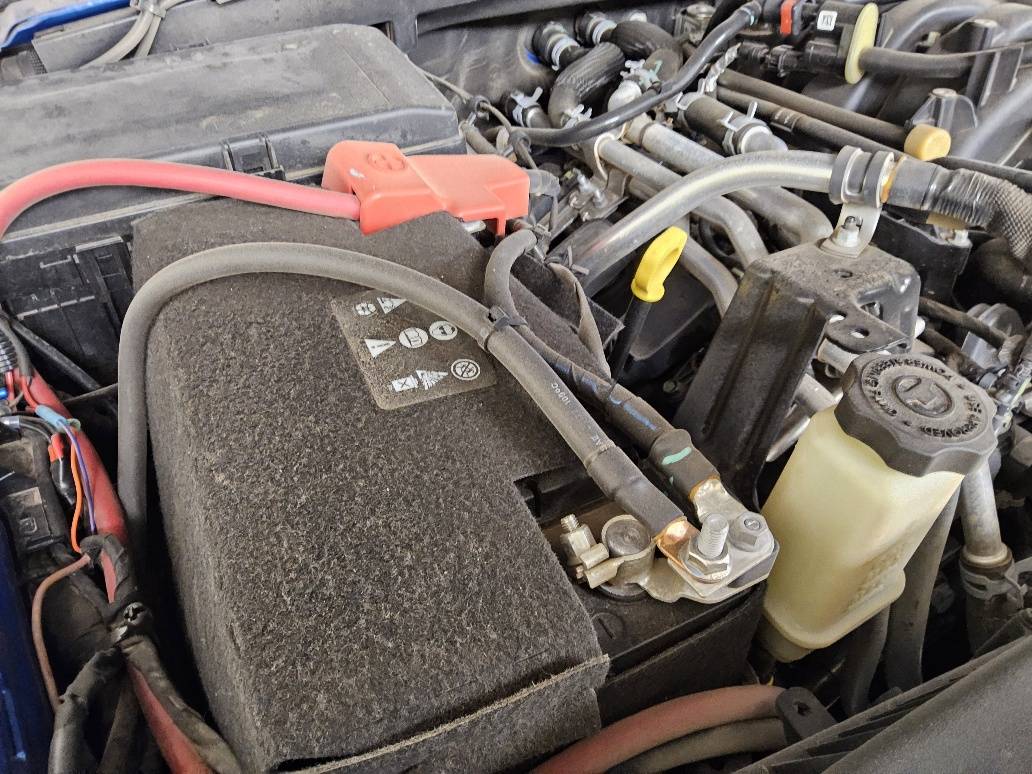

In the second picture you linked I see not one, but two cables connected to the negative post of the main battery.
Normally *from the factory* this is a telltale sign of the presence of an Aux battery. One of those cables, always present, connects to the body ground on the passenger's front fender. The other has, as its distal end the unseen negative post of the Aux battery.
But that said, I wonder if you have used that second connection point, absent from the factory, for one of your aftermarket appliances.

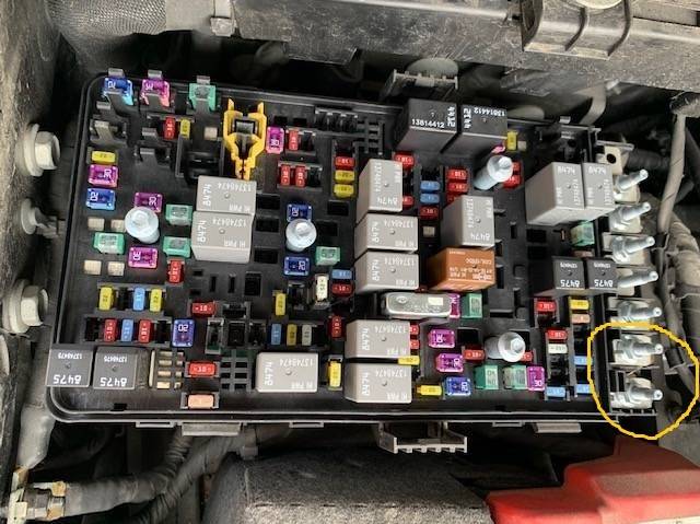

Behind your battery is that black box called the Power Distribution Center (PDC): your intelligent fuse box. If you pinch its cover clips and lift it up it will look something like the following picture inside. The two terminals I have circled in my picture below are N1 (closer to the bottom of the picture) and next to it N2. Unlike in this picture do they have a metal jumper connecting the two terminals? If so, I would think that despite the appearance of your battery's negative post with its two cables, that you may not have an Aux battery.
Jeep Wrangler JL DUAL BATTERY SYSTEMS? Feedback / Reviews? PDC
