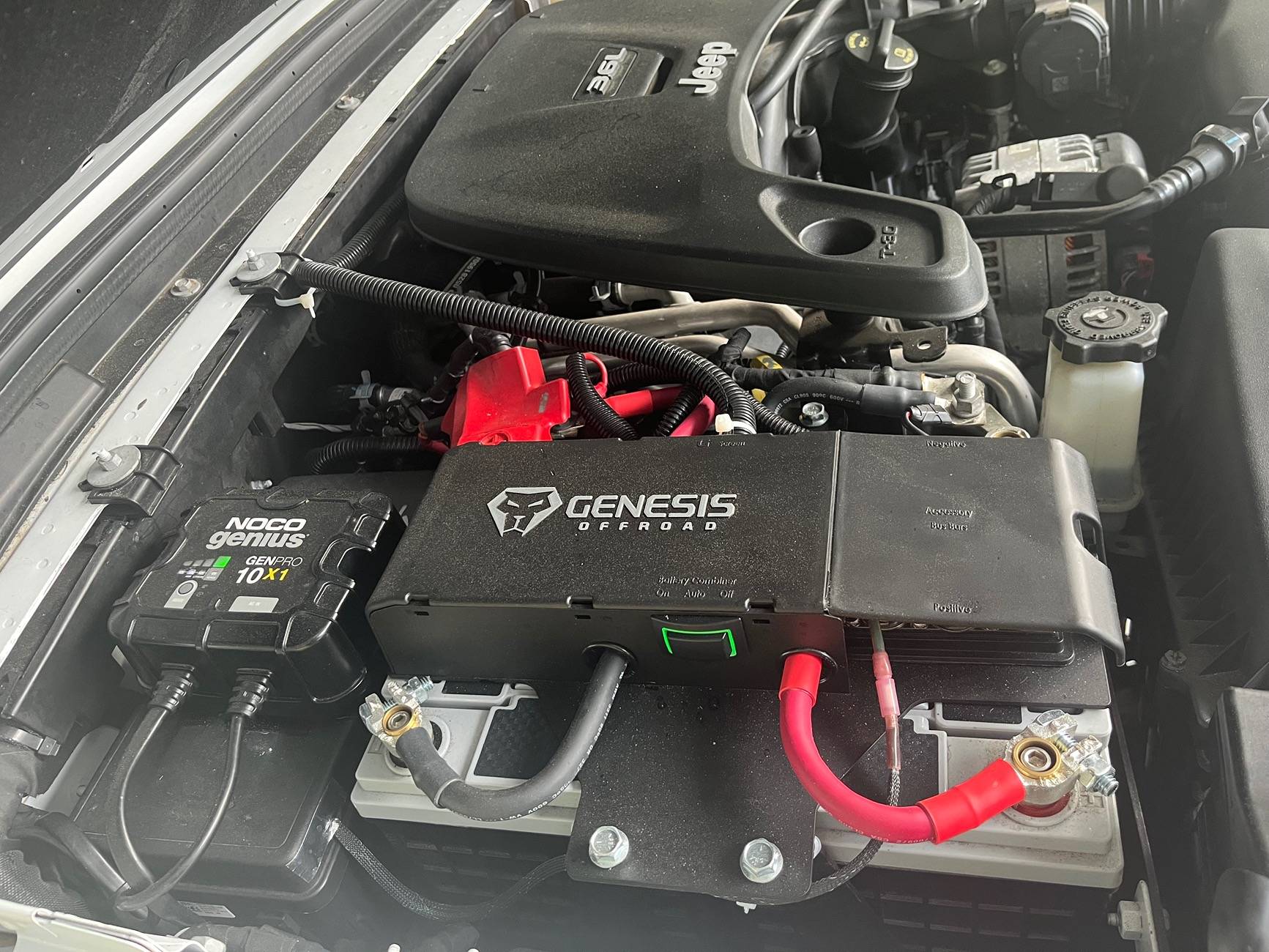

Hey Kenny:
In the second picture you linked I see not one, but two cables connected to the negative post of the main battery.
Normally *from the factory* this is a telltale sign of the presence of an Aux battery. One of those cables, always present, connects to the body ground on the passenger's front fender. The other has, as its distal end the unseen negative post of the Aux battery.
But that said, I wonder if you have used that second connection point, absent from the factory, for one of your aftermarket appliances.

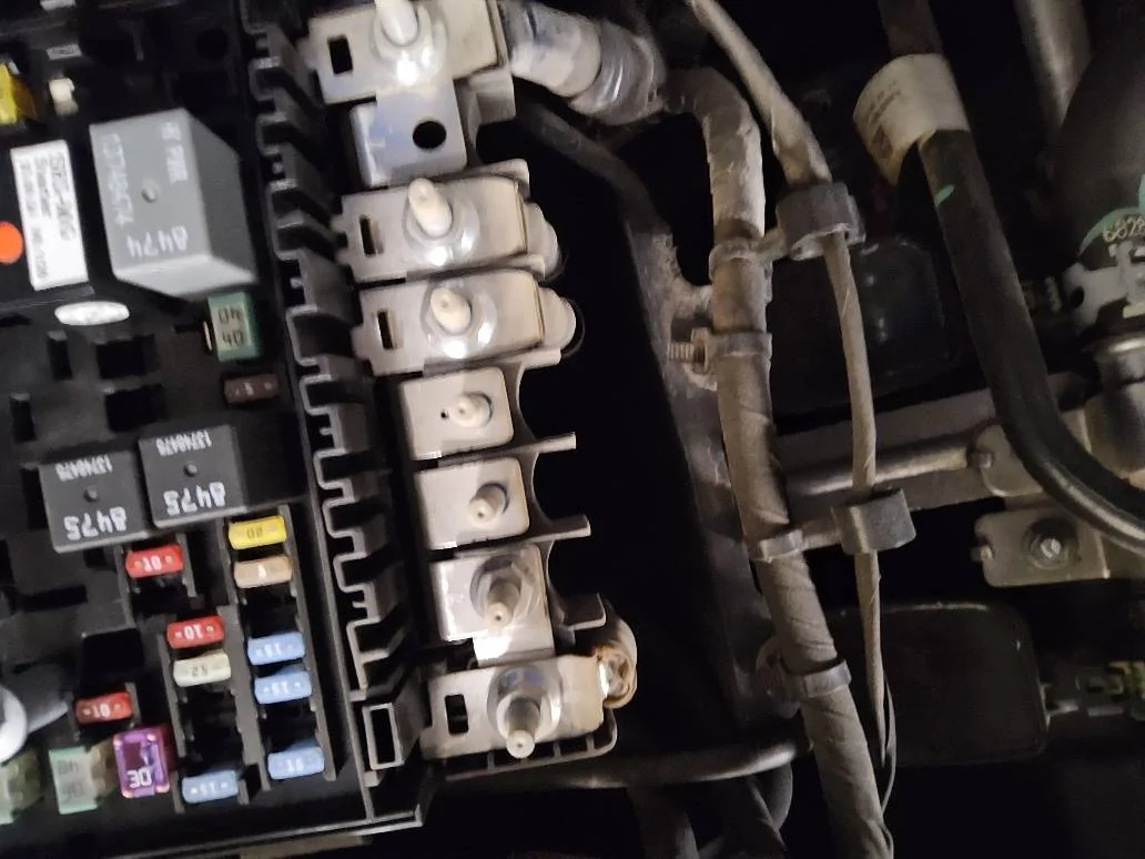

Behind your battery is that black box called the Power Distribution Center (PDC): your intelligent fuse box. If you pinch its cover clips and lift it up it will look something like the following picture inside. The two terminals I have circled in my picture below are N1 (closer to the bottom of the picture) and next to it N2. Unlike in this picture do they have a metal jumper connecting the two terminals? If so, I would think that despite the appearance of your battery's negative post with its two cables, that you may not have an Aux battery.

Hey again Kenny:
What I'm seeing is evidence that behind that front passenger's tire, in your engine bay and closer to the ground than top of the bay is a factory Aux battery. I say this because I do not see the jumper I described in your picture.
I would ask others to correct me if that assessment is wrong.
But lets operate under the assumption that it is correct. And if so, it opens up IMHO an entire different view of things. Here's why:
Shane of Genesis Offroad's great products will always be limited by the batteries they operate under. And the factory dual AGM battery configuration leaves much to be desired IMHO, particularly for the off-roader.
If you want to do this right, and it will involve more money and installation, I'd consider his kit that involves the installation of his dual Group 25 batteries in place of these two factory batteries.
It is rumored that Stellantis incorporated this dual battery setup to insure that the sensitive vehicle entertainment electronics would have enough power during ESS events. Against battery purists, which believe that batteries in parallel (like these) should be of equal size, chemistry, age and duty cycles, Stellantis incorporated different size AGM batteries with different duty cycles.
Barring ESS events and an instant at cold crank, these batteries' parallel connection, while providing more amp hours, allow one battery going bad to kill the other: usually here the Aux battery destroying the main. You turning off ESS does nothing to prevent that.
Most auto makers implementing ESS do it with one battery. Stellantis uses this Aux battery to run appliances during ESS events to spare the main battery for the post ESS engine crank.

My Wrangler Rubi will be coming up on 2-years old this coming Spring so it will be the right time to get the itty-bitty Battery out of my Jeep before it fails and leaves me stranded on the Trail.
Your post 7 has the manufacturer's sticker which shows your Jeep is eTorque, which means you have no alternator. JLs without alternators do not have aux batteries. Your post 17 has a photo of the high amp fuse array on the N studs, showing a connector strap between N1 and N2. This means your JL has none of the aux battery, N3, and PCR cabling. When you instal the Genesis system you can ignore steps that deal with the aux battery and it's cabling. Good luck.
I think I see the jumper now. I missed it on the picks originally, thrown off by the fact that the OP has two cables connected to his main battery's negative post.
My understanding was that factory Etorque looked like this:
https://www.jlwranglerforums.com/forum/threads/aux-battery-how-do-i-know.120115/post-2501518
Perhaps the OP used that opening on the negative terminal for his aftermarket stuff.
Kenny: if you have etorque than your ESS events are being energized through the 48 volt battery.
If you open the PDC (Power Distribution Center) is Circuit 42 absent a fuse? That circuit runs the PCR (Power Control Relay) that separates the two batteries in the dual AGM 12V battery JLs like the regular 3.6L and plays no role, from what I understand, in the Etorque models, hence the absence of a fuse here, as from the factory, being a tell tale sign.
Yes, there is no F42
