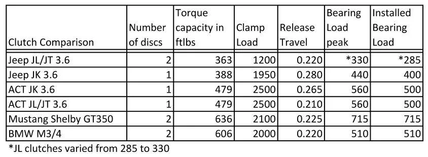

Test Results and Comparison:
The following chart shows data from several clutches in our discussion. The reason I chose the Ford and BMW clutches is because they share similar or identical components to the JL/JT. For instance, the floater plate, drive plate and rivets look the same.
Jeep Wrangler JL EXPLODED JL Clutch! Detailed Look & Testing by Advanced Clutch Technology Clutch Comparison data small
Since they are self-adjusting, the clamping force and torque capacity of the twin-disc clutches were tested/calculated at installed position. The others show results at peak clamping force, which is roughly 10% higher than installed position. Peak clamping force for a self-adjusting clutch is irrelevant since it never reached peak, while installed position for a conventional clutch is a moving target.
EDIT: See post 111 about more recent testing!
From the chart we see:
- The Jeep JL/JT clutch has a very low bearing load because the required clamp load is very low.
- Being a much larger clutch with a stronger diaphragm spring, the stock JK requires 27% and the ACT JK requires 20% more travel to release than the stock JL.
- The ACT JL clutch has identical performance to the ACT JK except travel is reduces dramatically.
- Although the Mustang and BMW have similar clamp loads and release travel, the bearing loads are quite different, which makes sense. You expect the modern muscle car to have a more manly pedal, while the more refined reputation of the BMW might demand a moderate pedal feel.
Note: I didn’t do deep research on it but there are reported clutch failures of both the Mustang and BMW clutches we are comparing to related to the drive straps or rivets failing. Unlike the JL/JT clutch failures, this looks to be related to the higher engine output or how it is driven, not overheating. Here are a couple links you can check into:
BMW M3: https://www.m3post.com/forums/showthread.php?t=1342757
Mustang clutch failure TSB: https://www.mustang6g.com/forums/th...ailure-related-to-excessive-wheel-hop.186777/

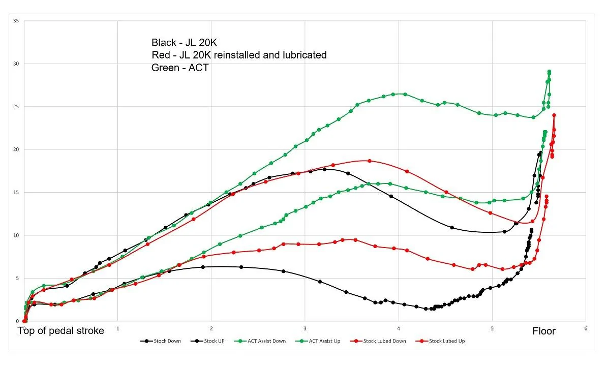

JL Pedal load test results:
Jeep Wrangler JL EXPLODED JL Clutch! Detailed Look & Testing by Advanced Clutch Technology JL Pedal graphs
The pedal load graph explains why the pedal felt so terrible on the used JL we had in the shop at only 20,000 miles. The pedal was showing less than 2 pounds of force on the return stroke at one point. Incidentally this is the same clutch shown in the earlier videos, which you can see was in pretty good shape. We repeated the test a few times because we couldn’t believe it. For comparison, we were interested to find out how much improvement we would get if we lubricated everything and of course compare with the ACT clutch installed.
