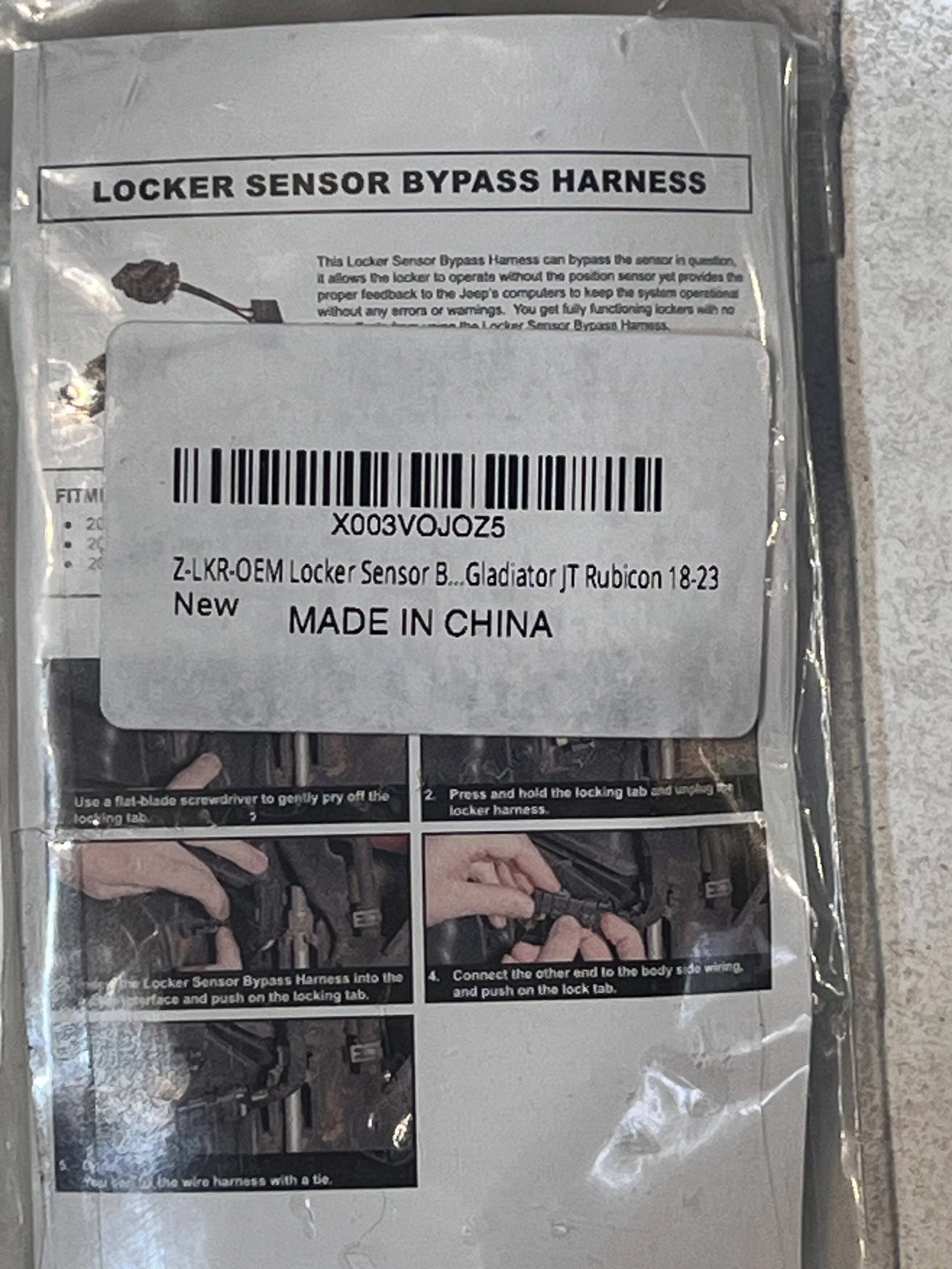

got my 21 Rubi on a lift this am, to install the locker sensor bypass harness, and the plugs didn’t line up, and wouldn’t fit. Both my trusted mechanic and I tried, but after close examination, the plugs are not the same, ridges, flats, etc. The Jeep is still under warranty, should I just have the sensor replaced? Looks like it’s held in with one bolt. Are there different bypasses out there? i have the factory tow group, does that make a difference?
Wow. They ripped off Joe's harness design too?
If you still have coverage, have Jeep fix it.

Oh, so this isn’t an original? Got it off Amazon, maybe that explains it. Where do I get Joe’s?
