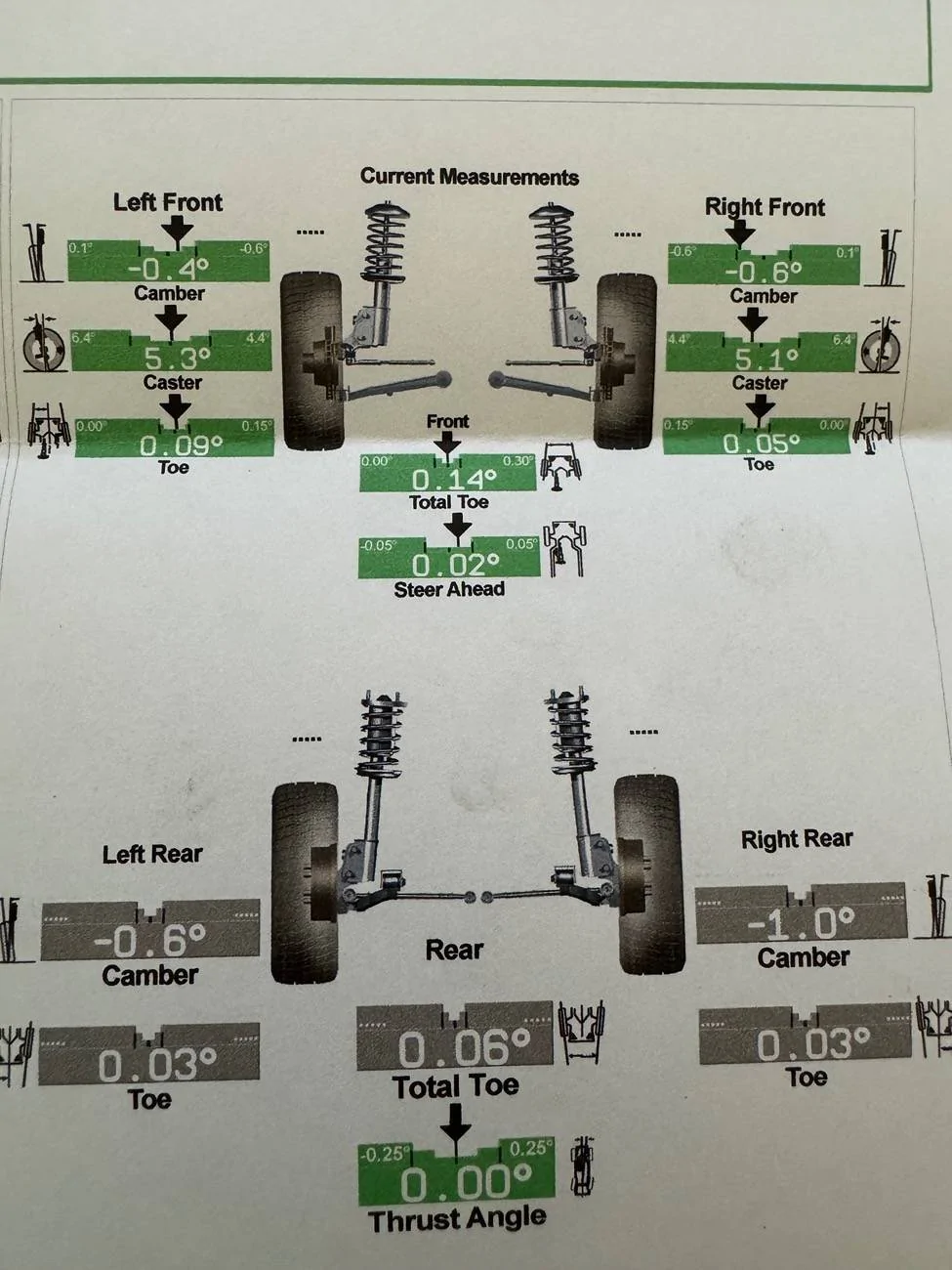

Attached is a picture of my alignment specs. Having a hard pull to the right still. I recently put new Mickey Thompson Baja Boss MTs 35x12.50r17 and I’ve rotated them multiple times and that hasn’t changed anything so I think I’ve ruled the tires out. Went to get the alignment check and seems all good here too. No weird sounds or anything coming from the front end. Sort of at a loss now so coming here for additional thoughts.
