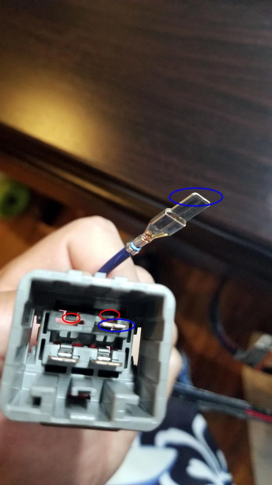

Okay, so modifying 3024-p is fairly easy, just switch the black and blue wires. Use something flat and small enough to push up the grey tab (red circle), while push the blade connector (blue circle) out.

I called the customer support for Reese....the main company makes all 3 brands, Draw tite, Reese and Tekonsha.
Reese 8508211 and Drawtite 5535 are the "Same" just different label on the front (says their Technical support)
As well I also found out that 3014 works but doesn't have the Diode (so don't use it!) 3073 is the correct pin-out with Diode (Correct for Wrangler) or use 3024 (Also has diode and is for the Ram) but just swap the black and blue wire on the grey connector end for the Wrangler.
