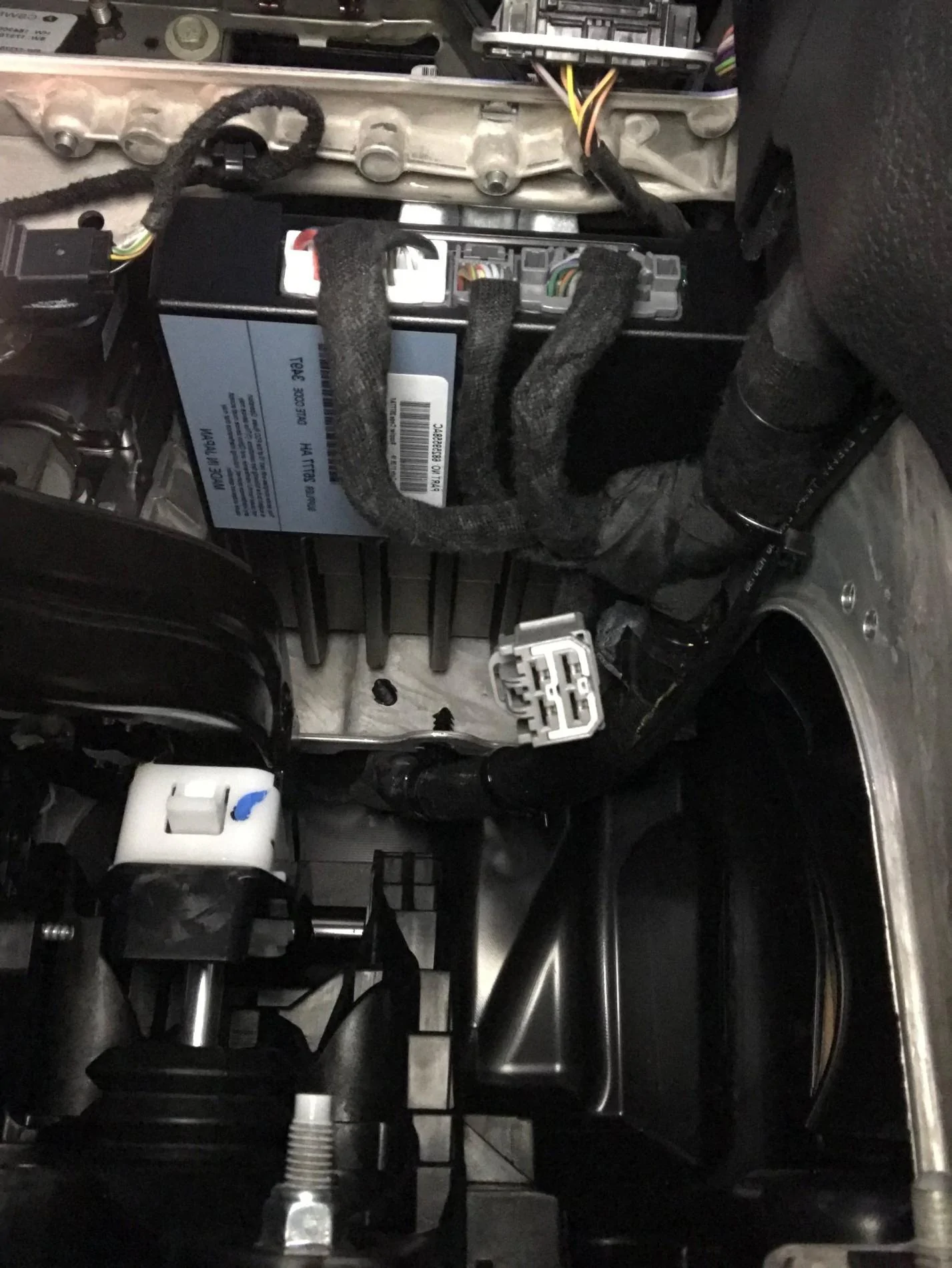

For those that have installed the MOPAR tow harness and then went on to install a brake controller, what did you do with the blue wire under the glove box left there from the tow harness install?

I looked under the driver's side an I didn't see a plug like the one in the picture below. So I am wondering if it only comes with the to package. I didn't get the tow package. I just installed the MOPAR hitch and JL harness.

Did we ever get an answer to this? I self installed my harness and just bought a trailer with brakes. Not sure I'm going to need a brake controller, but would love to understand what it will take for those of us that didn't buy the tow package and self installed the harness/hitch. There is a blue wire that instructions tell you to just leave it in the passenger footwell, it doesn't plug into anything.

I finally located the plug, way up, just behind the dash on the left, taped tightly to another wire, with the plug end facing up. Thank you to those who posted pictures so I could recognize what I was looking for. It was well hidden for no particular reason.
I do not know how a big guy can manage this, I am a medium size, fairly agile woman and I was contorted in every possible way to reach it. I am thinking the accessibility of this plug depends on the mood and sadistic nature of the guy who did the wiring on that day.
O|||||||O
This was not easy to locate or hook up. The wire is so short you can’t pull it down far enough to see it. I did pull off the center panel which helped. I had to just reach around up there and located it taped to another wire.
