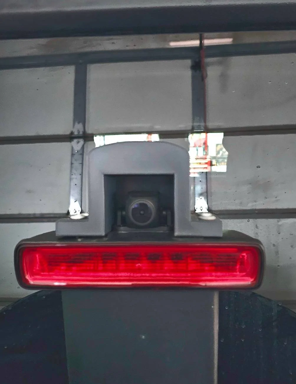

This is the Third brake light option on the Terraflex Alpha HD.

I have a Spartan Rugged Ridge tire carrier on my 2020 JL with an LED brake light. I glued it on with the double faced tape that came with my G900 camera. The camera is hidden, centered and provides a perfect video.

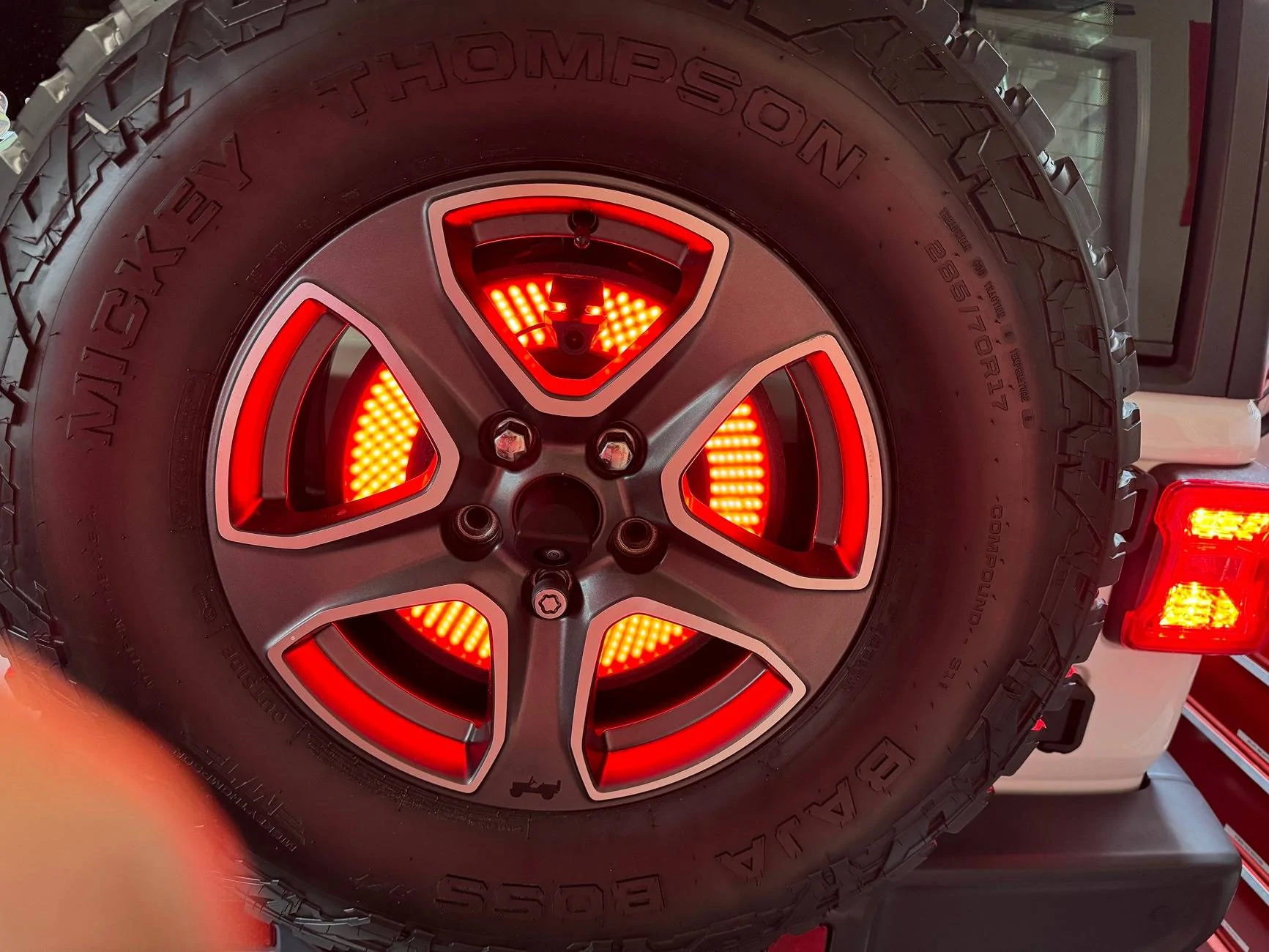

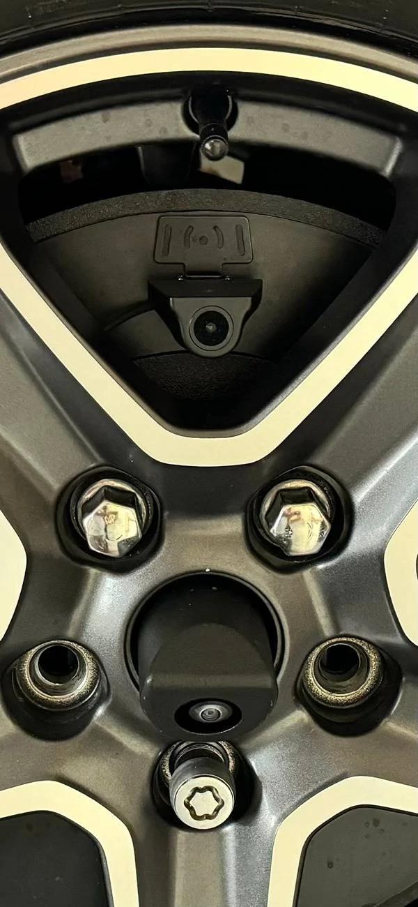

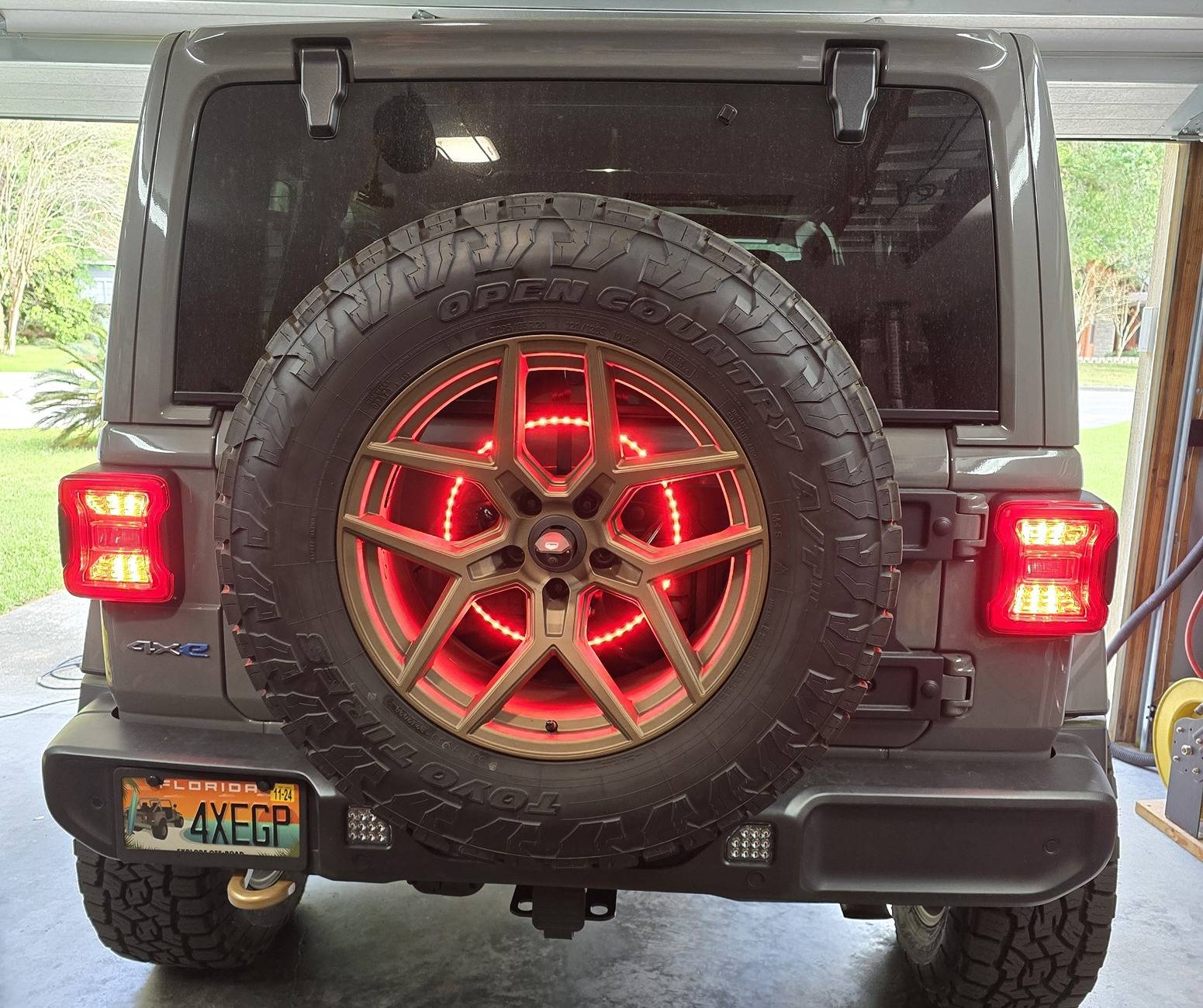

How much do you notice the red glare/glow of your light ring in the mirror when braking? I'm contemplating a similar location but am concerned about the red from my Oracle LED ring.

To be honest, I haven't driven to much at night since I installed the camera, but the few times I have I don't recall and issues on the video coming from the 3rd brake light.
I do recall certain vehicle headlights were so bright they blurred the video.
