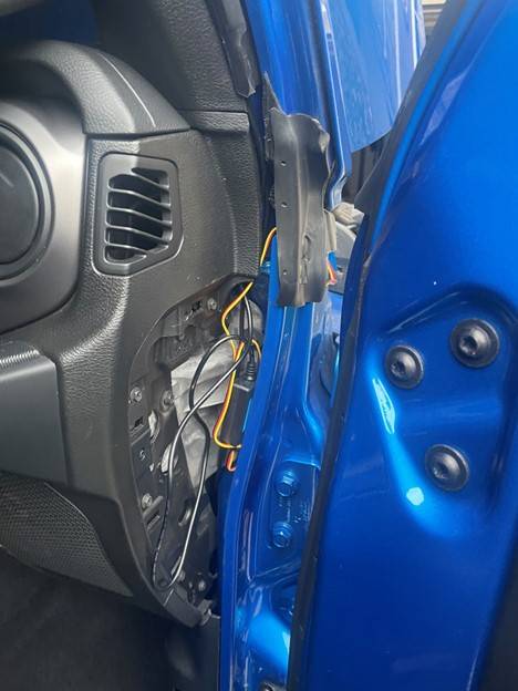

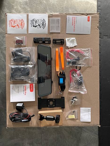

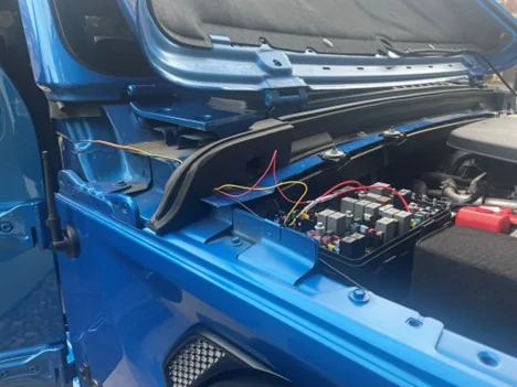

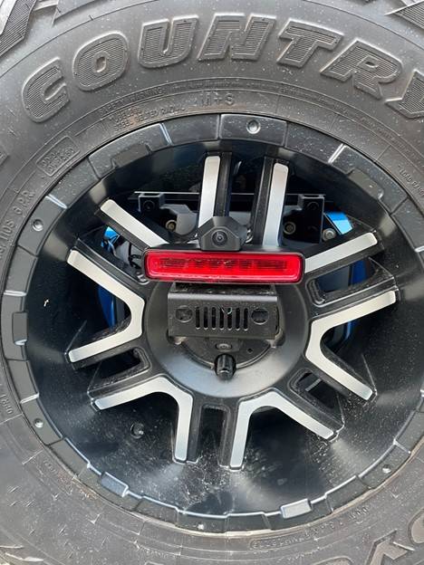

We received the package a few days later. It was very well packaged and labeled. After laying everything out and determining which parts we were going to use for our Jeep we got to it. My wife started running the wire from the backup camera, all along the floor of the Jeep under the carpet, and I started taking off the panels along the grab railing and above the windshield to run the wires from the mirror to the battery. We met at the passenger door panel. Next was running the wire from there to the battery. I removed the passenger side cowl to make it easier, then ran the wire into the hood. Once all the wires were ran, we plugged it into the Woflbox and everything turned on. Note, we did test the Wolfbox using the cigarette lighter before running all the wires to make sure it worked first. The only information I was not able to find was how to connect the red wire to the backup lights to enable backup camera. I did some more research after the install and think I know how to do it now, but just haven't gotten around to it.
The install itself was very simple. We are both very new to this so if we can figure it out, anyone should be able to too. Each bag with the wires has a QR code. The code took us to very detailed videos on the wires, what they mean, which fuse to use, etc. These were invaluable and a very nice touch for Wolfbox to do. Again, I don't think we would have been able to complete this without those, so it is a HUGE plus.

Overall this is a great product. I can see this being invaluable to Jeeps who can't see out the back window, RVs, vans, etc. Definitely useful, from a great company that stands by their products and are great at communicating and helping you when needed. Below are a few pictures.

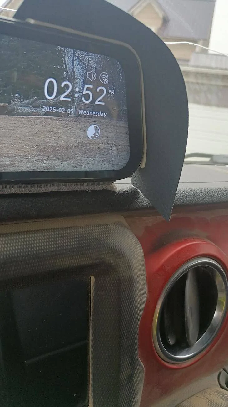

A hint for you if interested: I experimented with mine until I settled on its final location. I did try it as the only mirror. I did try it further over in front of the passenger seat (almost), on the dash. I have finalized it in the center, almost directly below my rear-view mirror. I LOVE being able to use both. I am not sure why but there you have it. I did add a small piece of plastic as a sunshade on the extreme right-hand side, wrapping up on to the top to help eliminate side glare from the sun. I can get a daytime pic if you would like.

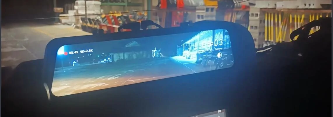

As to this point, you are 100% correct. Here is a quick comparison showing a night shot of rear camera vs rearview mirror with a slightly dirty plastic window:

What did you use to mount it there? We like that and want to give it a try.
Currently I am using heavy duty Velcro. I will get a pic tomorrow.
Two things to remember:
-There is/are button/s on the bottom of the mirror so I applied the Velcro to the left and right of them
-On rough terrain, you will get some movement because the mirror/camera is not "glued" to the dash. Hence, your video will appear a little bouncy. I intend to do this when the weather get warmer.
Imagine instead of the Velcro to he left and right, there will be a non-bouncy surface (like a thin piece of wood for example) that the mirror is stuck to, then that is glued onto the dash.
As soon as I get to it in the spring, I will post.
