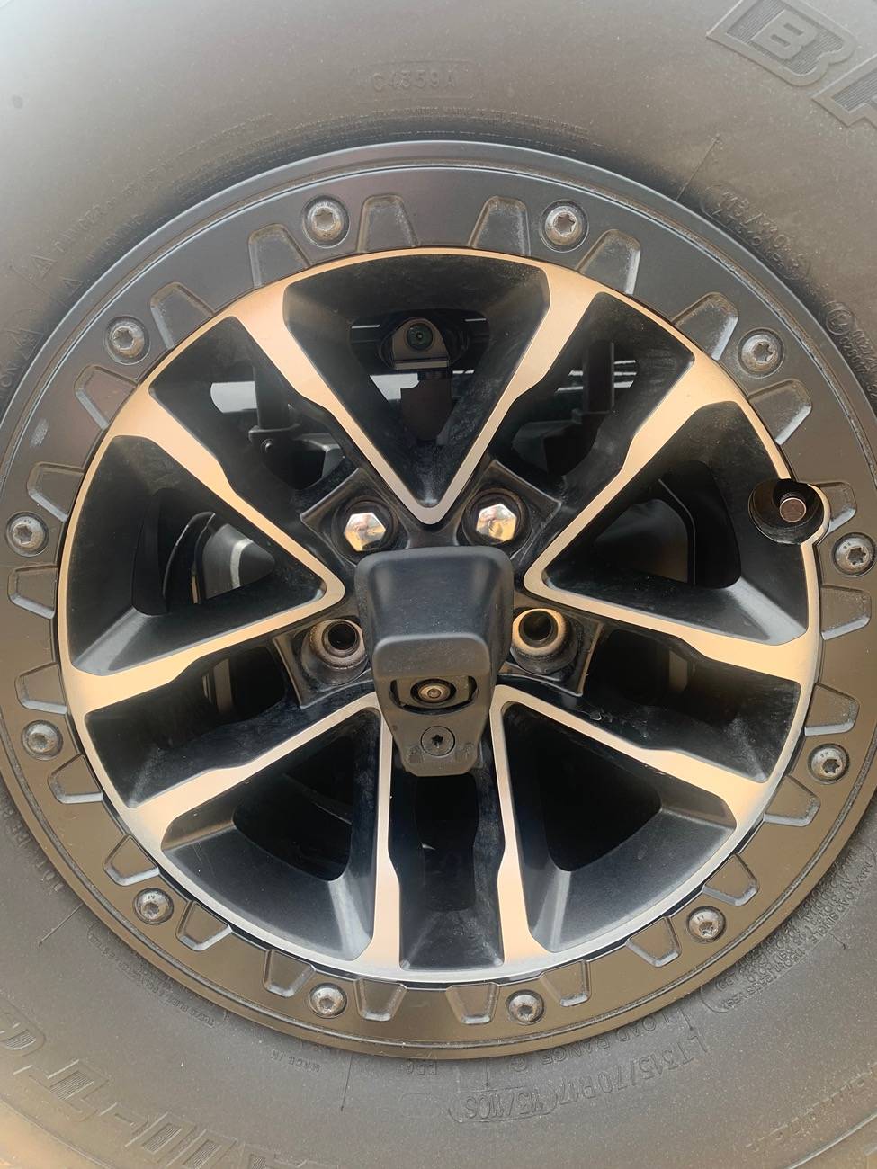

I ran the rear camera cable down the A-Pillar passenger side and under the door sills (super easy) then pulled the carpet back on the rear tire; slid the cable between the hard top and body. Then dropped it down and zip tied it on that OEM cable run to the tailgate. Removed that panel on the tailgate and passed it through the vent. Cable is long enough with about a foot to spare. This is by far the easiest way to route the cable. The camera is mounted on one of those mounts from Amazon that has the lug holes in it.

This is the one I used. I had to enlarge the center hole for this to work. I did not use the camera that came with this kit.
