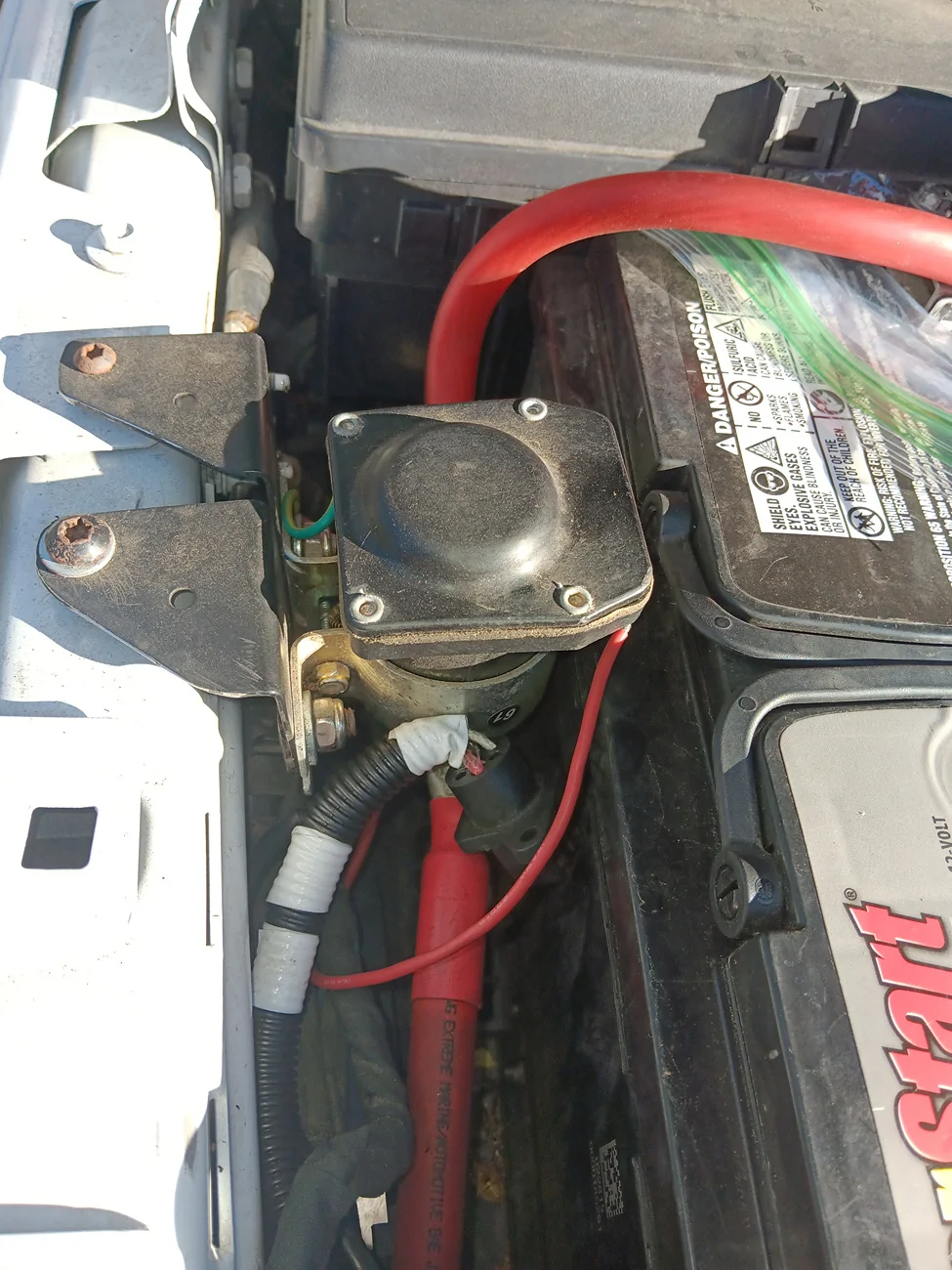

I wanted the relay installed under the hood, instead of on top of the winch.
Albright DC88P-1000 DC88P-1000
https://www.ebay.com/itm/313445108881
The Jeep also has a power-on solenoid wired to an Aux switch.

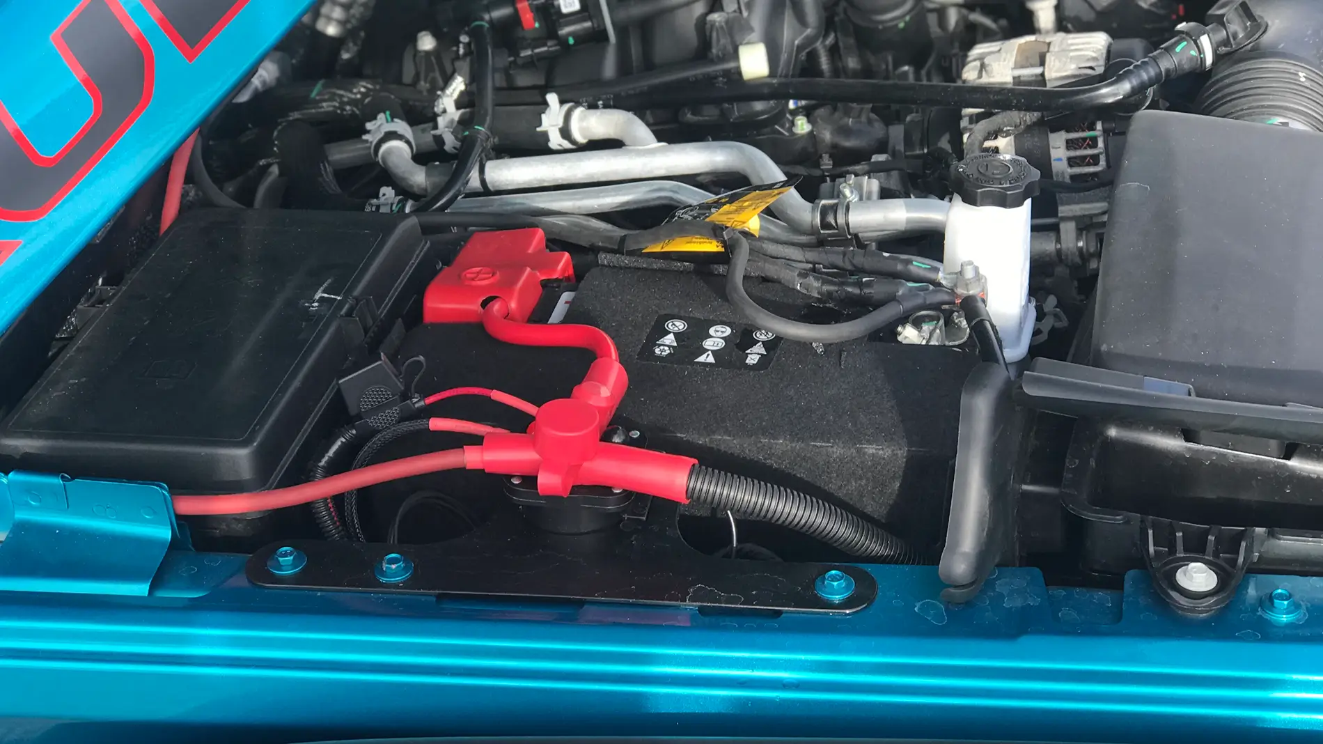

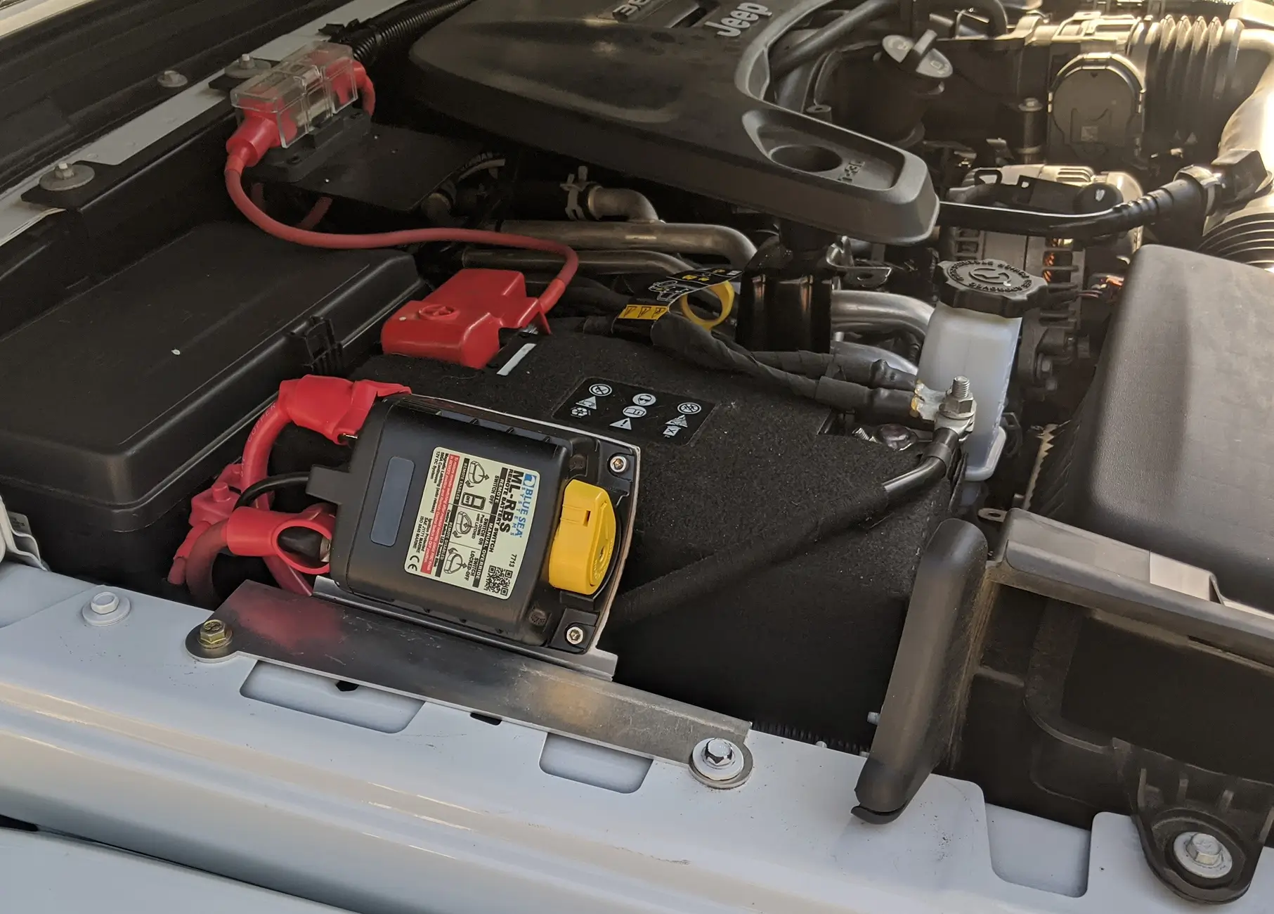

Jeep JL/JT Battery Cutoff Switch Mount - American Adventure Lab I went to the manufacture website for the solenoid and purchased it for $20 in black when it was onsale. Not sure the price anymore. Has been the best purchase, since my main winch cable is bad and drains the battery.
With respect, please re-read my original post. You'll see that this is what I have now—a manual switch that has to be physically turned by hand. I am forgetful, and although my plan was to turn it on as part of my air-down process, more often than not I forget to do it.
On a club trail ride this past summer the rig in front of me came close to rolling on its side into a mud pit. I had to get a line on him FAST, and my winch needs power to allow it to move the clutch into freespool mode. The switch was off and I had to mess around with opening the hood before I could extend a line. Thankfully nothing bad happened, but that was an unacceptable delay.
I need to change this to an electrical solenoid (relay) that can be activated from the drivers' seat, and does not require me to raise the hood. It needs to be of sufficient capacity to safely allow a 500A draw at peak load. I am seeking recommendations on which solenoid to buy from those here who have done this before and it's working as required.
