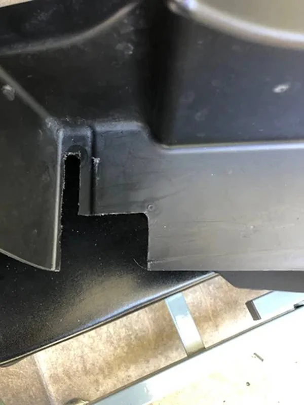

I had the same thought as you regarding the liner because it prevents junk from being thrown at the wiring that is tucked into the rear bumper. Here’s photos of the cuts I made in the liner in order to fit the Rokblokz. The instructions from Rokblokz said to just toss the liners.
https://www.jlwranglerforums.com/forum/threads/mudflaps-and-rubicon-flares.4435/post-1255166
Thanks, bookmarked that!

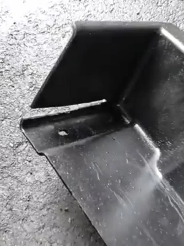

And what's really strange is that's the 3rd custom fitment for the OEM liner I've seen for the Rokblokz flaps and so far, each one has been cut differently in different locations.
Really not sure which is the best method, but yours is definitely the cleanest and Peter Parker's is probably the simplest/easiest. Compiled them all here with links and previews, since I'll probably need them myself at some point..
Peter Parker @Youtube (single narrow cutout):
Jeep Wrangler JL Mudflaps recommendation! 1-PETER-PARKER
Uncredited @Rokblokz (single narrow/wide cutout):
Jeep Wrangler JL Mudflaps recommendation! 2-ROKBLOKZ

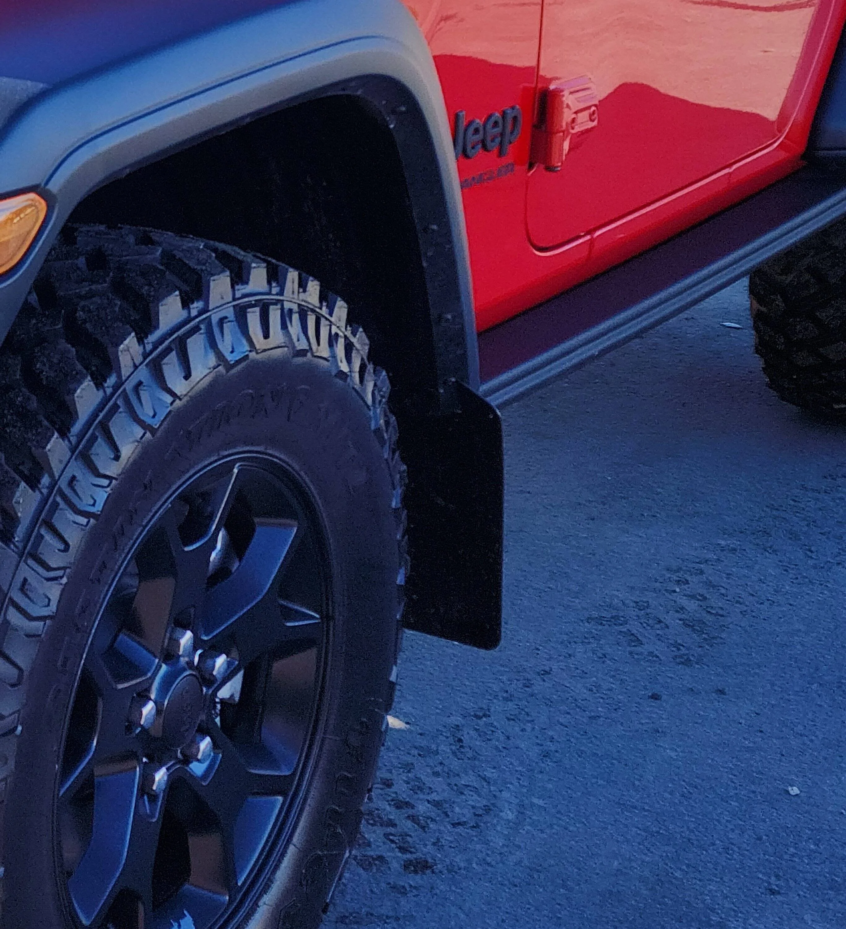

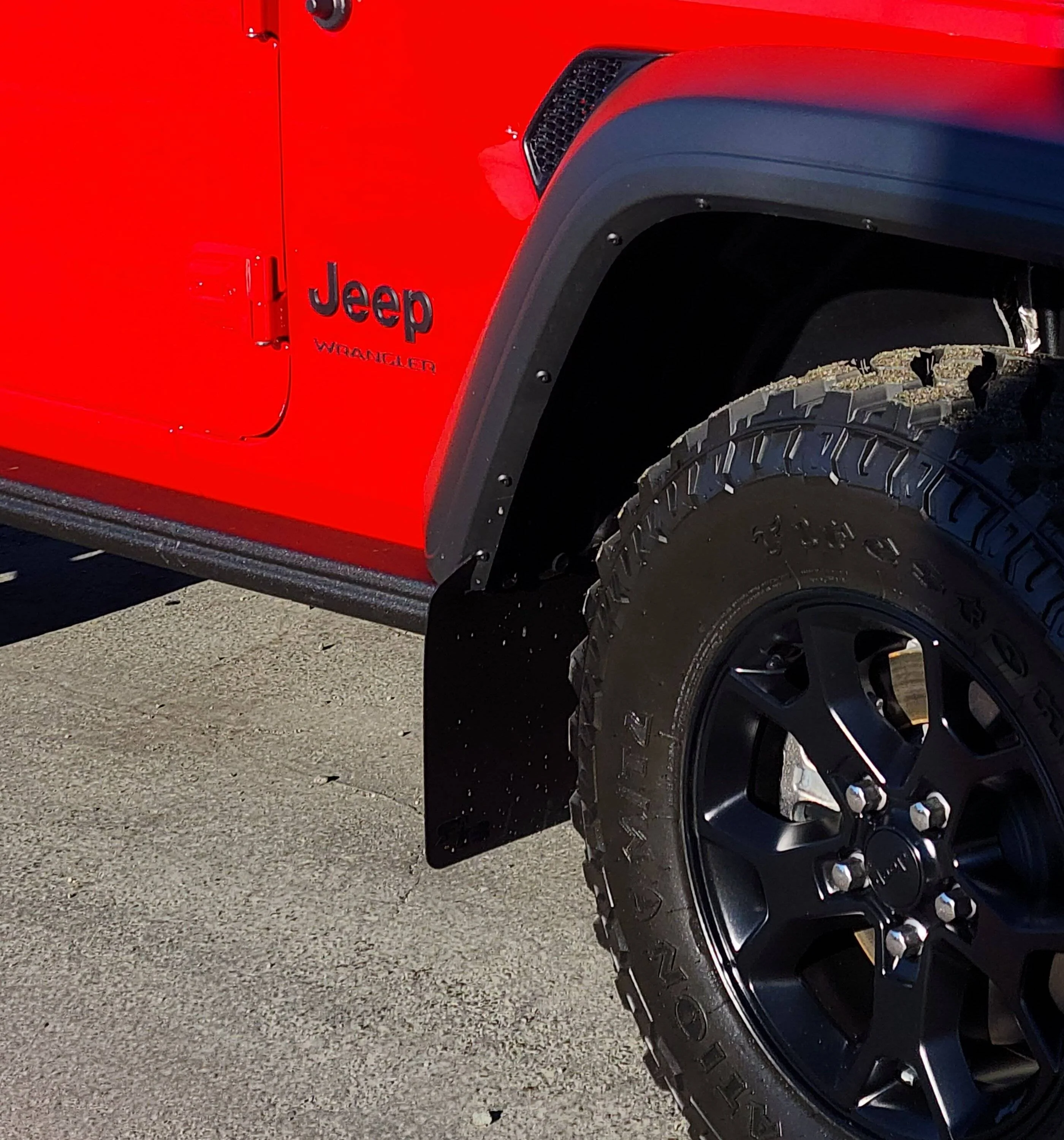

Weathertechs look OEM and well designed but they will not fit if you have the HD rock rails (the ones with the extended step). The Rock Blok are not designed for those rails either but can be cut to fit by the owner.
OJ, I have those Mopar "performance rock rails with step assist" (as the factory calls them), and I did manage to install the front Rokblokz mud flaps without any cutting of the mud flaps themselves. Note that Rokblokz does say that their mud flaps are incompatible with those particular rock rails, but not so!
What I did was to insert the mud flap between the fender liner and the hard plastic mounting tabs that sit behind the fender liner, instead of the normal procedure of putting the mud flap behind both, with the mud flap OVER the end of the rock rail (instead of having the end of the rock rail poking through a hole in the mud flap). I then inserted the thumbscrews through the fender liner holes as normal, then going through the mud flaps, and then lastly through the holes in the hard plastic mounting tabs.
Note that it is quite difficult to line those three things up, and I had to fight with for a good couple of hours to get it all just right, and also had to modify one of the mud flaps (on the driver's side) by filing down the rounded notch in the flap, in order to allow it to fit.
Then, after getting all that on, I put stainless steel wing nuts on the ends of the thumbscrews that were sticking out of the holes in the hard plastic mounting tabs, using a bit of blue Locktite to keep them on.
The front mud flaps do hang at somewhat less of an angle than they would normally, and there is a slight bend in them where they go over the end of the rock rail. But they don't hang literally vertically, and I think they look totally fine, and will provide equal protection as compared to what they would provide if installed by the standard procedure.
EDIT: I forgot to mention that the third, innermost attachment point cannot be reached with the supplied thumbscrew, as putting the mud flap under the fender liner and over the end of the rock rail ends up bringing the mud flap out at that point by an inch or more from where it should normally sit. So what I did was just take out the plastic push pin there, stick their supplied metal clip over the hole in the fender liner and the metal beneath it (to secure the liner to the metal), then ran a zip tie through the holes in the mud flap, and the fender liner & metal, and secured it down as snug as I reasonably could. Note that you have to do this attachment point first, or you won't be able to thread the zip tie through all of those holes after putting the two thumbscrews on, except maybe with the most extreme difficulty.
I know these are not the best pics of them, because they are not taken directly from the side, but you may still be able to get an idea of what I did here (the pics make the flaps look like they hang perfectly vertical, but they do not --- it's just the angle at which the pics were taken that make them look that way):
