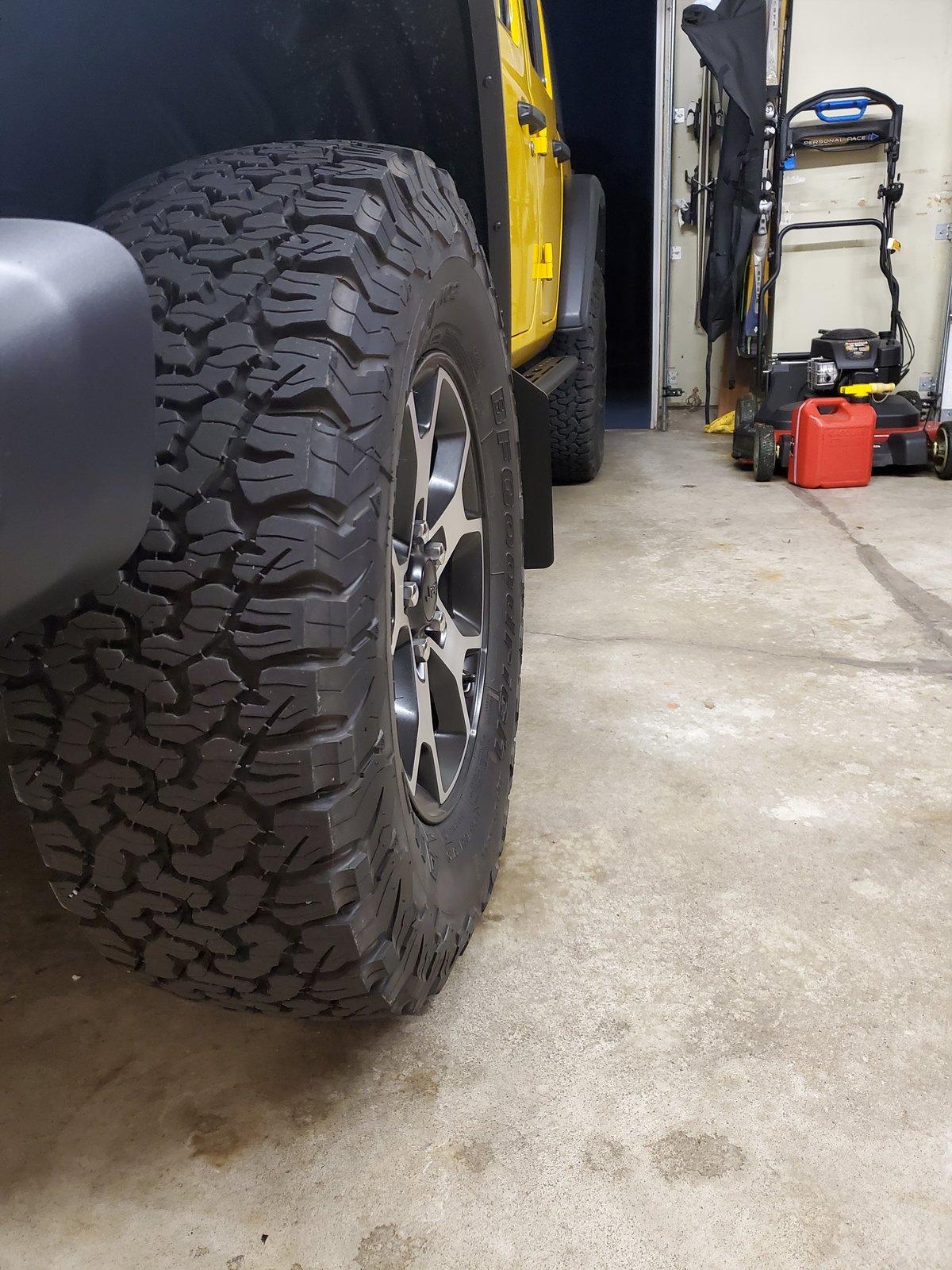

9" from the bottom to the ground on stock Rubicon.

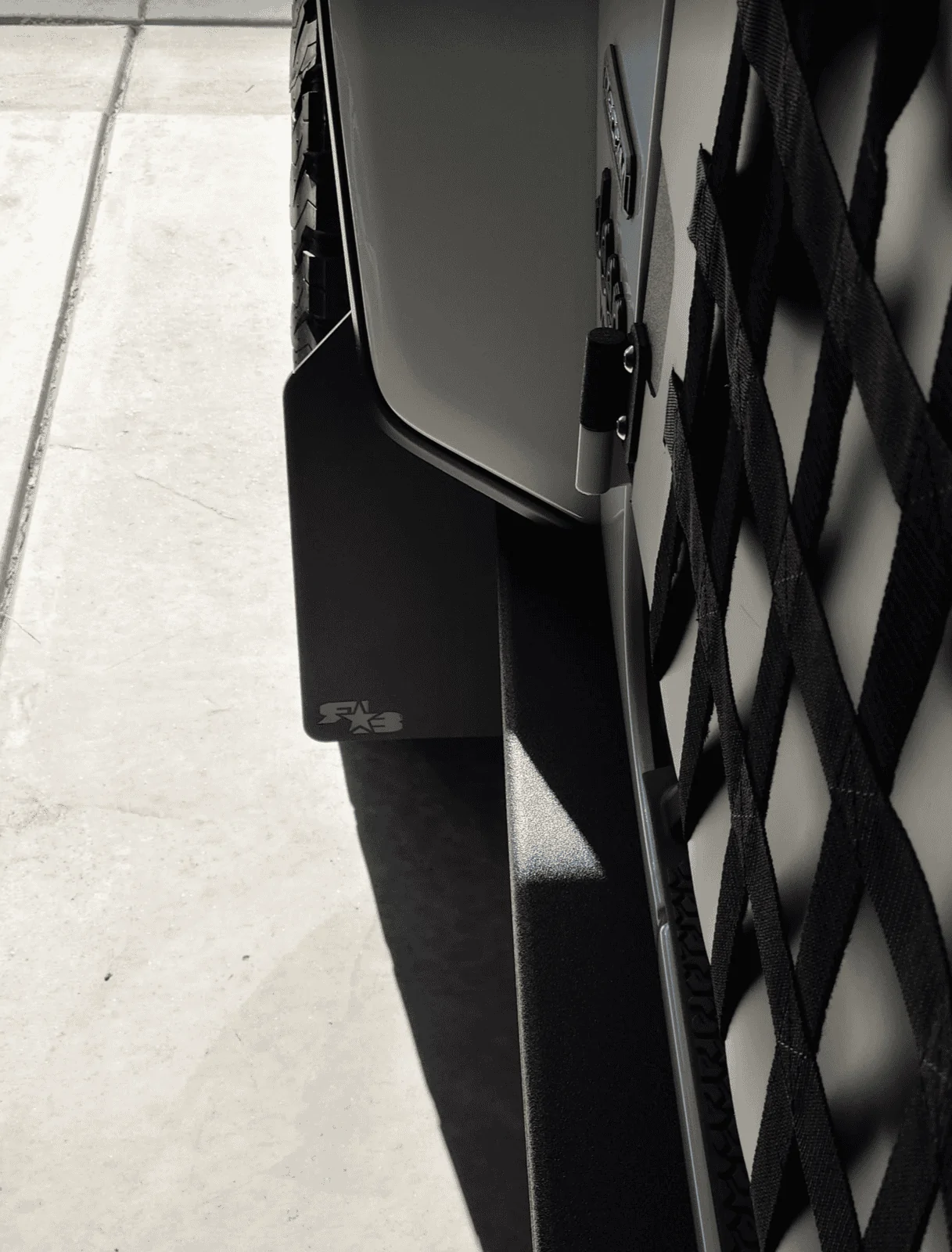

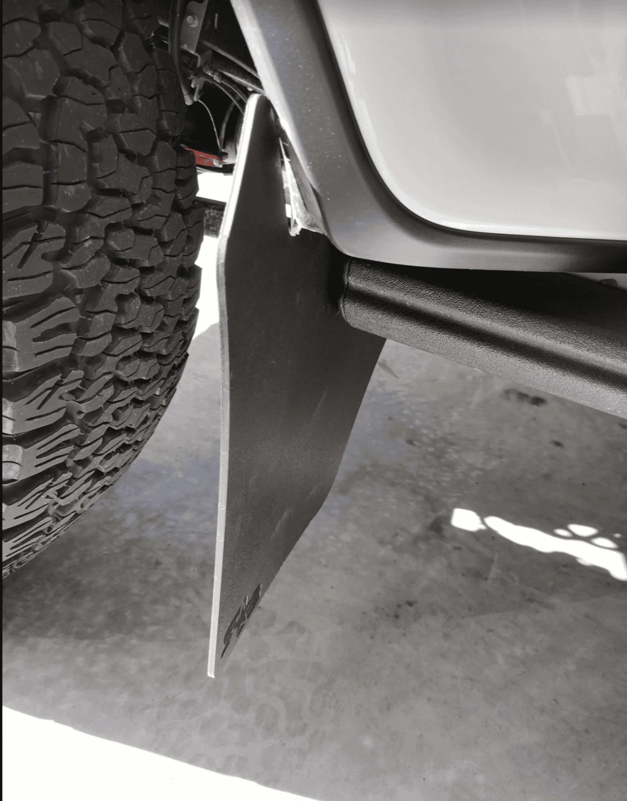

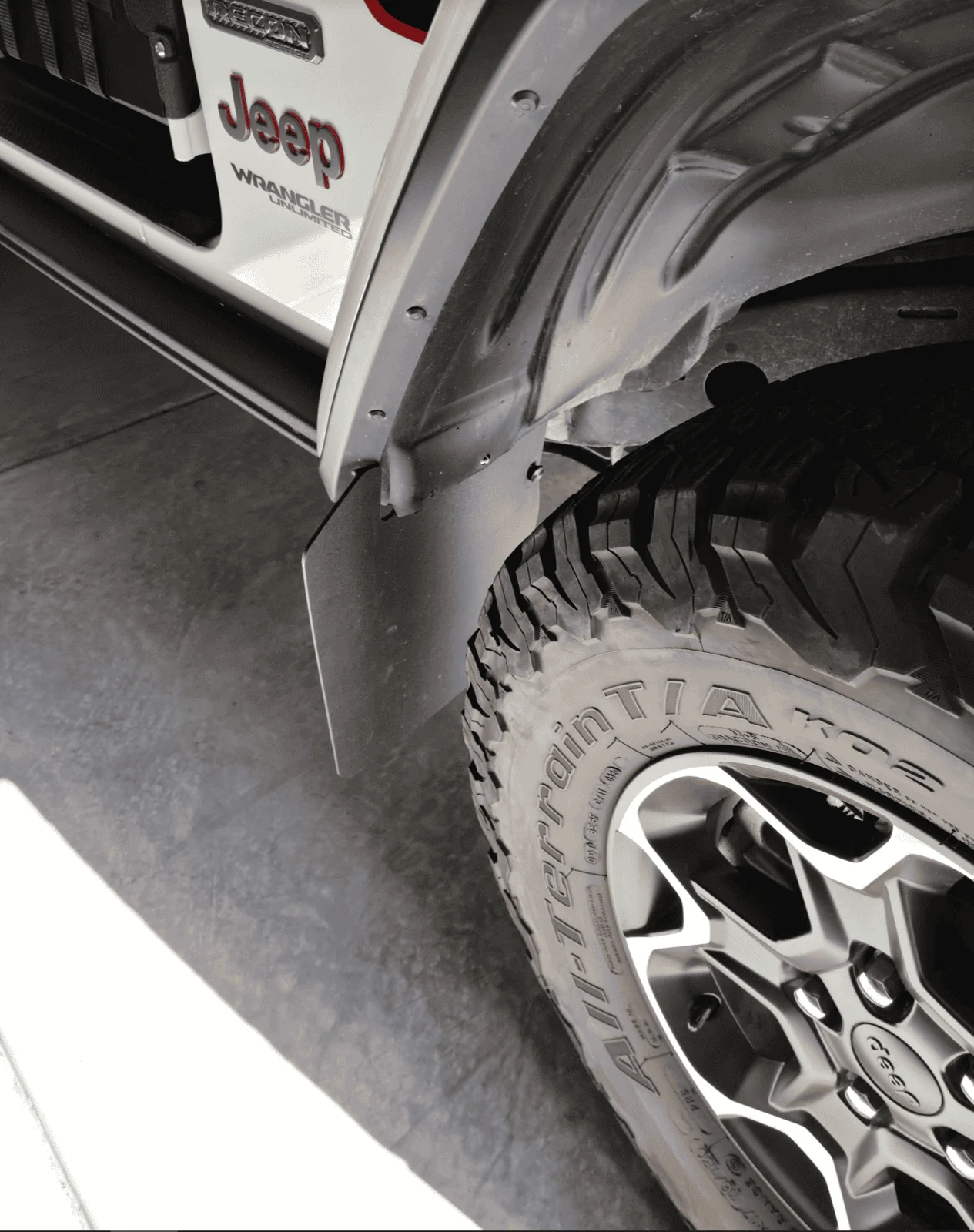

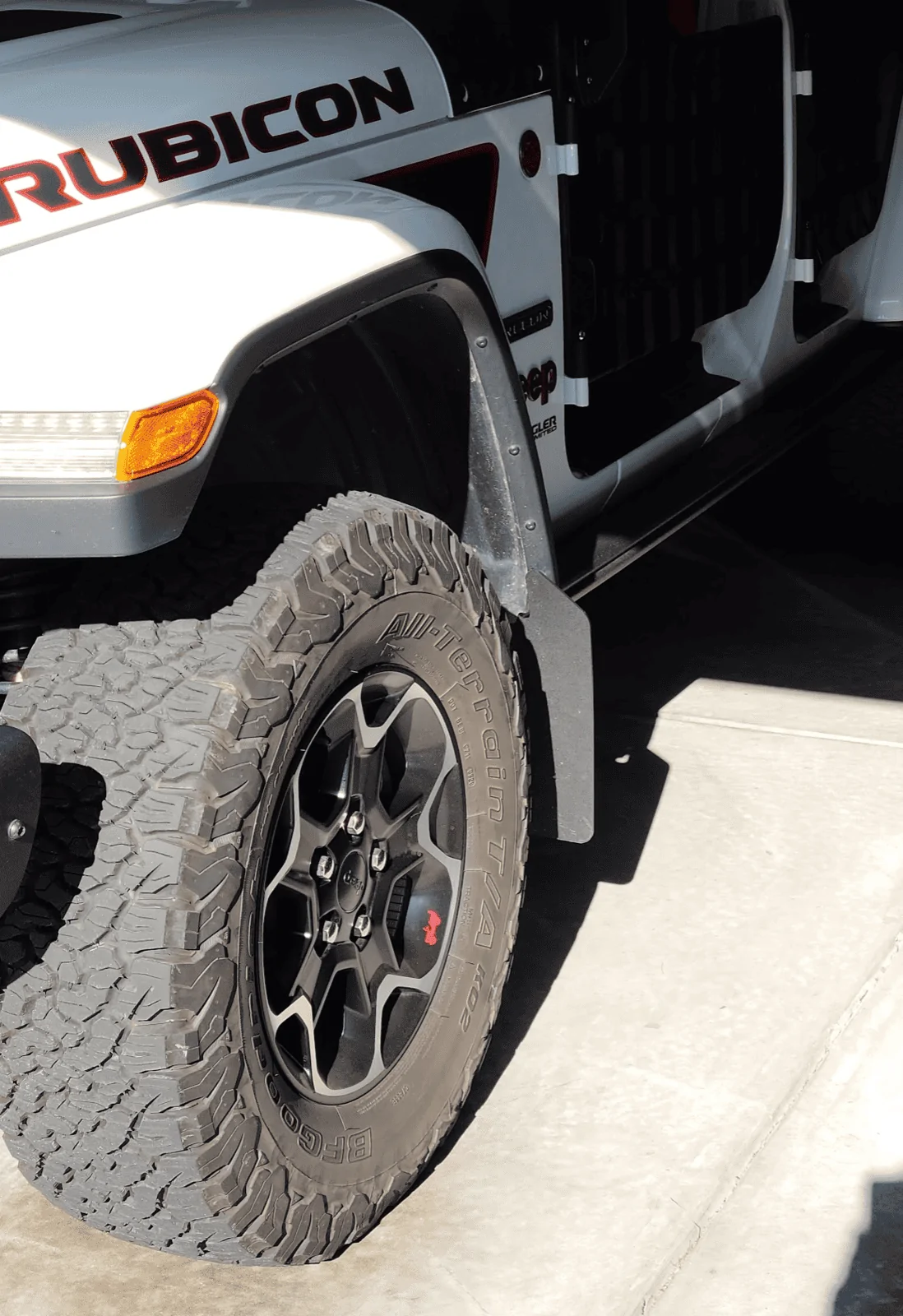

Here are some pictures for ya. Overall I am pretty happy with them. I do plan to get 35's which is why I went with the XL.
I got stuck in a rain storm the other day and I have tube doors and actually stayed pretty dry :)

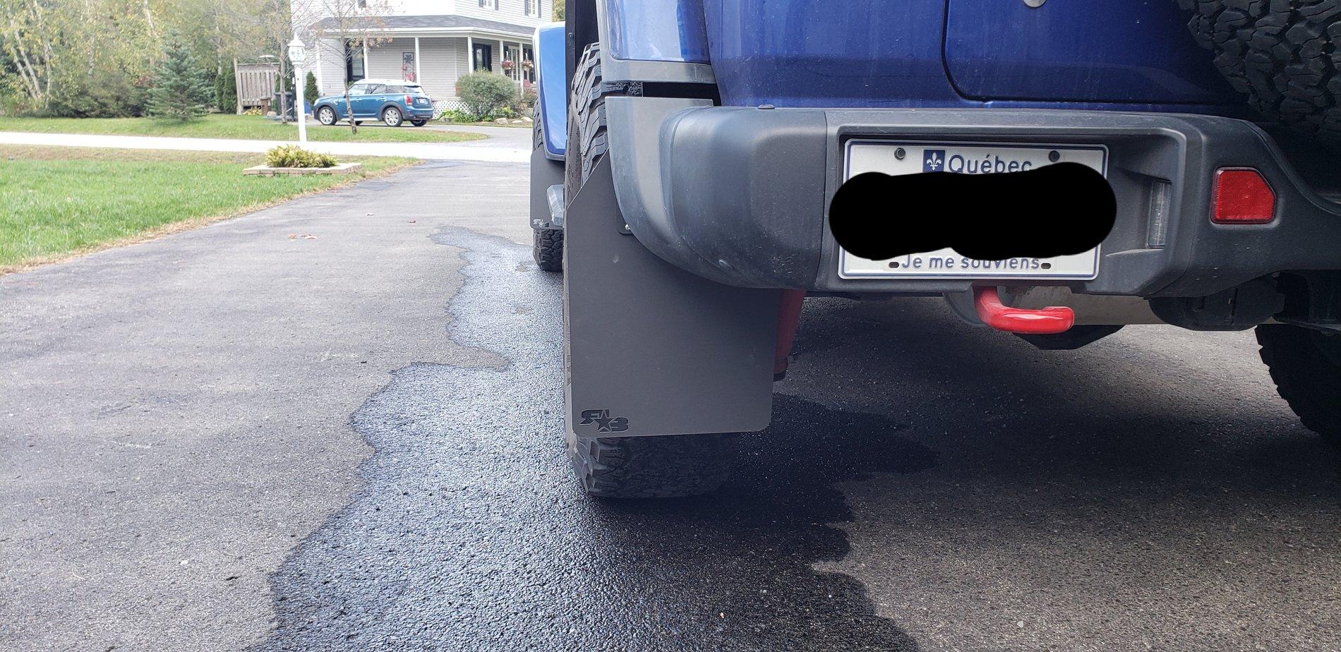

Finished mine on the weekend as well! 18 JLUR stock height/tires but with Go Rhino RB20 running boards.
Fronts were a piece of cake, backs took some playing around, still not satisfied with the lack of adjustment/angle with the plastic stock lower inner fender cover...wish there was more adjustment in the bracket (like twist already in the bar/flange).

They are the XL.
Hard to explain, but since the plastic fender well cover gets sandwiched between its mounting bracket and the new bracket...it removes any ability to adjust it...so it basically forces it straight down.
I dont want to remove the plastic inner fender cover...but I may have to...to get a better spacing/angle on them.
Before I reinstalled the inner fendee cover it did have some movement and I was able to get a nice angle on it...but the way the cover is screwed on (one above and one below the new bracket for the mud flap)...if I cut this plastic cover I loose the bottom screw and then I would be worried it would not be secure enough to not "blow off" or take the abuse from the mud/snow....
Since the bracket is "L" shipped with frowny face adjustment slots..its fully at one extreme and can't be adjusted to twist more...with the plastic fender cover between them.

Soo... after some playing around and creative arts and crafts... I bent the bracket to allow more clearance for it to pivot more...I'll attach pics... works/looks much better then previous (as they were almost straight up and down).
Re-sprayed the brackets with black rust paint... looks and fits much better
