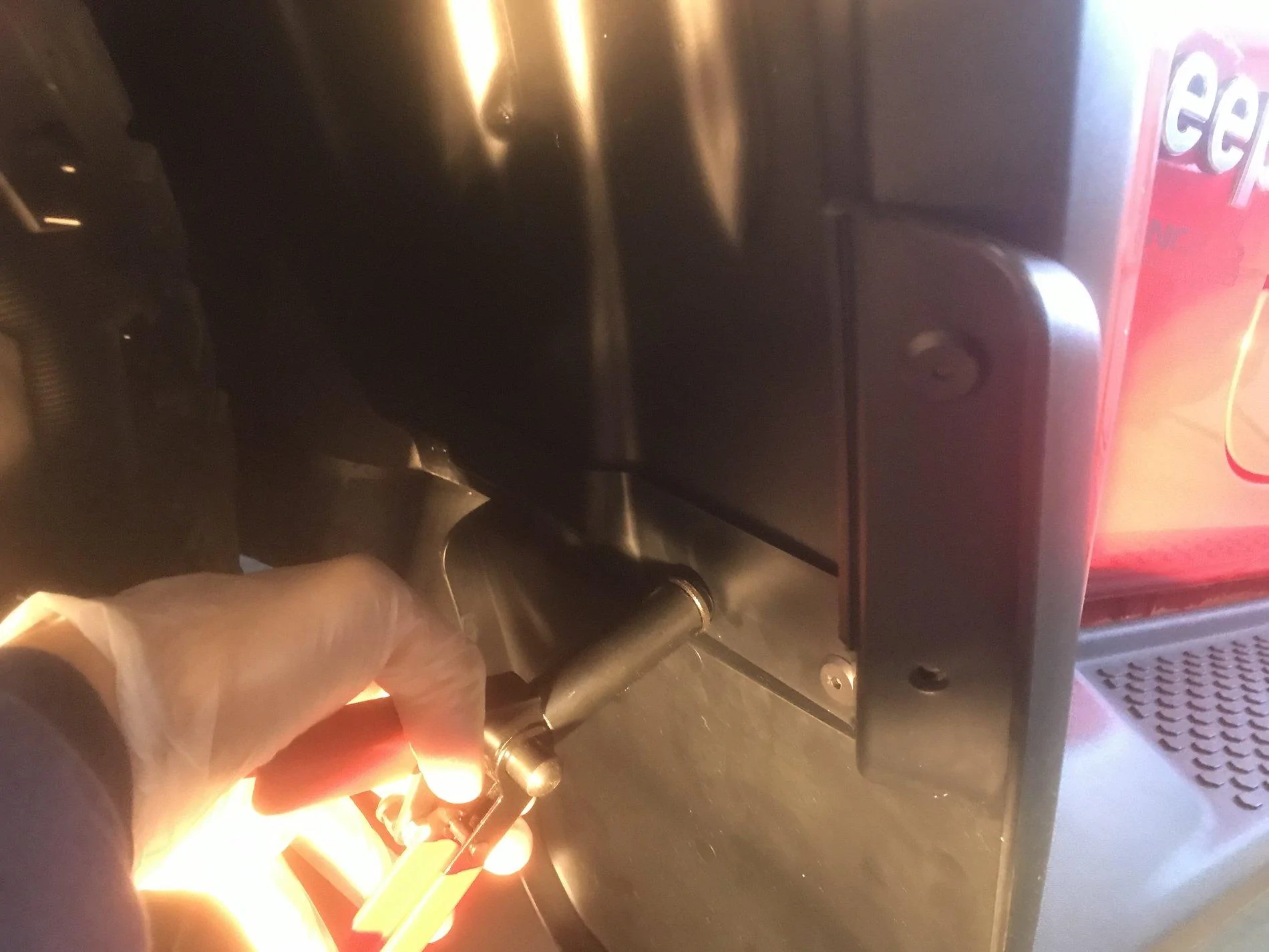

Got time to install the OEM mudflaps and locking gas cap over the weekend. Took me a couple hours tops to do both, including assembling the lock cylinder on my own (just follow the Quadratec vids).

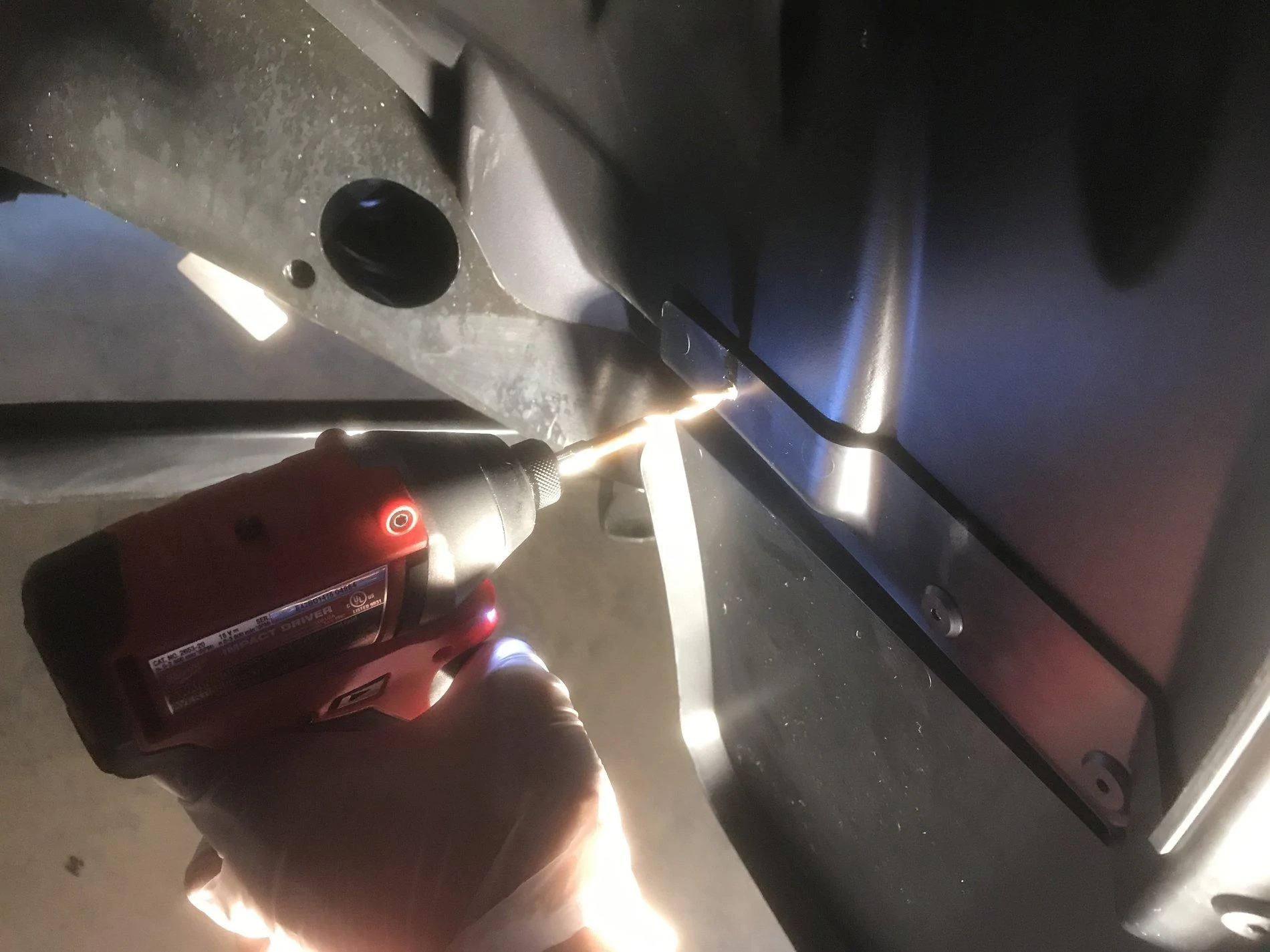

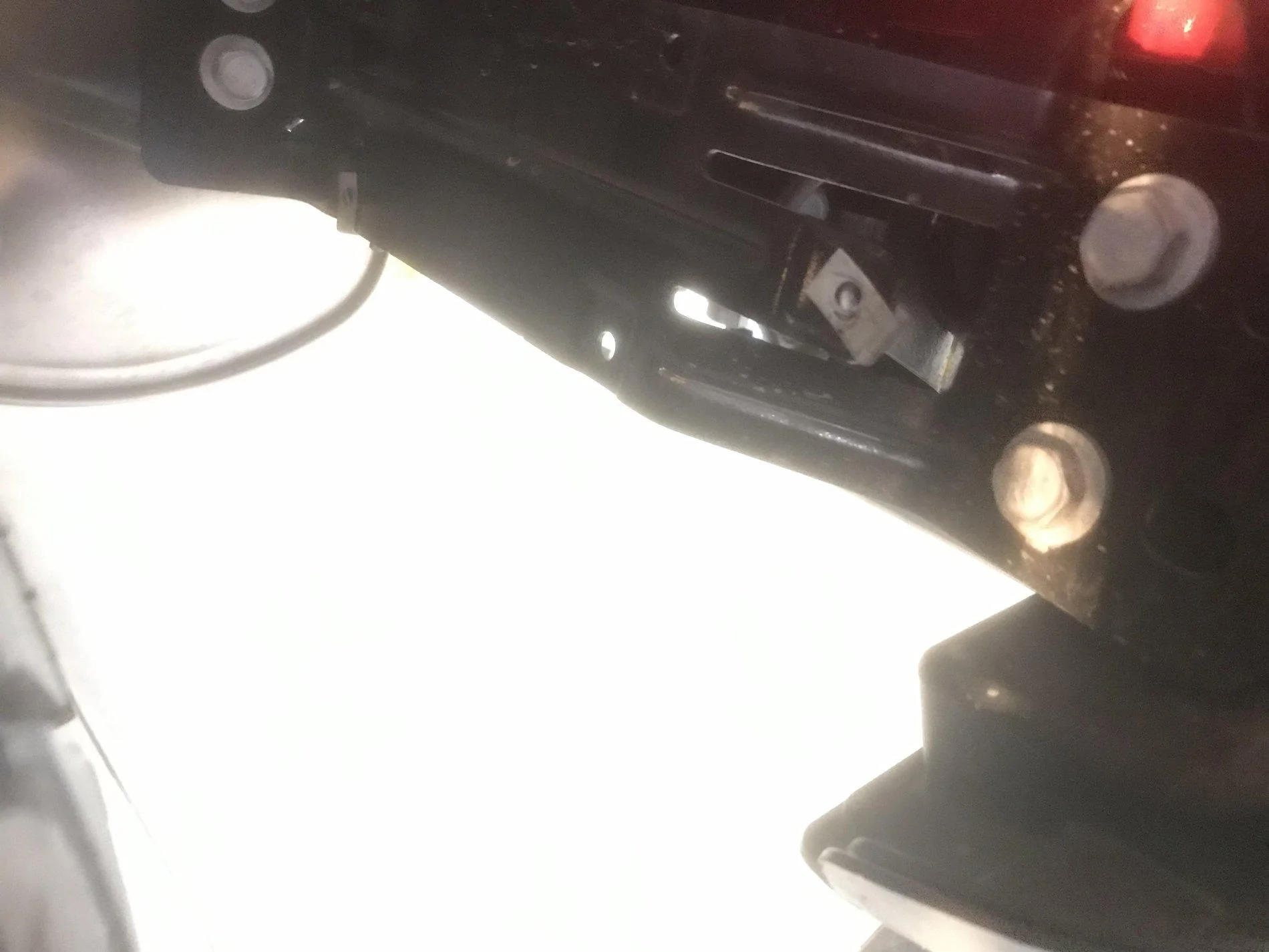

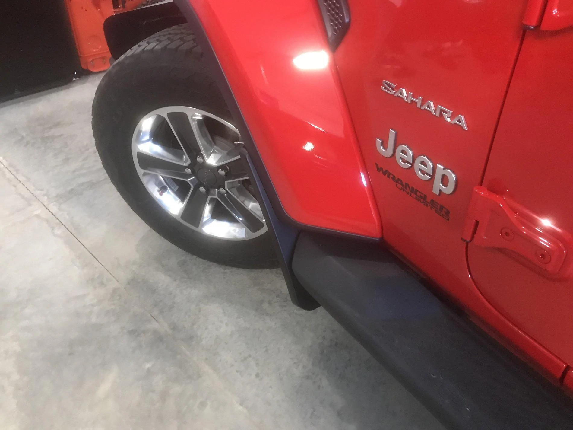

The mudflaps I installed without removing the wheels.... just turned the wheels left and right to gain access for drilling and riveting. Turned out pretty well. I love the OEM look.
Jeep Wrangler JL OEM mudflaps and locking gas cap installed IMG_4205
Jeep Wrangler JL OEM mudflaps and locking gas cap installed IMG_4208

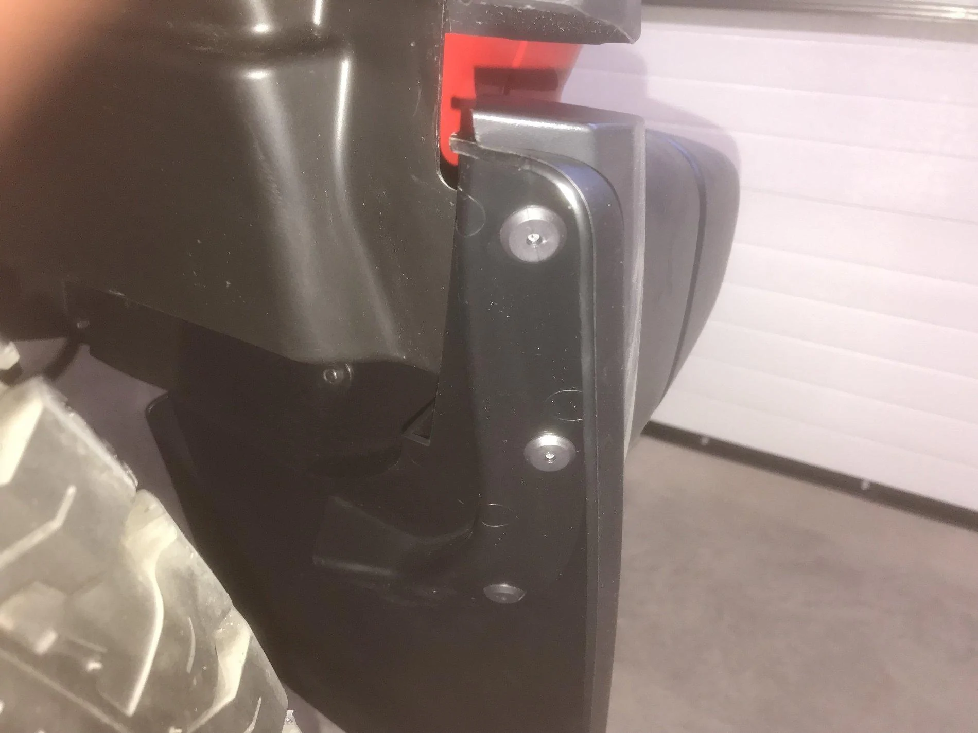

Also did the reverse clip install from CJ install vid, to reuse the screw for the rear flaps.
Jeep Wrangler JL OEM mudflaps and locking gas cap installed IMG_4209
Jeep Wrangler JL OEM mudflaps and locking gas cap installed IMG_4214

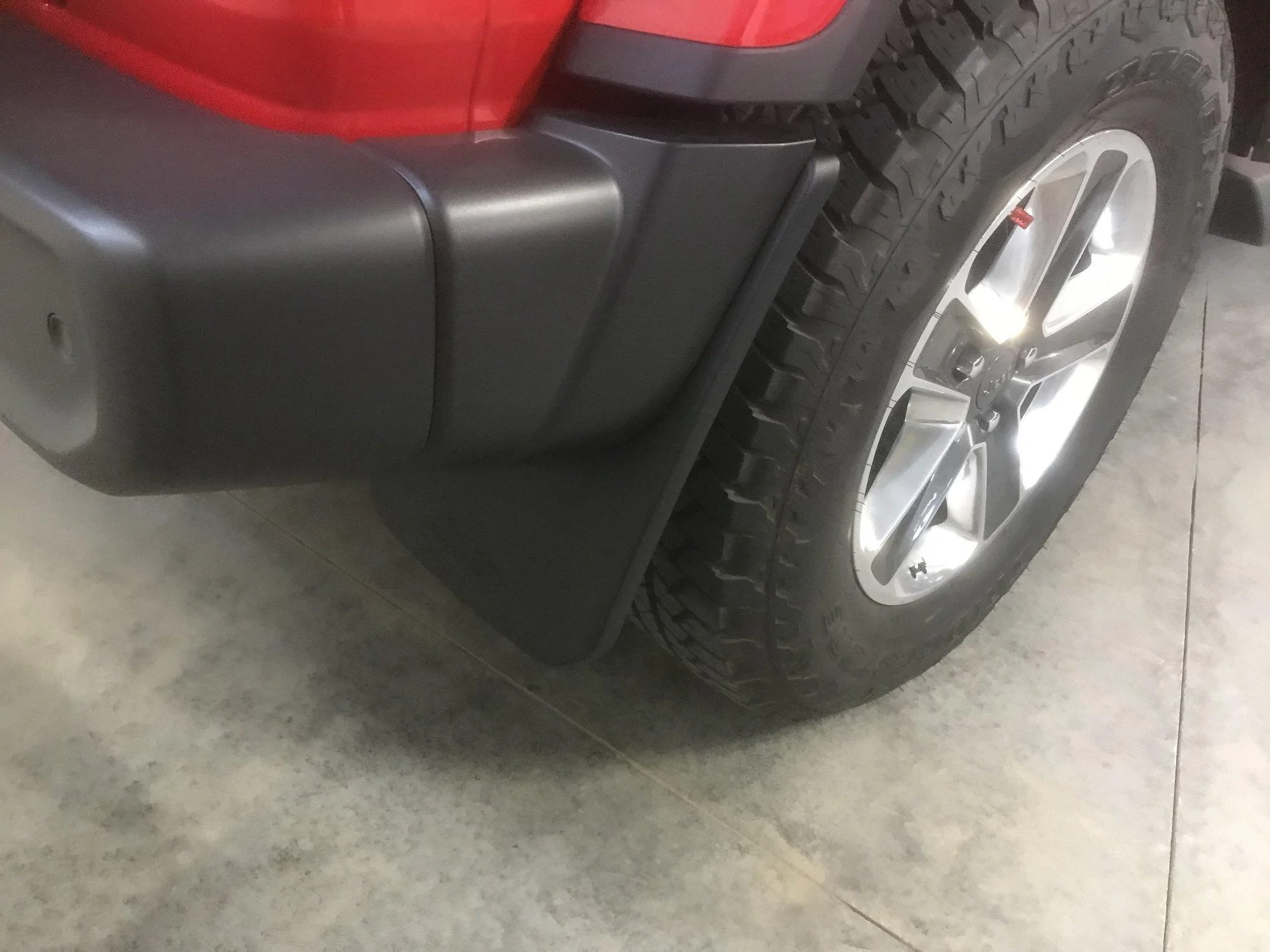

And done:
Jeep Wrangler JL OEM mudflaps and locking gas cap installed IMG_4213
Jeep Wrangler JL OEM mudflaps and locking gas cap installed IMG_4211

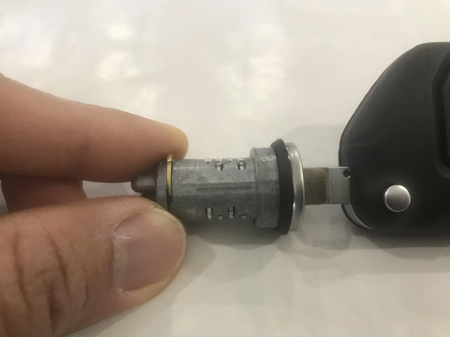

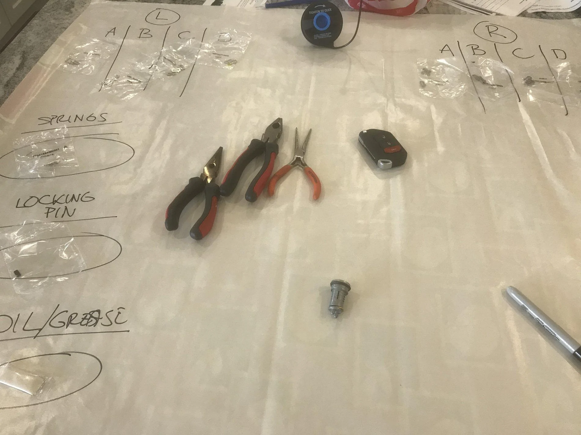

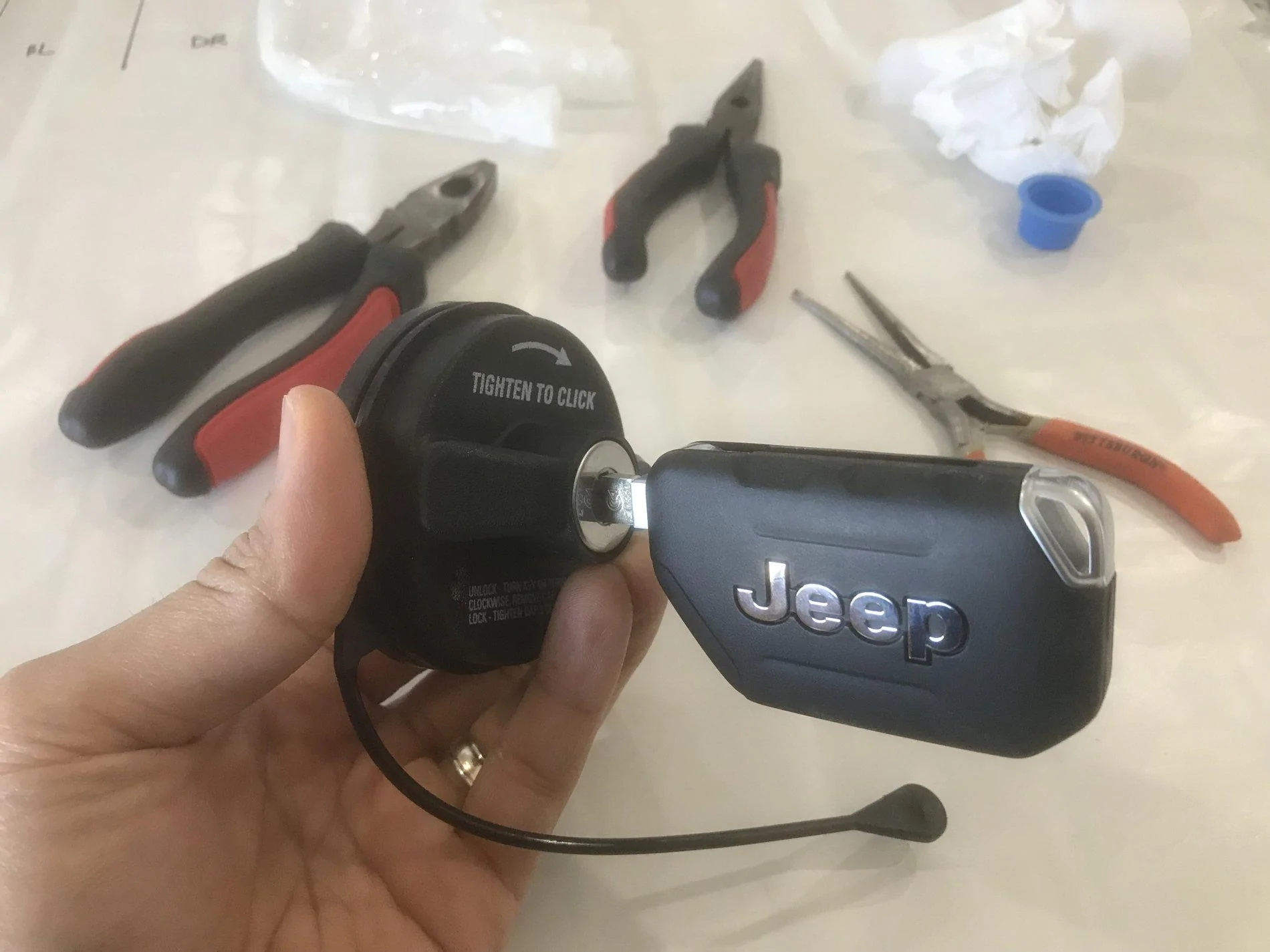

After that I did the lock assembly. Followed the vids, having a nicely organized counter.
Jeep Wrangler JL OEM mudflaps and locking gas cap installed IMG_4198
Jeep Wrangler JL OEM mudflaps and locking gas cap installed IMG_4199
Jeep Wrangler JL OEM mudflaps and locking gas cap installed IMG_4200

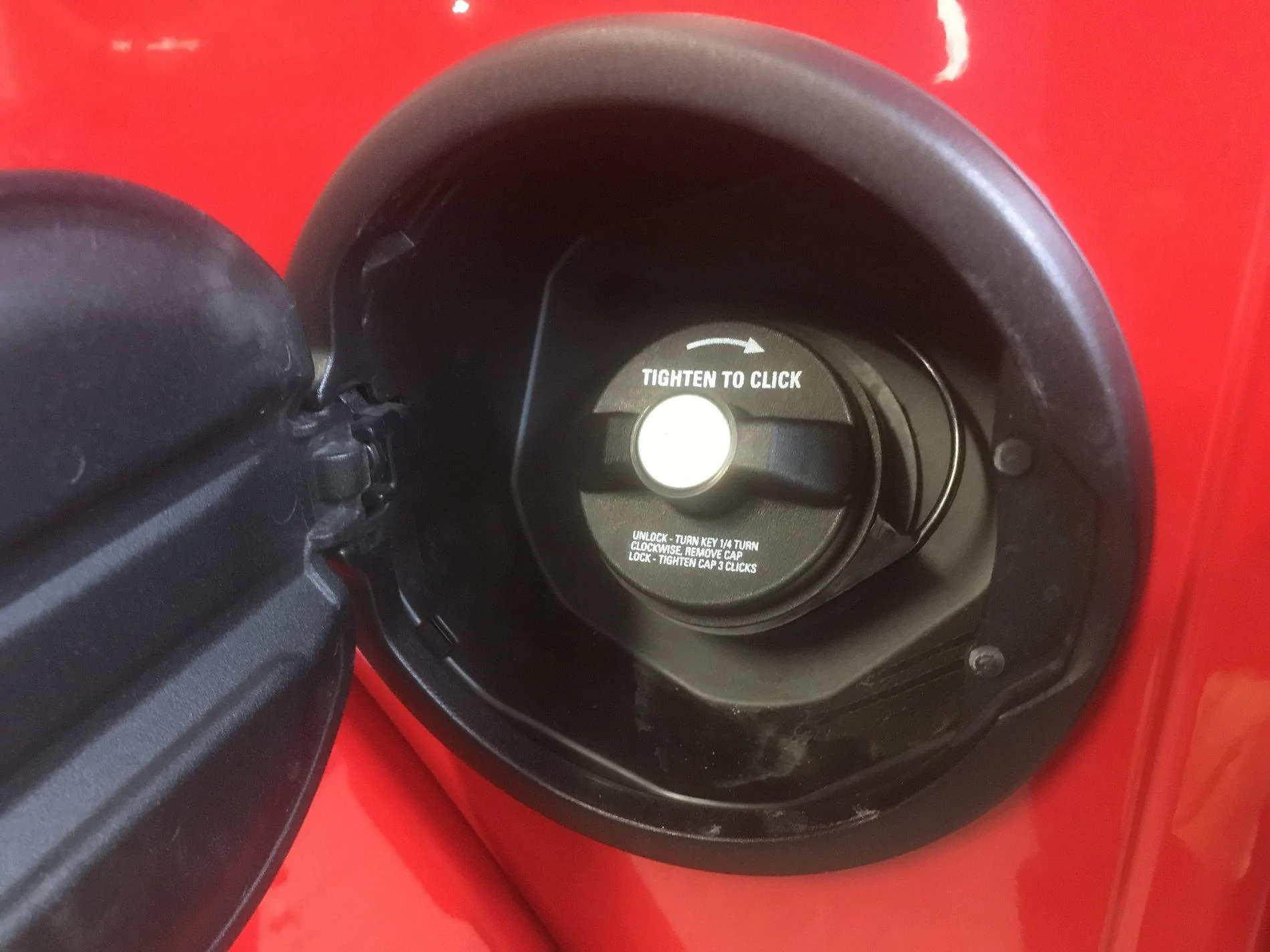

And done:
Jeep Wrangler JL OEM mudflaps and locking gas cap installed IMG_4202
Overall am very pleased with all the OEM upgrades.

Thanks man... I literally followed the Quadratec vid. It was daunting at first (vid was 1/2 hour long), but then after I watched it, the meat was really 5 to 10 mins worth, and it really wasn't that bad. The daunting part was "locking" the cylinder after you decide on the right combination. First, you have to make sure your definition of "flush" really is FLUSH. Then you insert the pin... and when it's on, it's on. No going back. The flush part comes into play because if it's not really flush, you can't turn the lock.
Btw, the drop cloth is actually Xmas wrapping paper, if you look closely :) Cheap and I just threw away after.

do we like the rear mud flaps? I only put the front flaps on, still debating whether or not to install the rears. I'm just not sure what I want to protect back there...
I think you are correct. The mud flaps for the rear are more aesthetic. It completes the look with the front. The embossed Jeep logo on the rear really finishes it off. If anything, it protects rocks from hitting the rear bumper, or maybe even some of the (slim chance) exposed rear panel paint.
