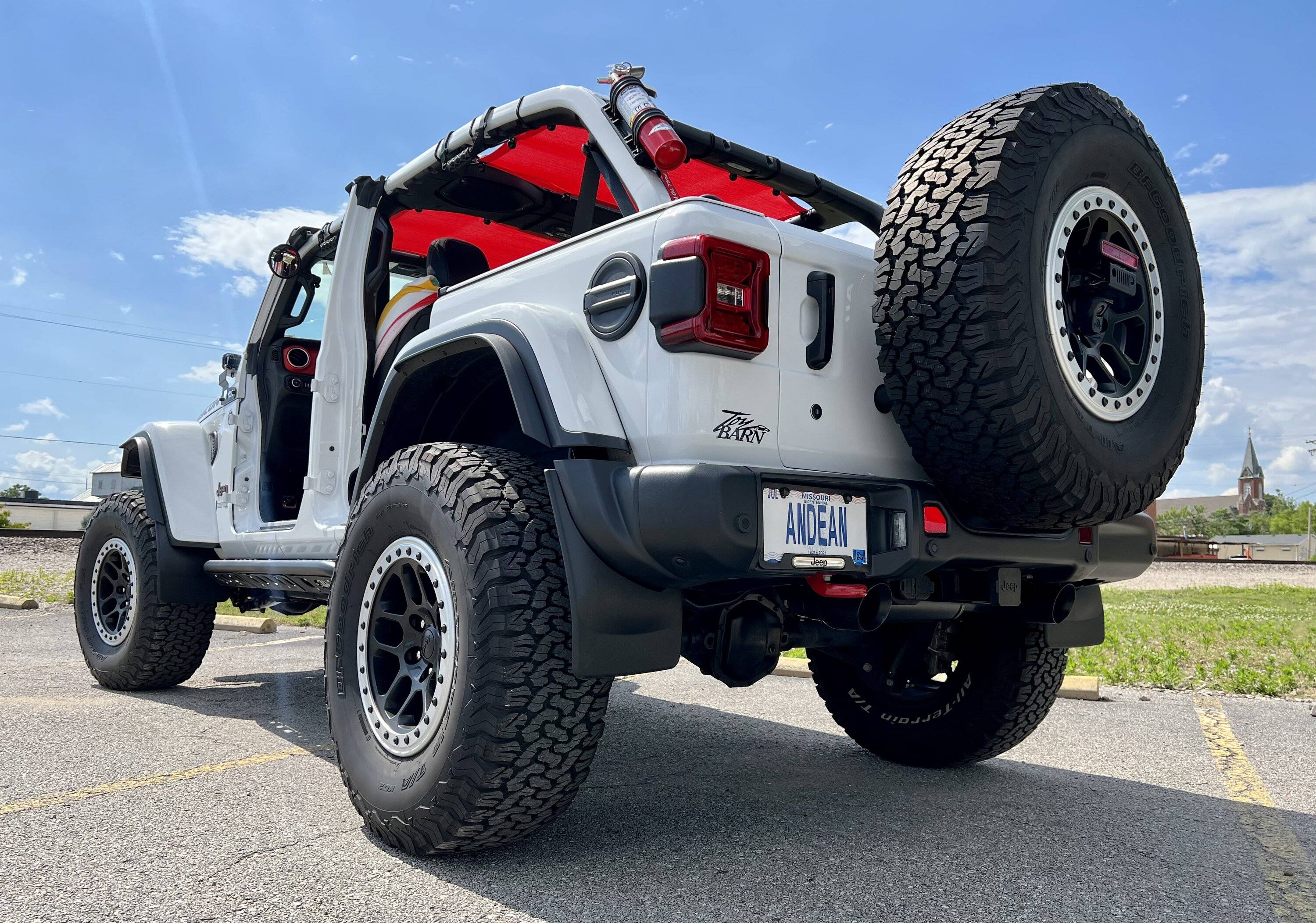

I got the WeatherTech mudflaps front and rear for my 2022 Sahara Altitude. The sides of the Jeep are not particularly splashed up, so I'm guessing that the front ones are working as I had hoped that they would. I did have a problem installing the back ones because there is a tab that is supposed to fit behind the lip of the rear bumper, but it does not engage the bumper, at least on the 2022 with the plastic bumpers. However, they have stayed on securely despite that tab's not fitting behind the bumper for a couple of months now, including driving through some moderately flooded intersections.

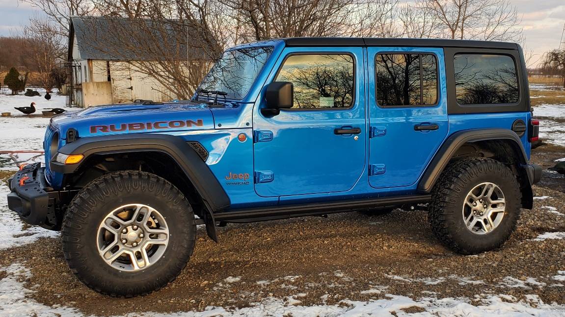

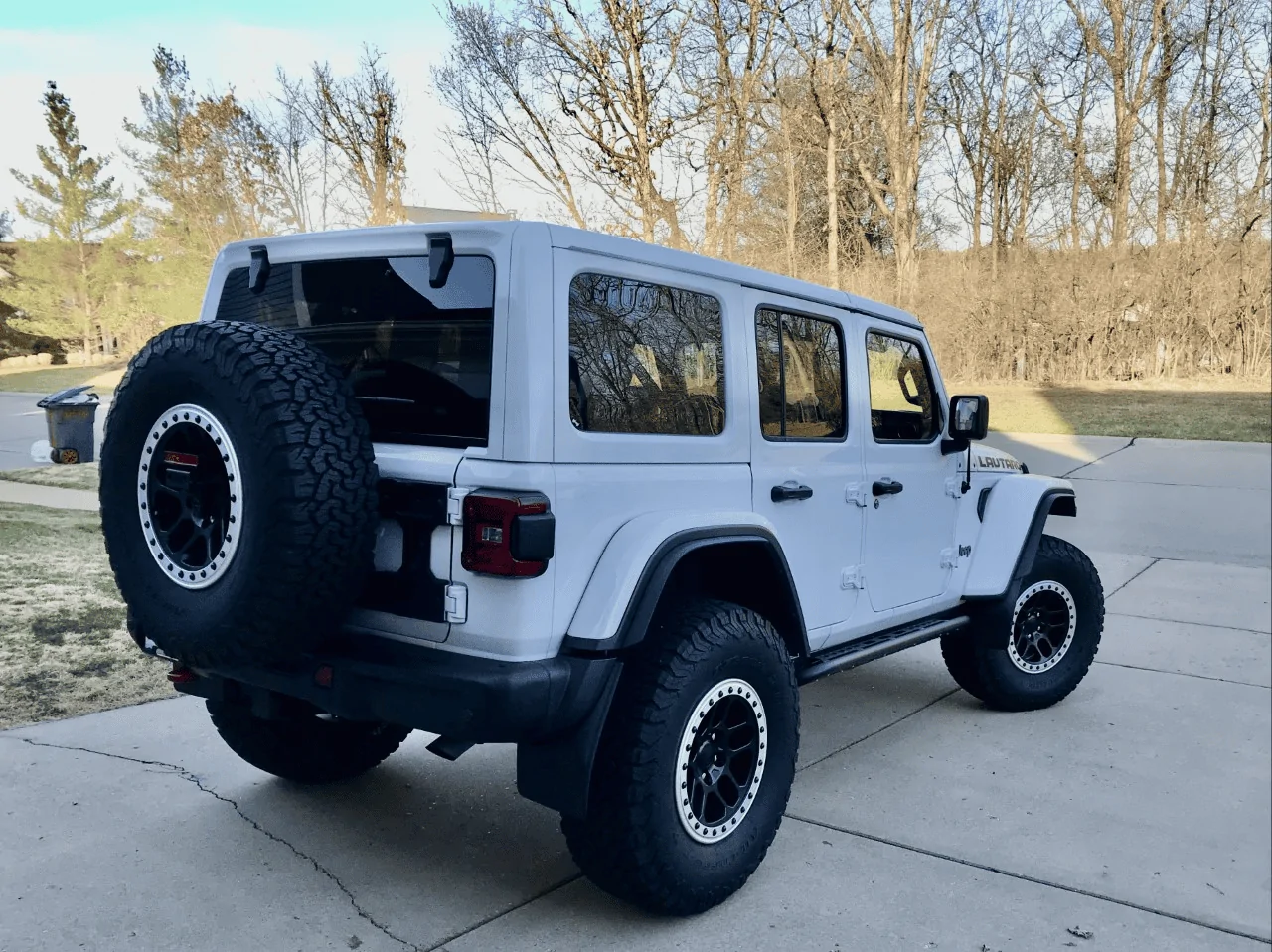

Hi,
You can modify the WeatherTech ones to fit with the Mopar Performance Rock Rails, same concept as what I've seen on other brands of flaps, just cut to fit.
Regards,
Jim
Looks like you have OEM rubi steel bumpers… any issue with rear flaps fitment with WT?

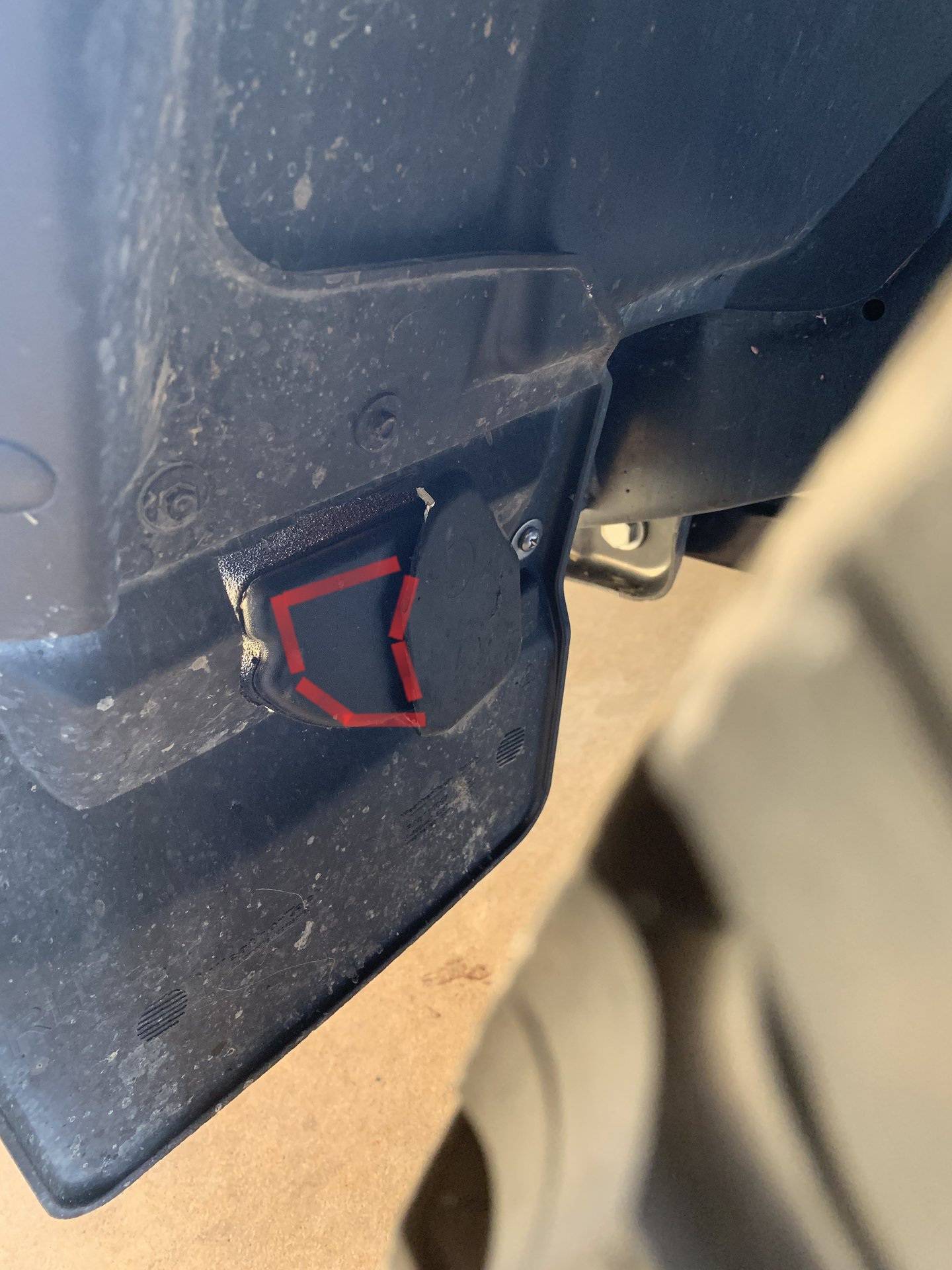

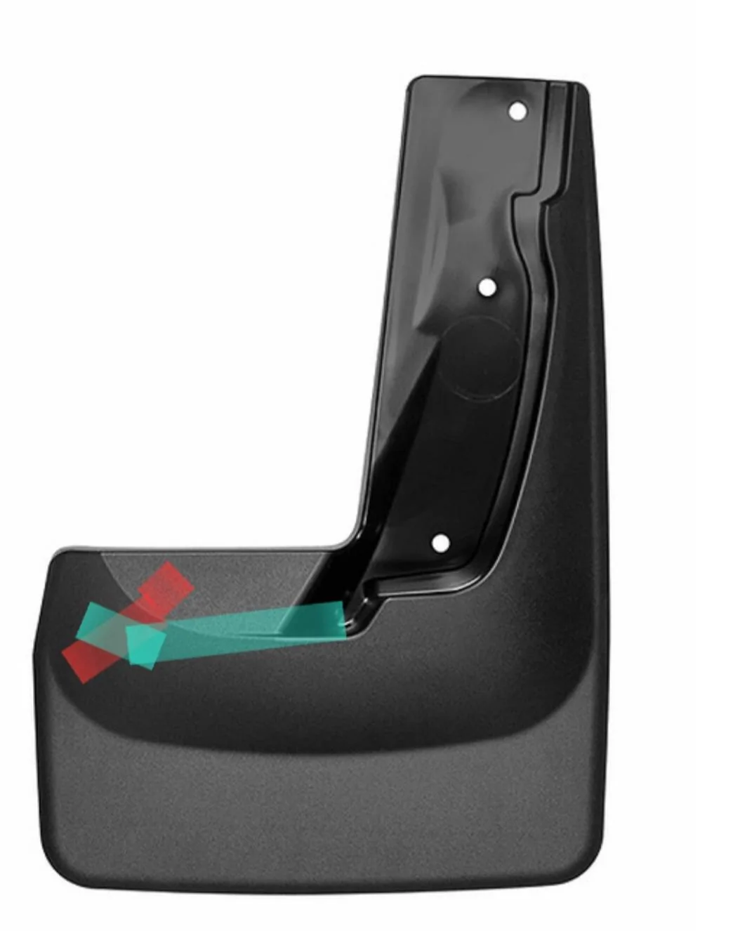

Hi,

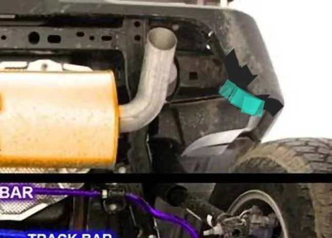

Yes steel bumpers, had to trim corners of the rear plastic bumper extensions to get the rear flaps to sit correctly, nothing you can see afterwards, heard some didn't have a issue so not sure if there are different fillers but either way a easy fix if you have interference.

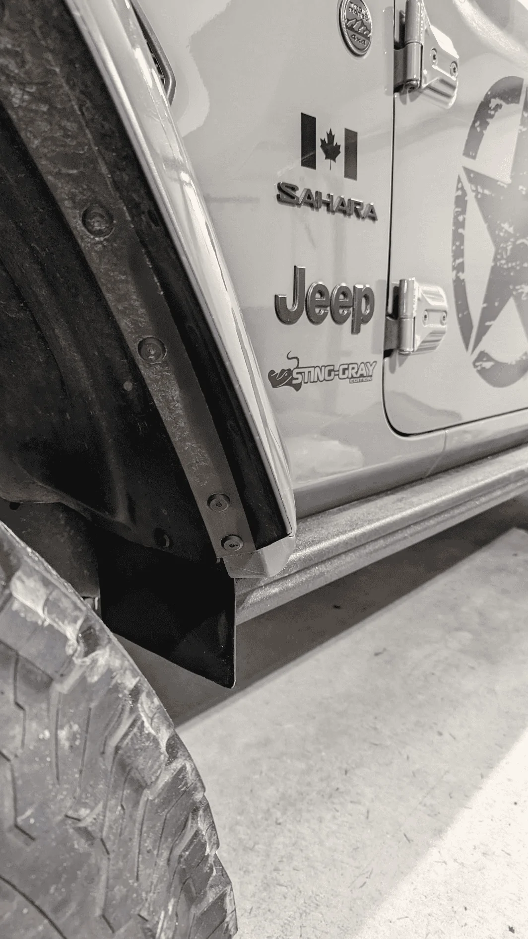

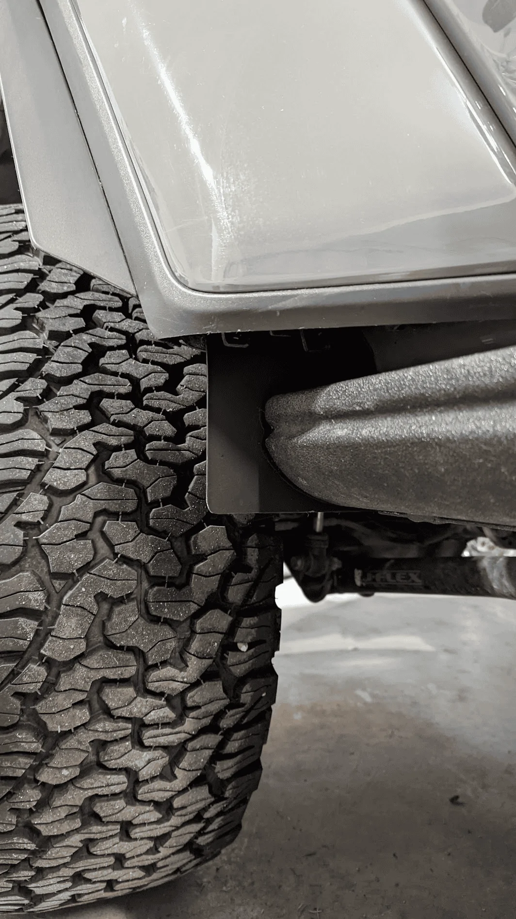

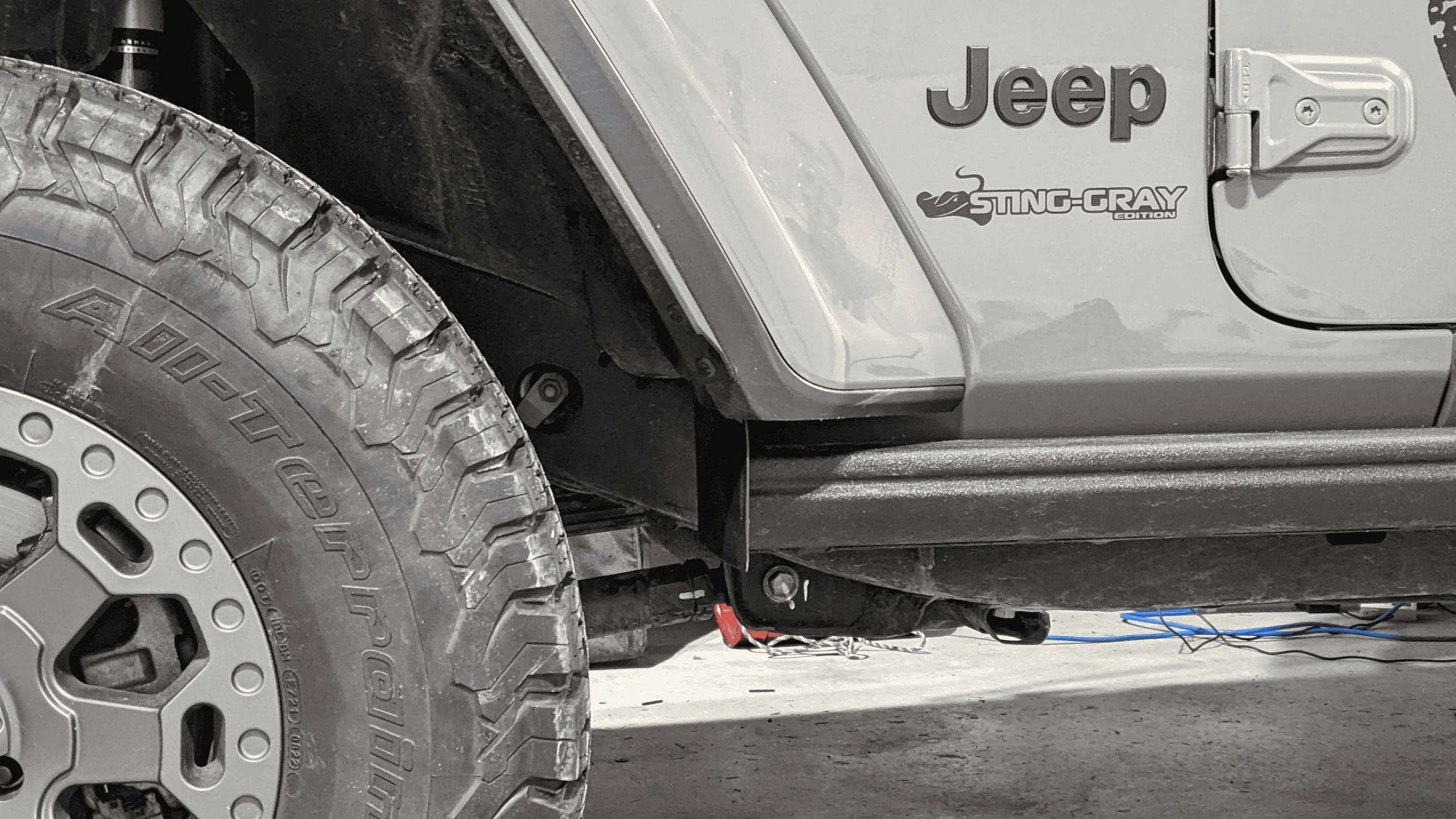

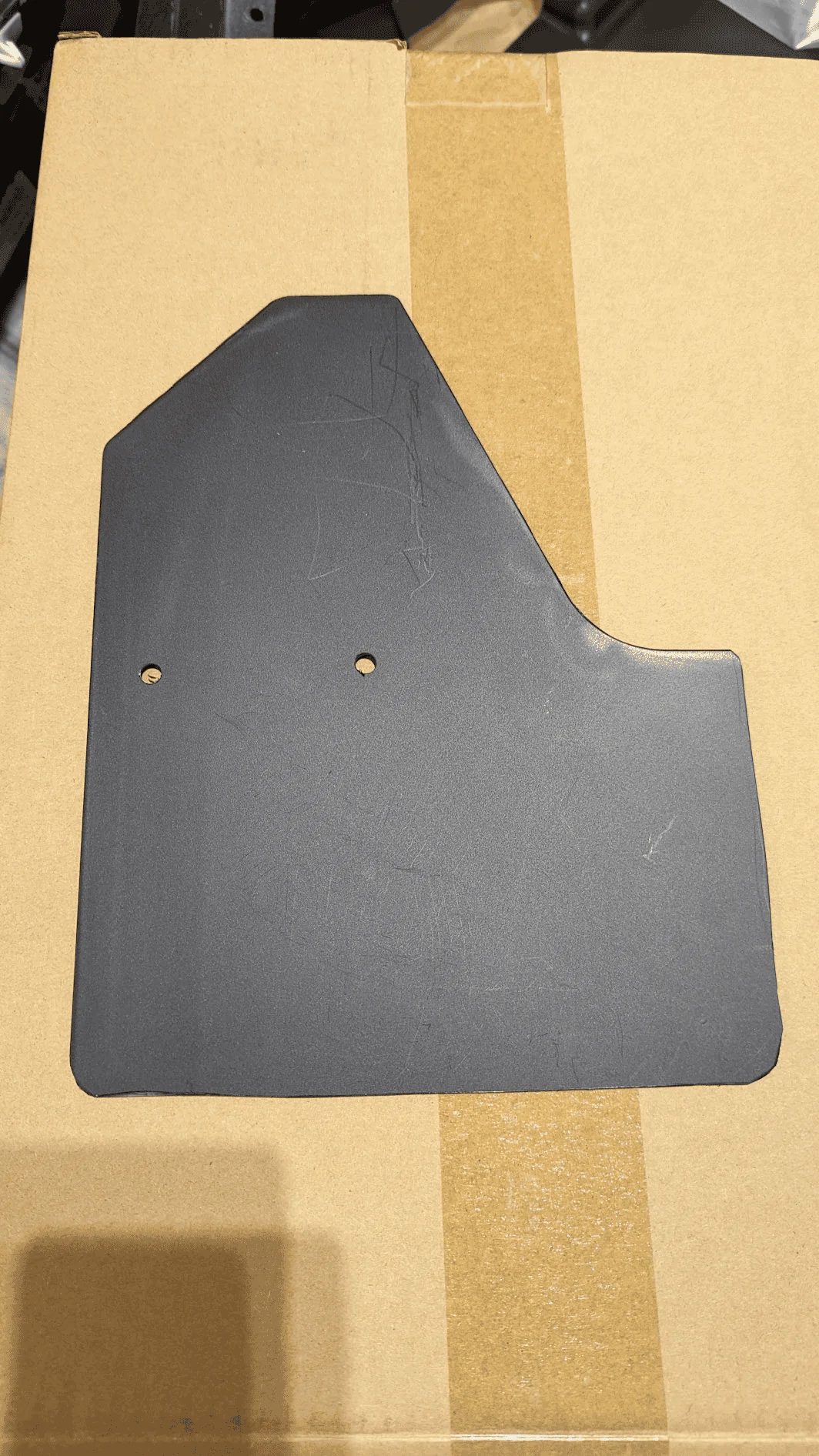

For folks who have the mopar performance rock rails
Another step in my quest to reduce mud splashes on the doors. After installing XR fender flare extensions, I still had some spray and looks like now it's mostly from the gap between the fender bottom and the mopar performance rock rails. Since there is no mud flaps that fit these rock rails without extensive cutting, I ended up doing a DIY mud splash - more of a gap filler - out of those thin universal mud flaps ($20 on Amazon)
Cut to size with box cutter
Installed with plastic rivets
I don't think this will get smashed off-road. It's very difficult to land on a rock that far up at that specific spot without avoiding the rail.

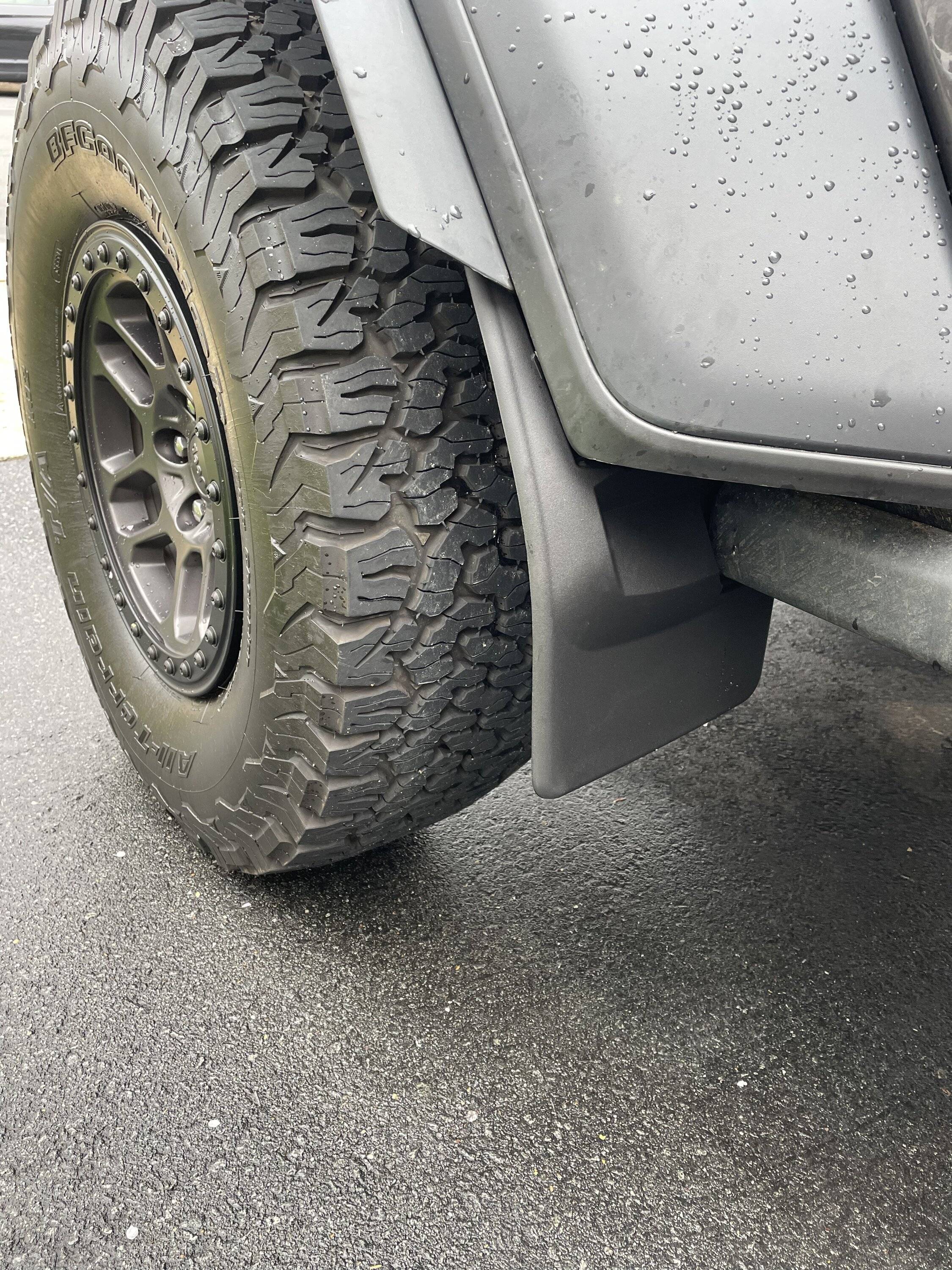

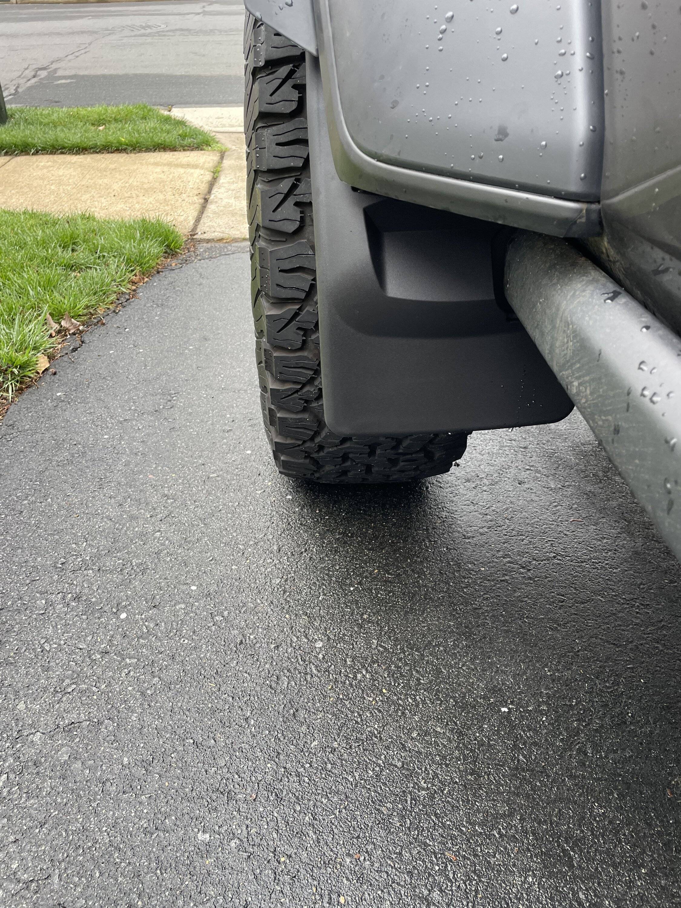

Installed the Weathertech mud flaps today on my Willys XR. As mentioned previously the XR flares metal rivets made it more of a challenge than I wanted. I only attached these with 3 screws instead of 4, and I had to drill a new hole in the mud flap for the 3rd one since they didn’t line up great with the XR flare.
I like the finished look of these, but if you have an XR and don’t want to drill any holes, I would suggest looking into other options.
